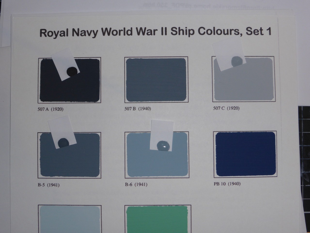

Posted: Tuesday, June 06, 2017 - 09:01 AM UTC
Hi AJ,
As opposed to Si above, I'm going by the modified expanded TLAR-System, which servers the same purpose, only makes it a little more complicated.
So here's what I used for my Belfast (Tamiya colours):
507 A : XF 50 (Field Blue) / XF 1 (Flat Black) = 3 / 1
B6 : XF 18 (Medium Blue) / XF 2 (Flat White) = 1 / 5
B5 : XF 18 (Medium Blue)
507 C : XF 2 (Flat White) / XF 66 (Light Grey) = 4 / 1
Hull Red : XF 9 (Hull Red) / XF 7 (Flat Red) = 4 / 1
And that'S how it looks like, as compared to Snyder&Short paint chips:
and on the model:
Here's the link to my build a couple of years ago on MSW:
https://modelshipwrights.kitmaker.net/forums/234206
Hope that helps, it's a fine model and fun to build, enjoy your build!!
and on the model:
