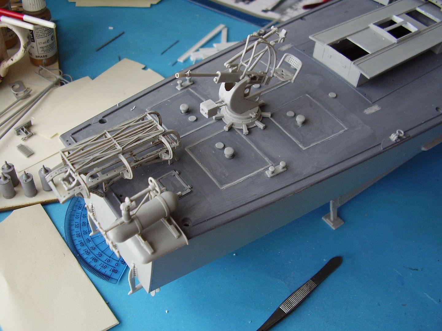

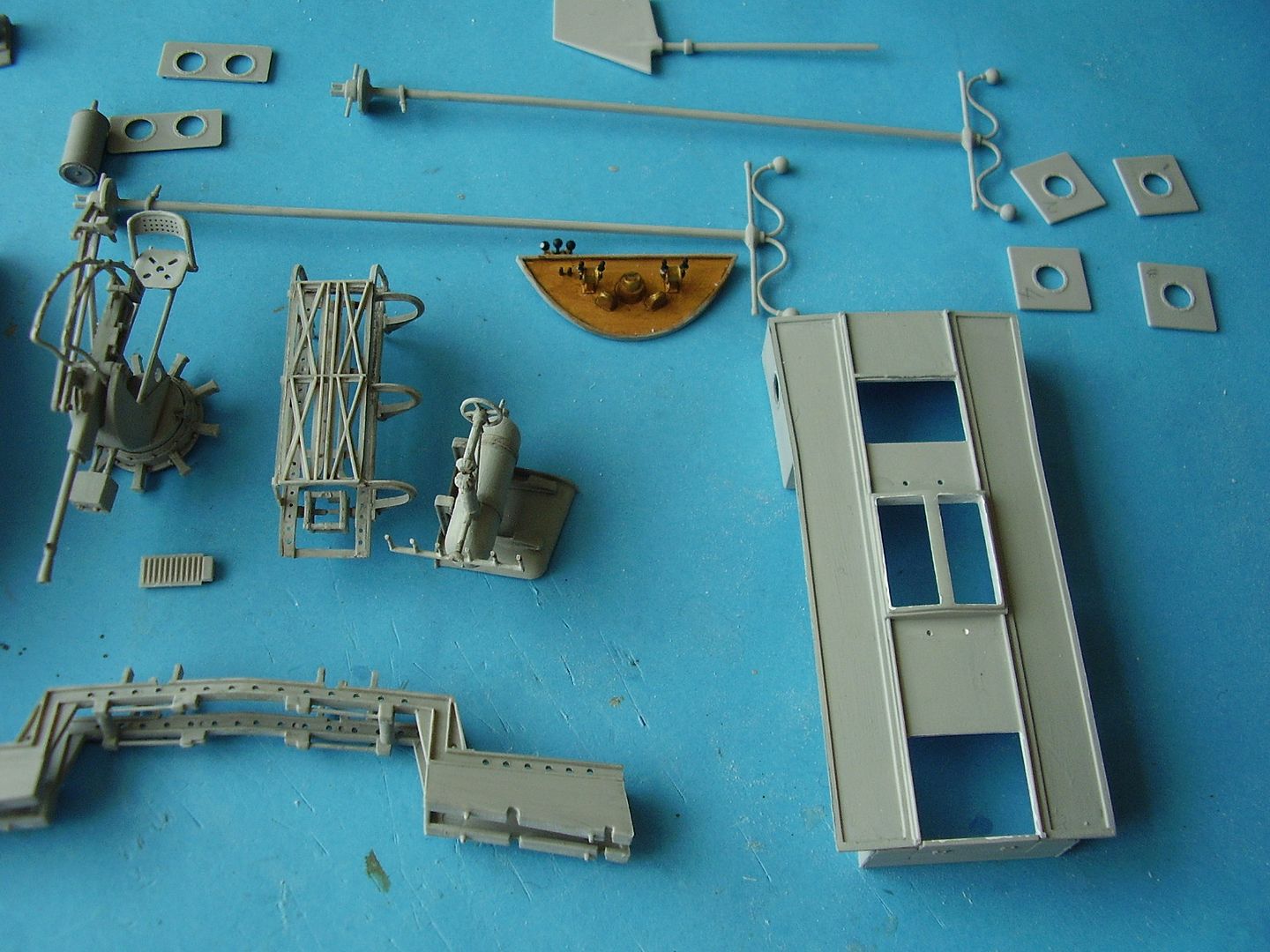

While I'm waiting on a resupply of styrene I got on wiht a few of the deck fittings.
I'm not sure what the corner fitting on the stern is it's at stage 32 in the instructionsand me thinks a coulpe of the part number are incorrect should be E not F. Parts 46F are the same one on each of the spures but I have a feeling one is wrong as the extended lug for the cross bar is on the outside?
Also worked on stage 33 the depth charges. There is a little spindle that rotates on the end of the rack - Parts 43f. One of these had a coulpe of stunted arms which didinl't help and the cross arm on my part 42d was broken off . Other than that a pretty good fit, I've som,e PE to add to thisp part yet
On the Breda parts 33e and 34e weren't a great fit and be careful removing part 31e the barrel end .
Smoke screen generator.

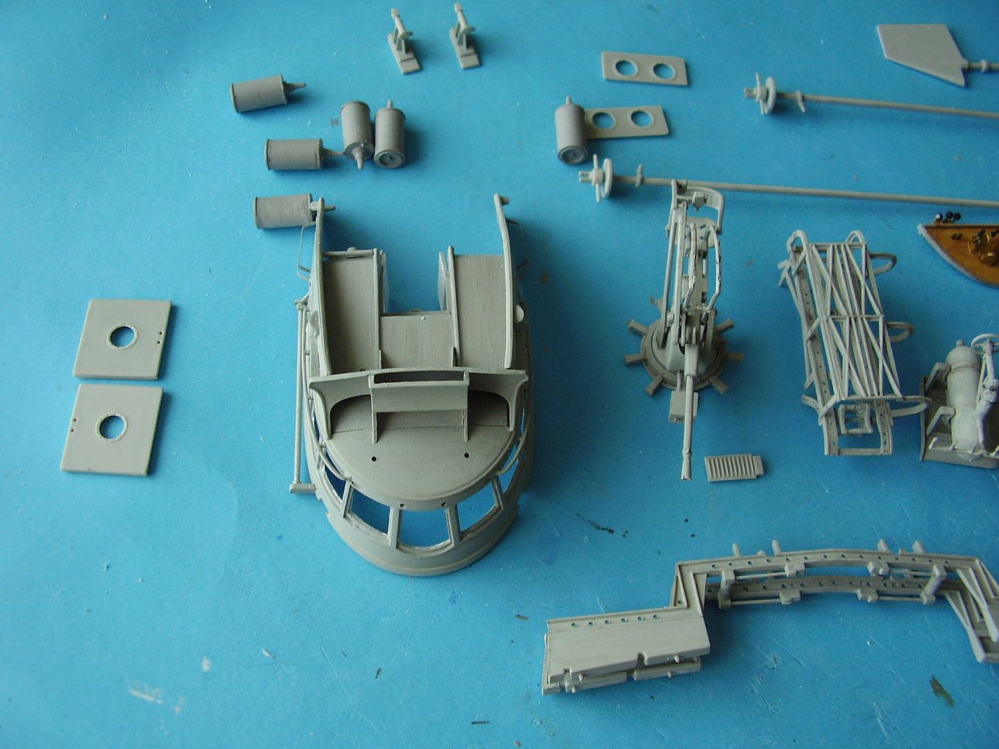

Hi folks,
bits worked on so far.

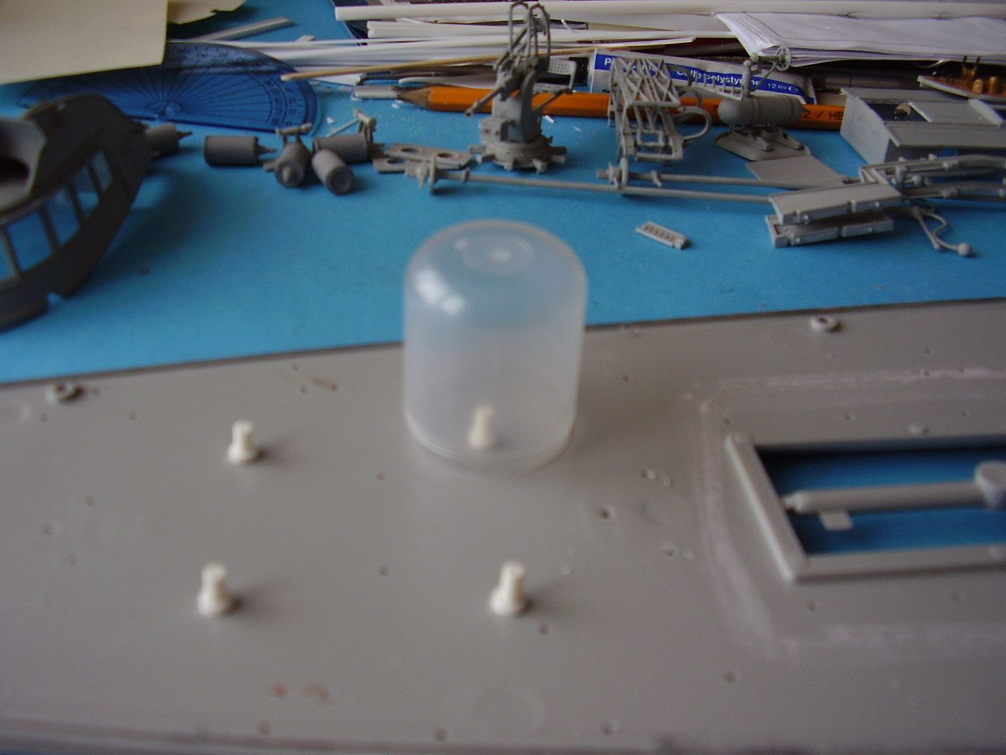

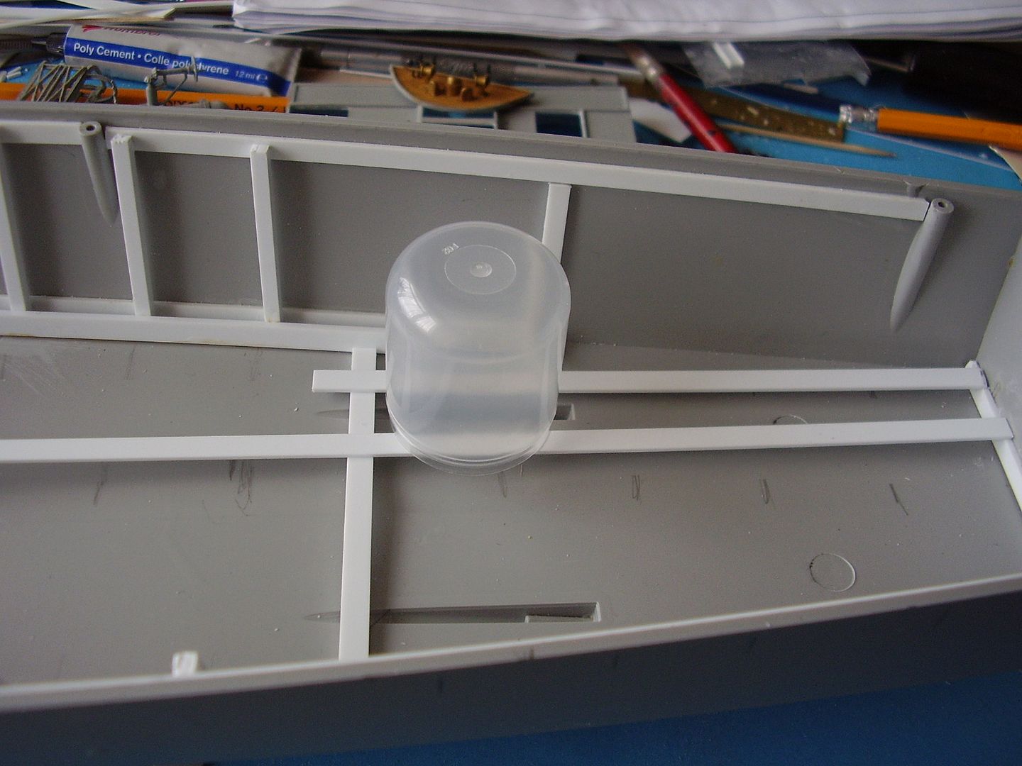

I did come across some tops that I though might work as fuel tanks!?

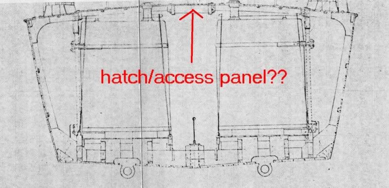

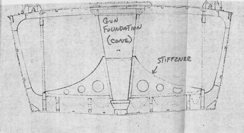

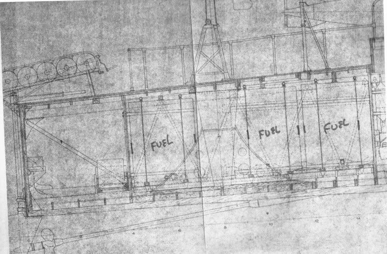

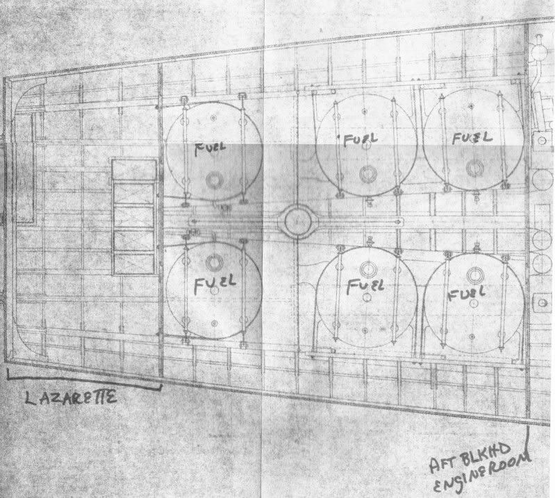

I've build 4 of the fuel tanks, which may be a waste as there is a bulk head forward of them, but I assume this bulkhead had a door way to the aft of the boat, so an open doorway which might make the effort worthwhile? That is assuming the bulkhead was solid and not a frame of some sort?

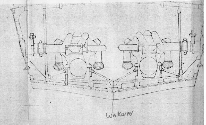

I also assume there was a central gangway running the length of the engine room, through the fuel tans to the workshop area, but this has some form of what looks like metal bracing between two sets of the tanks.
I've been looking at the drawigns but can't see whether the fuel lines run along the deck to the fuel pump at the side or under the deck. Can you throw any light on this and where the fuel lines exited the tanks?
Edit: As a follow up on the diagram of the officers quarters there are two box type things on the upper wall to the side of the rifle rack. Any idea what these represent? Also any idea what the locker type things are in the centre of the diagram?
The only access to the fuel tank compartment was through the four hatches in the deck above and, on the drawings, what appears to be a small hatch on the centerline between the first two pairs of tanks. The hatch is not on the model, but I can see what looks like the appropriate framing for a hatch on the plans. It appears to be flush with the deck, so may have been more of a removable panel than a hinged hatch. It's about the same size as the hatch into the lazarette, but runs lengthwise. Its forward end is roughly in line with the back of the seat on the BREDA.. The bulkheads at either end did not have an access hatch through them.
On the drawings, it appears that the fuel tank outlets were inboard, at the bottom of the sidewall of the tanks, in line with the filler caps. The plans do not show the fuel line runs.
The inverted cone with four supports between the second and third pair of tanks was the deck stiffener for the gun mount above. As thin as the lines are on the drawing, both the cone and the supports were likely metal.
The small boxes up high in the O quarters are bookshelves. The objects against the bulkhead are most likely a desk with storage under (center), and a cabinet or two for the skipper (clothes, charts, etc).

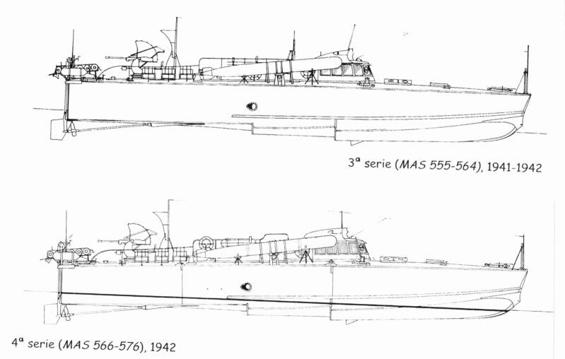

I have a question about boat MAS 558 (in the gray-white camouflage uniforms), this boat belongs to a series 3a.
What were the differences between the series 3a and 4a? How much to alter the model to get the MAC 558?

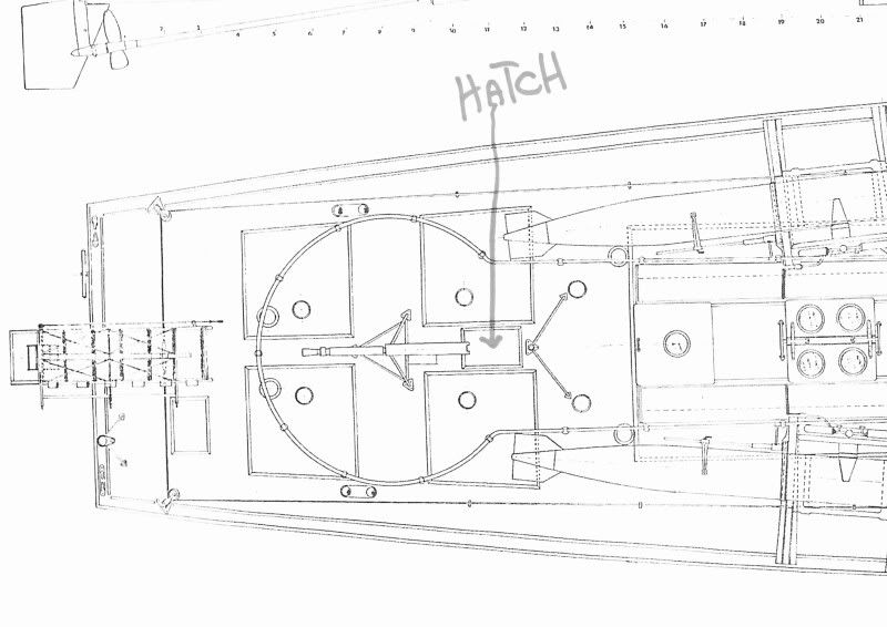

Here's that fuel compartment hatch on an earlier series boat.

Essentially, both series are outwardly nearly identical. They have the same dimensions (18.7m x 4.7m), same engines, same armament, etc. These drawings of the two series are from an article in 'STORIA MILITARE" by Erminio Bagnasco.
A great deal of technical detail, including photos and drawings, can be found in both I MAS E LE MOTOSILURANTI ITALIANE or MAS E MEZZI D'ASSALTO DI SUPERFICIE ITALIANI (both written by Bagnasco).
Al Ross

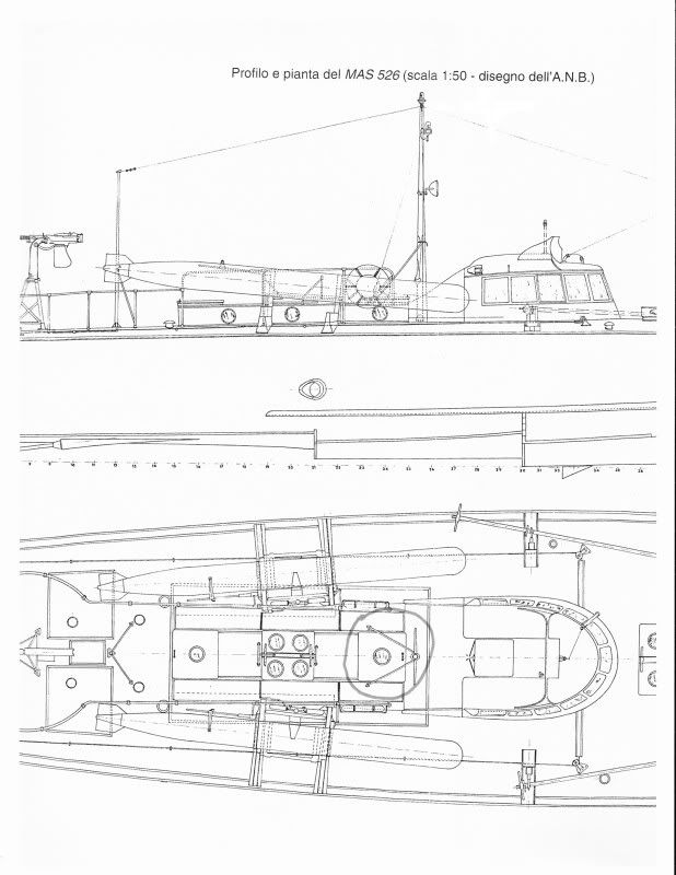

Al, I know that it. It is a mast, but it isn't up to the end traced on this drawing (the top is cut off or hasn't got on a picture). At first I thought that it is a machine gun on a rack, but have then understood that it is a piece of a mast with an inclined prop.
If you have the drawing of this mast, please show it.
While this drawing is for an earlier boat, I checked it against the set I have for the later boats and the mast is identical.

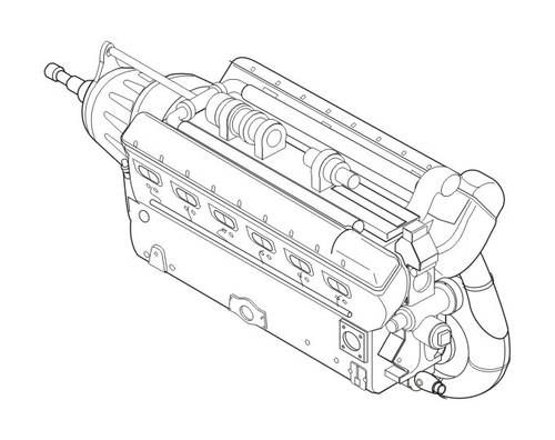

Engines!
Caused some head scratching i can tell you.
I came across this by CKM (thanks Luciano)
What do you think close enough?
