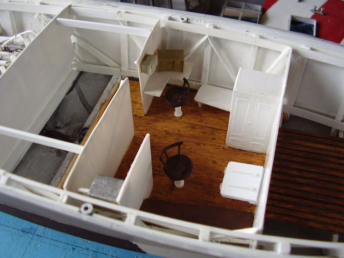

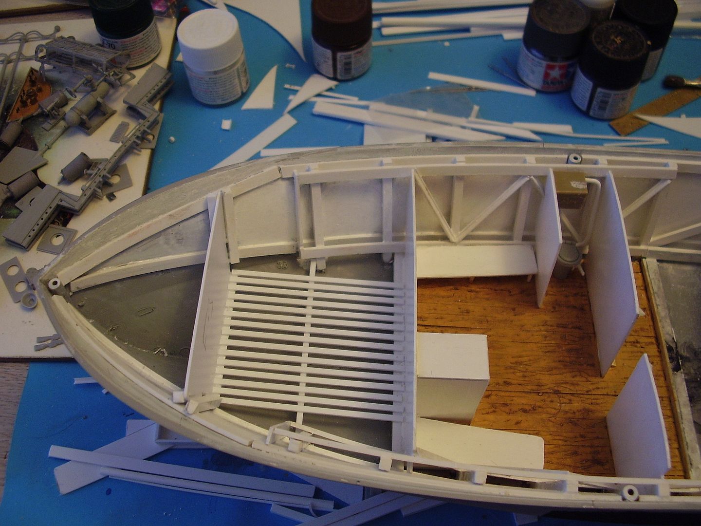

Hi Folks,
Added the Officers bog. Made this from a Sherman hatch cover and an upturned gun pivot left over form the 20mm plus a extra large can form the Tamiya LRDG truck for the tank., Fitted a pumping handle to the side and some plumbing, drilled a hole in the planking to fit it in so iready for use
Finished the planking in the crews quarters which gives a nice contrast but the spacing might have been a bit closer.

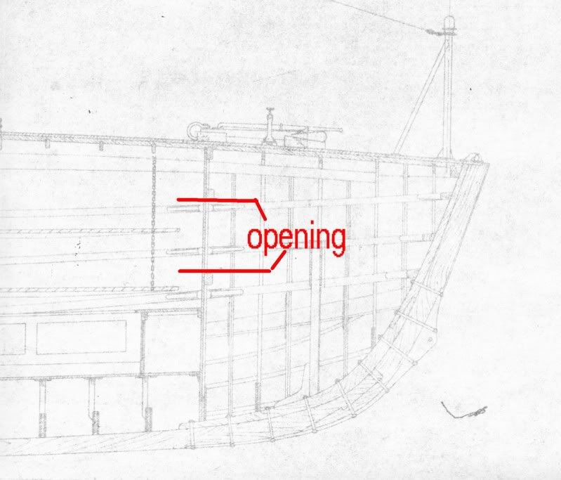

A question on the Officers Bog - a walled off side with a door or curtain on the front? Any thoughts?
Furtiture stuff - would the table have been a fold out type or fixed to the floor? Round or square with a raised edge around it?
Oh, one more thing, would there have been an access hatch in the forward bulkhead to the bow where ropes etc were stowed?
The drawings show an opening facing the center of the boat, but there is no indication of a door. Typically, they're shown as a line with an arc indicating how it was hinged.
Looking at the drawing, it seems that the writing surface was hinged. If you look down into the space, the desk is a backwards D shape with the straight part up against the forward bulkhead. The chair is placed quite a bit aft of that. There is a light D shape between it and the desk that is the same size and shape as the desk top. This suggests that the writing surface was hinged along the edge with the radiused corners and was flipped aft for use.
If you look at the side view drawing on page 2, you can just see two rectangles on the forward side of the forward bulkhead in the crew's compartment. If you look at the top view, you'll see what appears to be a panel between the inside of the hinges on the rectangle in the center. I suspect this is the hatch into the forecastle. It may have been hinged, but I can't tell from the drawings.

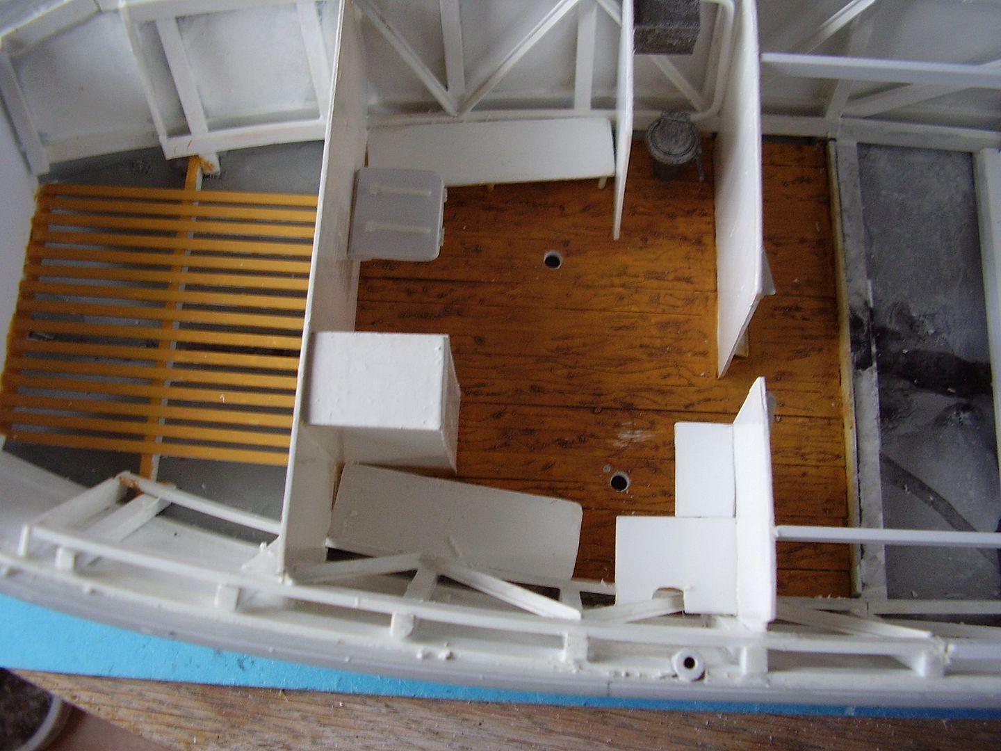

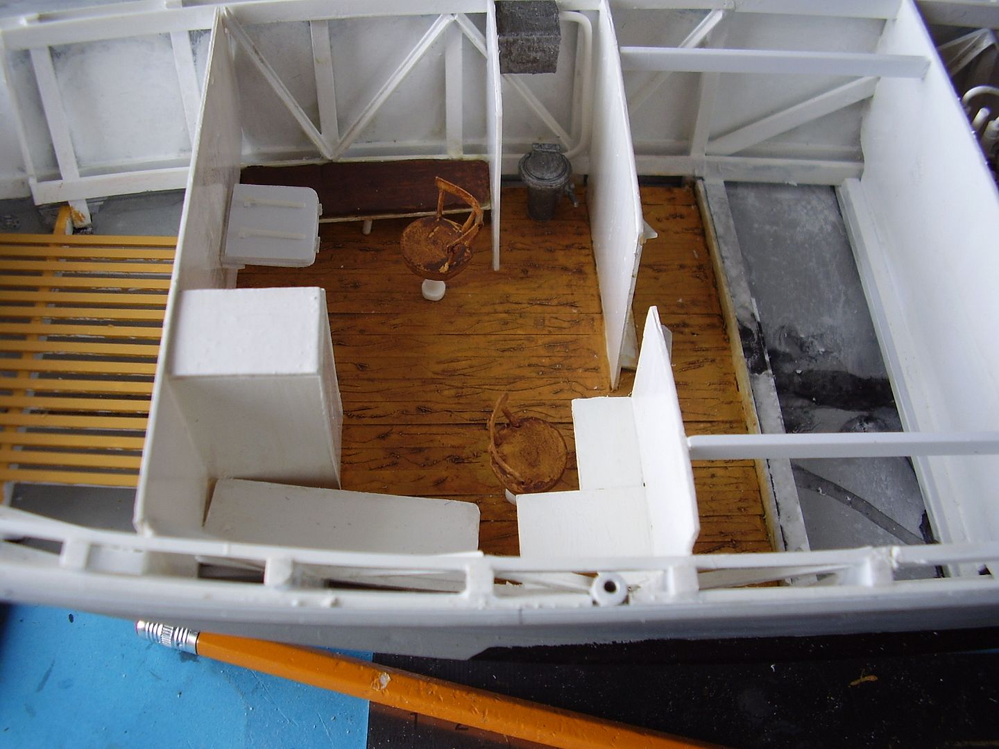

Posted: Friday, March 11, 2011 - 05:24 AM UTC
Hi folks,
Table added, I've made it in two halfs, one folded on top of the other. Added some bracks and supporting legs which one would assume were needed when it extended.
Drilled the holes for the two chaires, these I pondered about but thought I'd try using hollow sherman wheels as the base. This allowed me to cut off most of the tyre and I've added a chair backing of sorts . I'll make a seat from milliput and see how it turns out. Fixing them will be by various sizes of pipe that slot into each other as what ever goes inside needs to be well secured down.
Bit of a thick base maybe but this shouldn't matter from a top view.
Also made the rifle rack but I'm still unclear which bulkhead this fixes to?

Posted: Friday, March 11, 2011 - 06:19 AM UTC
Also made the rifle rack but I'm still unclear which bulkhead this fixes to?[
Forward bulkhead in O-country between the wardrobe and the desk.

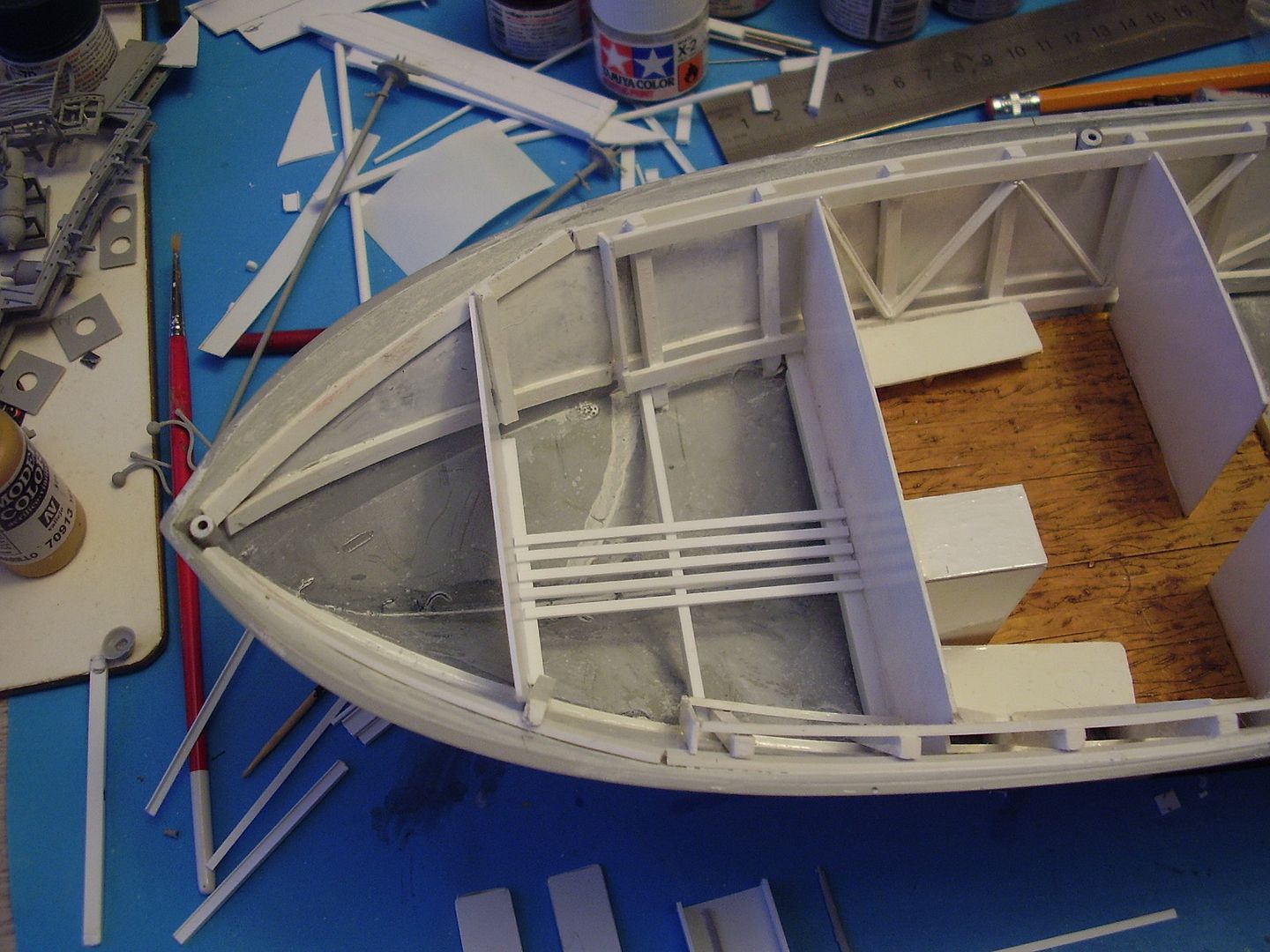

Hi folks,
Here's the Mk1 seating . Made a leather cushion for the bench too.

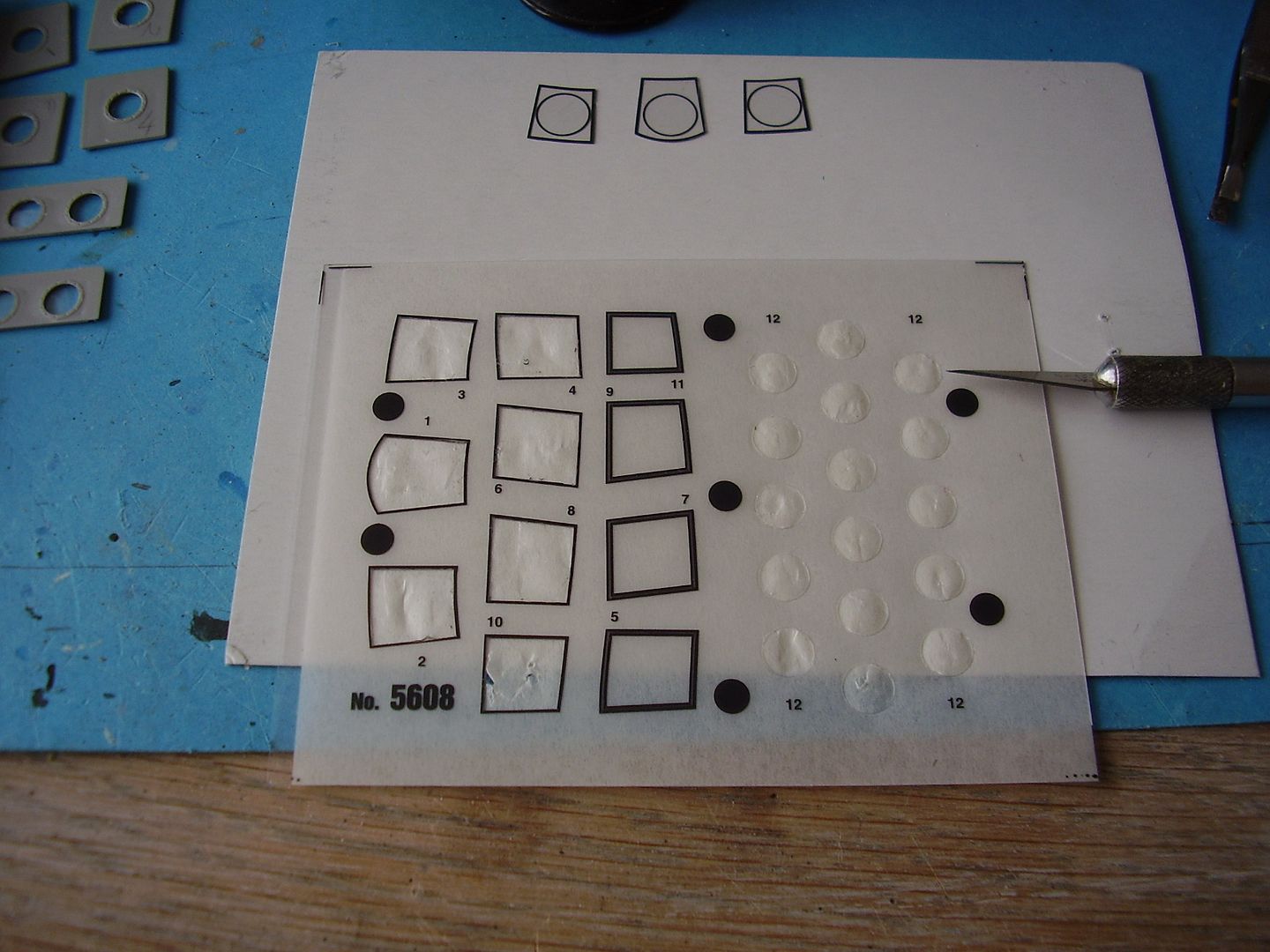

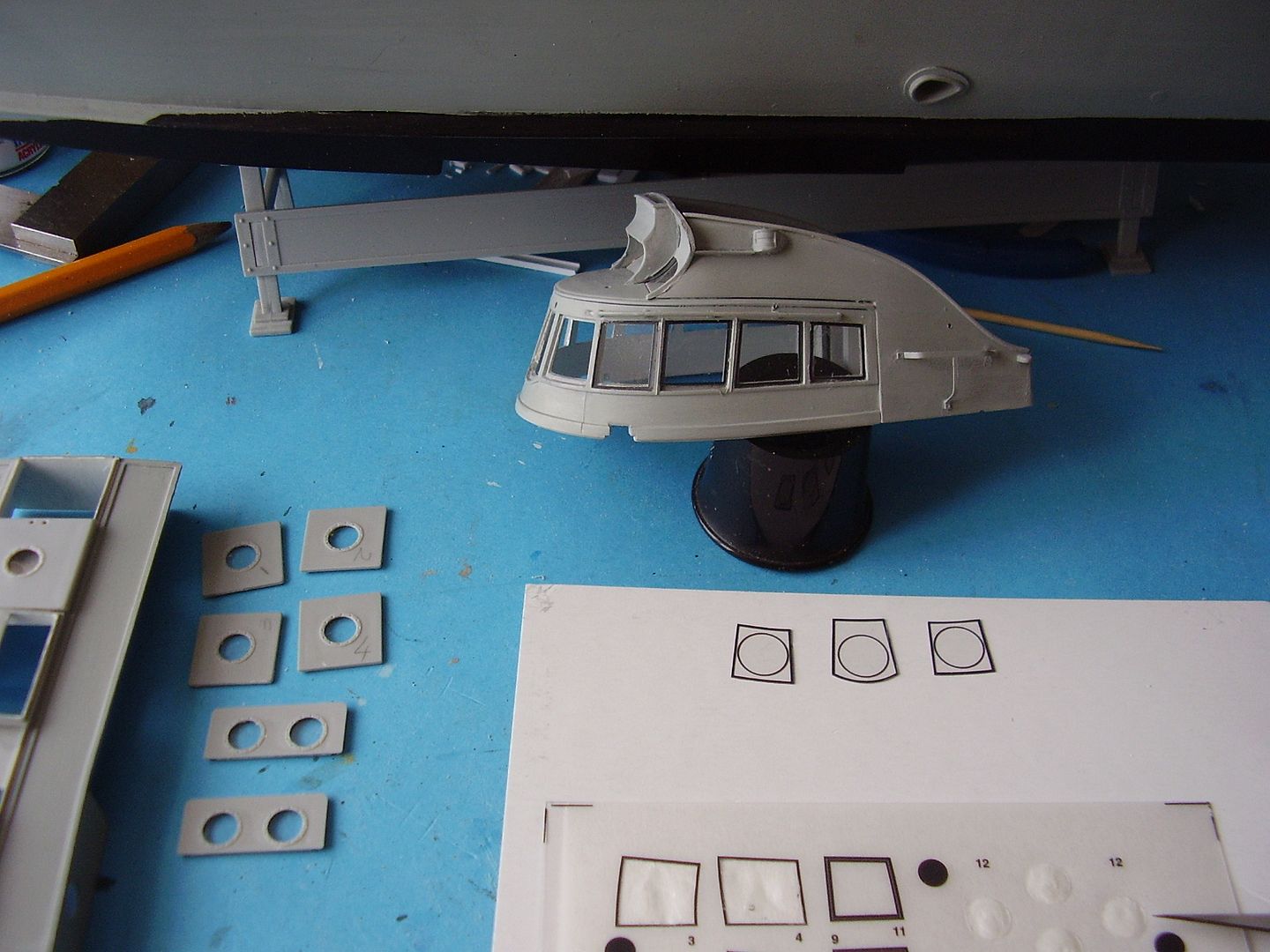

Hi folks,

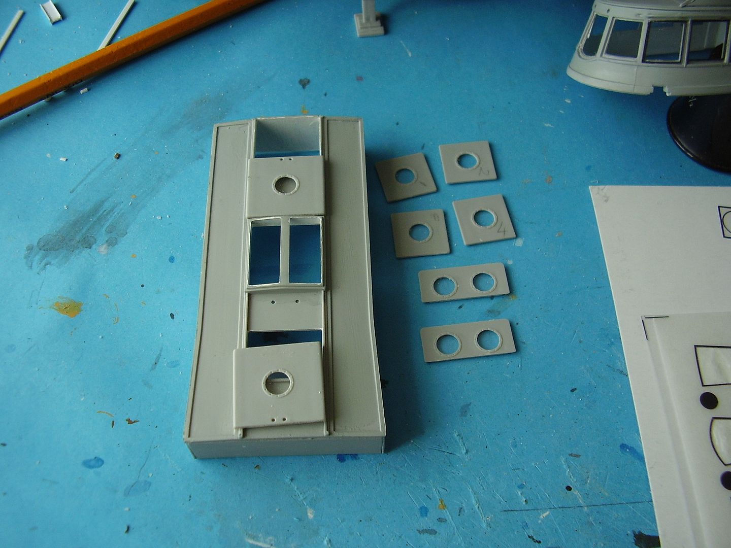

Thought I'd start and add the windows. There are quite a lot in the boat and it's the first time I've really used the Italeria clear sheets. Very impressive and easy to remove the windows.
There is some PE to add to the front three but I'm not sure how best to approach this; add the PE when the windows are flat and then add them to the boat or add the windws to the boat and then add the PE. The first option might be the best. Anyone worked with these two mediums before?
The widows come with the 'frame' on which is a nice touch.

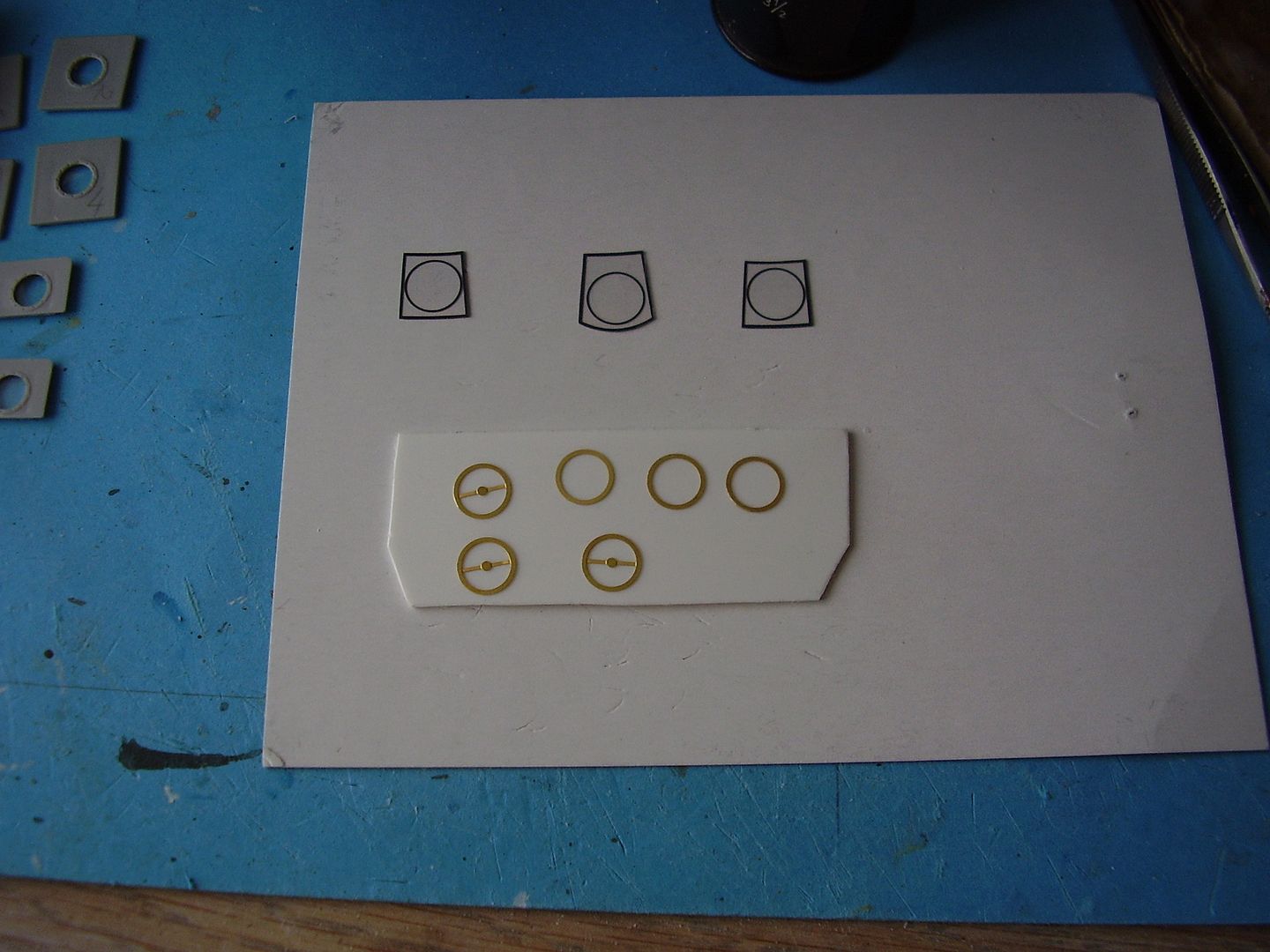

Hi folks,
These are the small PE pieces to go on the screens. Made them on the flat as that seems the best option.
Not much more to go in the interior now, getting toward time to get on with the exterior.

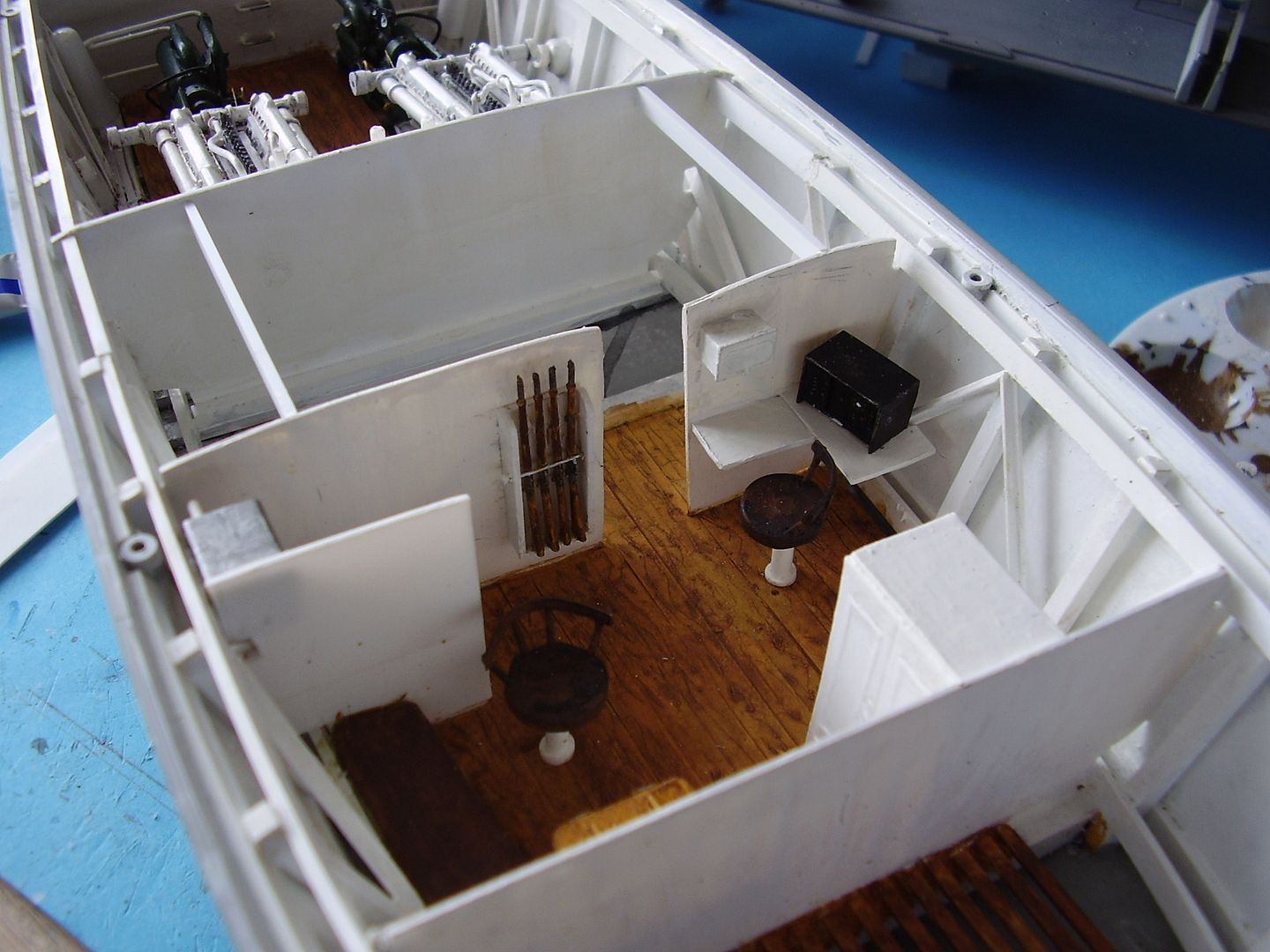

Posted: Monday, March 21, 2011 - 12:51 AM UTC
Hi folks,
Well I can see you're suitably impressed
Not much done this week, added the rifle rack and small radio. I put the rifle rack on the aft bulkhead for the simple reason the forward one will be a bit too crowded when the book shelves are added.
Some paint on the fold up table and some work on the Pipe Beds.
