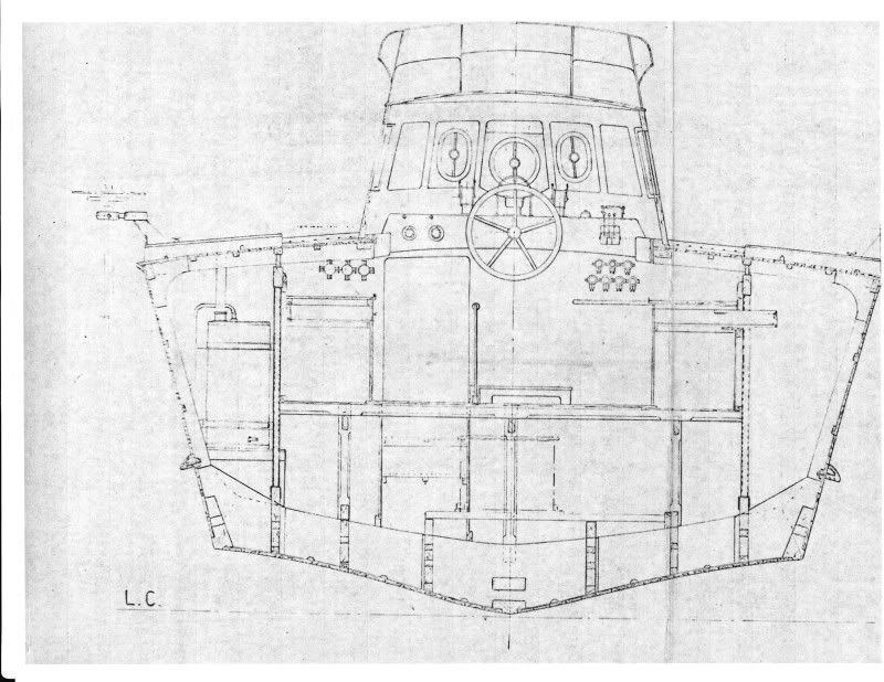

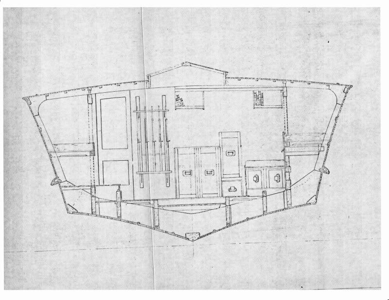

Would the internals of the cabine be in white?
Does anyone have a picture of any other parts of the internals, In thinking of what lies under the forward skylights/hatch.
White is a common interior color for small craft.
These are two sections looking forward, in the 4th series boats, from the original Baglietto plans

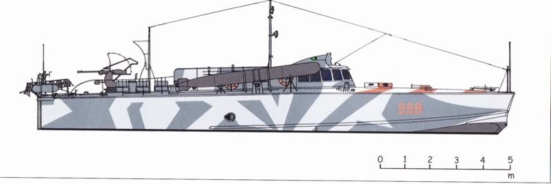

This is a color rendering from the Italian naval camo book by Bagnasco and Brescia:
The colors are representative. I don't use Tamiya colors, so can't provide any similarities. In the book, the colors are somewhat like FLOQUIL Reefer Gray and SP Lettering Gray.

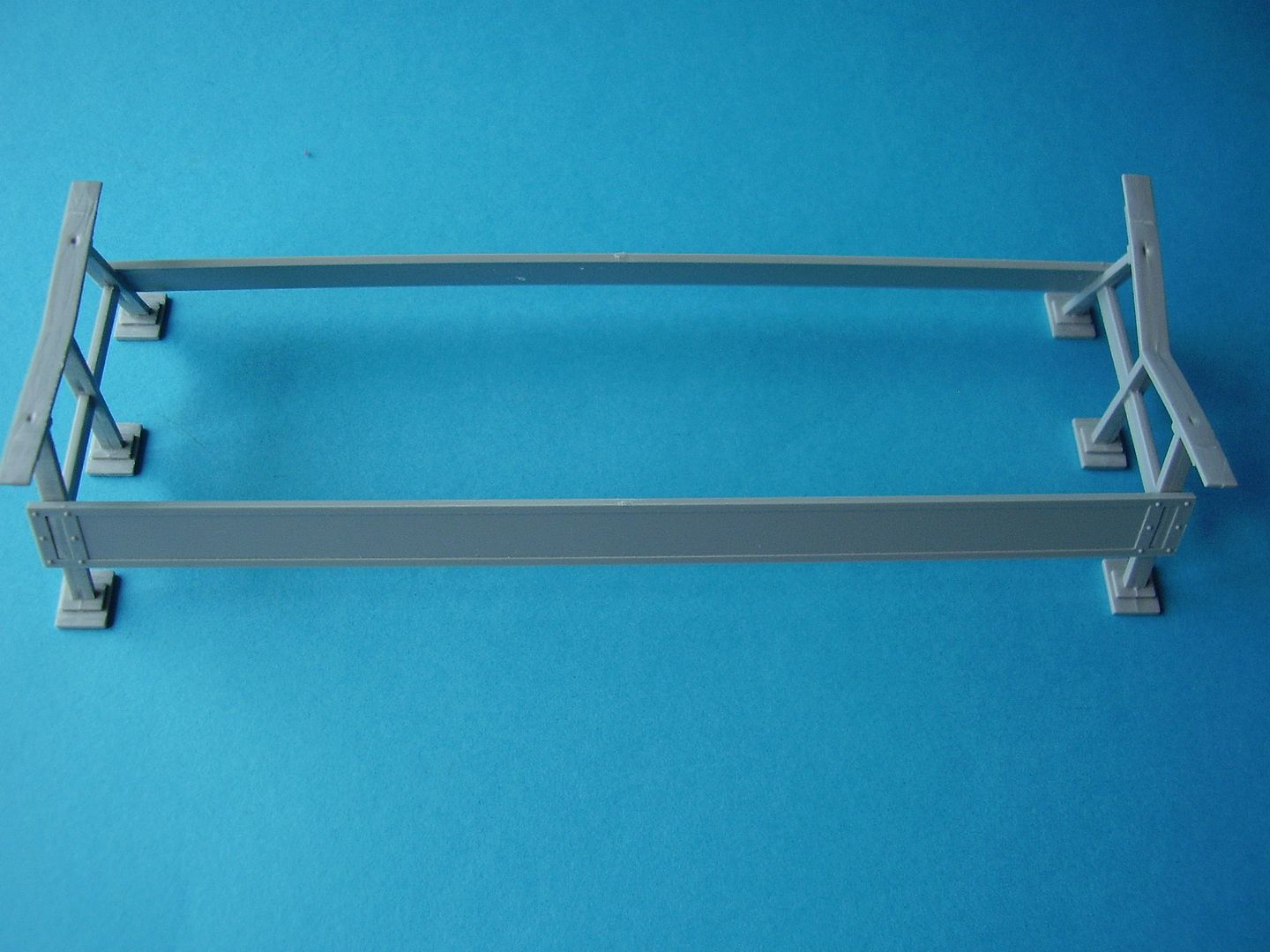

First the stand, this has some ejection marks on the inside that you might like to sand down and some seem lined to file off. A little filler will be needed here and there.
That's better things seem to be working again.

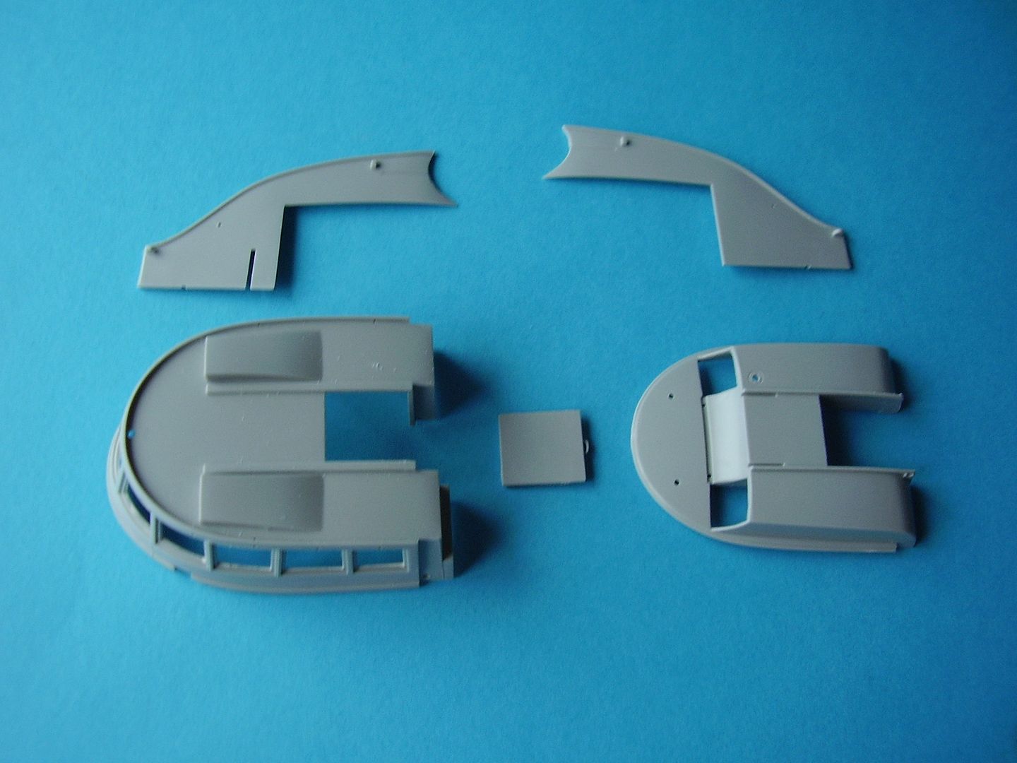

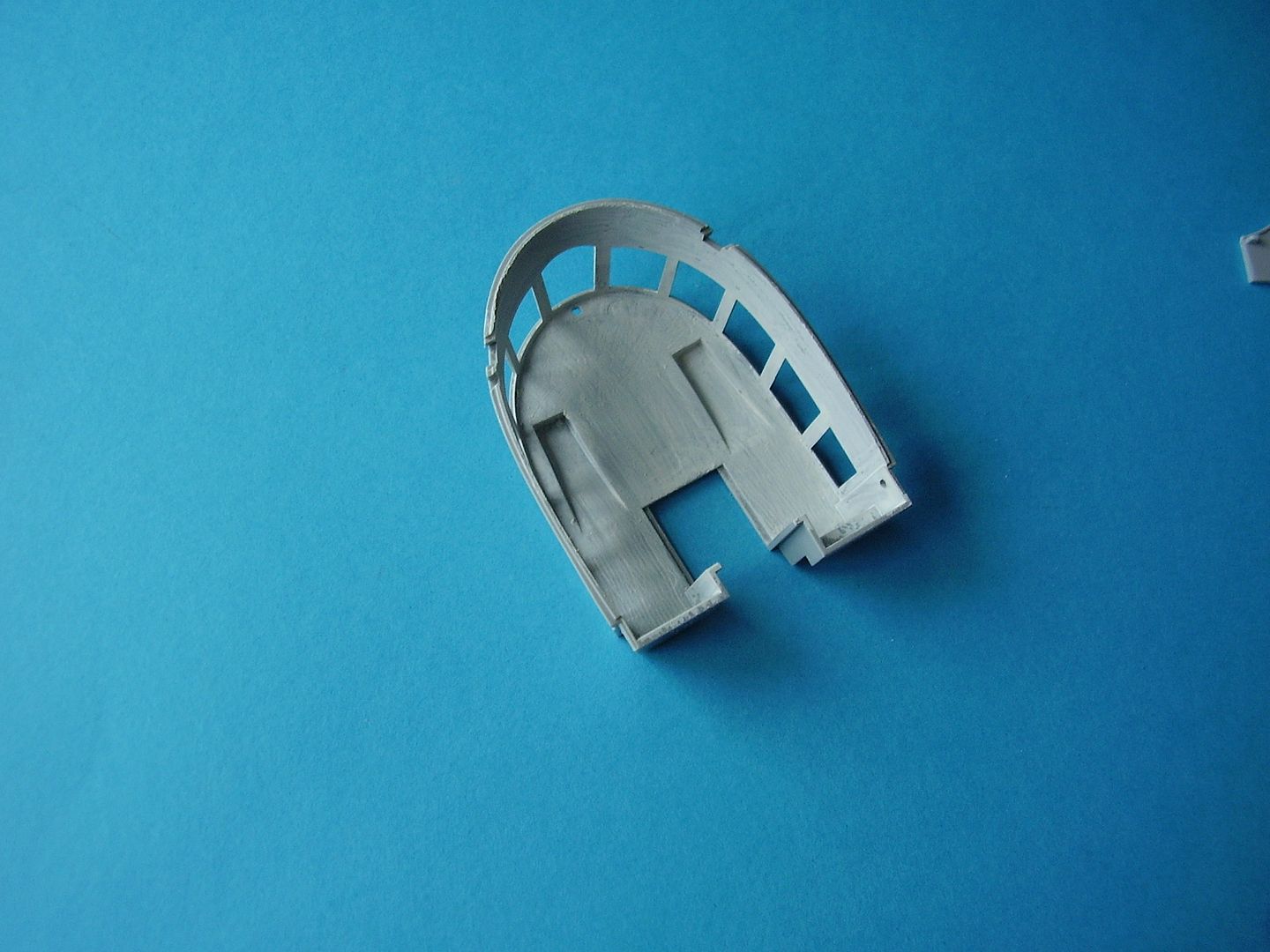

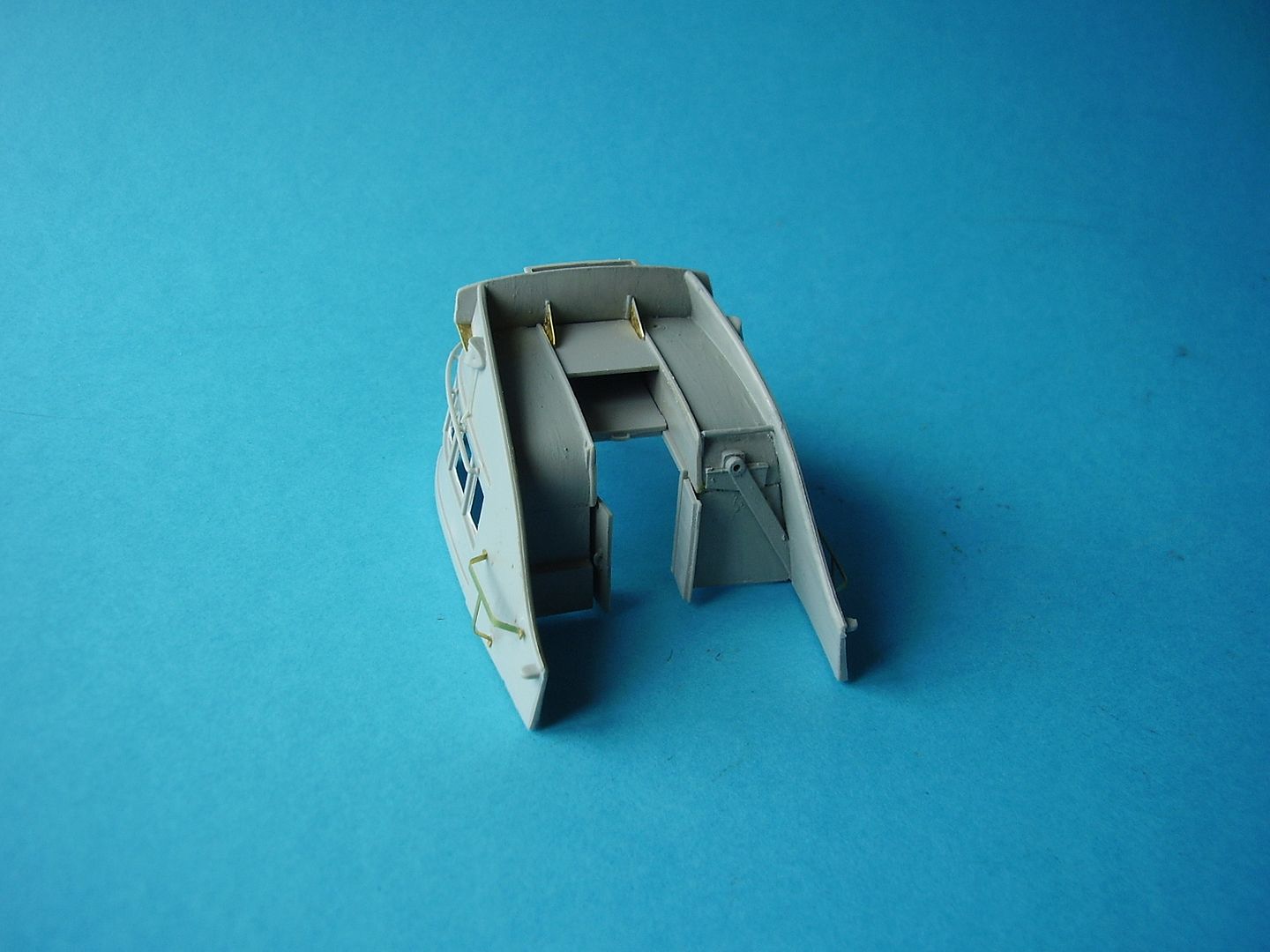

Next I looked at the cabin top. This has some ejection marks and manufactuers marks on the underside of the roof and I scrapped these off. Be careful here as the window braces are quite fragile and are easily snapped lol, lol.
Then I cleaned up some of the other main cockpit fittings. The joint between the part and the spure is quite thick so again be careful you don't twist the part when cutting it off if you know what I mean. The sliding hatch also has some ejection marks to clean off underneath.

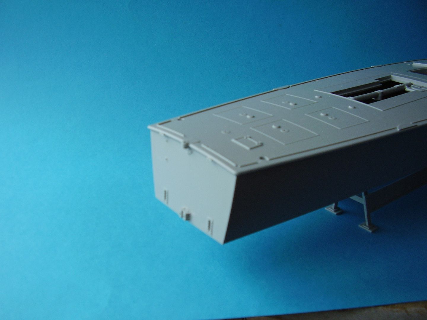

Then a dry fit.
The rear plate fits nicely with only two small joint spikes to remove.

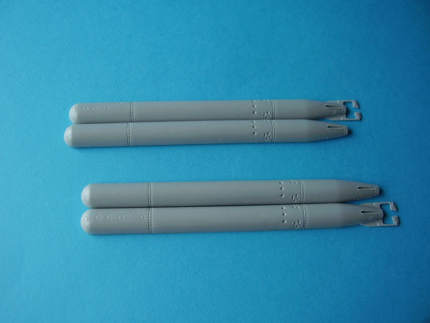

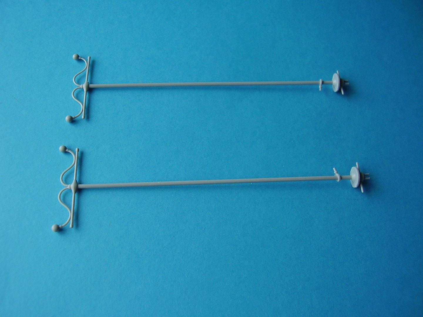

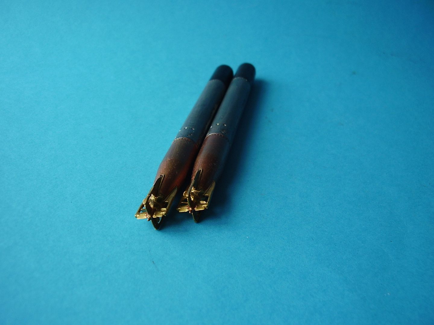

Then I cleaned up the hydrophones (?) and the torpeados.

A note on the torpedos.
Page 15 Step 26. Reverse parts 40 and 41 or part 42 won't fit.

Build note. When you add parts 2e and 3e the sides of the cabin, leave them to set fast over night, otherwise when you add part 4e which takes a bit of pressure to push into the curve you might move the previous 2 parts slightly.

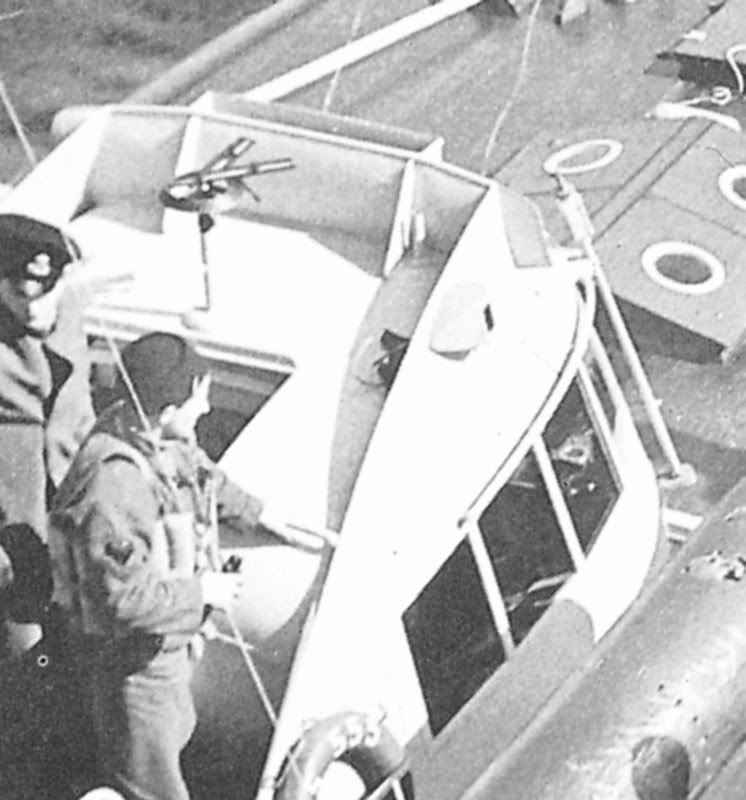

Here's another shot, identified as MAS 530 in 1941. Not sure this gives any more detail of the light, though.

I like the picture of the crewman. Would I be correct in thinking that's an open window? Interesting.

Yup, it's open. Looks like the same one on the other side is, too. Makes sense in a Mediterannean climate. If you look at the other photo on page 2, you'll see that the same window is just slightly opened. They are hinged on the aft end and fold back.

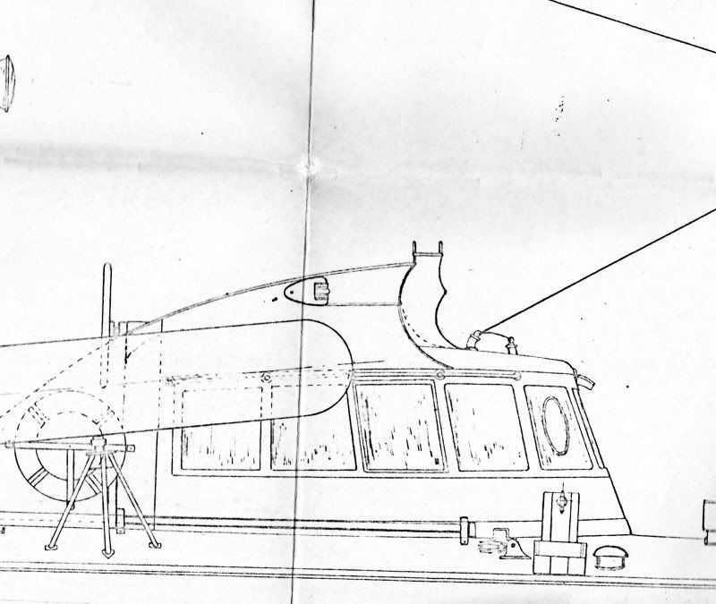

Based on photos in MAS E MEZZI... and the Baglietto drawings, the sidelights on the third, fourth, and projected fifth series boats were on the windshield:
(MAS 555)
Thus, for the wooden boats actually built, this would be MAS 555 - 576.

Thanks Al. That looks spot on for the kit. Don't see any external wiring on these either.

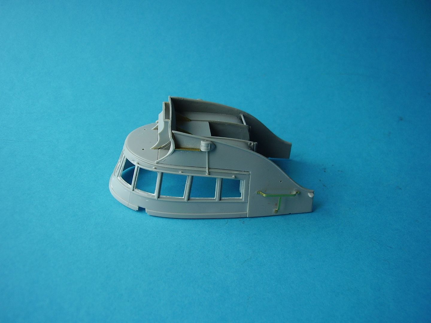

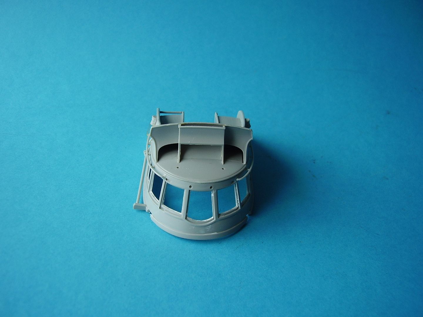

Hi Guys,

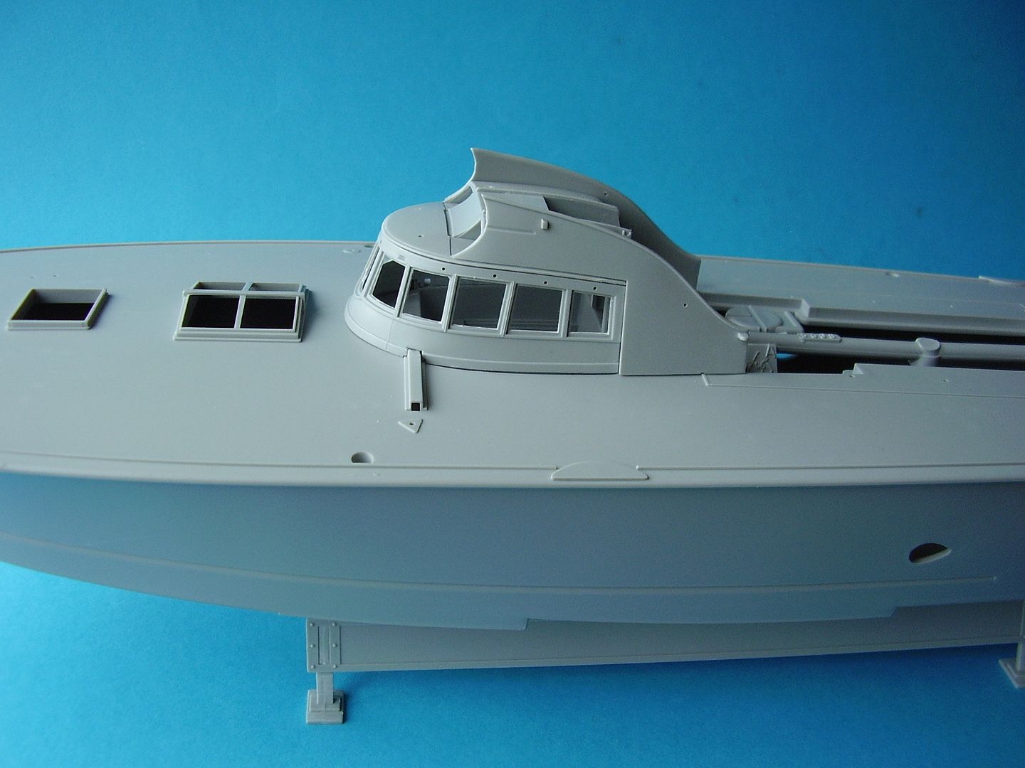

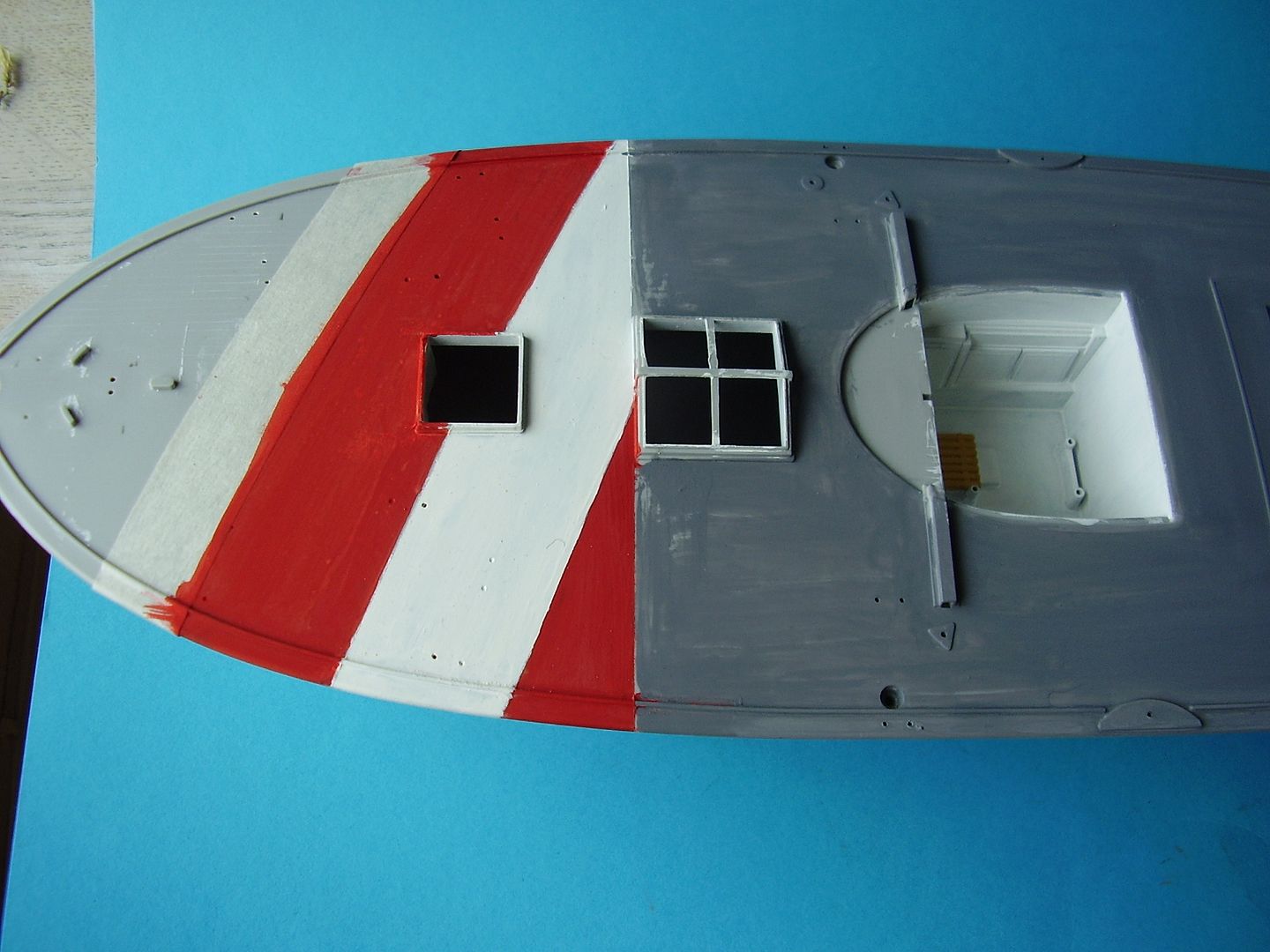

Following on form Al's excellent pics of the cabin here are some where I'm at now pics.
As you will see I had already added some wiring to the pilot lights which will need removed but that's simple. There are 3 contact points on the underside of the cabin roof and sides you may wish to fill in also.

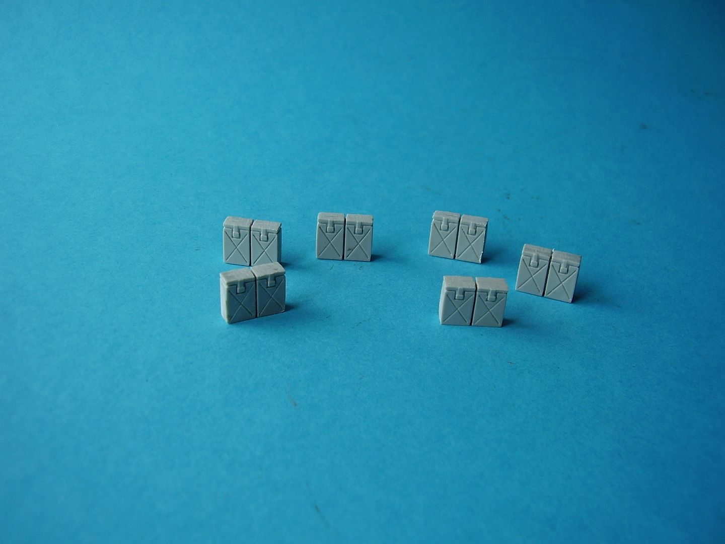

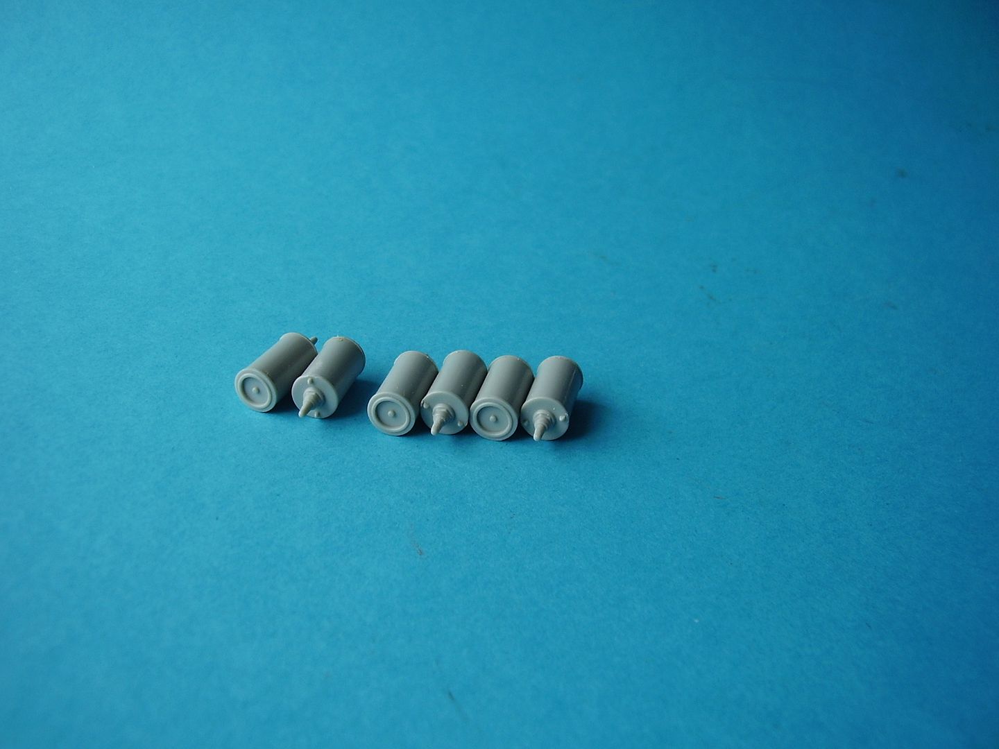

I've joined a few of the larger fittings together, depth charges, Breda ammo bins and having thought about it I decided it would be much easier to paint the the deck free from fitttings. I did experiment with doing the whole foredeck red/white but thought that might be too much so clean it off and started again opting for the alternative as outlined in the instructions.
Step 9 of the instruction show where to drill the fixture holes and there are quite a lot of them but these are indicated underneath the deck, although looking at the layout not all will be needed so don't just drill away. I've done most of the ones on the fore deck but will open them up again when I've done painting the air recognition markings.
You get a nice little jig to bend the PE fitting for the life belts on.
Things might look a bit untidy at the moment but there is a plan ?
If your leaving the cabin doors open then shave off the ejection marks, this also helps thin them down a bt.
