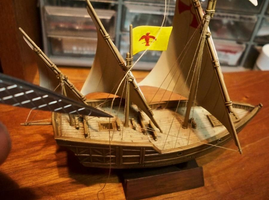

By the way, here's how a raw umber artist's oil wash looks over an acrylic tan-painted deck on my Niña build:

Hiya Jan,
Thanks for amplifying your post! AFter reading yours and Tim's responses, I remembered, too, reading about how someone took a very sharp pencil, and just used the pencil lead to highlight some deck planking details - maybe I'll go that route!

Thanks, Tim. I don't know if I'd try any paint that is oil-based, as I've been using acrylic paints on the model.
Even better - any oils you use won't attack the acrylic base paints, so if you don't like it you can just remove the wash with turpentine and try again.
Although I've found a thin oil application to be an easy and effective way to show depth, highlighting with pencil can work too.

What kind of oil? A long time ago, I used some 3-in-1 oil on the landing gear of an F4U Corsair, and managed to melt the plastic!

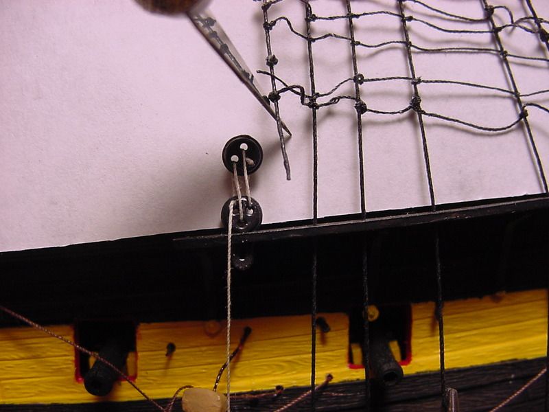

Well, I was hoping to upload a photo of my latest mistakes, but Photobucket appears to be enjoying the holiday weekend.
My mistakes? Well, I glued the first set of deadeyes on the port side inside out, and I found that the ratline was not long enough to around the upper deadeye. So the ratline problem was an easy fix; I decided to keep deadeyes installed incorrectly, because the cement was in that stage of not yet hardened, but still "gluey" enough to keep the plastic soft, and I figured if I pulled the deadeyes out, I'd just have a bigger mess on my hands. Not that it matters, of the deadeyes I've installed, they all look like crap. One problem I'm finding on the lower ratlines is that the thickness of the thread doesn't fit neatly around the deadeye; it sometimes slips off the deadeye, and the ratline shroud actually gets caught in the roving of the deadeyes. So for the last couple of deadeyes, I'm cutting off the flange that goes around the upper deadeye, so that there is a wider surface for the ratline shroud to attach to. Getting the painting on the lower foremast done; paint, dry, sand smooth, repeat.
I'll post that pic as soon as I can. (And maybe even some more!)
Update 4 July: So here's the picture:
Update 13 Jul: So, the above pic is NOT of my ship, but Photobucket is wanting me to upgrade my account so that I am able to do third party hosting. I haven't seen what kind of offer they're making.
