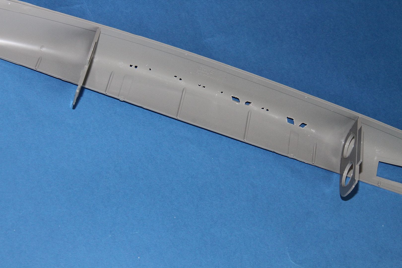

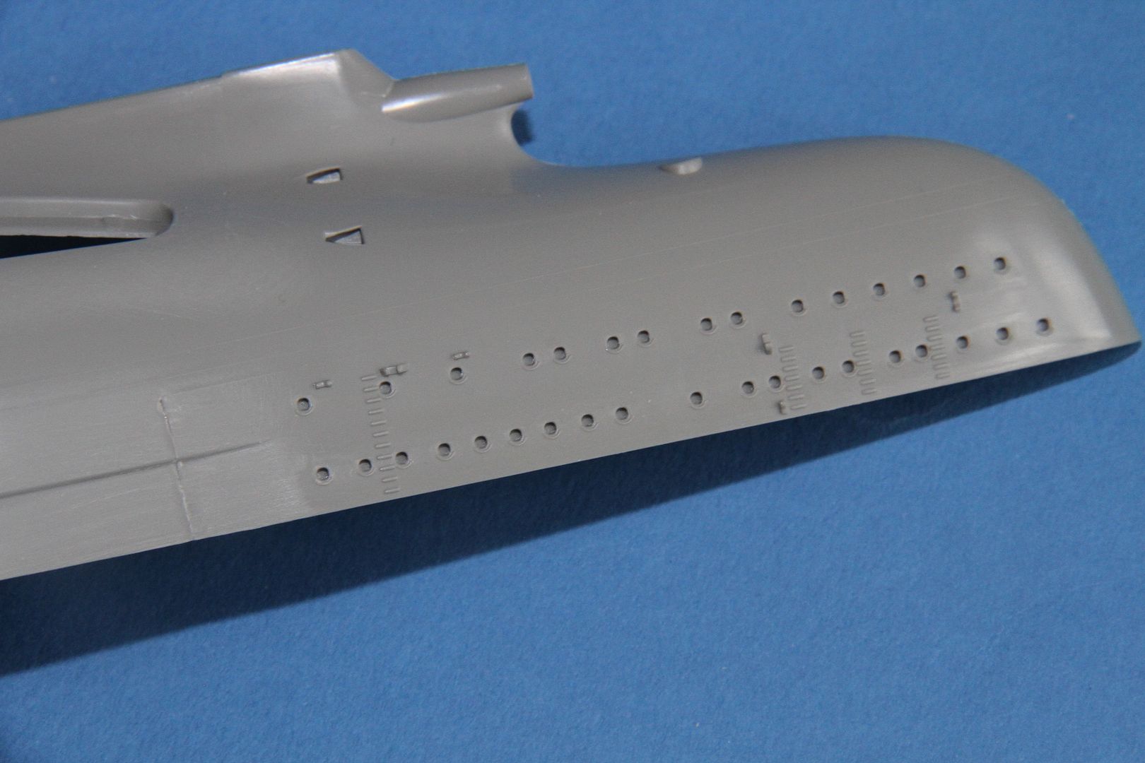

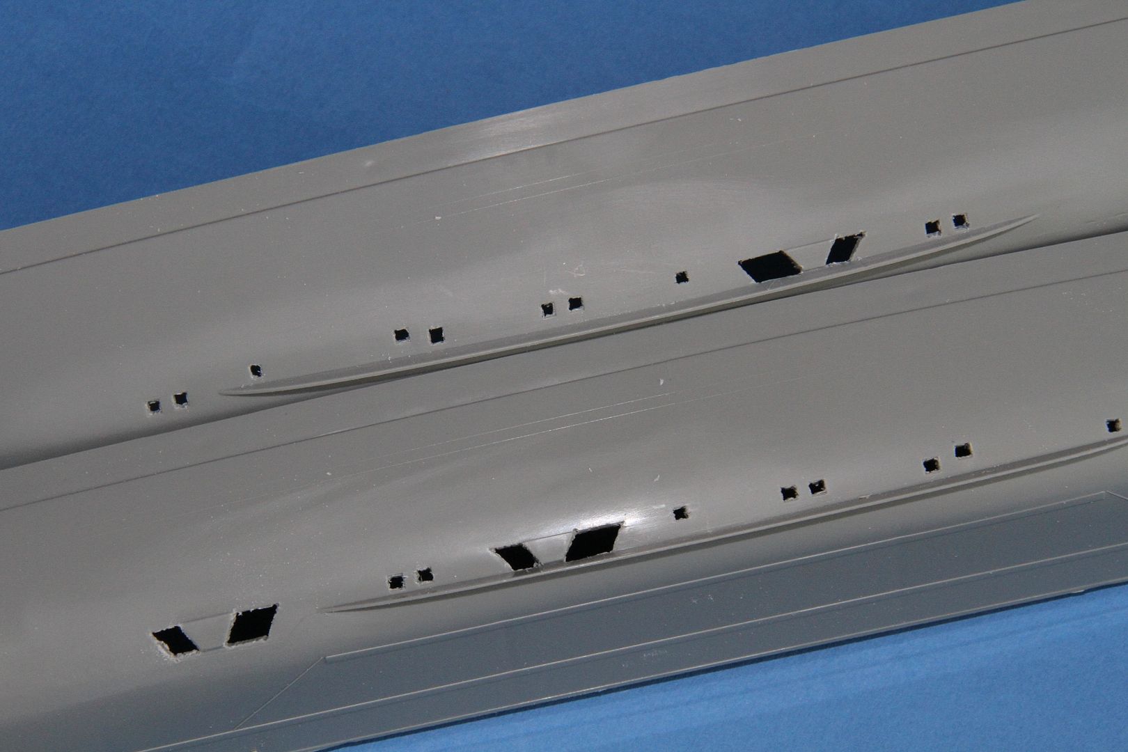

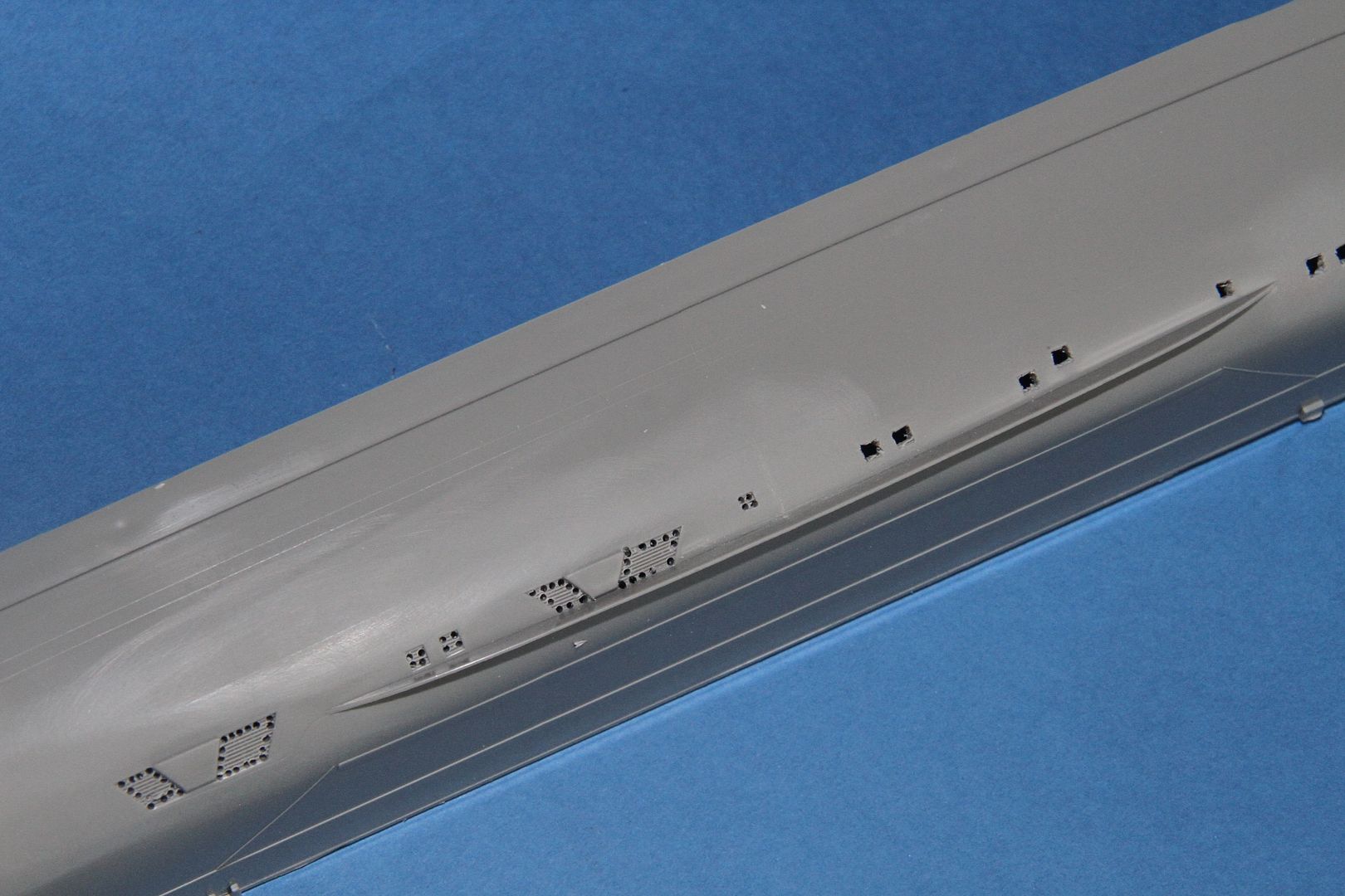

First job, cutting out the sea chest and overboard discharges to replace with Pontos etch.
Chain drilling.
Starting to cut out and clean up.
Cutting out done, and most of the cleaning.
The mounts for the screw guards and the moulded on iron ladders.

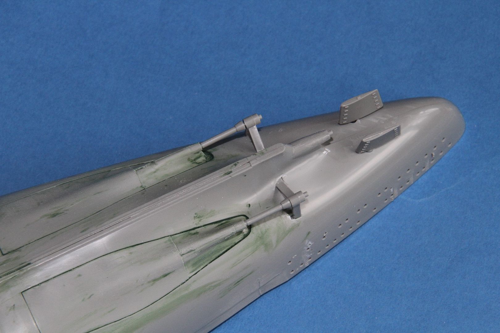

Removes, and mounts for etched replacements drilled, same on the paravene booms up for'd.

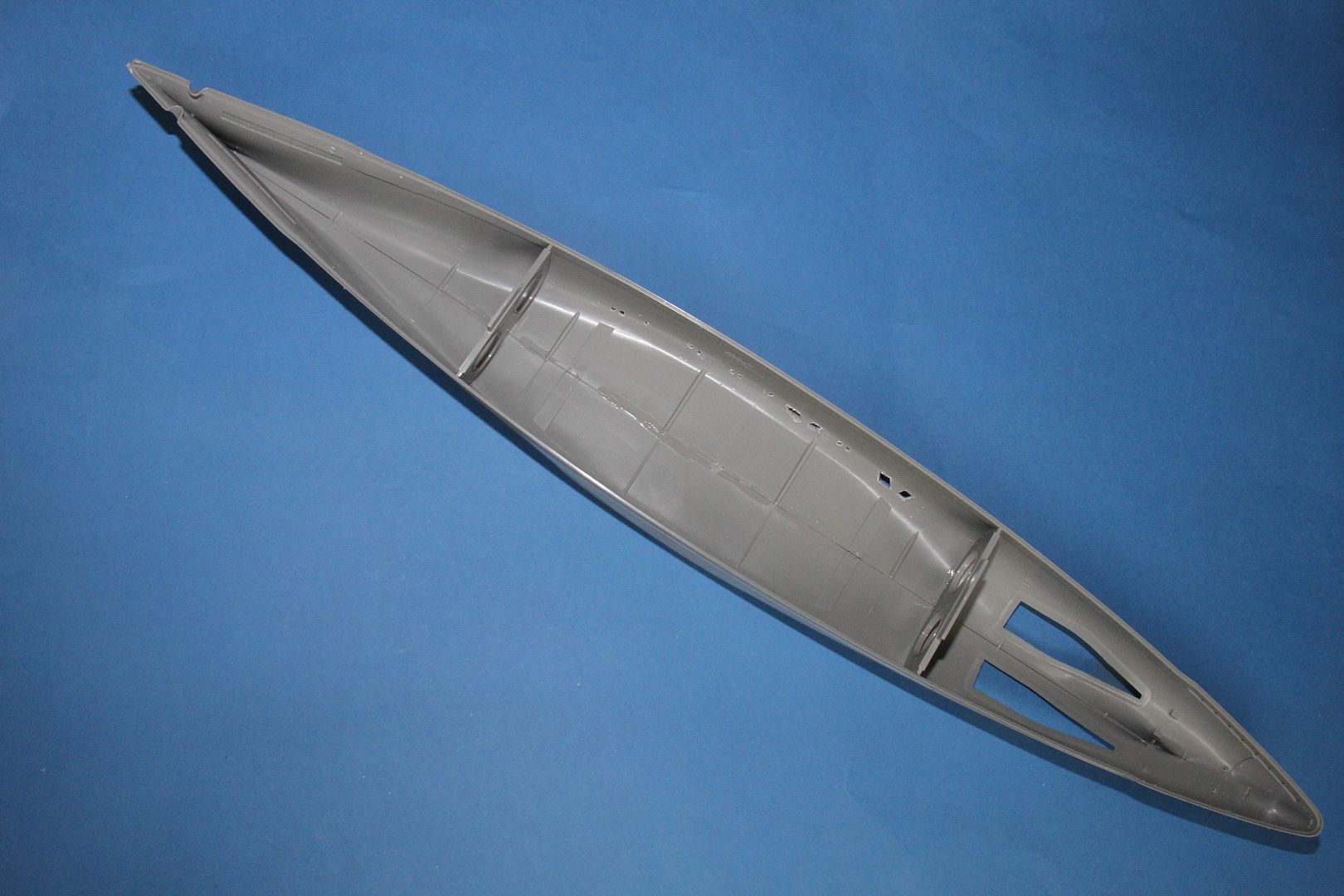

Bulkheads fitted.
Hull halves joined.

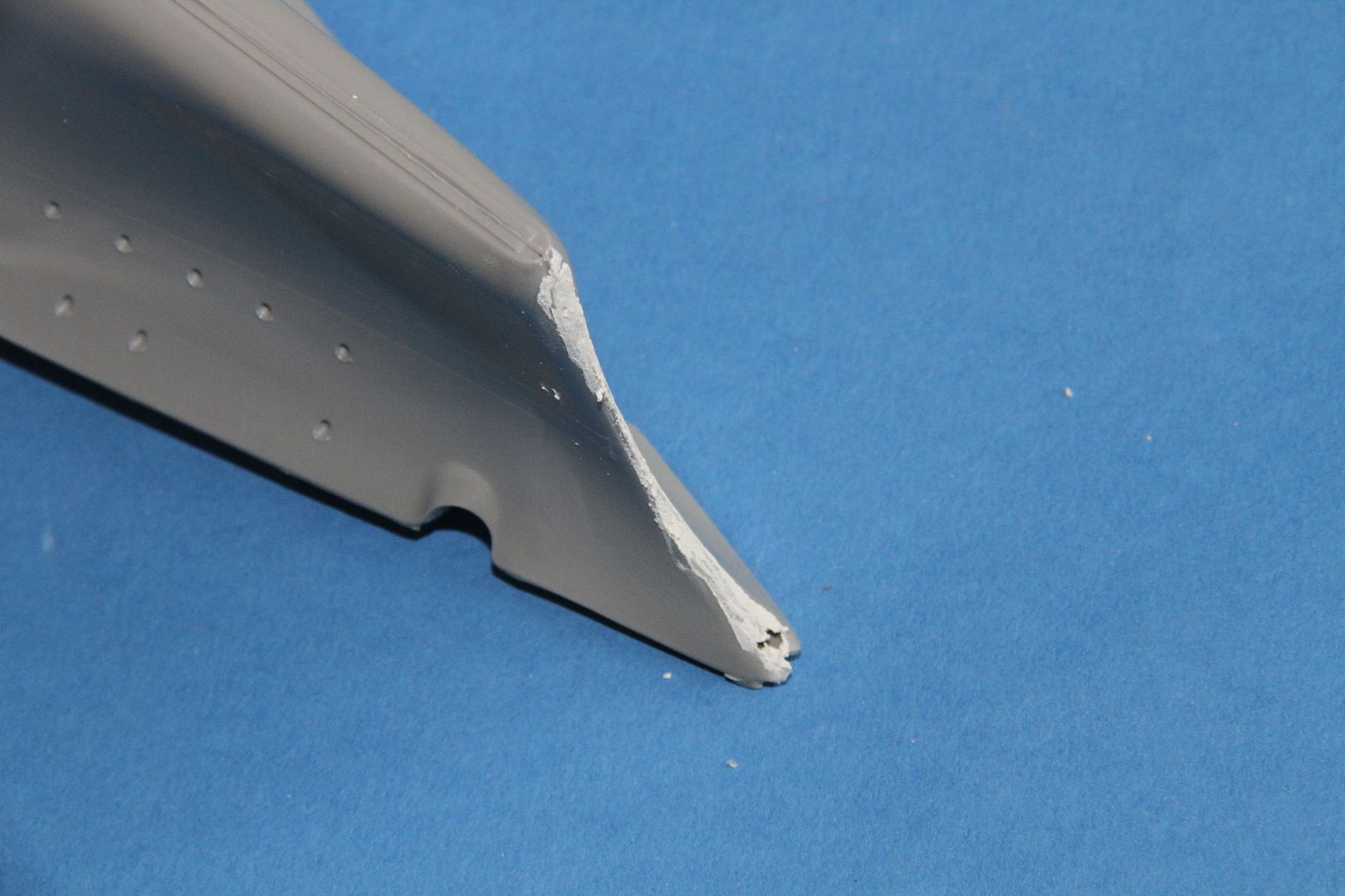

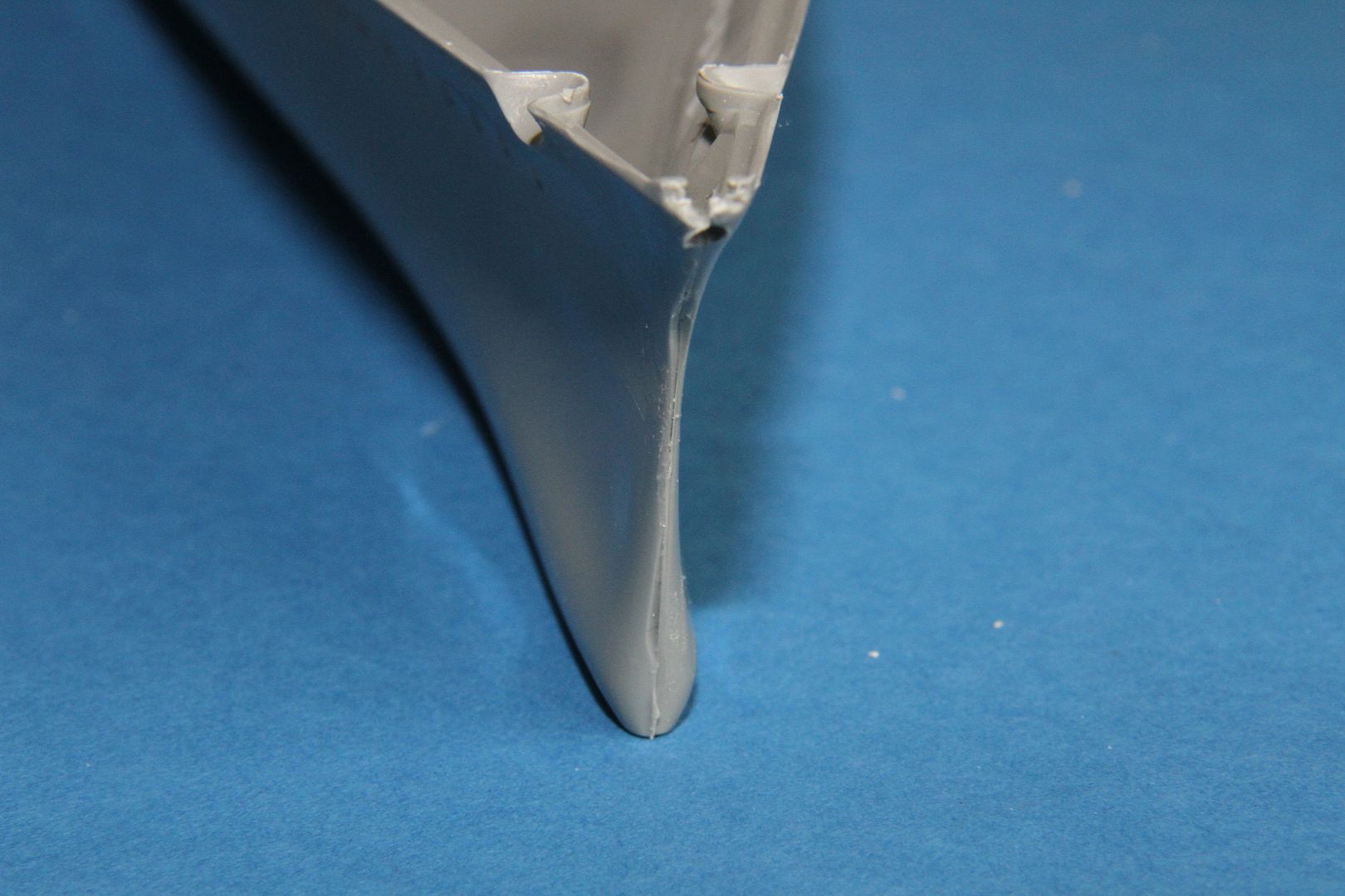

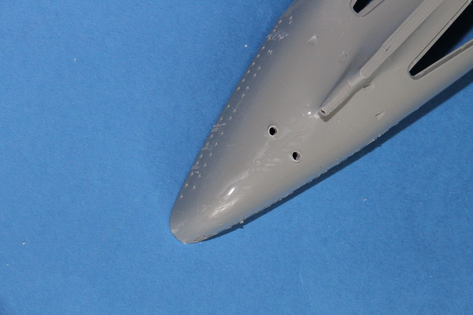

The bow needs a bit of remedial work.
Holes for the rudder posts drilled, I used 3mm as suggested, 2.5 might have been better.
Bow filled.
Shaft housing fitted, could have been better, but gaps rather than shape, so not all bad.

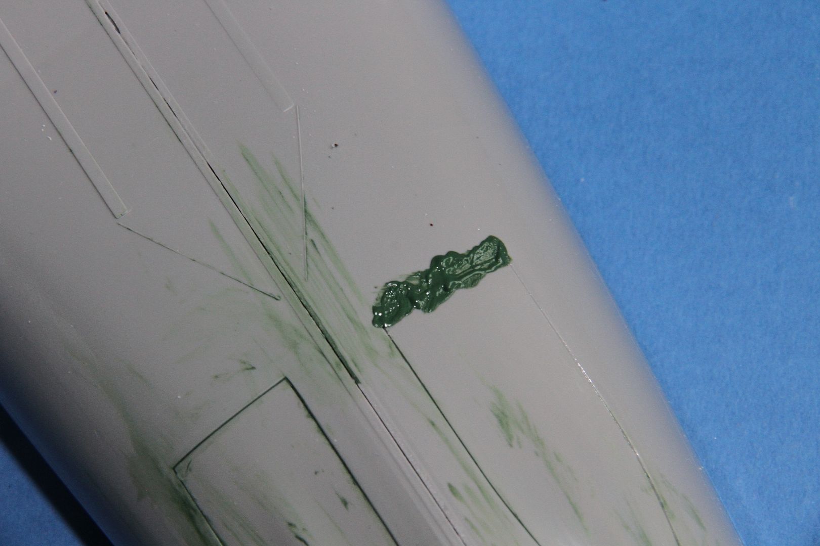

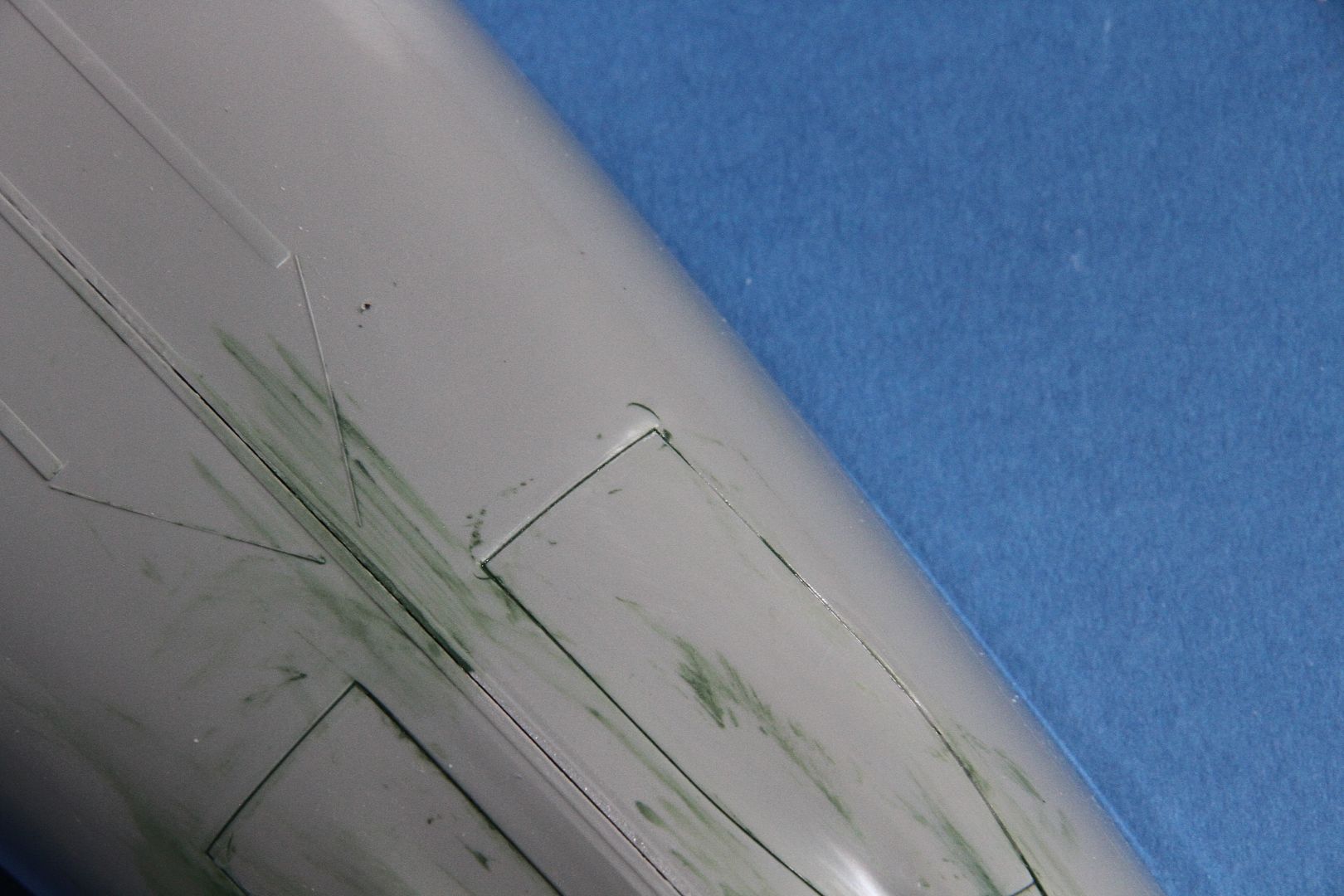

Filling, citadel liquid green stuff. a great product.
Apply with a paint brush.
Wipe with a moist paper towel, little if any sanding needed.

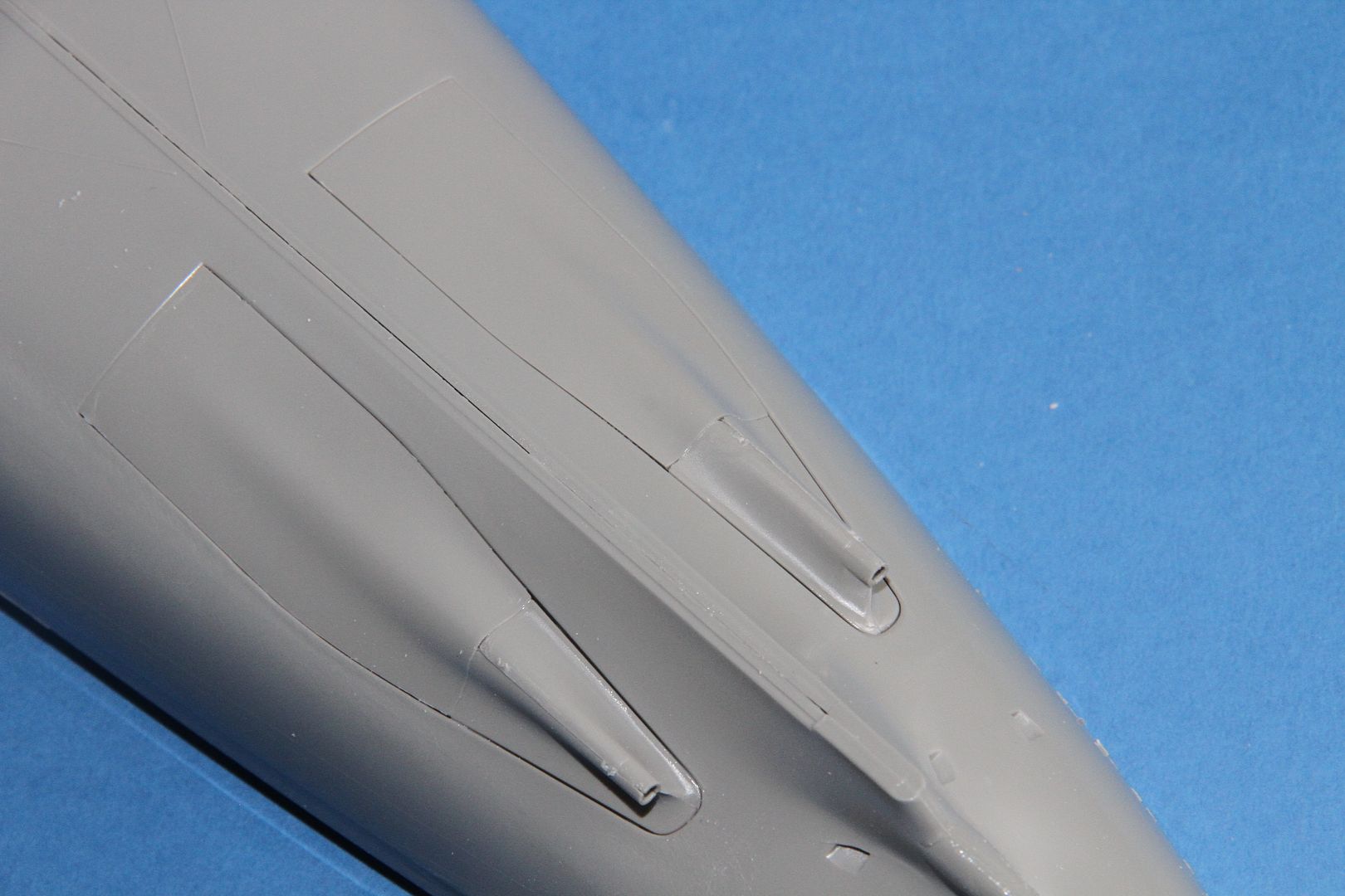

The bow done the hard way filed and sanded.
Rudders and prop shafts and brackets added.

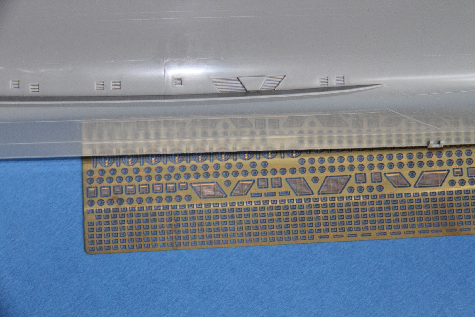

The set bears a very close resemblance to the 1/200 set, parts like the iron ladder steps and the porthole surrounds are there but not references in the instructions. (Won't stop me using them though)

Today's progress.

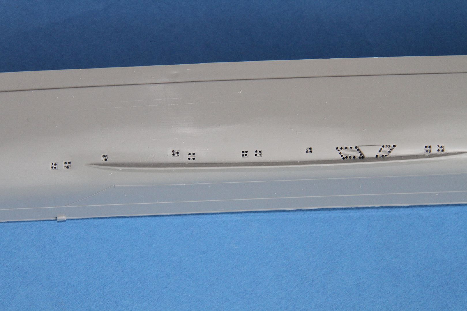

The first sea chest grill in place, very slightly recessed. Once I had cleaned up the hole to fit the grill, a little chamfer all the way round and it sat in quite neatly.
all went well til the first big grill, which whilst sorting the fit pinged. Could I find it ! Nope! so found a bit of mesh on pre used fret, cut to shape a bit of rame and job done.
The port side dome too. (didn't loose any grills this time)
Not mentioned in the instructions, but the Pontos frets contain porthole surrounds and iron ladder steps, shame not to use them.
As far as I have got, couldn't quite hit my stride this afternoon.

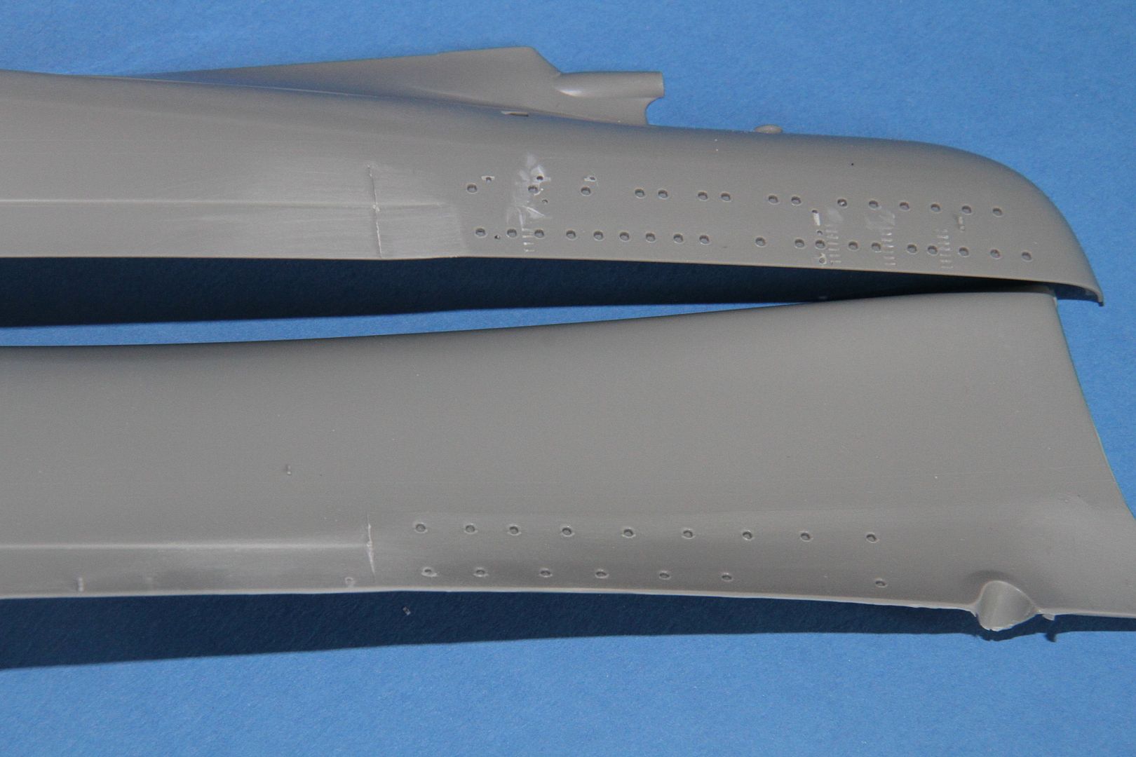

So did the destruction on maindeck. The Pontos instructions clearly show the moulded detail to be removed.

Sarry about that mate, but another 80 odd porthole surrounds and quite a few setps to go before the first coat of paint.
Also need something to blank of the back of the sea chest grills, did try with the deck in place and you can see through the big ones.
Unfortunately the missing grill catapulted into another dimension, but I did find a bit of mesh, don't know what from and cut it to fit, so no real damage done.
