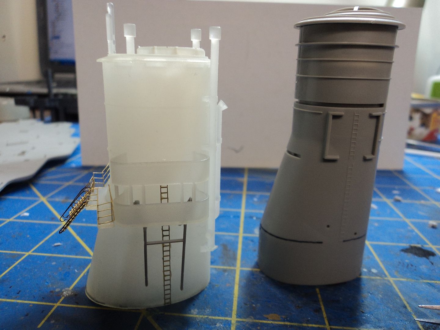

To start I ordered the 3D printed superstructure as provided by Steve "Model Monkey" Larsen through Shapeways. Steve has a catalog with all of the goodies he has designed available from Shapeways. https://www.shapeways.com/shops/Model_Monkey
Lot's of neat stuff for the Ship Modeler.

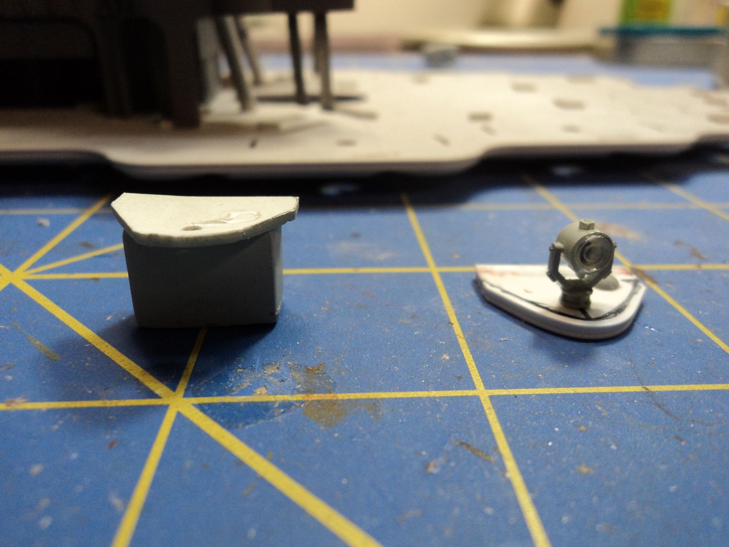

I received the Superstructure and started to fit the Trumpeter kit parts into the 3D printed part.
I had to drill holes for all of the supports, searchlights, signal lamps, as well as fabricate flag boxes, platforms, mounts and other items using the photo's from the Mare Island refit as a guide.

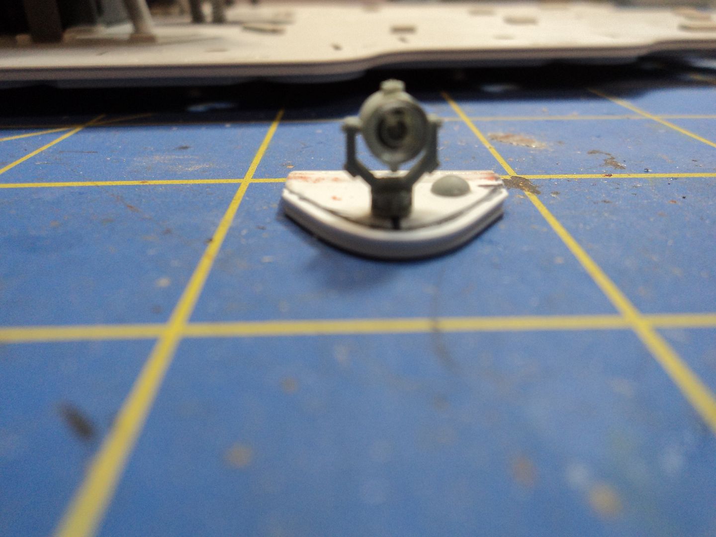

Once this was accomplished and all the PE was in place, I had to figure out where the searchlights, pelorus, and other deck fittings went, again referring to the Mare island Photo's.
I also noted that the signal platform as 3D printed represents the platform as it appeared at Mare Island. I found this out after I had it completed. In looking at various photo's that I had acquired after I had the superstructure finished I noticed that the at Pearl the signal platform was enclosed in railings not the splinter shields as molded. Oh well, a small compromise to accuracy.
In scoping out some of the photo's I could tell there was a searchlight platform aft on the air defense level.
Through the smoke and haze you can make out the searchlight platform.
Taking some artistic license and a SWAG, I came up with this
And the finished searchlight platform

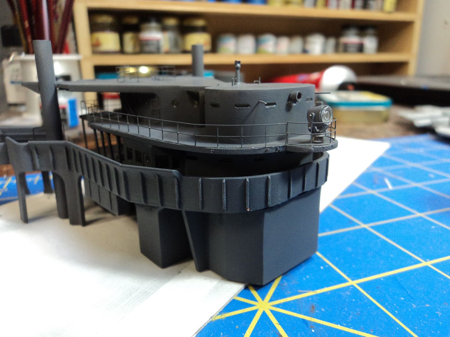

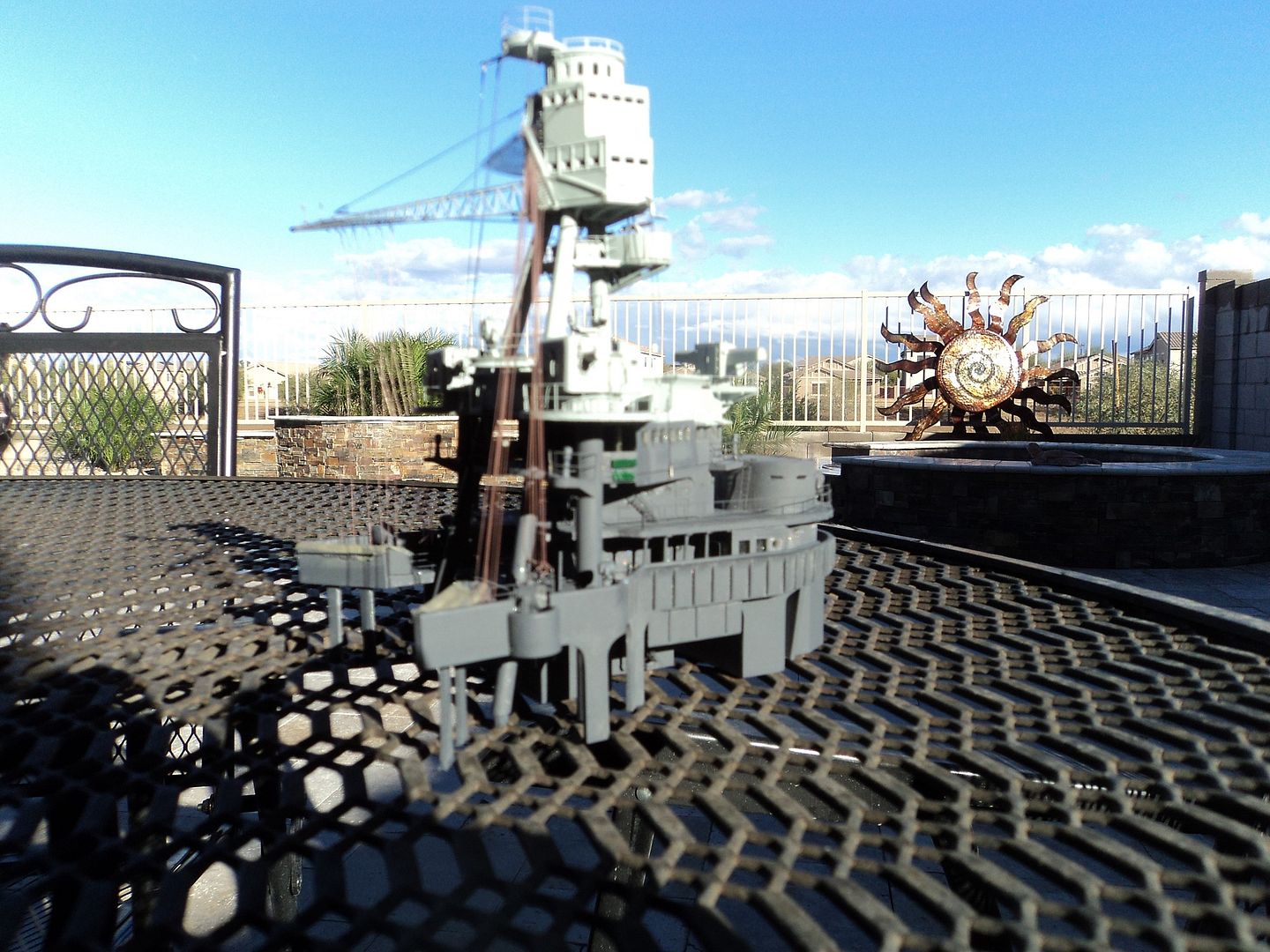

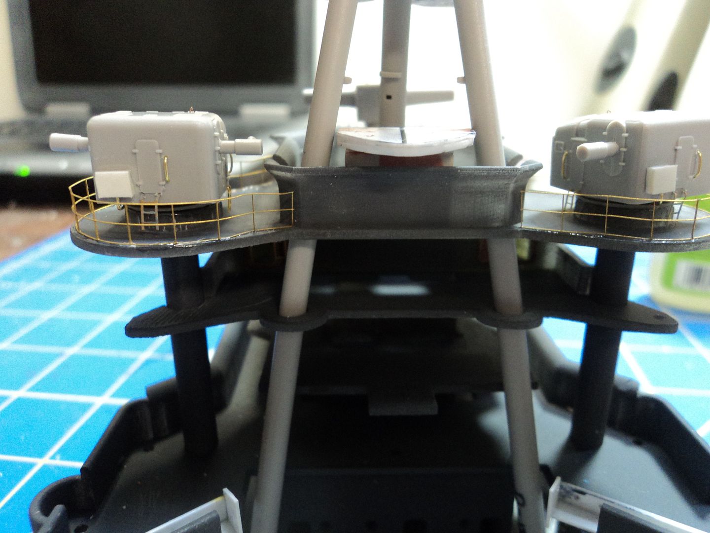

Okay, more updates. So, to back up, I had to add the stanchions that are unique the Pennsylvania.
The 3D printing process printed the supports on the underside so no guess work.
In the image below you can see the stanchions in their correct place. As this assembly went together I was able to put clear acetate behind the bridge bulkheads to simulate the windows.
In this image you can see the flag bags. I used sheet plastic, eyelets and rod for the front and back. For the searchlights and signal lamps I had to raise them a bit by putting a shim of sheet plastic between the lamp and the deck.
In this image of the armored citadel, I used a periscope off the Arizona kit, PE Railings and some ladders for access to the top. I also used brass rod for future rigging attachment points, as there were antenna trunks, antenna wires and stays all in the same area.
In this image I added Tom's Modelworks doors to the already open access ports to the super structure.

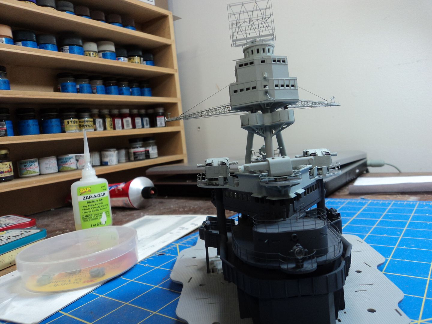

Moving up the superstructure, I wanted to get the foretop and foremast finished to assemble it as one unit. By looking at the photo of the foretop taken from a distance, the modeler can clearly see the light configuration, the CAXM radar and the attachment for the line going to the jack staff.
Working from the top down I added the light mount, the line attachment bracket, an eyelet on the top for future rigging.
Using strip plastic I added some detail along the bottom of the top and ladder rungs.
TO give the PE lattice yard something to "grab" onto, I added these bits of sheet plastic, once painted they become invisible.
Whilst forming the lattice yard, I added a bit of cut PE for a hand rail on the top portion.
Here is a view of the completed top. For the light lenses I cut the tips off the bombs that are included in the Kingfisher kit. Prior to attaching and painting I added eyelets to the underside of the yard for the halyards to slide through.
I also added some spare PE to simulate the weather vane and the anemometers that graced the outer edges of the yards.
Here is the backside. As you can see the supports pretty much disappear when painted. I added eyelets to the foretop for stay attachments and ladder rungs to the backside. They are a trick to line up.
In this view you can see the machine gun platform to better affect.

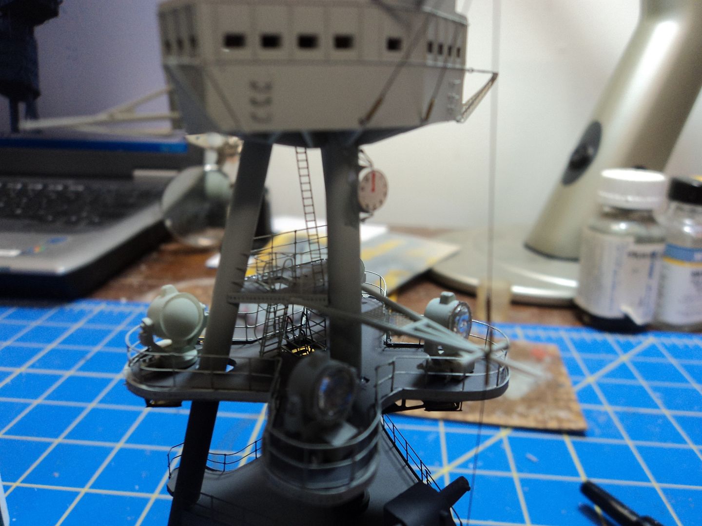

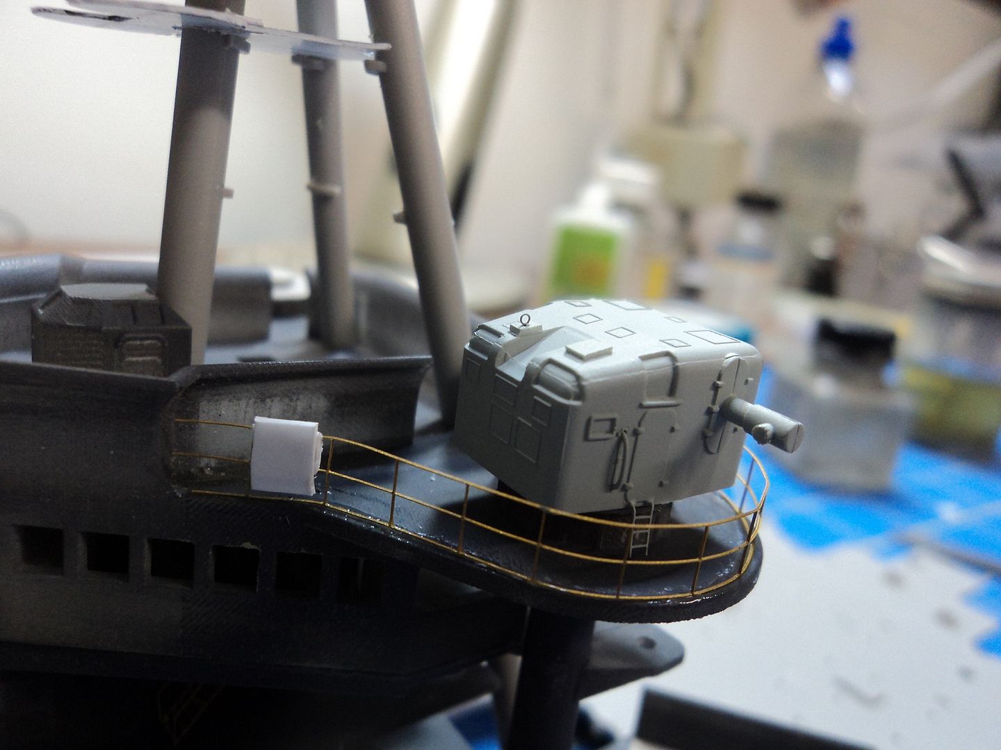

Moving on to the gun directors on the air defense platform. I added brass railings to the sides by the doors, for an electrical box I used a chunk of plastic with a brass wire for the conduit and PE ladders. I also added an eyelet to the foreward top portion. I think it was an antenna.
I also added a chunk of plastic to the railing. I am not sure what it was on the real ship but probably a junction box of some sort.
Referring back to this image you can see the platforms and ladder arrangement on the foremast.
I tried to duplicate that with sheet plastic, PE ladders and bits and bobs of plastic.
I detailed the gun directors with a wash of AK washes for ships, and a fine point sharpie for the glazing on the directors.
For the 5-D I use Tamiya XF-24. For the light grey 5-L I used a mixture to match WEM Color Coats 5-L. The Lighting gives it a more greenish cast than it shows in person.
I also added bits of fine rod to simulate the conduit and piping attached to the legs.

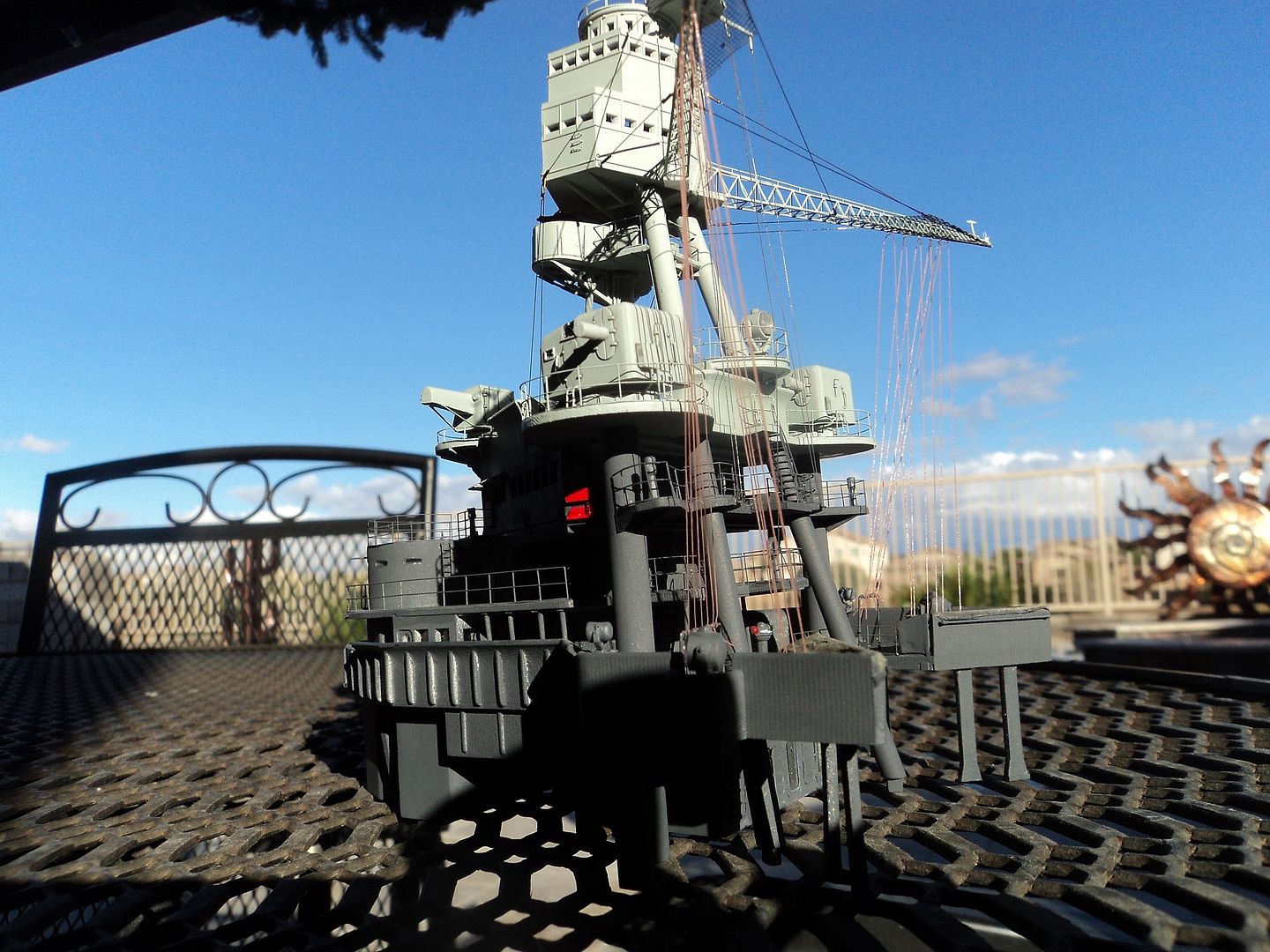

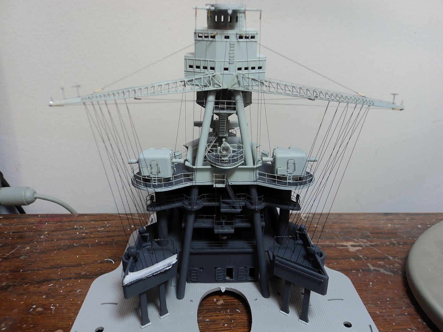

Below is the completed superstructure/foremast assembly. For Rigging I used Model Kasten .06 stretch thread available from Sprue Brothers.
A word of caution here. I use Tamiya acrylics thinned with Methyl Ethyl Ketone (MEK) I had no idea of the long term affect this stuff has.
When I unpacked this in November after sitting in a warehouse since July this is what I saw:
I was upset:
The 3D printed plastic doesn't like MEK. So I gave it a wash with a brush thinned with laquer thinner and the crystals seemed to disappear.
I also had this to deal with:
I had used Gator GLue, a white glue designed for PE, well, it doesn't work if there is tension applied as in the case of the Lattice yards. So, off came all the rigging and clean up.
I used new Lattice yards that I got from a buddy and used tan EZ line. It isn't what I was looking for, but it shows up and the halyards were a tan color not black, so I am content with it and happy with the way it turned. The CAXM radar was just sitting on the top for affect, it survived intact. At this juncture I also added the yard arm safety netting. This is fine brass mesh cut to shape, given a wash of black and carefully glued with Testors Canopy Cement and placed into place.
The Next area I addressed was the cranes. The Pennsylvania cranes are totally different from Arizona. Haply, Steve Larsen designed a set for the Pennsylvania.
Below is a shot from Mare Island
and Pearl Harbor
When Compared to Arizona, the difference is dramatic: Compare to this photo of Arizona at Puget Sound in January 1941.
Using the Shapeways 3D printed cranes and parts off the Eudard PE for the Arizona, a Pennsylvania crane can be built. I added some eyelets for rigging and PE Ladders.
So Folks. That's it for now.

In the Photo below you can see the grey scheme of the kingfisher on the #3 turret cat. The guns are definately in 5-D. The 7 Chiefs are quite striking.
This one below is off the USS Maryland about mid 1941
My Kingfishers on #3 turret.
I got a little impatient and put the completed subassemblies on the hull to get an idea of how it all will look.
More to come.

Another area of difference is the stack. Again, Steve Larsen designed the stack for the Pennsylvania. Some mods needed to be done to the boat deck as the stack was designed from the boat deck up, whereas the kit stack is designed to go through the boat deck and attach to the 02 level.
So, first order of business is to fill the hole for the stack
and then move on to the stack itself.
As you can see there is quite a difference in the shape.
Using kit PE I put in the exhaust deflectors.
And added bits and bobs to the stack.
There isn't a lot of photo's of the stack, but this one shows some details such as the "bottle cap" helmets and what looks like storage boxes.
Using chunks of plastic I added these to the stack. I think it turned out alright.
One of the other things that was involved was moving the exhaust chimney for the incinerator. You can see the incinerator chimney on the stack. I added a handle to the door of the incinerator using the kit part.

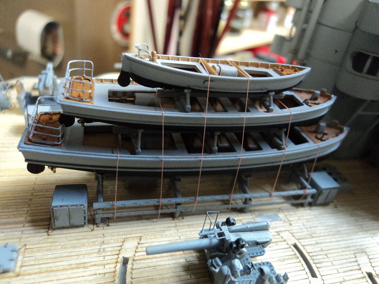

Moving on I assembled the boats. Pennsylvania had 6 of the "Captains" gigs. I had some spares from an "Extra" Arizona kit. The boats were assembled per kit, drilled out the portholes and using the Eduard and the MKI set I added PE Details.
Eduard provides interiors for the boats, but as it is for the Arizona kit, only 4 are provided. Sadly, the MKI doesn't provide interiors, so the two extra boats will be sandwiched in the middle.
For my Arizona model I assembled the Eduard PE Boat Cradles, but the stanchions didn't line up as you can see here:
I liked the added detail of the Eduard PE set, but not the way it fit, so..........I cut out the side panels and added them to the kit plastic boat cradles. I thought it was a satisfactory compromise.
And now the cradles will fit into the holes nicely without any added filling.
For the whale boats I used spare deck material for the bottoms of the boats.
I thought it gave the boats a nice touch. As they will be cradled, not a lot will be seen, but it's enough to be noticed.

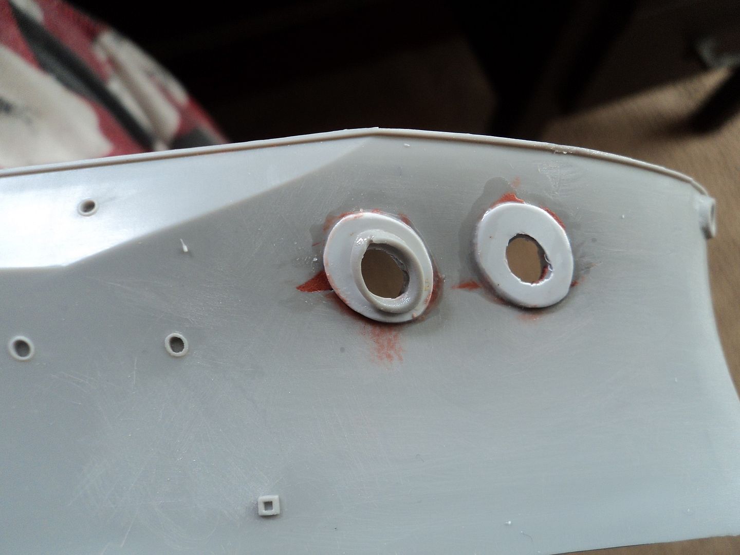

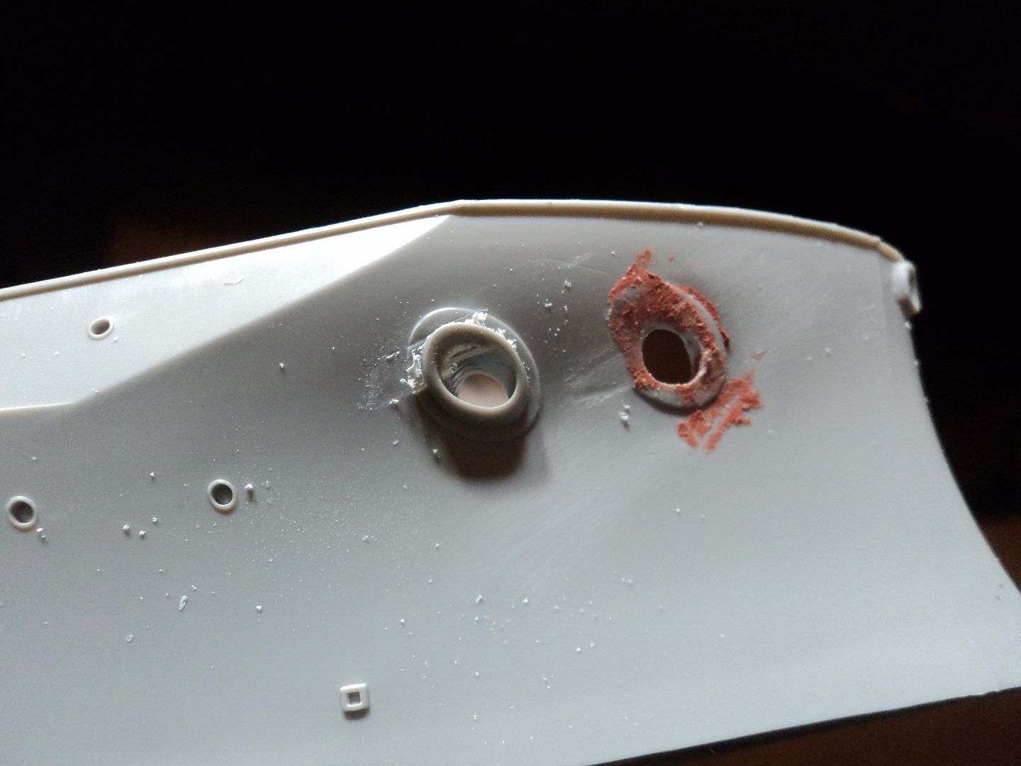

The next phase is on to the hull and that is where I am at now. I am presently travailing over the added armor belt and the unique "notch" as it ends aft. So far......ahhh.
The anchor hawses are molded upside down, so had to be cut off.
It looks rough now, but once blended, painted and with the anchors in place, it looks pretty good.

Moving on the cranes, yes even the aircraft handling crane is slightly different on Pennsylvania than on Arizona. Using the PE from the MKI set and remnants from the kit part, I assembled the crane.
The photo below shows to good effect the Pennsylvania crane, it had a third wheel as seen here.
So finding a spare wheel on the PE sheets, I added the wheel to the crane.
What is nice about the MKI set, it provides the internal bracing for the crane, whereas Eduard, WEM do not.
For rigging I used the Modelkasten line and Bob's Buckles tubes.
And the finished Crane

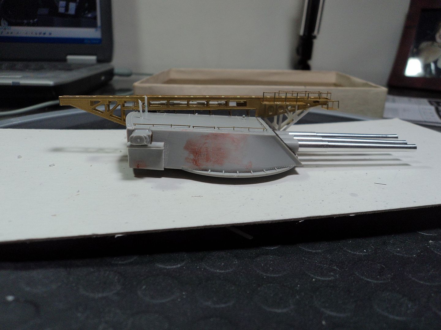

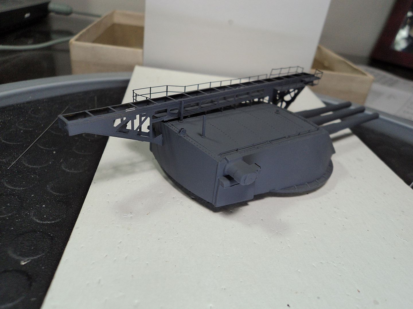

Yet another difference I unearthed was the catapult on number 3 turret.
In this image you can see a lot of structure on the glacis plate of the turret.
And in this one from the 30's a better view from the aft end also showing the work wasn't done at Mare Island.
So using the MKI Catapult I added the struture using bits of plastic strip.
Much debate has ensued regarding the color of the top of the #3 turret both on Arizona and Pennsylvania, I opted for the overall dark grey/non skid option.
Stay tuned for more modeling excitement.
