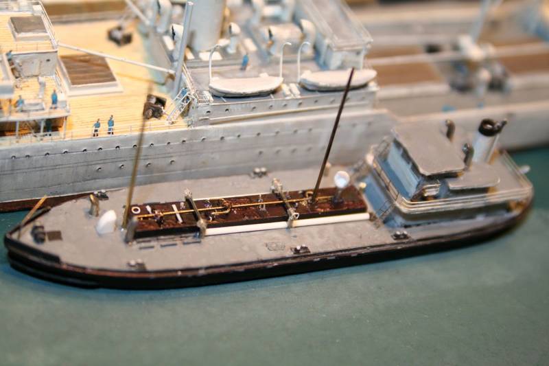

At this stage the BFM tugboats arrived, along with an oiler and a garbage vessel… these were mini-projects within themselves. The oiler had some alterations carried out to make it look like an older variant; pipe-work was added, as well as valve wheels, along with the very sturdy masts, used, I surmised, for hoisting the heavy oil delivery pipes.
