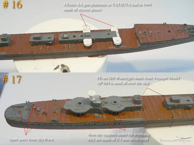

Nice looking build!  I also like less-famous ships so it's good to see something similar.  I enjoyed the steps of your build article- always interesting to see another person's work ethic.
For future builds, if you want smaller anchor chain, Lion Roar makes a nice photo etch set, and hobby anchor chain can be purchased in 40 links per inch, which is perfect in size for 1/700.
