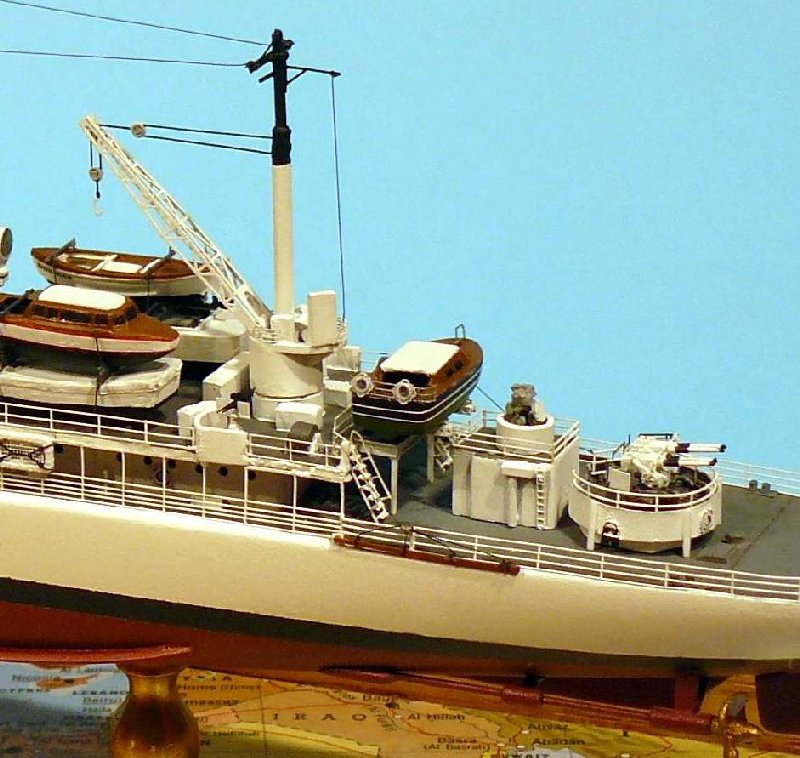

Some of the after market pieces that I used were the radar (L’Arsenal), the floater net baskets (L'Arsenal), the life rafts (L'Arsenal), the whale boat (L'Arsenal), the 40mm and 20mm guns (L'Arsenal and Tom's Modelworks). The Mk52 gun directors were specially molded for me by ISW. The railings are from ISW and GMM.

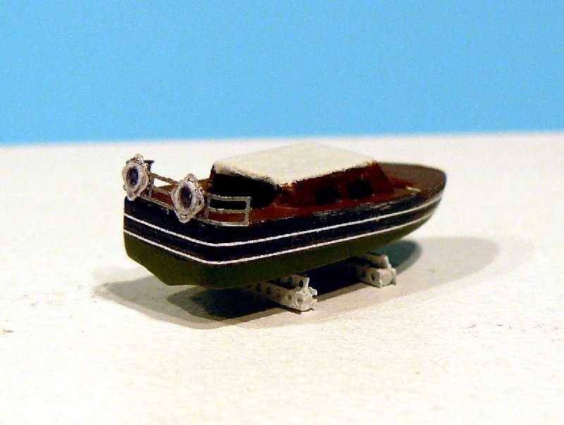

The admiral's barge came from an old broken DRAGON Ticonderoga CG kit and the captain's gig is from an old broken REVELL USS Pine Island seaplane tender model. I drilled out and carved open the rear seating area and the coxswain’s cockpit in the bow on the admiral’s barge. I painted it to replicate the barge that my father had taken pictures of.
I made my own decals for the stern ship's name and the "Dux-Bay" decals on the small boats.
I made and rigged small boat handling booms, port and starboard, and added an aviation fuel supply pipe to the aft starboard hull.
I added torpedo handling booms and a scratch built winch forward of the pilot house. The torpedo loading hatch in the deck behind the forward Quad 40mm was already molded into the deck.
For the rigging lines, I used two-pound test monofilament fishing line for the mainstays and backstays; and invisible thread for the halyards.
