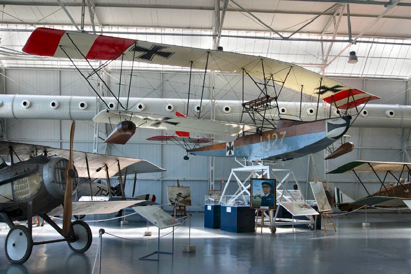

A restored example of an Austro-Hungarian Lohner L (serial L.127) is preserved at the Italian Air Force Museum at Vigna di Valle.

The wing struts are contrail brand strut stock cut and trimmed to specs. The rigging is my lovely wife’s hair, which she kindly donated for this project (and all my others too!). The center section of the top wing was scribed using an Exacto knife, and clasps were added using Evergreen stock.
The engine started as a spare in the Roden Fokker D.VII kit and was detailed as follows:
i.) Ignition wiring harness-PART photo etch
ii.) Exhaust pipes-Florist wire
iii.) Pushrods-stretched sprue
iv.) Oil Reservoir-sprue filed to shape with a rod cap and stretched sprue straps added
vi.) Radiator-came with the kit
vii.) Propeller- I used wooden strips ...some were soaked overnight in woodstain.These were sandwiched together when dry and clamped. I carved the blades with a #3 exacto blade and sanded. A wash of burnt umber oils was applied, and then the prop was varnished.
viii.) Prop boss-styrene discs cut from sprue using a razor saw and sanded to thickness. A micro drill was used to show all the tiny holes.
ix.) The outboard wing floats were entirely scratch built. I carved balsa cores, then coated them in a fairly thick putty coating and sanded to form. These were drilled and florist wire struts were added and the entire assembly was fixed to the wing using crazy glue.
PAINTING- The fuselage was primed using Humbrol linen, and allowed to dry for 3 days. A wash of Burnt Umber oils was applied and straking was introduced after the paint had a chance to grab the plastic. A varnish consisting of Future floor wax was used to protect the finish.
The wings were given a coat of Humbrol linen, and all ribs were pre-shaded using black. Humbrol linen was mist-coated on and gradually built out until the black was just a shadow under the linen.
All shadowing was done using oil washes. The dolly and sawhorses came from an unknown resin kit I picked up at a swap meet.
Decals came from the kit.
This is a sweet little kit that I think has been re-issued and I recommend it to anyone into flying boats....(or boats...;) )
