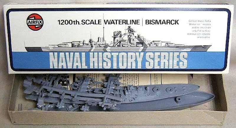

This kit was one of Airfix’s first 1/1200 “Naval History Series” clip-together models issued in 1973.  I hadn’t even heard of this series until recently; apparently there was also a Prinz Eugen, Hood, Ark Royal, Suffolk, and a Tribal class destroyer (all ships involved in the Bismarck chase).  These kits have long been out of production, but you can often find them on e-Bay fairly cheap (I paid less than ten bucks for this one).  The 50 gray plastic parts assemble into a basic but good looking little battleship.
The waterlined hull is a single part with a solid bottom and separate single-piece main deck, so there are none of those annoying mid-deck seams so common on larger scale kits. This is fortunate since the raised deck planking is beautifully delicate. In fact, it is some of the best I’ve seen in any scale—they really got it right way back in 1973! I wish more model manufacturers had continued this style of depiction for planked decks, so much more effective than the overdone trench lines so often seen today.
Assorted deck hardware is also well done with bitts, hatches, vents, and other details sharply depicted. Unfortunately, the model overall doesn’t quite capture the graceful lines of the original. The length/beam dimensions are right, but the hullform is too pudgy fore and aft. Also, the armor belt is too low and the numerous portholes are missing. Worse, the funnel, superstructures and aft turrets are placed just a little too far back. The problem isn’t too noticeable until you get to the fantail, which is about 20 scale feet too short as a result.
The superstructure is simplified. The distinctive spherical hoods of the 4m type SL-8 antiaircraft directors are molded integrally with the superstructure and represented as rounded tops on the mounts rather than as spherical shapes. Not very good. Also, the aft mounts shouldn’t have the hoods at all (unless you intend to build the model as the Tirpitz). The two-part funnel is hollow with an open grating represented on the top. Main turrets are ok, except that the barrels are about 6 scale feet too long and the rangefinder hoods extend too far down the sides—but they are fixable.
The 150mm secondary turrets have simplified shapes and the barrels are also too long. In addition, the ‘midships pair of mounts just forward of the funnel should have rangefinder “ears”. Smaller parts vary in quality from fair to excellent. The tiny Arado Ar-196 floatplane is only so-so with no floats and an overlarge canopy, but the aircraft/boat handling cranes are fairly good. The 10.5m rangefinders atop the superstructures are delicately rendered, as are the masts. The best parts are the ship’s boats, 37mm, and 105mm antiaircraft guns, which rival comparable parts in many larger scale kits—if this kit were more readily available I would be tempted to raid these to outfit a Revell 1/1200 scale Scharnhorst or Gneisenau.
