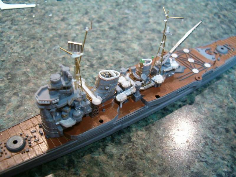

The photoetch sets I chose were Gold Medal’s IJN Destroyer/Cruiser set. I was very impressed by Gold Medal’s Yamato set but this Cruiser one was very disappointing. It does not have embossed pieces, and the railings are slightly overscale. The 1993 copyright date on the sheet told me when this set was first created. Hopefully Gold medal will redo the sheet with embossed pieces since so many new and retooled IJN cruisers have been released. Next time I’ll use the Gold Medal IJN auxiliary set for the catapults. I also used Tom’s Modelworks IJN Aircraft Carrier Set A. Why this set you ask? Because it has a excellent variety of parts for any IJN ship. The funnel grills from the set where used and the wind screen was cut down and used as photoetch windows. Several other pieces from this set were used as well to replace or help scratchbuild certain pieces.

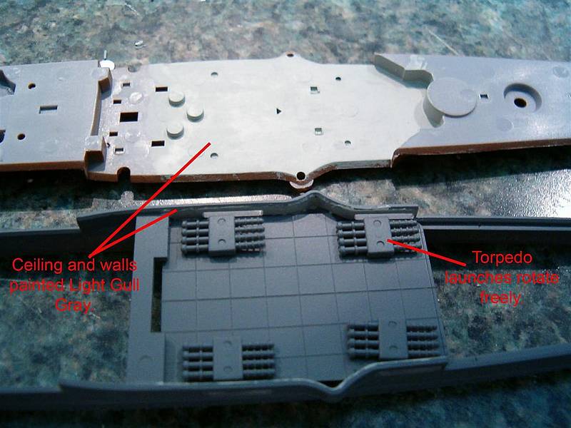

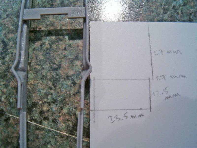

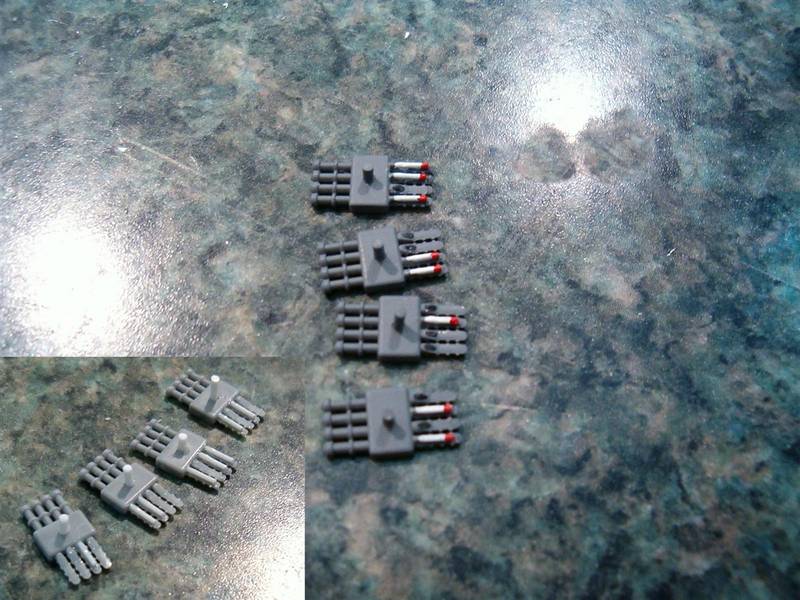

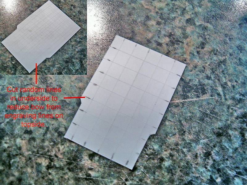

I like to make things movable on the model and I redid the torpedo launchers to swivel from the bottom instead of getting glued to the underside of the deck. This also provided a means to create a bit of the internals of this area, even though it will really not be seen.
The paint was Tamiya Kure Gray and the Linoleum color was a craft store enamel by the name of “Spice Brown” that I really liked to represent the linoleum color. This is my first ship I’ve modeled with the Linoleum deck and it was a big learning experience for me. I messed it up in a few areas and had to try and cover my mistakes. I will definitely do things differently next time but learning is what modeling is all about. The gold lines on the deck are just VERY fine stretched sprue painted gold first, then cut and glued to the deck over the molded on lines. All in all, I think the model turned out okay, minus a few mistakes I made with the paint. I love planes and boats on ships, so unfortunately I pack them on, even though it was not accurate. Ironically, this is the first ship I’ve modeled in the IJN that actually survived the war.

Anthony, your work is always so amazing and I love what you did with the torpedo launchers!  Very inspiring work!
NOV 13, 2008 - 06:59 AM
Thanks everyone.  I had a hard time with the linoleium deck near the bow but I got it looking pretty good again.  When I found out this was a build feature, Mr. Smith generously offered to post a few more photos for me of the build process.  They are in the feature now, Thank you Mr. Smith.
NOV 15, 2008 - 05:44 AM
Heck of a job on the Myoko, I have the Nachi and did a lot of things as you did with this one.  These 1/700 kits that have been upgraded are worth a look see for sure.  I used Toms' Model Works PE IJN Cruiser set along with a few bits from GMM's for mine, Toms' rails were much better than the GMM ones even though they are curved up for the bow end.  The Morskie Monograph on the Nachi came in real handy for upgrading the mast and several other parts from the kit.
Good work on a nice kit.
NOV 15, 2008 - 12:41 PM
great job and great mini-lessons, LOTS of great ideas and tips... thanks for sharing! cheers

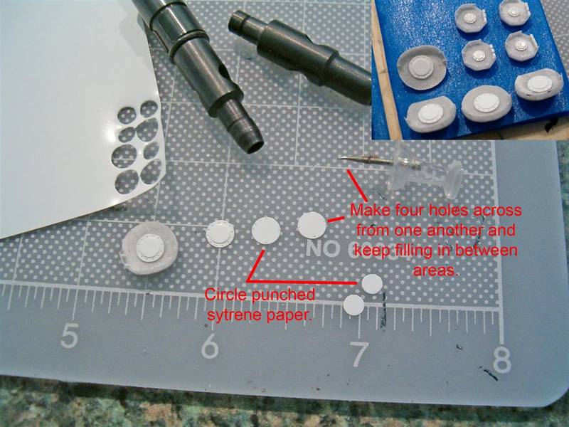

So many good ideas from Anthony - and while I do my best to follow the tips and advise, I still get lost over slip mats, paper punch, and wrapping wire around a drill bit and cutting it in 3's great ideas.
