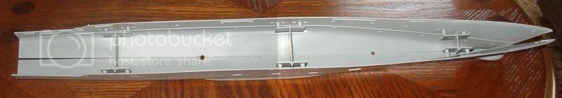

My entry will be (for anyone who doesn't yet know.) a 1/350 scale model of the USS Gettysburg.
Well looking at the hull I assumed it would be the normal 2 haves getting glued together. I was wrong. It’s got 3 support pieces running across the hull and no notches around the edge. Not sure if I like this way better or not yet.
Needless to say the battle of the hull has started.
Also I glues up the kits base. Did a real crappy job of it. Even think a piece or 2 in backwards. I really don’t care what it look’s like. I’m just going to use it to hold the ship for construction. Once its done it will be sitting on a custom handmade cherry and walnut stand.

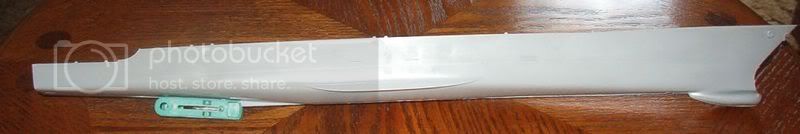

I’ve got the hull glued up all except the tip.
I think I’ve got a piece of plastic broken off the one side so I’m going to wait until I can get the deck inplace to work on that.
Now its time to pull out the putty and sandpaper.
