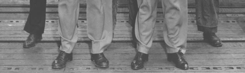

Mostly they were douglas fir, not pine, and there was no diamond tread... just wood planks and tie-downs. Sometimes the board just aft of the tie-down was mahogany .. I've got a document somewhere that mentions it and will post it if I can find it. Not that it would be noticeable in any scale. Pine was used when Fir was in short supply, but I've never noticed it in any of the photos I've seen. CV-6 might have used SOME pine in later time repairs, but she would have been predominantly fir during the war.
Decks were stained throughout the war, but the colors changed depending on year. Additionally, they took a lot of abuse from aircraft rolling over them, dripping oil on them, etc. So it's not abnormal to see more blue on the edges and a darker wood tone in the heavy use areas of a flight deck.

OK, correction, the single-plank thing I mentioned above is from a 1949 document... here's an excerpt:
I. Introduction
Laminated teak surfaced fir decking has been authorized In order to conserve supplies of teak wood and to obtain a hard surfaced deck material with no appreciable increase in weight over fir decking. Teak surfaced decking is used on weather decks of combatant vessels. Due to the weight increase over solid Douglas Fir decking, the use of laminated teak surfaced fir decking on carriers requires specific Bureau authorization, except that on flight decks immediately aft of the steel tie-down channels a single laminated teak deck planking is required as tailhooks readily gouge fir planking. This instruction sheet specifies the materials and method employed in laminating teak and Douglas Fir.
II. Materials
A- Teak
Teak wood shall be in accordance with. Navy Dept. Specification 39T1. The grain may either be flat or vertical.
B. Fir
Fir shall be in accordance with Navy Department Specification 39F33 Fir Douglas^, (For Ship's Use). The grain maybe either flat or vertical. As a component of teak surfaced decking the fir need not be of select grade without blemishes, but shall conform with the lower limits as set forth in above specification.

Ron Smith did a little digging last night after I brought it up... it turns out there were some strips with diamond tread, but only around expansion joints. Diamond tread would not be used around arresting gear as it would cause wear on the arresting wires, which the Navy otherwise spent a lot of effort to keep in good condition. So Karl and I were both wrong and both right.

In examining wartime photos of the flight deck on the Yorktown (Enterprise's sister), one can see that directly beneath the arresting gear cables and their supporting fiddle-bridges, a strip of textured (diamond pattern) steel lies. In the famed photo of Marines manning a 20mm mount on the catwalk where the bow cuts sharply inboard about a foot, an arresting gear sheave is visible and extending away from it athwart the flight deck is that metal chafing plate (see "That Gallant Ship" page 72).
In another photo taken from the island, a wounded SBD gunner is being carried away on a wire litter. The flight deck details show at least three arresting cables with the metal plates under each. ("That Gallant Ship" page 137).
Furthermore, such chafing plates were also used beneath the stowed positions on the wire barriers.
What this all really means is, independent research is vital to pull off a true representation in our hobby. This is especially true for those of us who weren't there.
Kudos, Tracy, on being more specific on the type of wood used, though I understand botanists will debate whether Douglas firs aren't a type of pine after all!

I looked over my copy of "USS Enterprise: the Most Decorated Ship of WWII, A pictorial History" by Steve Ewing, and I can see evidence of those plates there as well. Page 58 has a very clear image.
Don't know what to say, I've mostly studied the Essex class and haven't seen them there at all. Obviously the Yorktown class had them... or at least, the first two.
