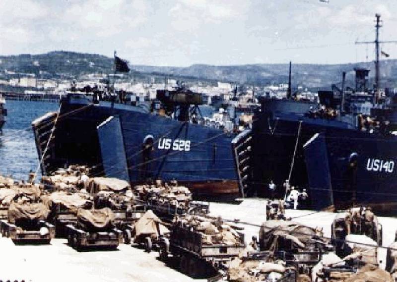

Here's two nice blue ones in Naples.

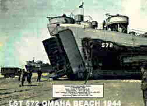

and a nice camo one at Omaha:

Great looking photo's - more if possible thank you
