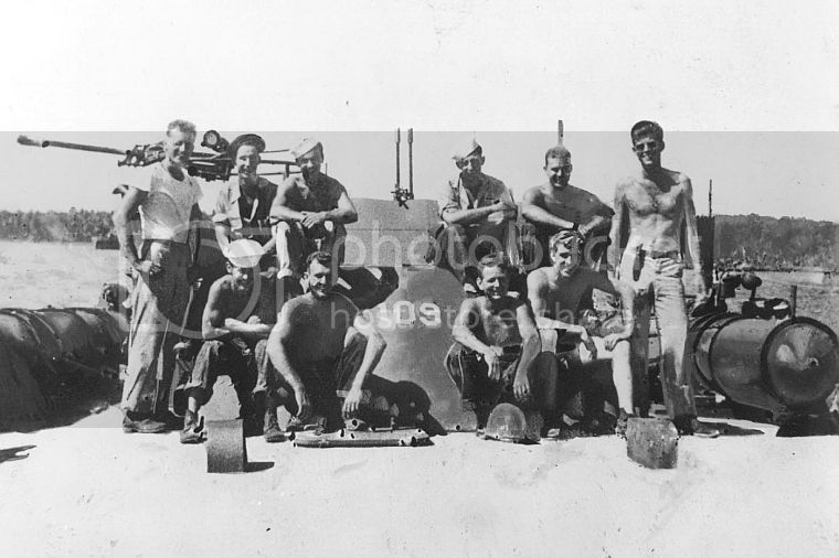

I agree with you that the 109 had a mast coming out of the factory and when transferred to Panama. I'm sure it had a mast on arrival in theatre. In my opinion sometime after arrival in theatre the mast was gone. If you look at the photos on Gene Kirkland's web site (http://pt-king.gdinc.com/index2.html) you'll find a very good story about the history of PT-109. The mast is not visible prior to JFK or under his command. No telling why but many boats ditched their masts until radar came along. I'm familiar with the photo in the book you referenced. It's labeled incorrectly. That is PT-105. Anyway, here are three photos of the 109 in theatre. Some say the mast is folded but there is no evidence of it in the Bollard photo.
PT-109 prior to JFK
PT-109 under JFK
PT-109 prior to JFK
PT-109 under JFK
