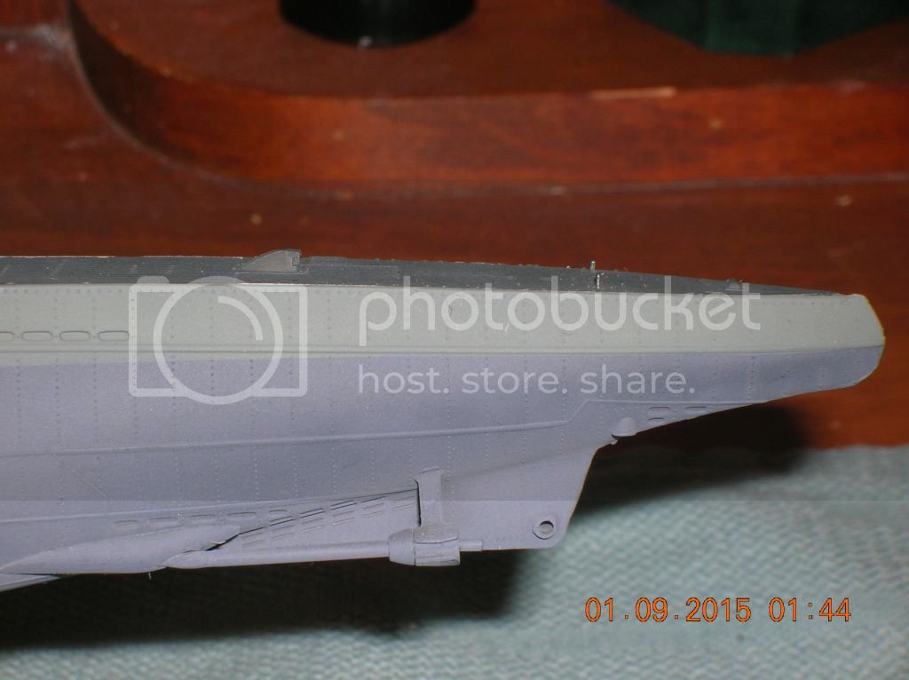

Hello David,
The paint is looking very good so far.
Well yes...the 2 cables going into the insulators on the tower
casing are definitely historically correct (photo proof)for this
tower but don't use it for reference because this is not U 318
as you are trying to build.
U 318 was a Type VIIC/41 with snorkel....the boat in the photo has no snorkel
or provisions for it and the tower is very different than that of U 318 as seen
in the Revell model.
Could it be U318 before some mods and a snorkel refit?
It seems to be a training boat.
I don't know her exact history but I will look up my references and
get back to you as to how many wires should be going into the tower for U 318,
as you are trying to build her.
