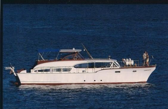

"The Lindberg Chris Craft Constellation is a model of a 1956-54’ Constellation. Hull number series was X-54-101 to X-54-138 with 38 hulls built. Power was either (2x) WEBR Chris Craft gas motors, (2x) GM diesels 6A, or (3) GM diesels 6A. She carried 400 gallons of fuel and 150 gallons of fresh water. Total weight of the boat was 26900-29450lbs. The hull color from the factory was black."
I wonder what the two chrome finished grates (parts 62) on the aft deck were meant for (drainage perhaps)and I also wonder how these are supposed to be fitted. Thing is I'm not even sure which side should be facing up. The davits are also puzzling, I think there should be a winch on top of each. I finally wonder about the seating arrangement, especially the steering seat. Personnaly I think a pivoting steering seat would be most logical. Some pics of the maiden voyage (last Sunday) :
By the way, I installed bigger motors, 4 mm propshafts and 3-blade- 3 cm props. It's probably the most suitable plastic boat kit available for rc conversion (easy access, it can take quite a lot of weight and there are few small vulnerable plastic parts).
