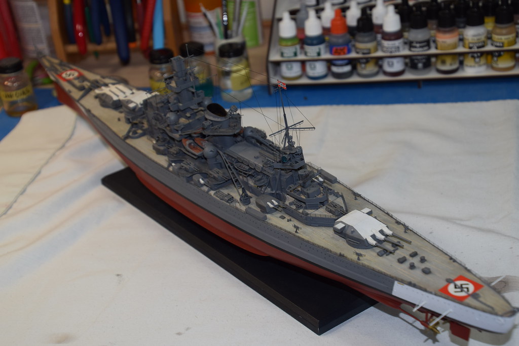

Hi Charlie,
You are right; ship model building community opinion does seem to be split between real wood and painted plastic decks. I am ambivalent myself. On the one hand, on full sized ships wood decks look basically one tan color from normal viewing distances – the plank runs are not typically even visible.
So given that, simple painted plastic decks like that on this 1/720 scale battleship
or this 1/303 scale Coast Guard Cutter
should be the most realistic. Only close up would the plank runs even be discernible:
On the other hand, nothing looks as much like wood as real wood!
Unfortunately even the finest real wood veneer decks for scale models are pretty much always massively overscale, and the individual planks are much more prominent than in real life.
A case in point is this USS Olympia in the relatively larger scale of 1/228:
 Even though not really in scale, though, these heavier, more “theatrical” renderings of wood decks are undeniably attractive!
Anyway, as to your actual question, yes, you can get good results from a simple wash over a single-color painted plastic deck. On this Chinese junk, the plastic deck was given a coat of tan acrylic followed by a wash of dark brown oil paint to deepen the plank and hatch detail.
So again, even though exaggerated compared to real life, a more dramatic approach on a model can still be effective.

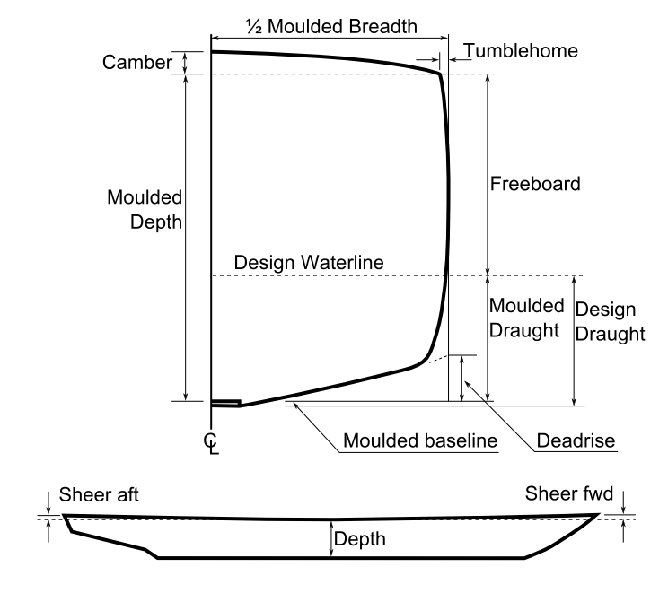

One important aspect of decks which is usually missed in plastic models is the deck camber.
In my opinion this is more important than trying to replicate wooden planking. The absence of this will be visible on a 1/700 battleship.

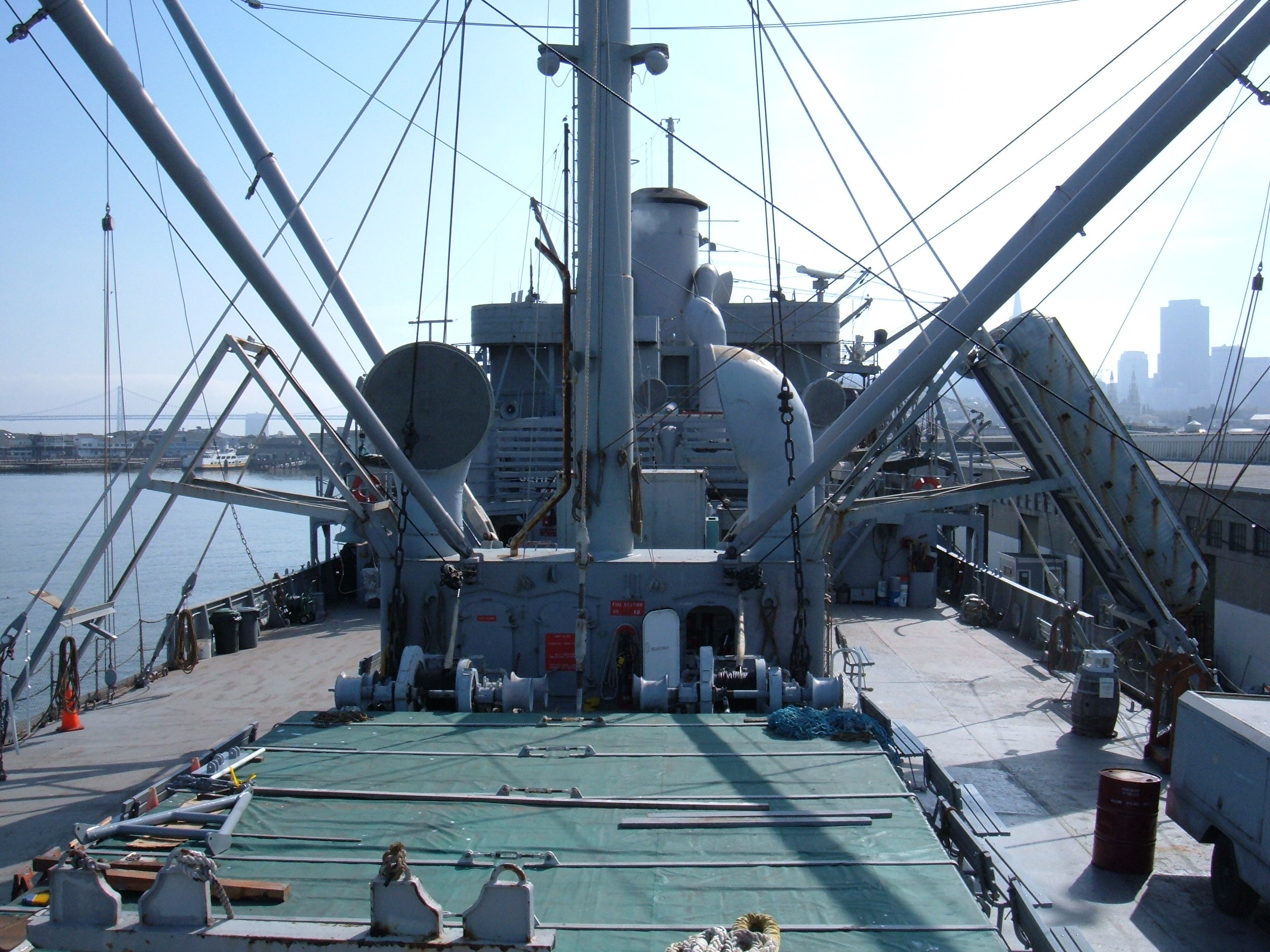

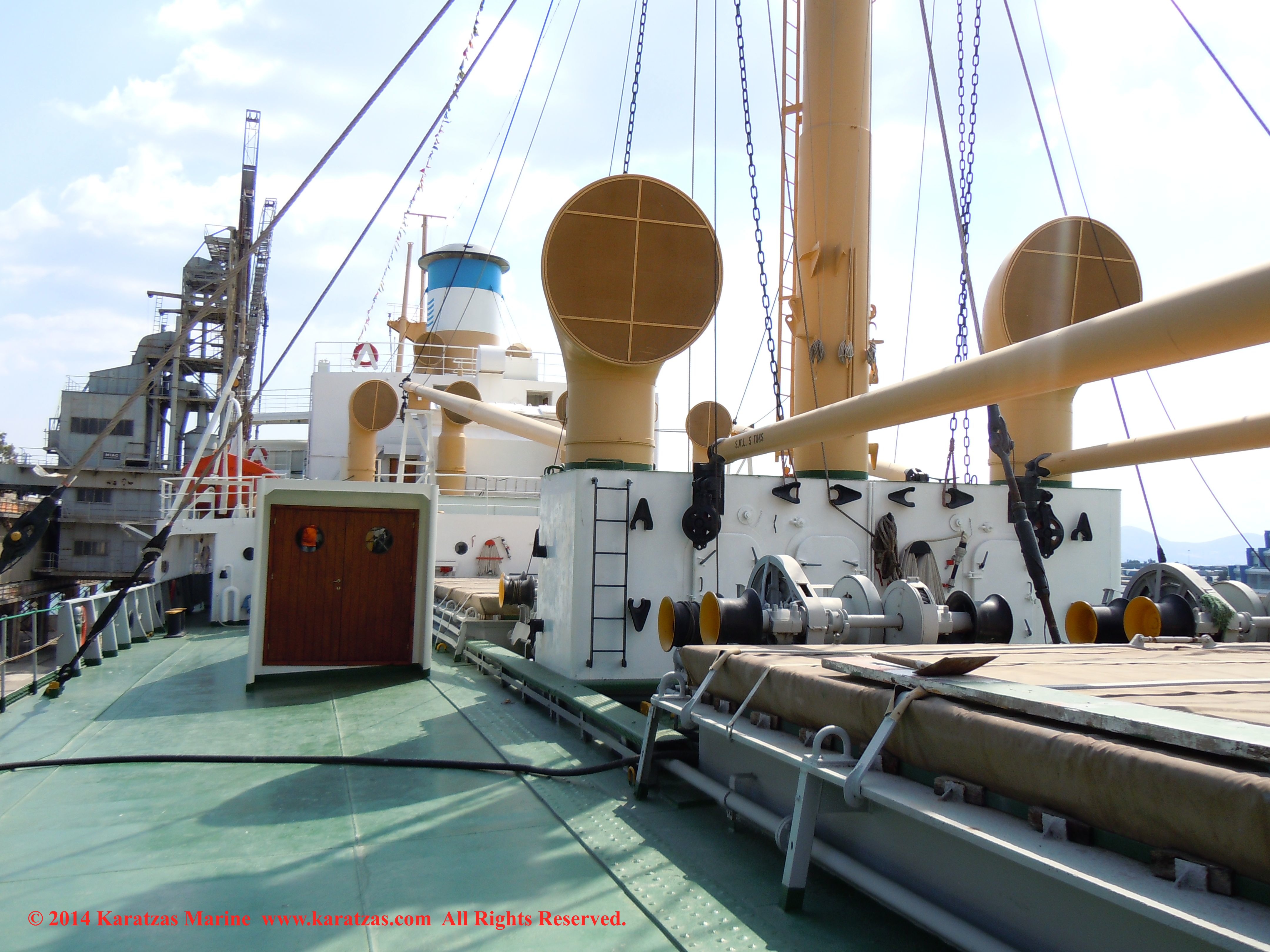

Deck view of the Liberty ship Jeremiah O'Brien
Link to full size image:
https://upload.wikimedia.org/wikipedia/commons/6/6f/SS_Jeremiah_O%27Brien_main_deck_5.JPG
SS Hellas Liberty. Note how the deck drops away to the side under the doors to the companionway.

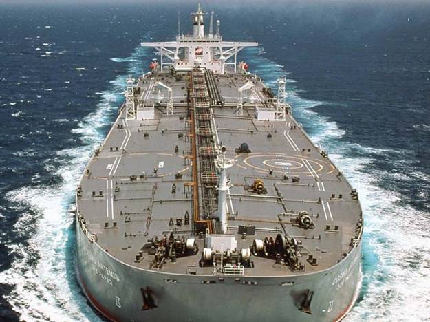

The load deck of a container ship is flat though, it gets awkward to handle containers otherwise ...

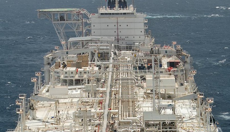

Large ships
and small boats
The problem with camber on plastic models is that a flat sheet of plastic can be bent as camber (crosswise) or as sheer (lengthwise), doing both at the same time requires a lot of force or softening the plastic to allow it to adapt. To achieve both the deck needs to be molded as a three dimensional structure.
Building the deck from strips makes it easier to get the curvatures right.

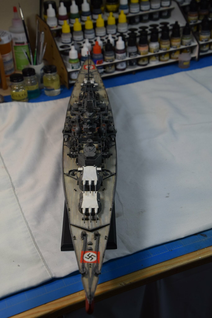

I have installed the wooden decks but never been happy with out thick they are so I started painting the decks. I use a multi step process. Here are a few pictures.
This is what it ended up looking like with the model built out.
Mark, that deck looks amazing. What was the process?
Posted: Monday, March 26, 2018 - 04:15 AM UTC
Rory,
I borrow the technique from a Guido Hopp who posted two videos on how to paint decks on ships. Here are the links to the two videos.
https://www.youtube.com/watch?v=bAnTo2OYLYw
https://www.youtube.com/watch?v=aa6vWwIaOyg

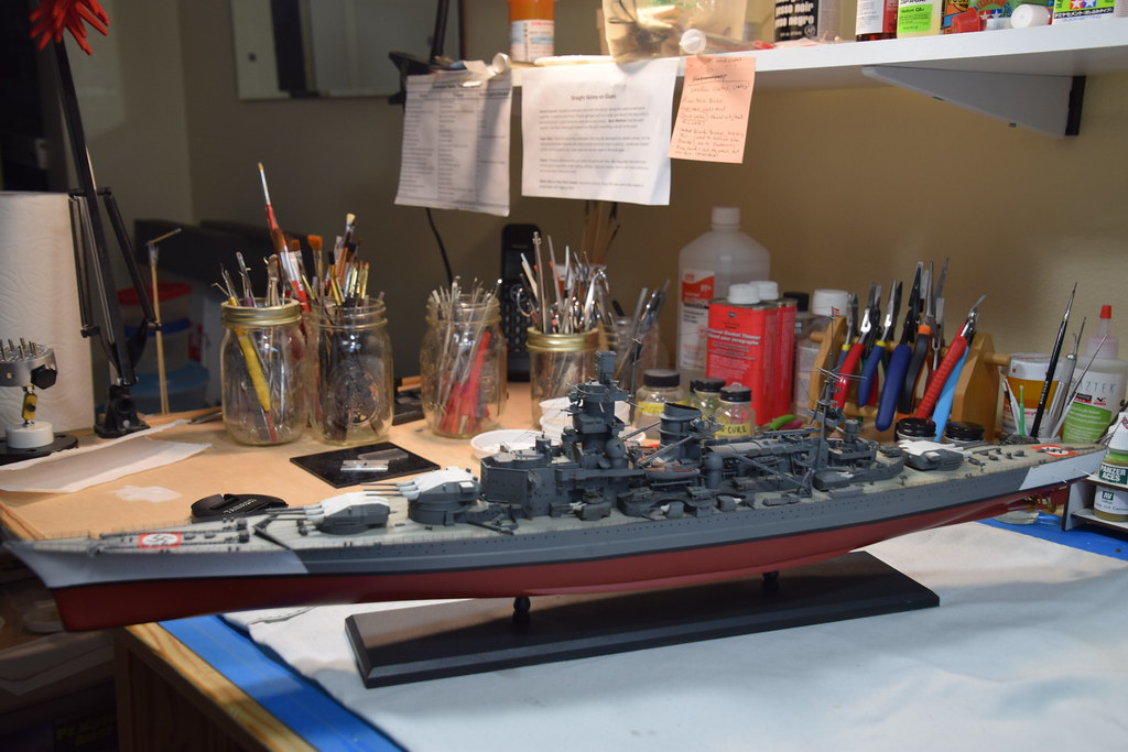

So got a chance to sit down and put some paint on some plastic the other day. Vallejo and Citadel paint BEAUTIFULLY with a brush. Oh man. I can totally see buying all kinds of colors.
Haven't had a chance to paint the with the AB yet, but am really looking forward to being able to put it to use.
