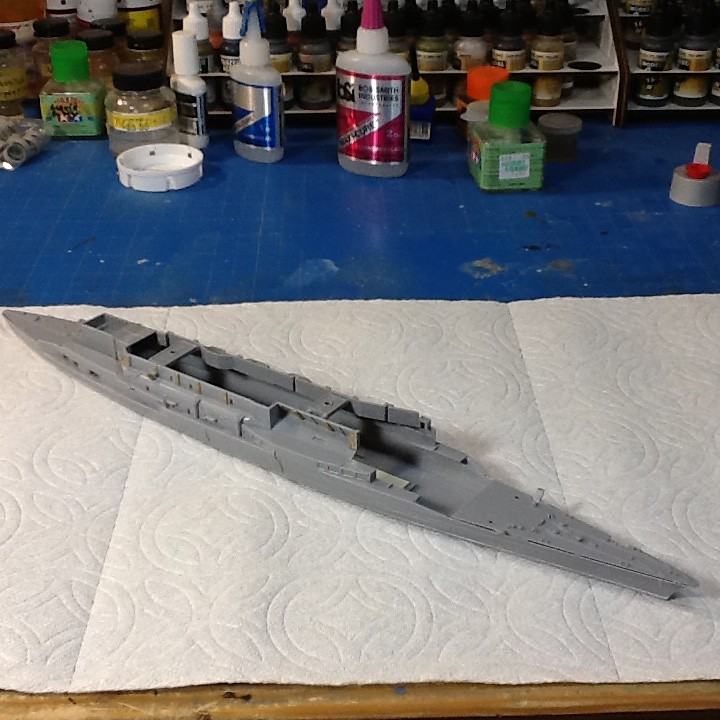

I thought I would follow the other builders in the "Flattops Campaign" and start a separate build log on my "Akagi "Three Flight Deck" carrier 1/700.
This the kit box.
Purchased Tom's PE designed for this kit and a whole bunch of Voyager IJN carrier upgrade PE for radio antennas, deck stuff, weapons, etc., etc. I have a feeling I am going to hate PE when this done.

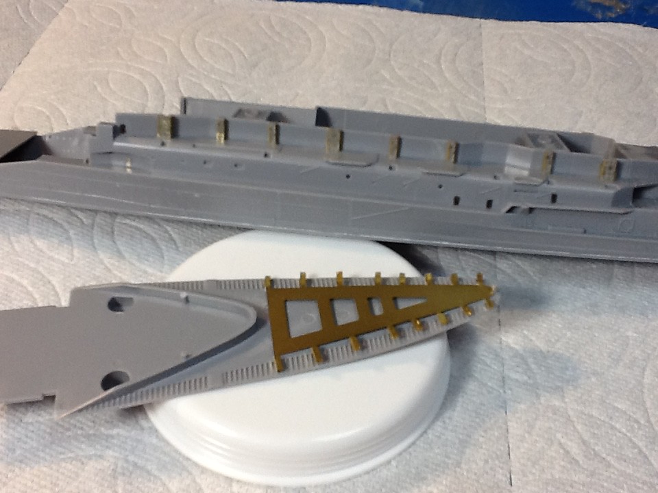

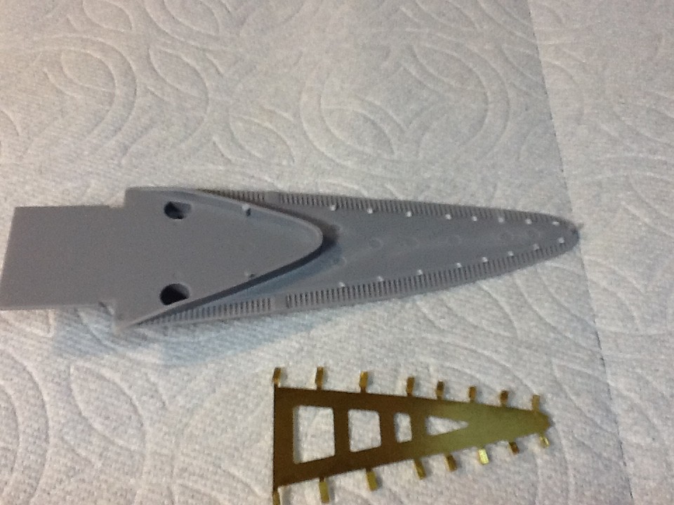

So far I have the hull assembled, drilled out the portholes, started adding PE and dry fitting the decks.
My first major PE test is removing and replacing the molded on pillars supporting the lower flight deck just about the main deck at the bow. The picture really doesn't show the pillars very well but I had to shape sixteen pillars attached to the PE sheet. Each pillar took 4 folds to shape and they are held together with very thin superglue.
The installation of the PE pillars will be another day. My next step to mount the hull on a board. Until the next posting.

Looking very good Mark. Now I see what you are trying to build that's an interesting approach to flight decks. I am not sure I would want to attempt PE in 1/700th scale so you're a brave man.

I have to agree with what Michael said, Mark: PE in 1/700 makes me jittery to say the least

It makes me jittery also, but I am willing to give it a try.

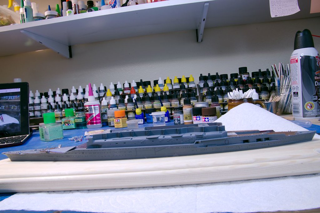

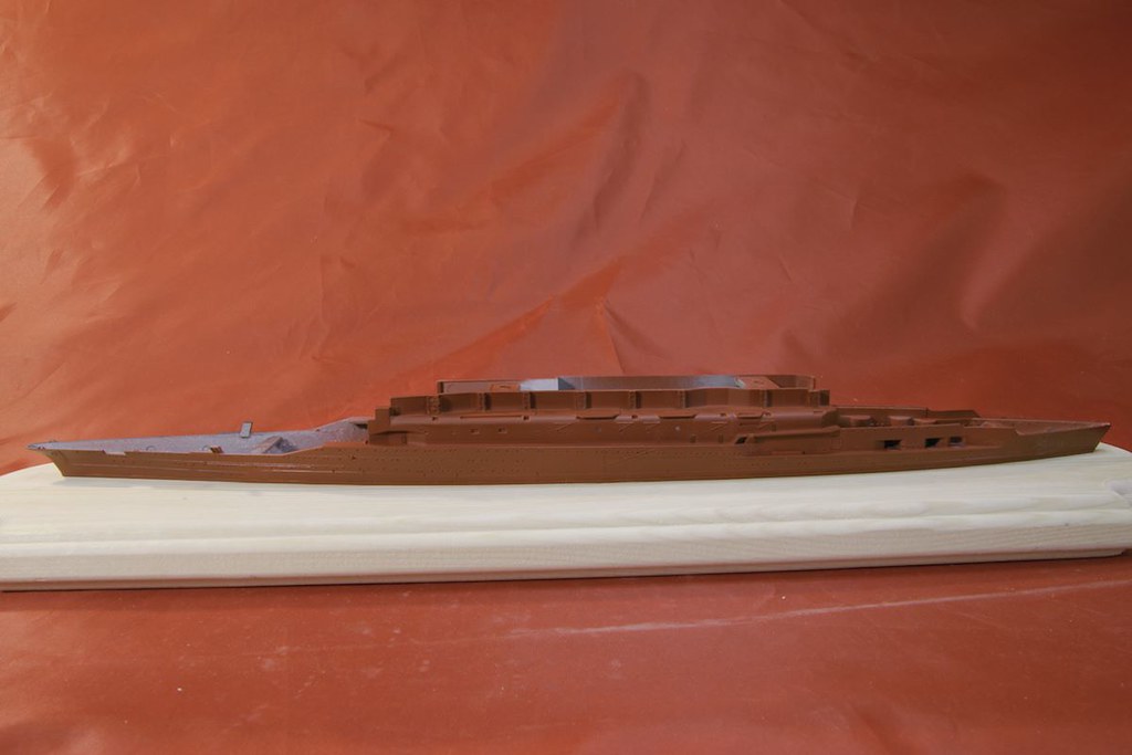

Finished up my last AFV for the year today and will focus on ships until the end of the year.
Here a couple of photos of where I am at.
The hull has been primed.

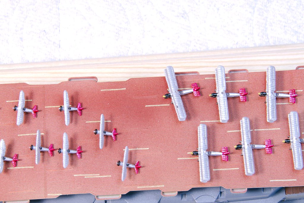

I also started on the air wings of fighters and torpedo bombers. I purchased additional aircraft because the kit only came with six fighters and torpedo bombers.
All of the aircraft are assembled and have their base color coat on them.
I don't have photos, but the decks are taped and ready for me to paint them. I am not adding an after market deck but spay paint them. Will post photos as the work progresses.
Until the next post.

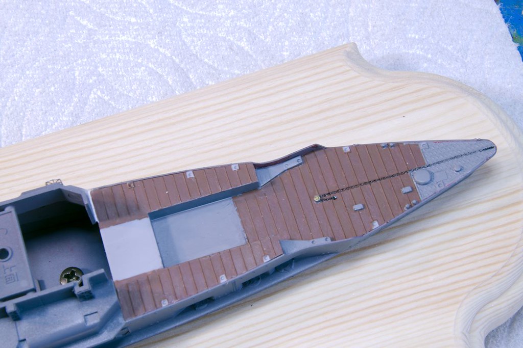

#453
Joined: August 28, 2016
KitMaker: 1,925 posts
Posted: Sunday, July 22, 2018 - 08:05 AM UTC

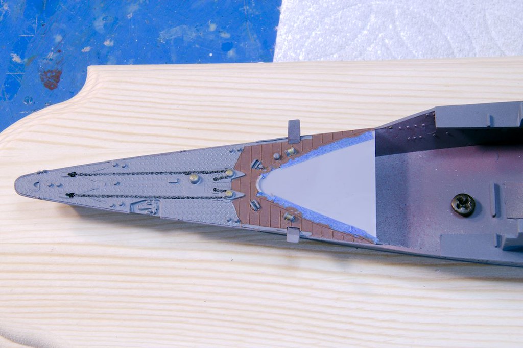

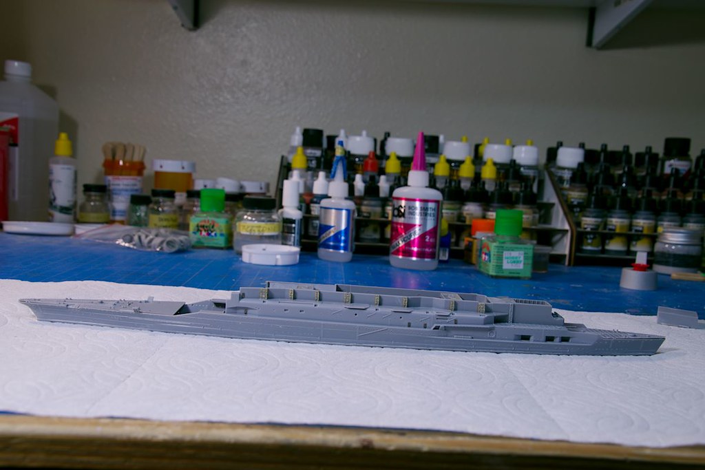

I have been making progress these pass few days.
I put a couple of coats of (Model Master) Kure Grey followed with a couple of coats of Future to protect the paint.
The bow and stern main decks have been painted and fitted on the hull.

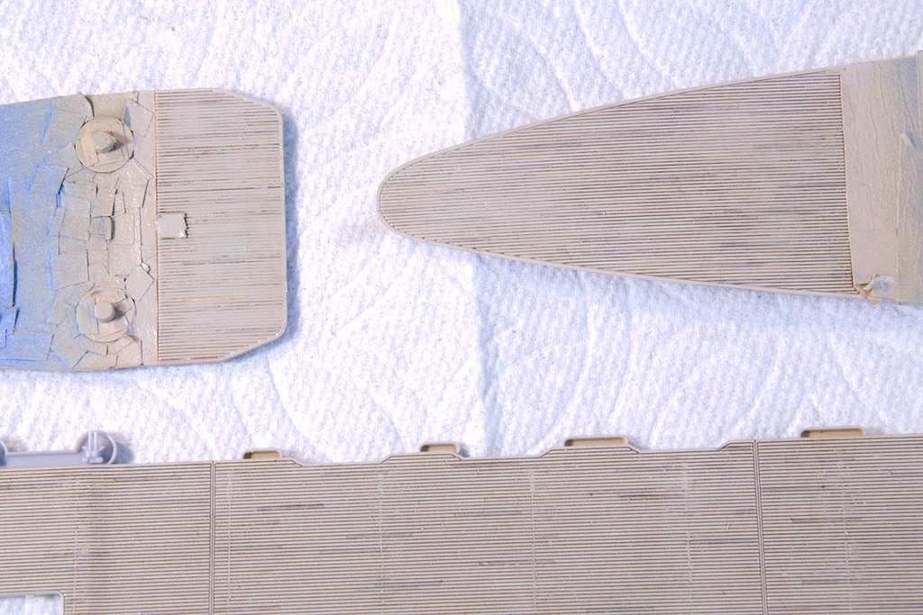

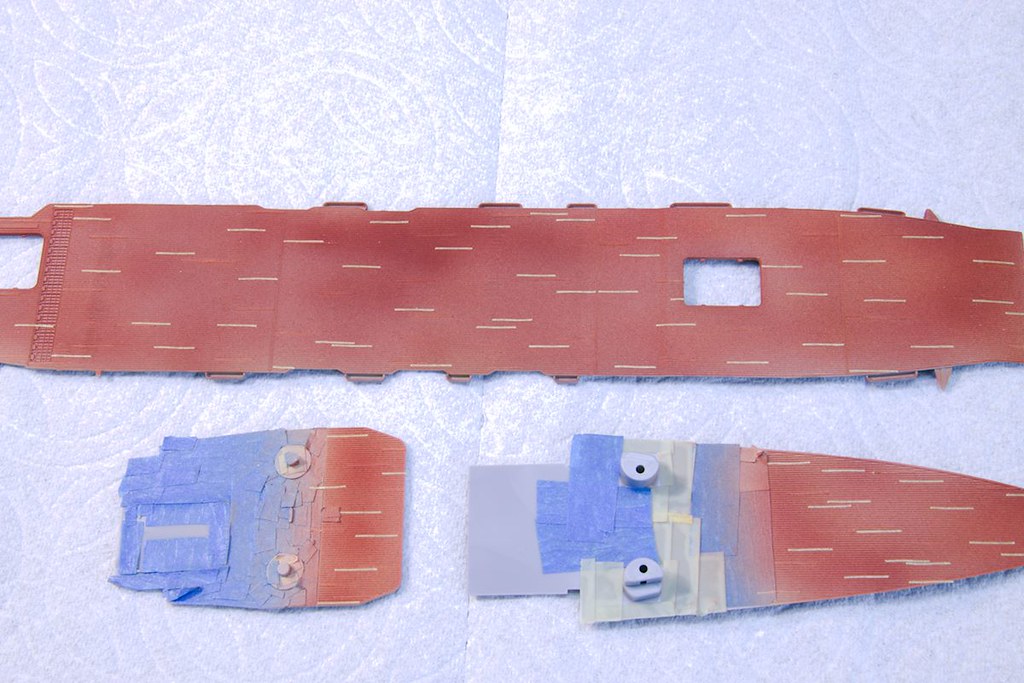

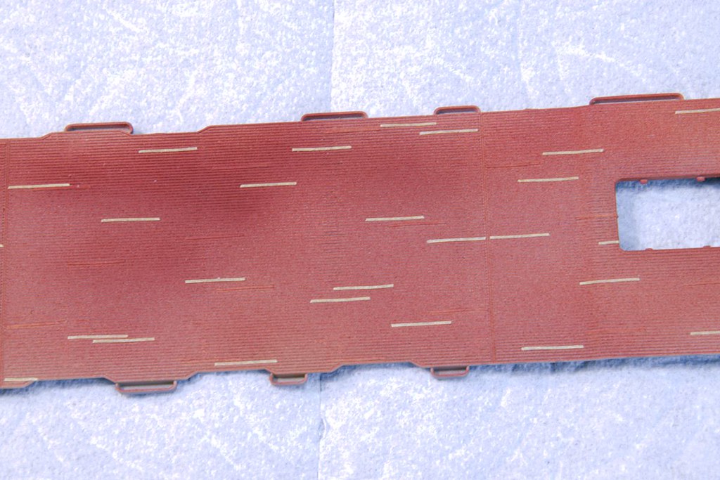

Started painting the three flight decks. The first attempt was a total failure. The paint wouldn't stick to the decks and the paint would come off when I pulled the (test) tape off (I don't think I let the paint cure long enough). Remove the paint and re-primed (Vallejo White Primer) and let it sit for a couple of days. Then I added a random coats of Buff and Sandy Brown. Lay .4mm X 9mm strips of tape randomly on the decks put on a coat of (Vallejo Model Air)Mahagony paint and added more tape strips randomly.
Right after I took those photos I put on a layer of Medium Brown paint. I will let that sit for a full day and then add more random strips of tape. I have four more layers and colors to do, so this will take a week at least before I put the final coat of Future to protect it.
While I was waiting for the decks to dry I started on the air wing. They are all painted and have a layer of Future on them.
All they need are the decals which I plan on starting tomorrow. I hope all goes well because those decals are mighty tiny and I have big hands.

Posted: Tuesday, July 24, 2018 - 10:49 AM UTC
Hi Mark,
I like your multi-tone approach to painting the wood flight deck; I've never had much luck with that technique myself, so I'm interested to watch your progress!
#453
Posted: Tuesday, July 24, 2018 - 12:20 PM UTC
Hi Mark,
Thanks Tim,
I have one more set of strips to lay follow by three more coats of paint, clear coat and wash. First time I tried this on a 1/700 model. I am completely winging it.

The deck looks great Mark. Always interested to see new styles for painting. The aircraft are looking good too. I don't envy you in this scale but do appreciate the way you are dealing with.

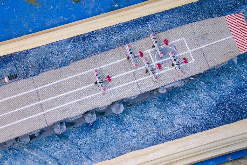

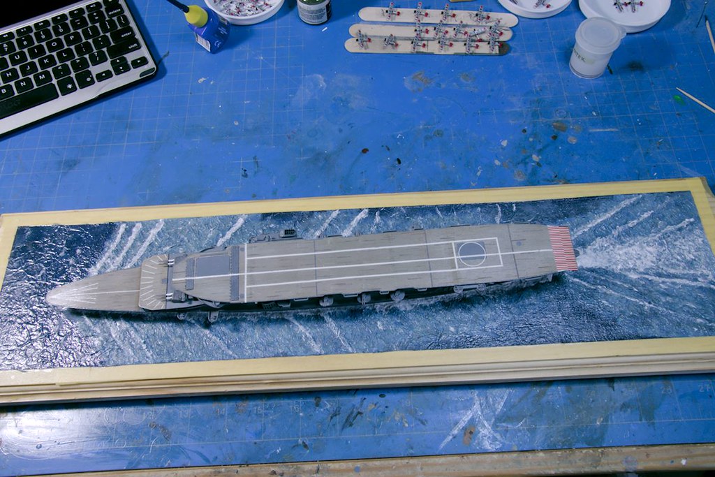

Posted: Saturday, August 25, 2018 - 10:29 AM UTC

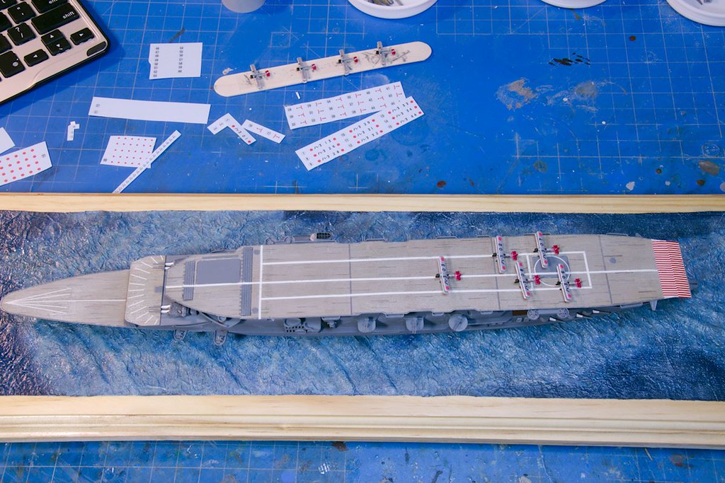

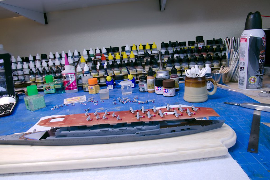

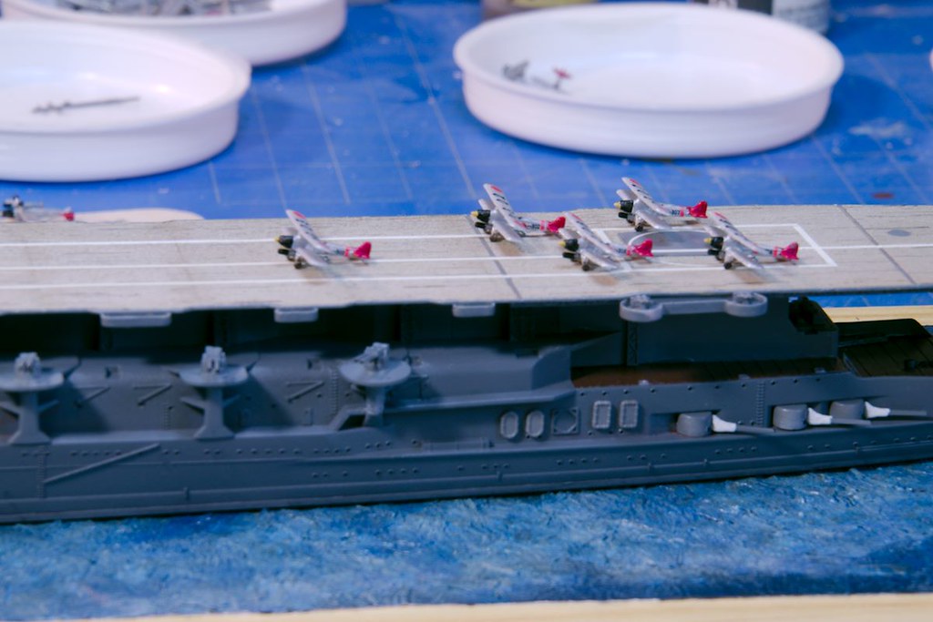

Wow, I can't believe it been almost a month since my last post on this build. I have been busy as bee getting the ship ready, planes painted and creating the water base, my first one. Anyway enough of that here are a few progress photos.
Portside and starboard side sitting on the base.
Here is a top down shot with 5 torpedo planes with decals. Each plane requires 8 decals. I haven't put the decals on the tail, that will be tonight.
I had to be drunk or crazy when I order those additional planes. Only 49 more to go.
This is my first attempt at making a water base. Its been a big learning curve for me and has taken most of my time this past month. It is ready for me to mount the ship and then I will began to add the white caps, do some more blending and such.
Well back to the decals. Until the next post.
Posted: Sunday, August 26, 2018 - 02:41 AM UTC
She's looking really good, Mark! Akagi was at any time an unusual looking ship, but that three flight deck configuration was her weirdest look of all! It certainly underscores how committed the Japanese were to naval innovation in the 1920s and 30s!
I look forward to seeing all those tiny aircraft come together. Can you post a few close-ups of them as you proceed? I'm very much enjoying the quality of your work!
#306
KitMaker: 3,959 posts
Posted: Sunday, August 26, 2018 - 09:45 AM UTC
This looks amazing Mark
Only 54 planes!?!?! WOW!
You can do it!

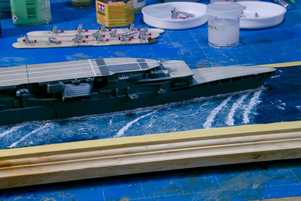

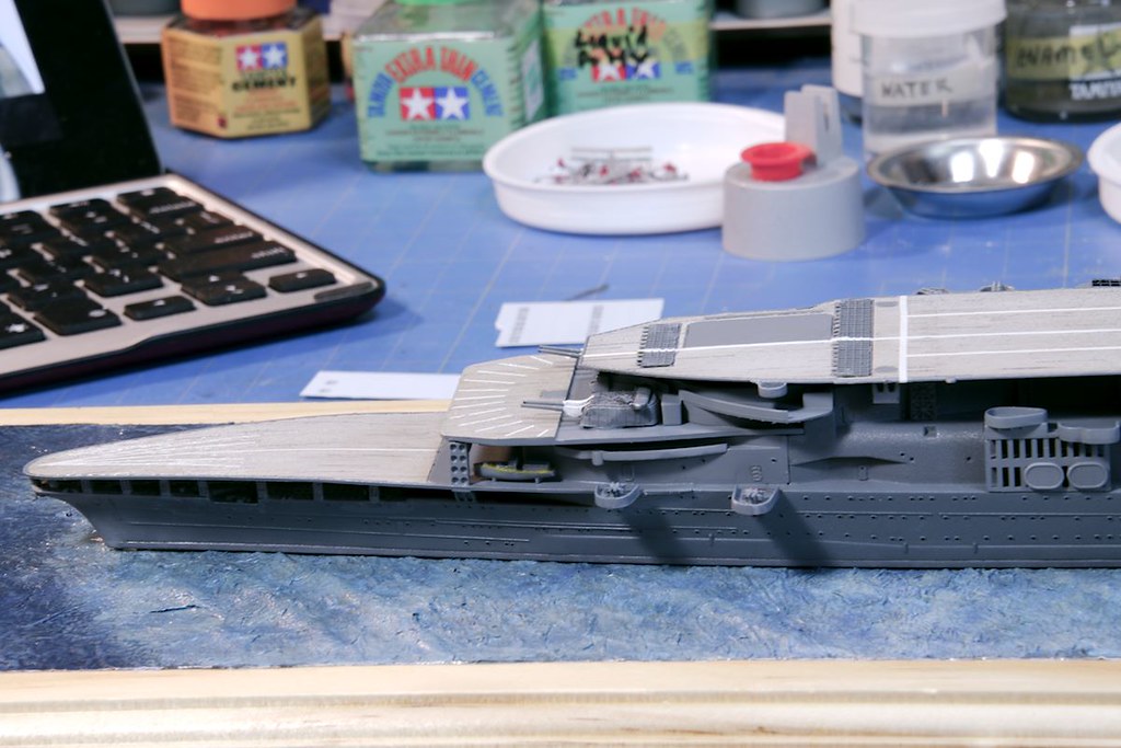

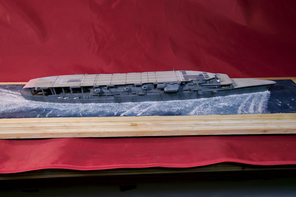

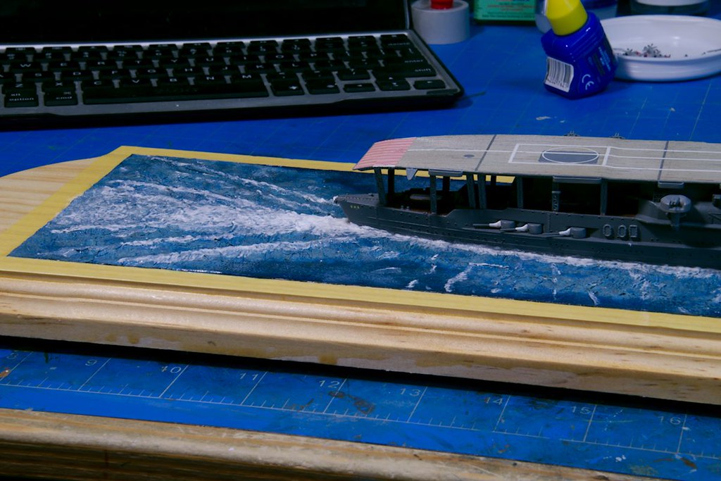

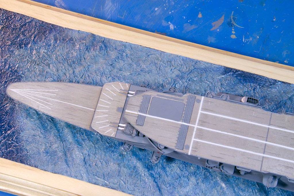

Posted: Sunday, September 16, 2018 - 01:15 PM UTC
Everyone,
Mounted the hull to the base and then cemented the deck to the hull.
First time doing a water base so this will be an experiment in trial and error.
There are some touch ups to be made, railings to add and some odds and ends to attach. My goal is to finish her by the end of the month.
Until next post.

Posted: Monday, September 17, 2018 - 06:13 PM UTC
Great water effects and setting. I have always secretly wanted to try this but haven't had the courage to take the plunge. Looking forward to seeing the airwing in place.

Posted: Tuesday, September 18, 2018 - 10:09 AM UTC
Thanks Michael, I still have more to do with the base. Making slow progress on the airwing but I will get there.

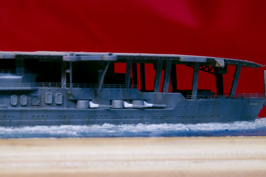

#453
Posted: Monday, October 08, 2018 - 01:42 PM UTC

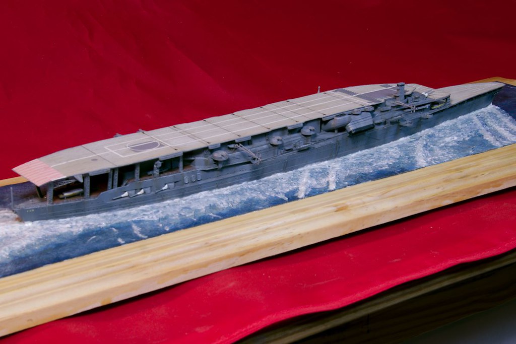

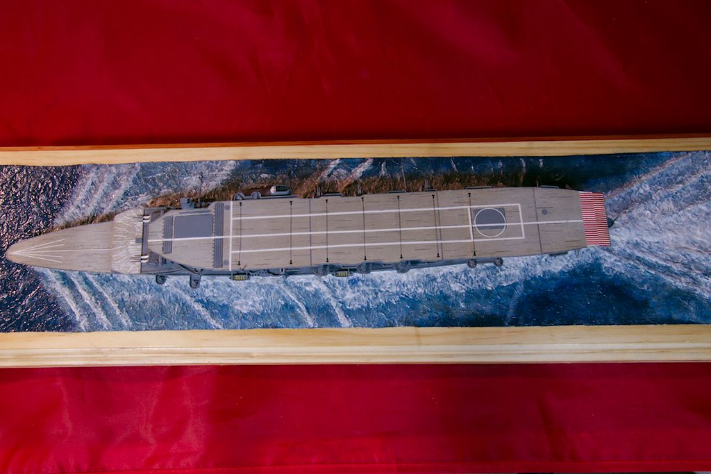

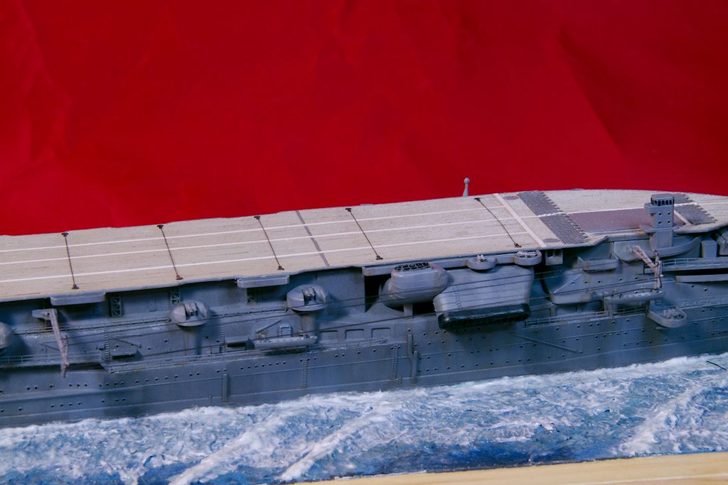

Well this kit is finished, there isn't anything more to add to it except for the air wing. After the last post I realized that there are 11 decals per plane, not nine so I have to confess I been putting it off until the end.
I finished adding all of the odds and ends, worked a little more on the water, installed the railings, antennas / wires and finished up with weathering and pin wash. I just have to add the flag and the air wing.
The weathering was done with artist oils of black, white, burnt umber, blue, blue/black with 15 parts of turpentine to each color. Several random brushing of each color.
The arrestor cables were aftermarket, I believe Eduards.
The next posting should be with the air wing on the flight decks. Only a couple of hundred 1/700 decals to go. Until the next post.
