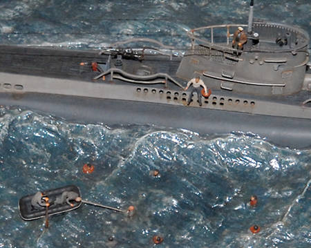

Posted: Sunday, April 01, 2007 - 03:35 AM UTC
Ahoy Filipe,
I have set a couple of u-boats recently in "water". I am very pleased with the effects
so here is my method and it is not a new one.
1. Draw the outline of the model on a piece of plywood.
2. Start to cover the plywood with plaster and work a 1/4" layer with a larger'
course paint brush and work in the direction of the waves.
3. With a smaller paint brush gently sculpt the wave details adding plaster to
build up the waves. Keep the paint brush wet will help smooth the quick drying
plaster.
4. Paint the plaster with the desired colors.
5. Set the model in place, touch up the plaster if required and repaint any
touch ups.
6. Paint on acrylics gloss medium either liquid or gel. Several layers will
add depth to the water.
Here is a photo of mine showing the effect:
Hope this helps,

Posted: Sunday, April 01, 2007 - 03:44 PM UTC
Hi Filipe,
yes that's completely normal that polyester resin doesn't keep its shape as told Kenny.
There's however a trick to make some waves -the resin stays unset for quite some time depending on the amount of hardener and then sets very fast -it's during this one minute or so that you can shape it. You just have to be near the stuff and be very patient..
Joe now that's a nice diorama!
Posted: Monday, April 02, 2007 - 02:06 AM UTC
Ho Joe,
great looking sub and I love the activity in the water.
