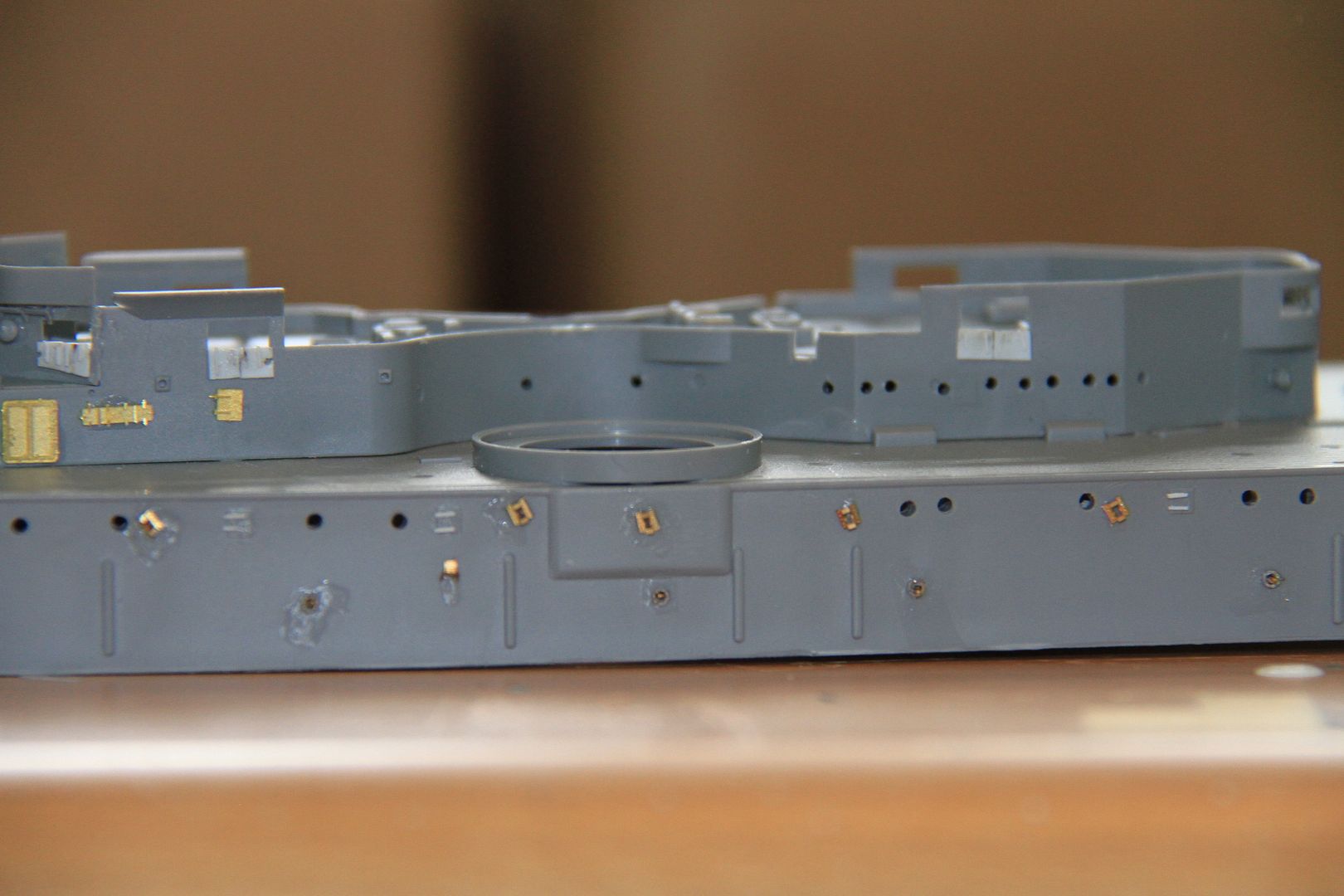

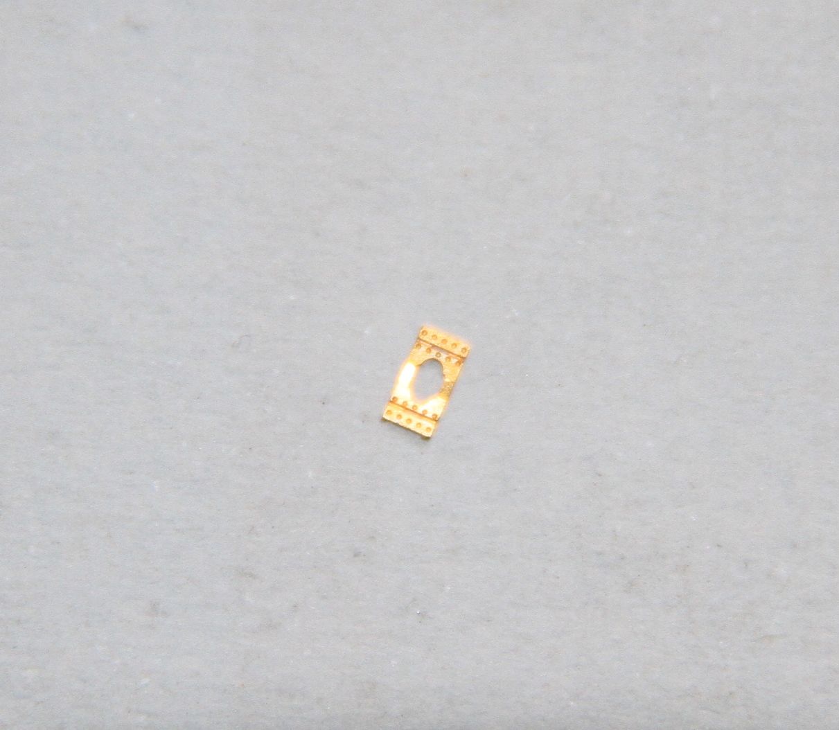

A bit more progress on the hull details, the trickiest folds are the brackets for the stowed booms. the weak point is the half etched folds around the opening in the bracket.
Nt that clear in the picture, but running from the long etch to the long side of the oval hole.

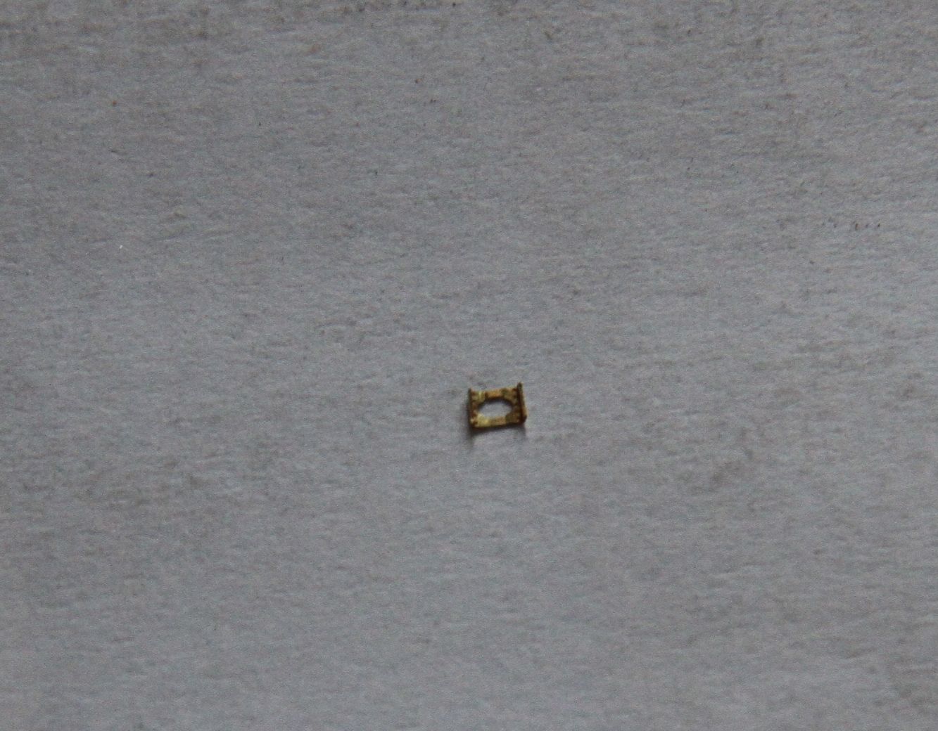

the easy method I have found is to fold the two mounting plates up first, as the are the hardest fold. I have a very simple folding tool, but it works for me. The mounting plates folded up.
The double fold to complete the piece was done using tweezers.
Mounts for the midships boat boom fitted.
The port side completed up the maindeck level with some work above.
and the starboard side so far.
More soon

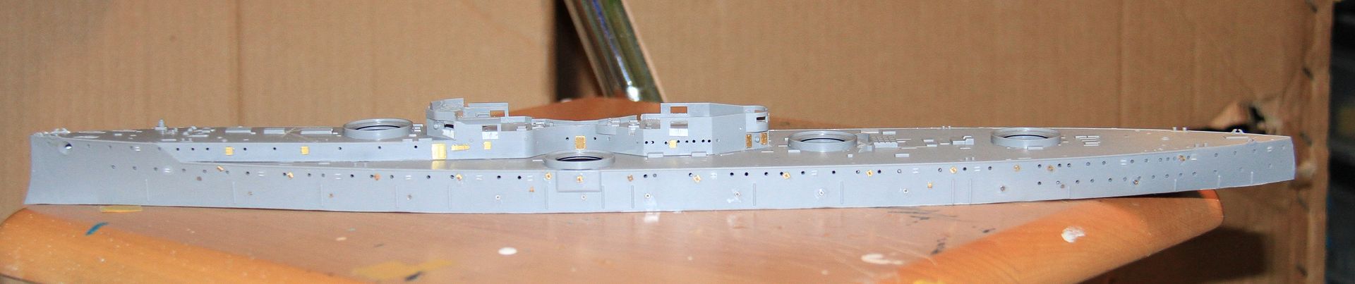

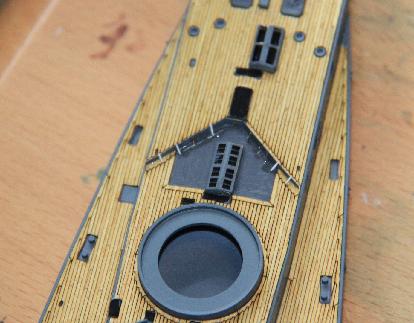

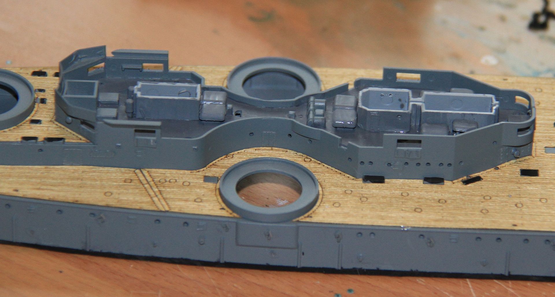

Finally, all the fittings for the boat and torpedo net booms and other bits of hull details completed. Next job, whack some paint on. Tamiya TS66 looked about right to Me.
I have painted the skylights black, as I intend to have some of them open, also the steel deck areas have been painted a darker shade of grey.
The tedious job with using a wood deck is picking out all the cutouts with tip of a No.11 blade. I prefer to do this as they don't always stay down when the deck is peeled up and I want to minimise handling the desk once it is off the backing.
The fo'c'sle deck down, a very good fit indeed.
All of the maindeck down. I was conscious that there may be an issue with having fitted the fo'c'sle deck first, but I didn't want to risk a prominent visible join right on the hull sides. In the end I needn't have worried, I slid the deck under the overhangs around the rear gun ports on the superstructure, and just eased the sections around the barbettes for the wing turrets into place, gently rubbing it down with a clean finger. Any edges standing proud around structure can be gently pressed down with the back of a knife blade.
The two forward section of the maindeck also fit well. Overall the Pontos deck fitted very well.
Deck fittings next, and the superstructure 12pdrs (I think)

Great looking decks Simon and good tip about removing the cutouts before peeling off the backing. I will remember that!

I must admit I am convert to real wood decks, this is third one I have used and with a bit of forward planning so far they have not presented any insurmountable problems.
My one fear is a splash of paint on the deck touching something up, but as this will some crew about no doubt I can think of a cover up.

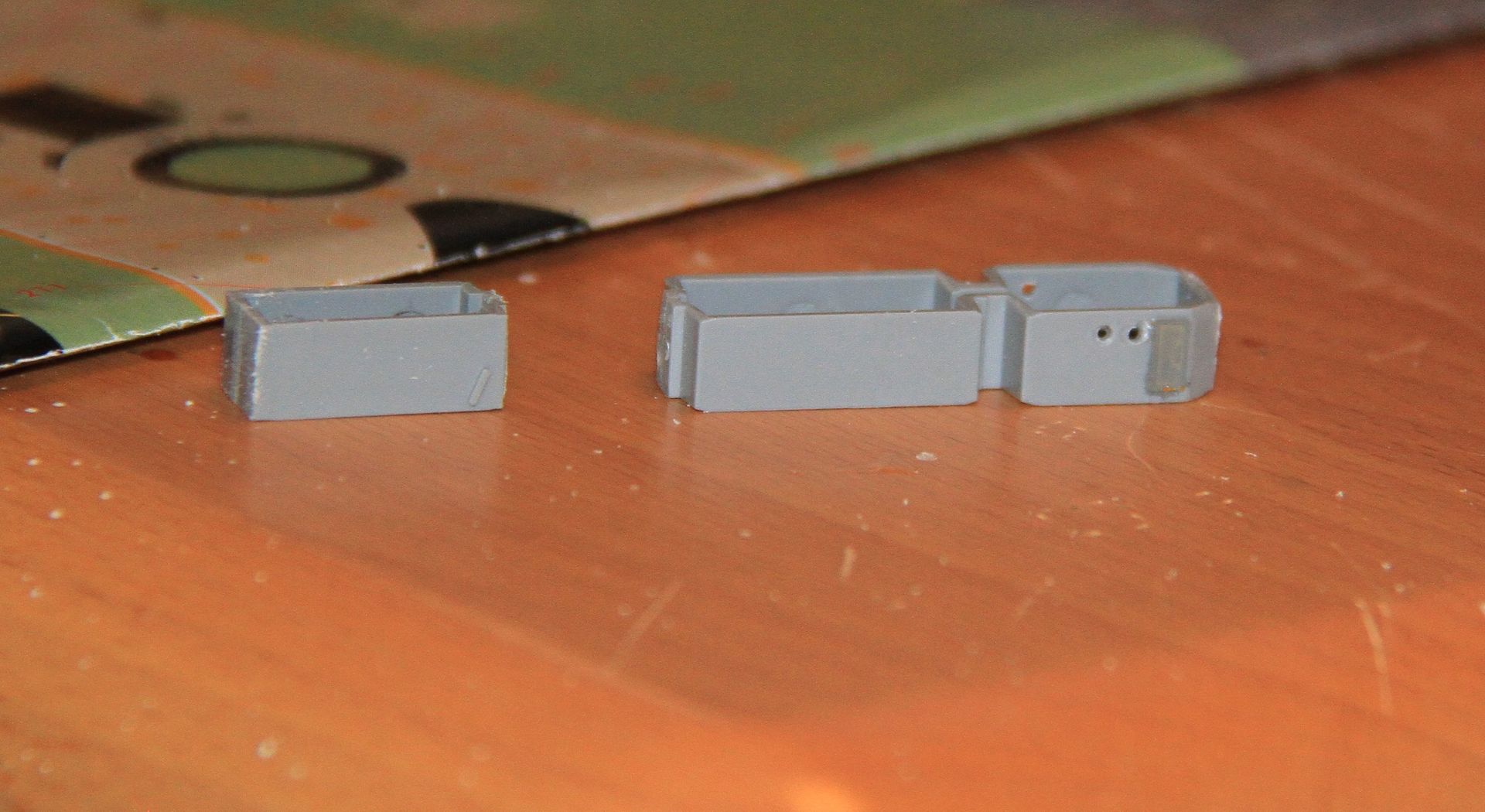

The funnel casings that go in the superstructure have been assembles]d, the larger, after one has had it's portholes drilled out & and etched doors added.

After all the etch a bit of work on the superstructure, funnel cases and vent covers in place.
