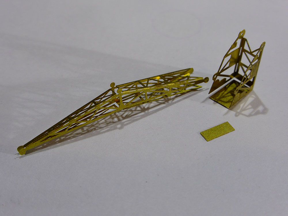

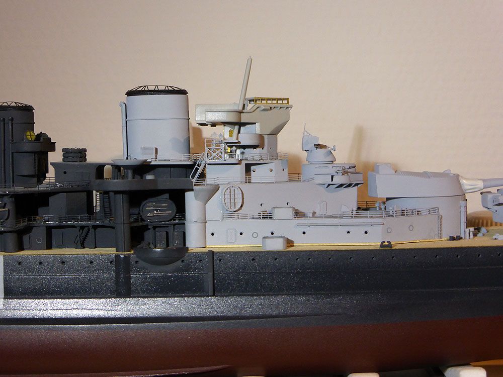

All right, x-mas is taking over and minimizing my time at the yard, so I decided to give my personnel an early leave after the last work session yesterday. So this will be the last update for 2014. But now worries, 2015 should be better from the modeling opportunities than 2014, and I am already thinking about the next build...
But first good ship REPULSE needs to be finished, some work to be done here still.

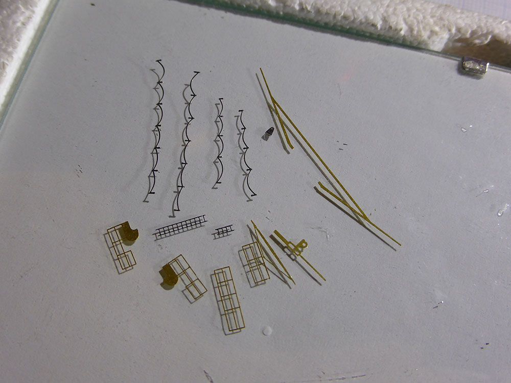

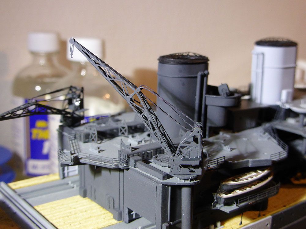

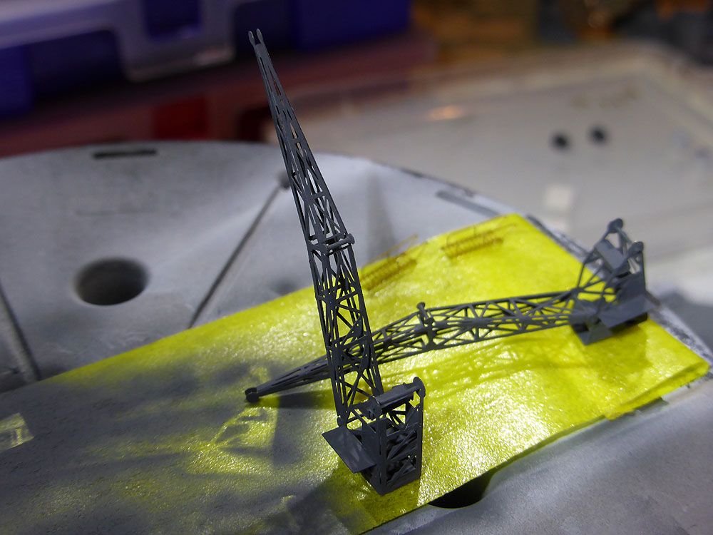

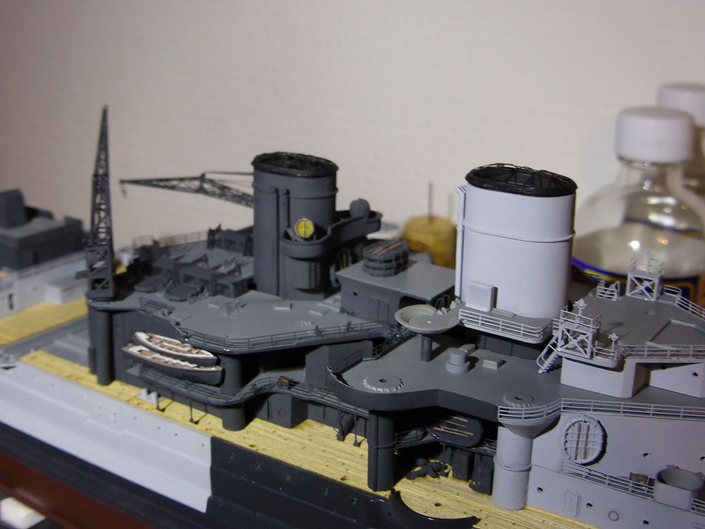

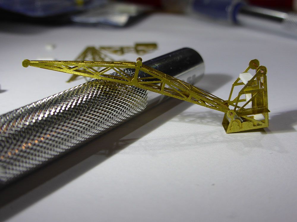

So, the cranes: nice parts by WEM and a little plastic card.
Both get the dark 507 a paint:

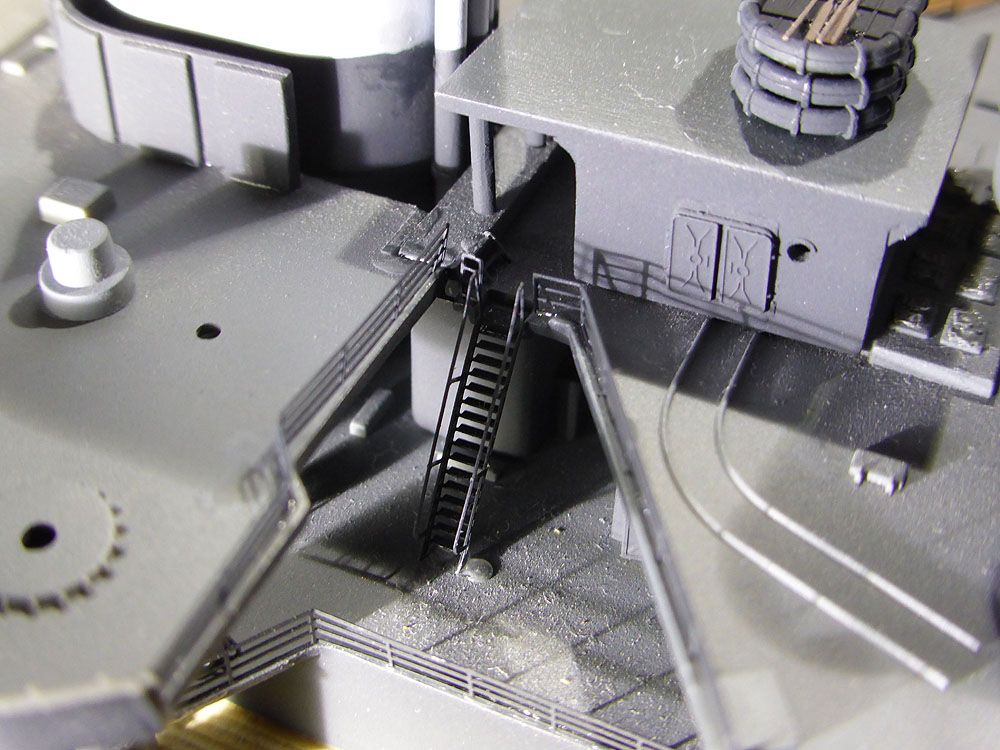

Some more ladders and railings to the higher decks:
- ups, who put all the dust there just amazing what a macro lens pics up...

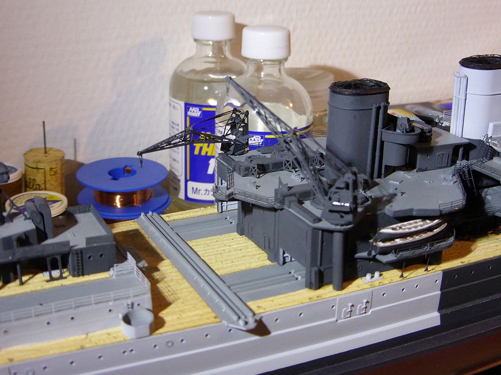

...and the cranes installed. I hope I'm not regretting this...

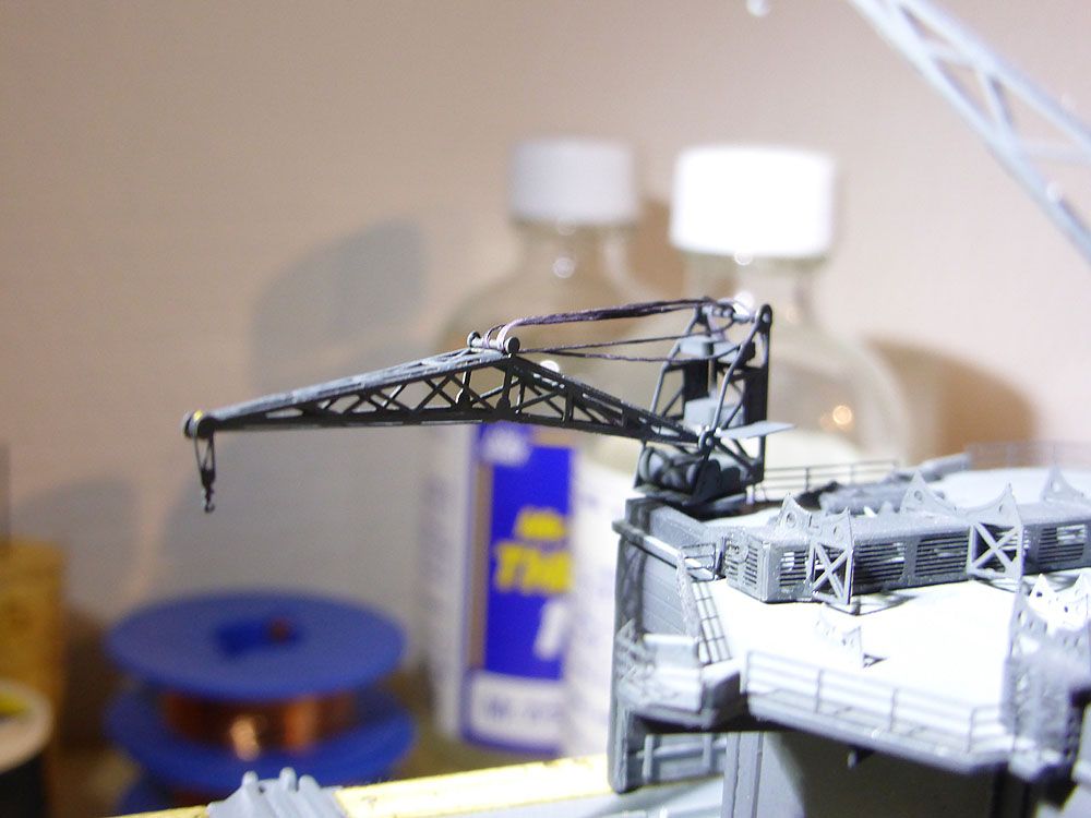

Small modification, I ran my first trials with EZ-line for rigging the cranes. Promising so far, but it looks like they would nee a little weight to get some tension. Will see in 2015 what I can do about it:

The ladders, railings and cranes all look amazing! :-) Those macro lenses sure do show up a lot of detail a magnifier head set does not. Curse that "Evil Dust"
Your EZ line work looks great so far too. If I could offer a tip though, it does need a little tension to look its best. I find that if I trim the EZ line a little shorter than the final length it will need to be rigged at and then dab a little accelerator onto the object I'm going to attach the EZ line to, I can then apply CA to the EZ line and stretch the EZ line to the attachment point and it adheres almost immediately under tension. If I am applying the EZ line to a 'flat' surface I will use a #75 drill and put a small hole in the surface to insert the EZ line into prior to attaching it. Not that I'm trying to tell you how to run your dockyard though.

thank you very much for your kind comment and no worries, you are not telling me how to run my shipyard - the opposite is the truth, I am very grateful for any tip or advise!! And that is in particular true for matters that are new to me like the EZ line. Your tips should be very helpful when it comes to rigging.
With the cranes, however, I kind of outsmarted myself - they are not fix, and are hanging on the lines. I was hoping their weight would suffice to straighten the EZ lines, but they are to light and the lines are to strong. Now, I could either bend them down as to just straighten the lines and then glue them in place, or I could attache some weight - maybe have them lift a plane, or at least attache another line from the hooks to a plane glued on the catapult, or...I am still considering options. If you can follow along the lines I am thinking and have any ideas, please let me know!!
But that will be dealt with only after all the wine has been drunk and the good food has been eaten ... A very Merry Christmas and a happy New Year to you and your family, too!! (and I am hoping for the new Pontos 1/350 Bismarck set, even though this will not be my next build...or let's hope Trumpy makes up their mind and releases a 1/350 NELSON!! Could not agree more with you on that topic!!)

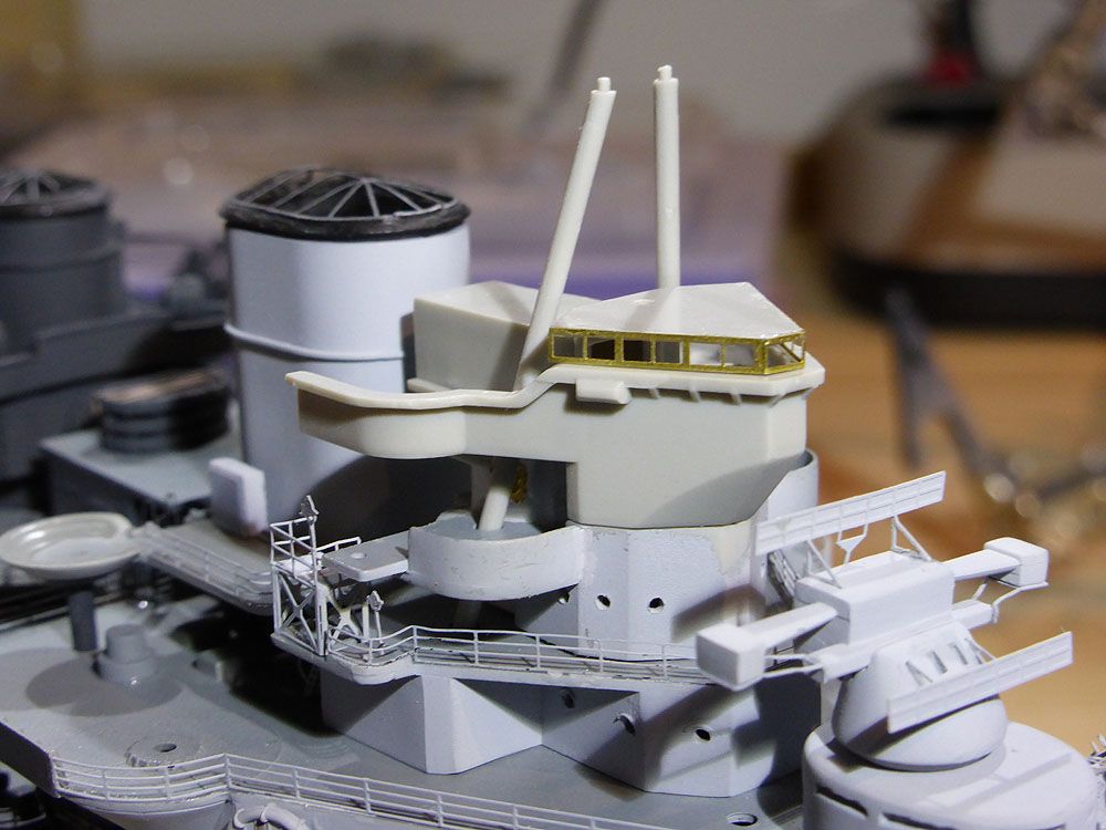

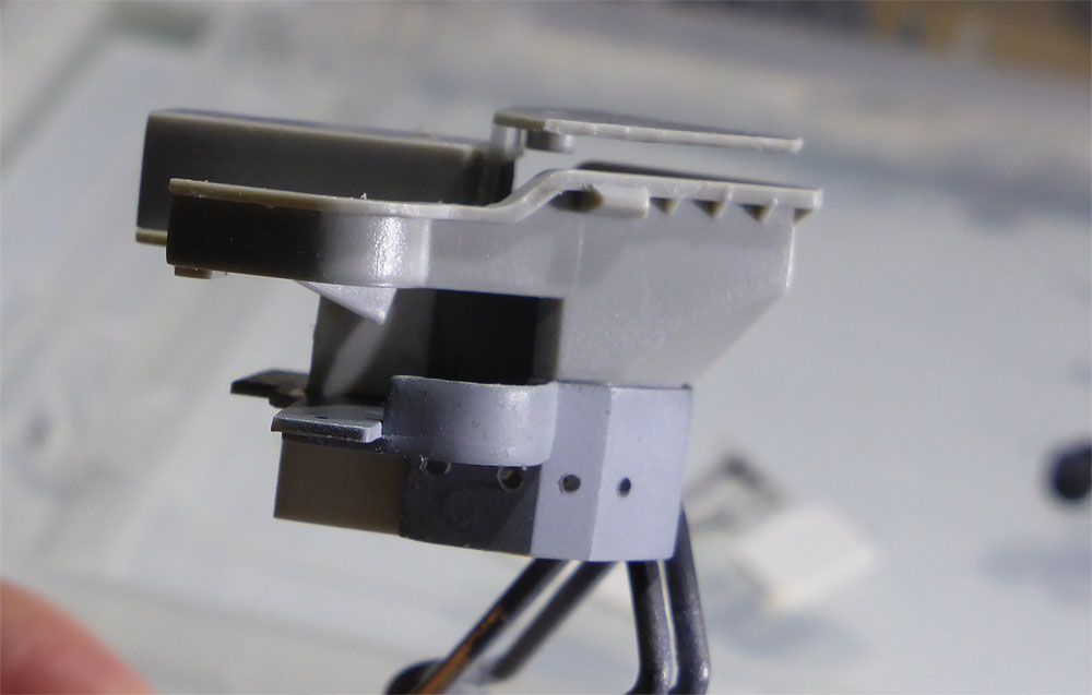

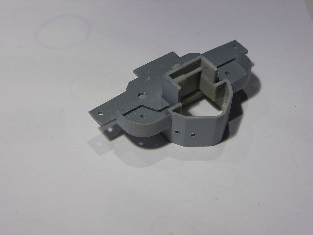

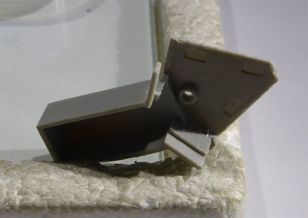

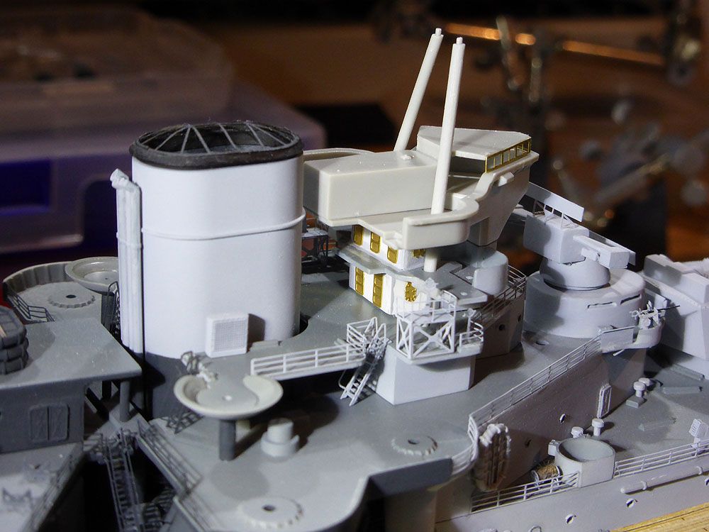

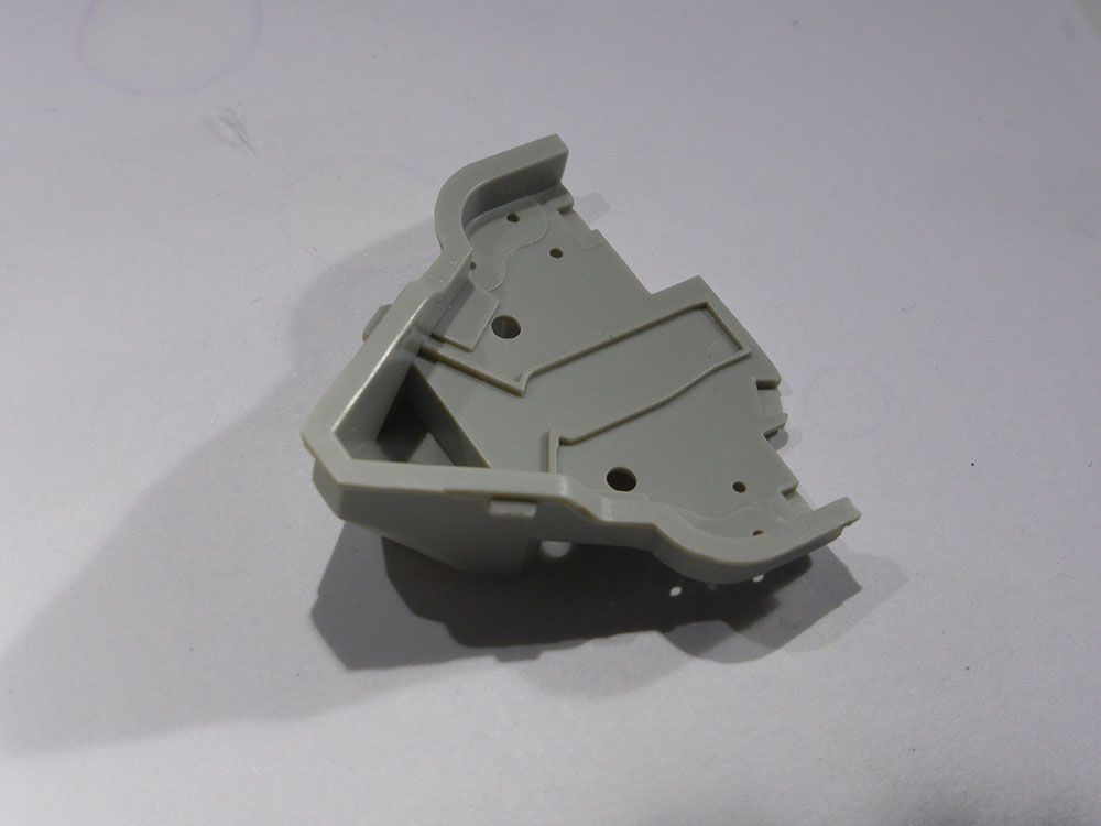

It's all about the bridge/pilot house/compass platform, a rather small area but quite some corrections and creativity necessary since apparently parts of the lower after parts of the bridge are not correct, at least according to plans that I can access and an older build log from a different site that I sometimes use as a helping guideline.

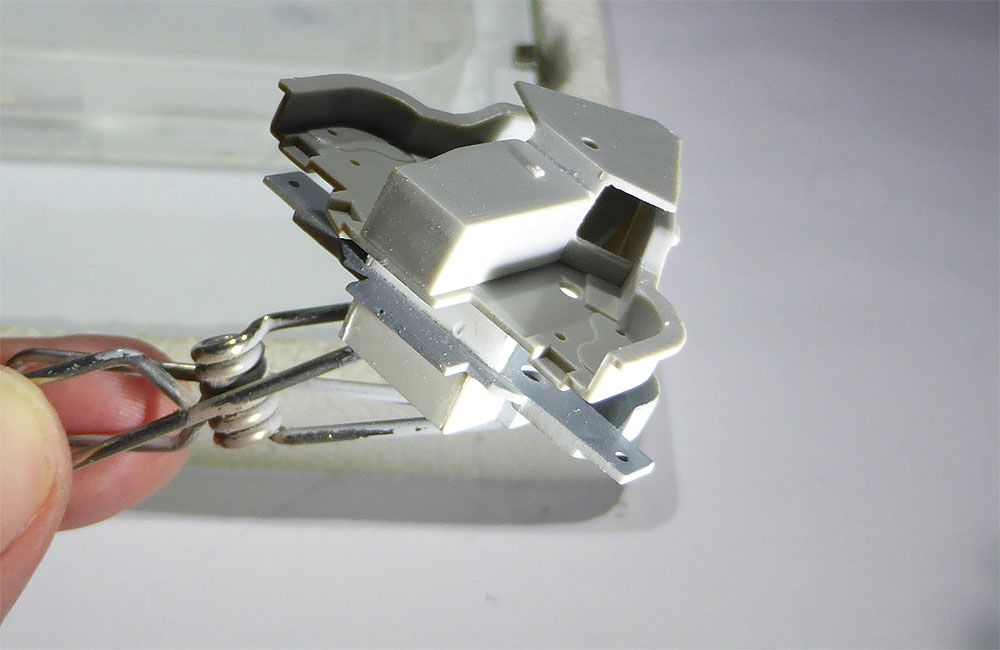

So here's the starting point, a part of the lower bridge, partly assembled and with a first color coat. No worries, that's by no means the final paint!
Here are extensions required, below and above:
Some brass added for effect - no proof of that but sure looks better than plain walls...

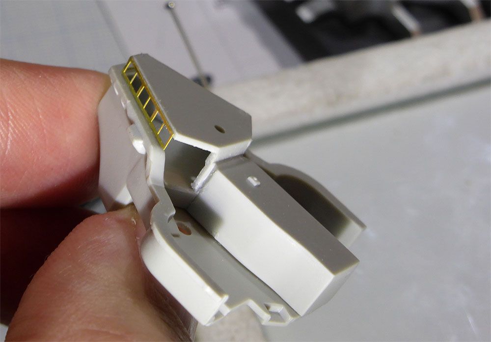

The underside of the next higher level, some molded parts had to go to make room for the extension to the lower deck. Well, some bad ejector markings, but I guess they will be well hidden when installed...

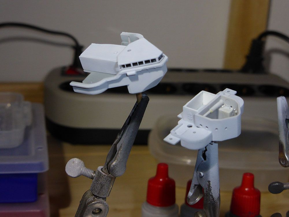

One more deck up, the compass platform (roof). Here, open windows are provided by WEM, so the molded parts have to go. I decided to open the back of it, too, since one plan showed steps leading in on both sides. As in an earlier thread, I believe that the compass platform is a quite open and exposed area. So I try to get this appearance and put some equipment in as well.
Quick impression of the development:

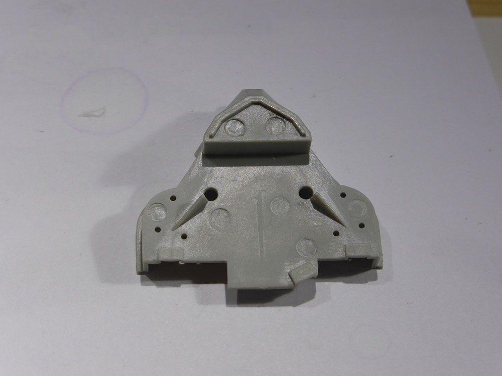

Now these will be inside - anybody can tell that they are German equipment? I don't think that anybody will be able to spot the difference... These are Veteran Models Observation Equipment for DKM, but they'll do...

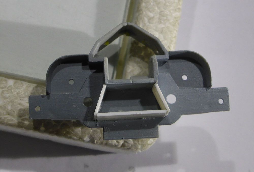

Here's the lower part of the compass platform, since it's not designed to be built open, a new deck has to be installed.
And this would serve as the deck inside:
The WEM windows installed, I will leave them open.

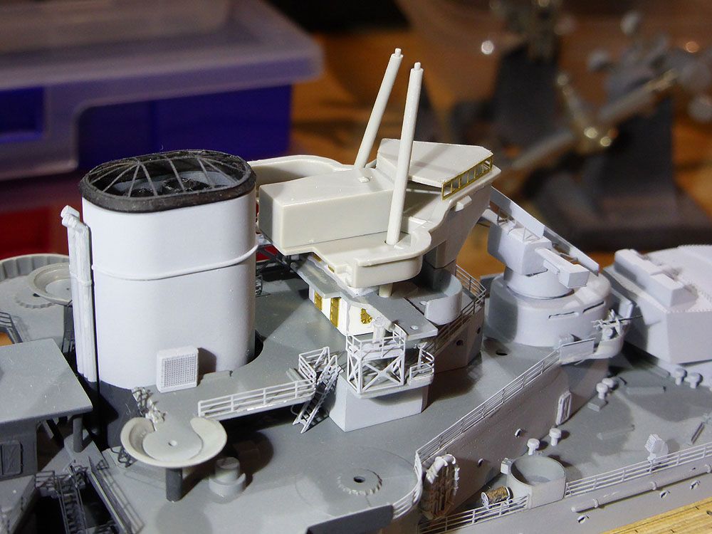

The parts 'as is' provisionally installed, that's where I'm at. For the way ahead I think I will paint each deck/subassembly individually, then install other small equipment, maybe even the railings, then glue everything together. At that point the nasty gap at the front has to be dealt with, but that should be possible without damaging the stuff in the back - I hope... - and finally the inclined ladders etc. will be installed. Not quite sure about the best timing for the railings, though...
Just a few more impressions:

I don't think anybody will notice the German kit, good solution to add missing detail. Good way of doing a bit of what I call "creative gizmology".

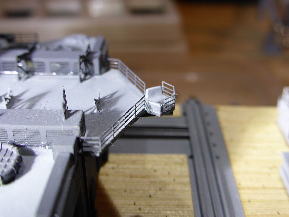

Just a very quick update on yesterday evening's progress, some small stuff (including three inclined ladders from WEM, of which each had a pair of the steps still connected - managed to get them apart with an engraving tool, smallest bit I have for my Proxxon drill. Knife was out of question since the ladders were already bended into shape...) and first color coat on parts of the bridge structure. This will all receive a final paint later, but getting some color on now showed areas that still require some work and allows spraying areas that will not be accessible later on. And it does not hurt.
Should get some more done today and another update today or tomorrow

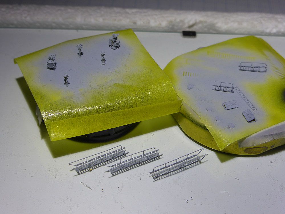

Well, OF COURSE I did not manage to get the update done yesterday...but here it is, with only slight delay

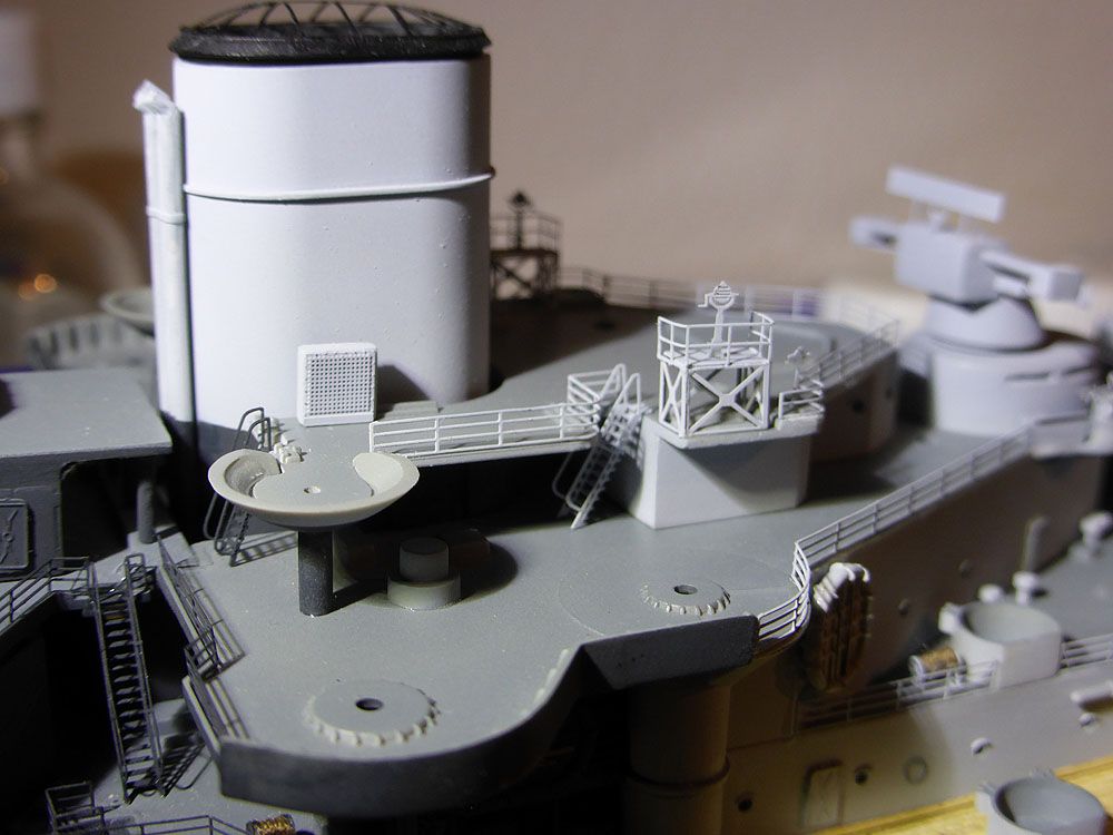

Small stuff...doo-dads as you call them over at the Battleship-Campaign. And quite a few. Don't look like much work, but they are and the grand final of HMS REPULSE apparently becomes pretty doo-dads intense so this is not going to be a quick, bright final but rather a slow and prolonged one... I hope you are ready to bear with me here for another couple of weeks...let's call ist spring
Okay, doo-dads one:
and two:

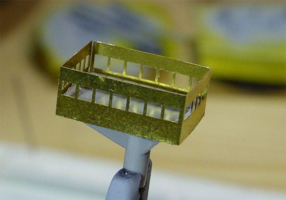

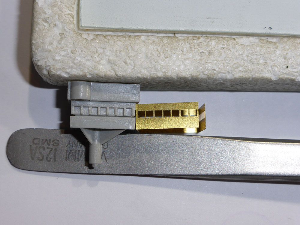

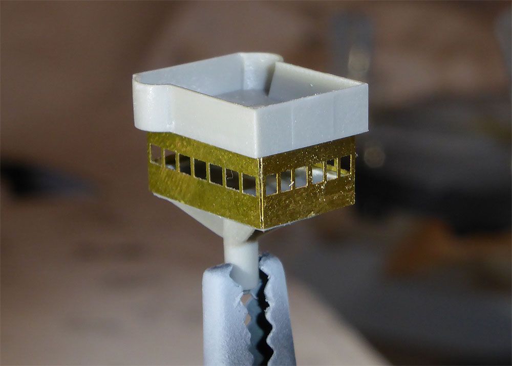

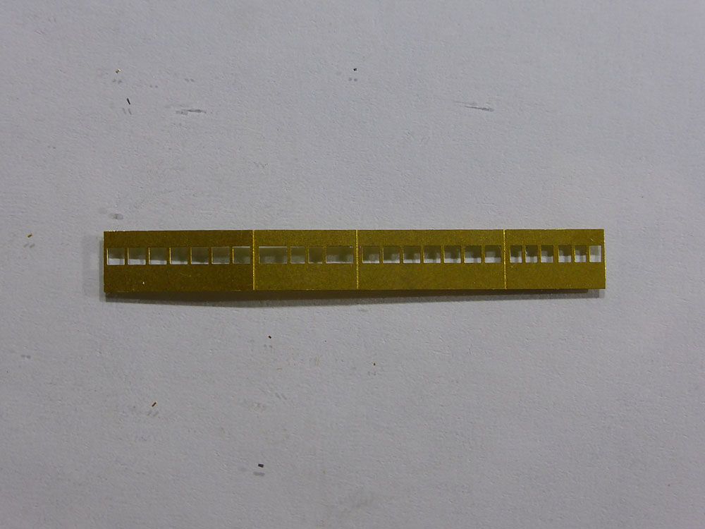

WEM and Eduard give me the unique chance to pick which platforms on the foremast are more apropriate no decision yet...

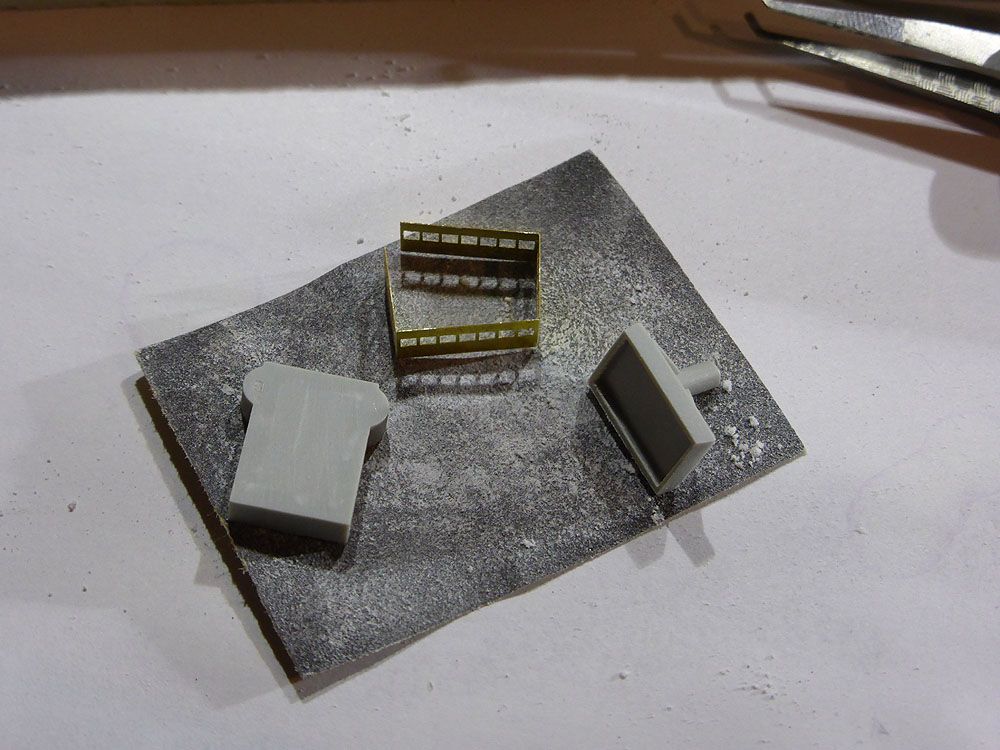

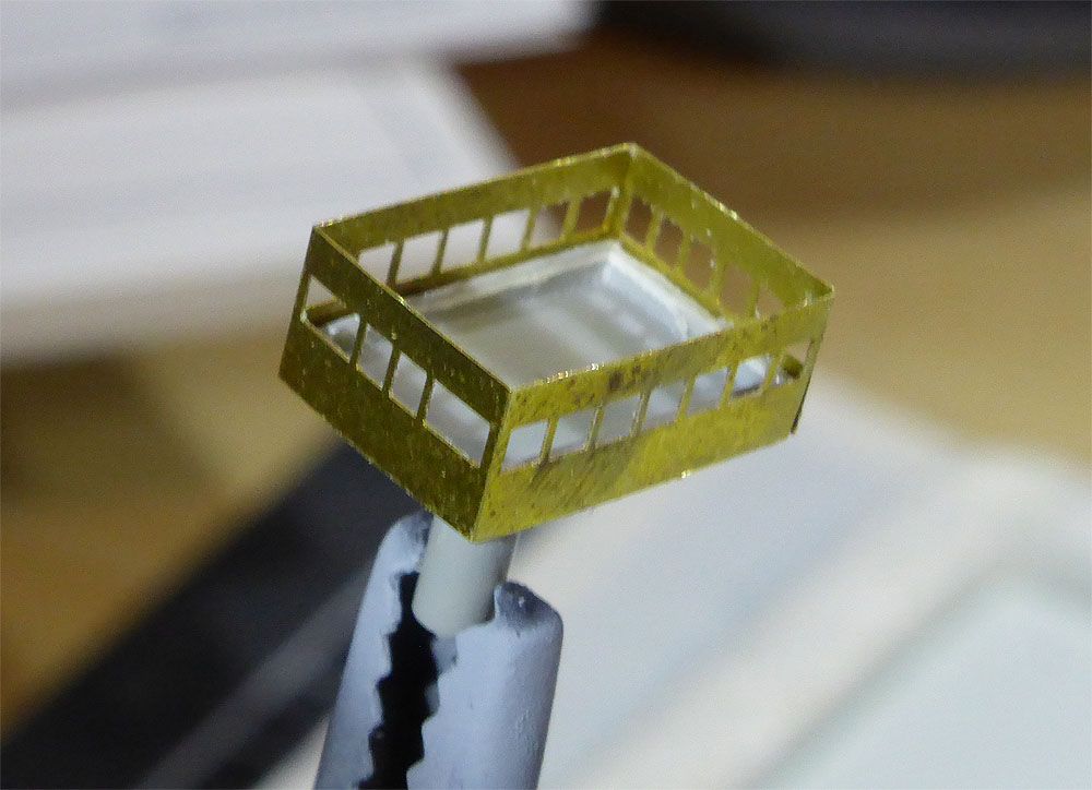

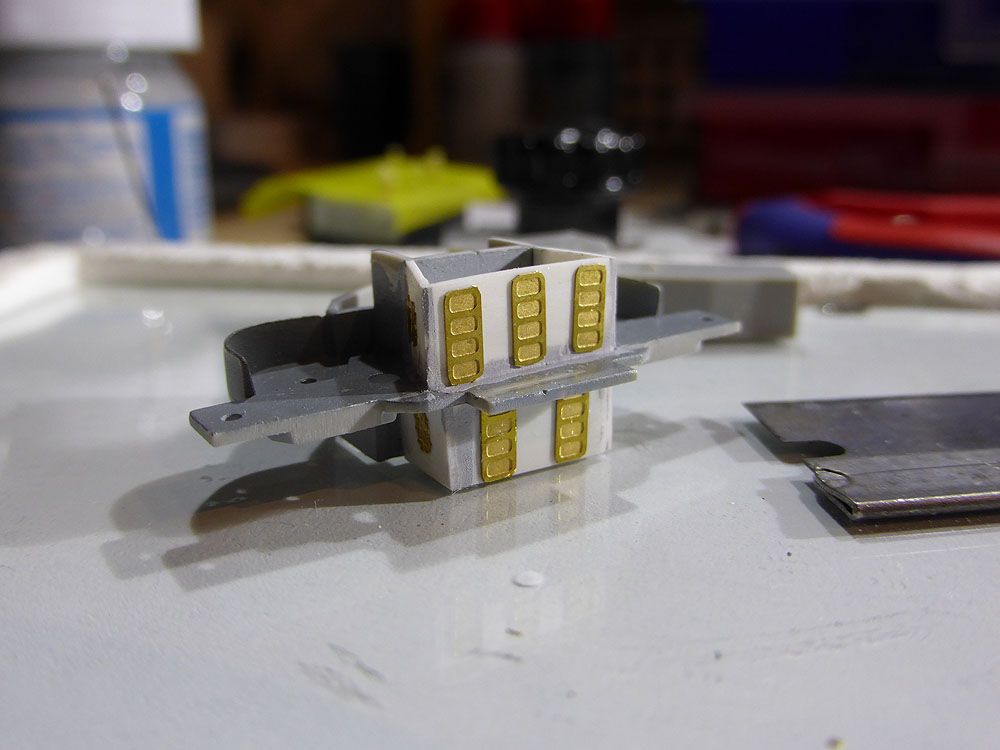

The windows and walls for the spotting top
They have the exact same hight as the combined walls/windows of the kit's part,
so while it is sufficient to cut the walls from the upper part, the PE has to be wrapped around the lower part. This requires grinding down on the sides to account for the PE's material strength. Well, one may discuss whether the slight increase in the spotting top's side would be visible, but: just wrapping it around leaves a nasty gap at the joint. So, grinding down all four sides a fraction of a mm, but done through trial and error...
All parts cleaned and ready

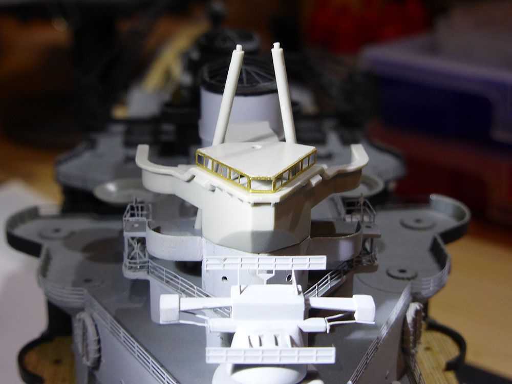

The new walls of the spotting top, some interior to follow
and finally the spotting to, not glued yet, of course:
