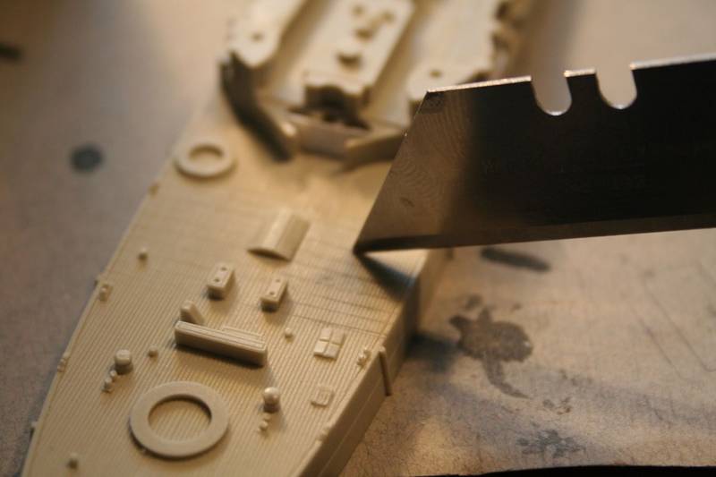

Another problem was the complete lack of any representation of the
cross planking so common to many Russian Capital ships of that era. I
chose to score the deck using a blade, using masking tape as a guide to
assist in keeping the cuts parallel; this was arduous with the
superstructure and other deck fittings cast in place....!

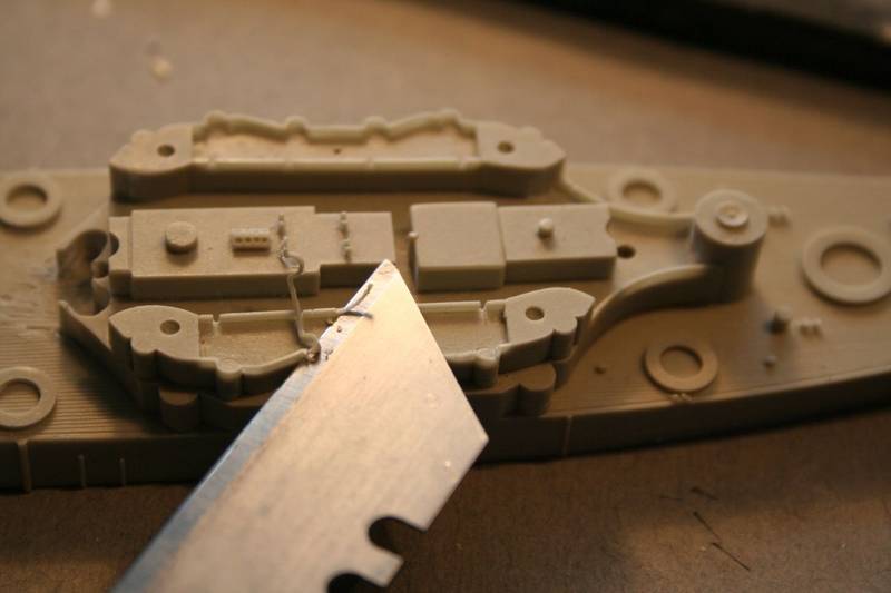

Thereafter all the solid splinter shielding was cut away...

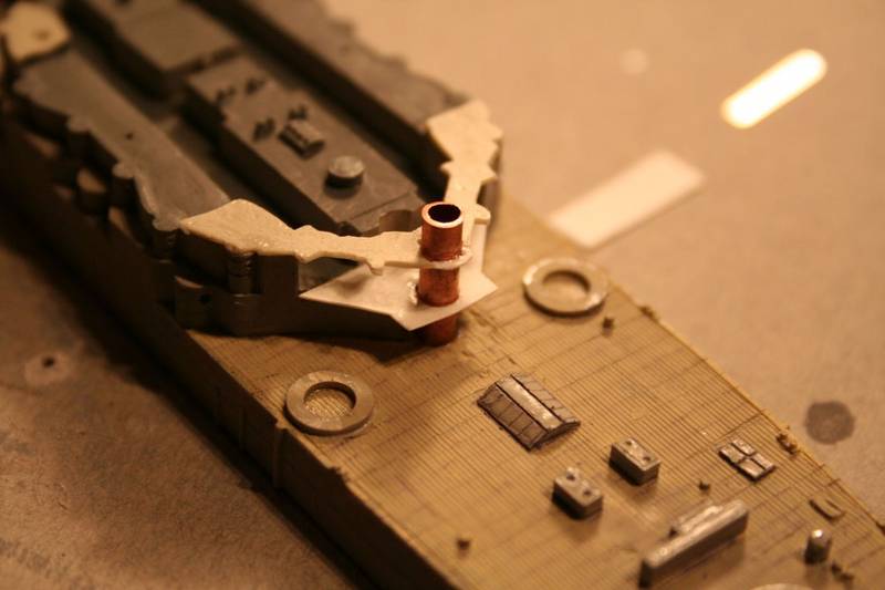

...and construction could begin in earnest. I installed the new aft armored tower and extension deck made from styrene sheet from a paper pattern over a new bulkhead and later furnished the solid splinter shielding of paper.
