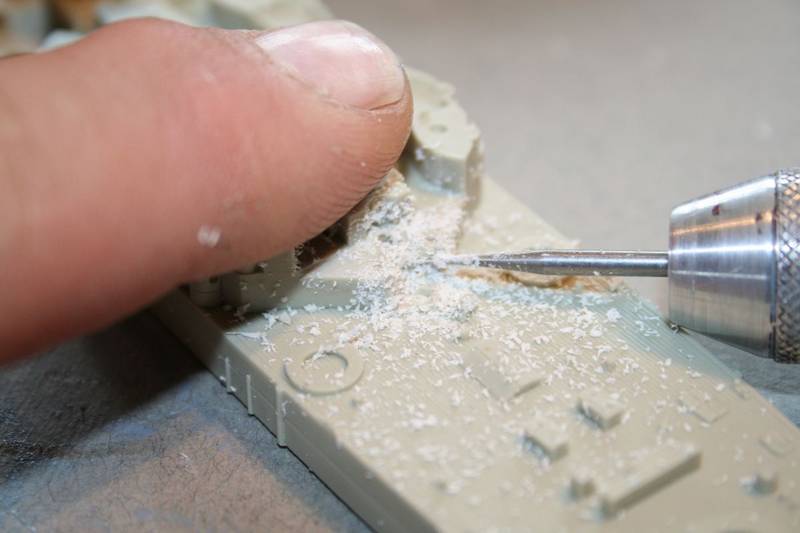

This is an early Kombrig kit and the very first to contain any PE parts--these being essential for the cage masts. The hull was cleanly cast and appeared to be spot on dimensionally. The distinctive sheer line was well captured and the proportions matched drawings and photos I had.
Many hours of close examination of the numerous photographs in excellent Russian Monographs on both imperator Pavel I and Andrei Pervozvanny eventually yielded a few more minor differerences between the sister ships; namely the arrangement of the aft companionways and the cable reel disposition as well as deck vents and hatches. The first hurdle to overcome was the removal of all the numerous cast on ' Aztec' stairways as well as creating the undercut and new decking extension area at the aft superstructure.
Having established a methodology to proceed it was achieved by grinding away at the casting with a motor tool.

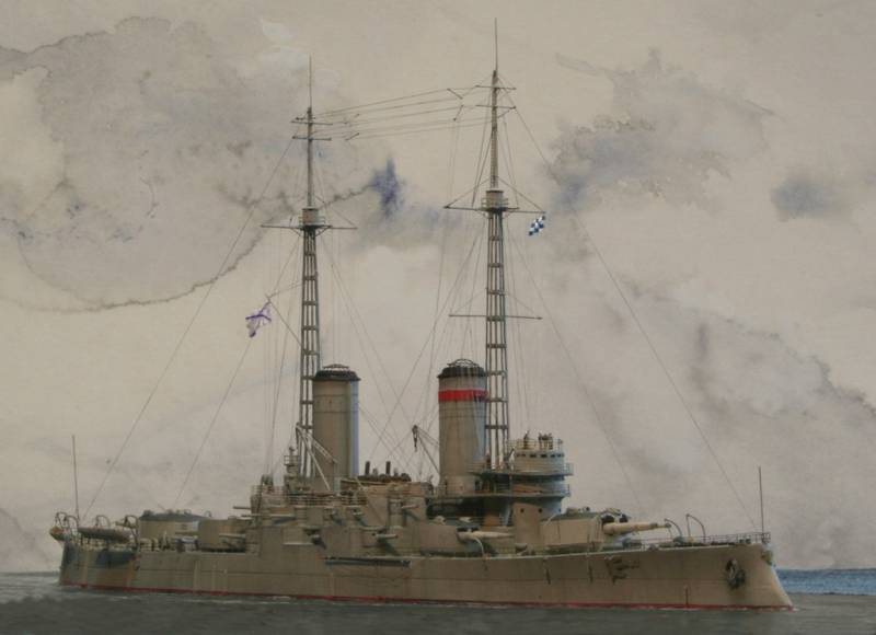

Hi Jim,
An amazing piece of work. Thanks for sharing it's a real gem of a build.
JUL 17, 2007 - 09:08 AM
Jim has done it again!
Every time I see a Feature/presentation or real model from Jim Baumann, is always a delight and the proof that I still have a lot to learn and practice - even if I am not trying to copy Jim's work
Congratulations Jim
Good job Mark
JUL 17, 2007 - 01:22 PM
Truly incredible. I think it was those cable reels, in 1/700, that really got me. I would consider myself good if I could do 1/2 as good on a scale twice as big. Inspiring.
JUL 17, 2007 - 11:06 PM
I agree Rodge!
JB must have seriously keen eyesight AND steady hand! I just look at these little beauties with amazement...
JUL 18, 2007 - 03:27 AM
