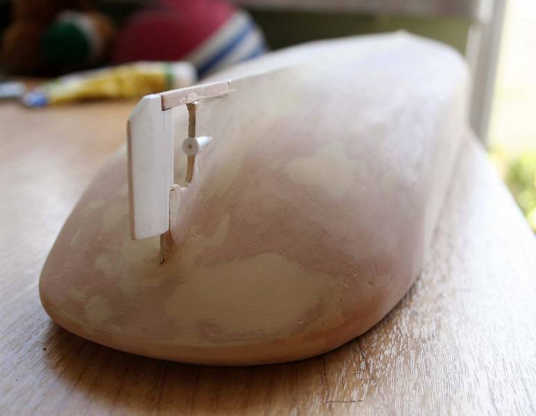

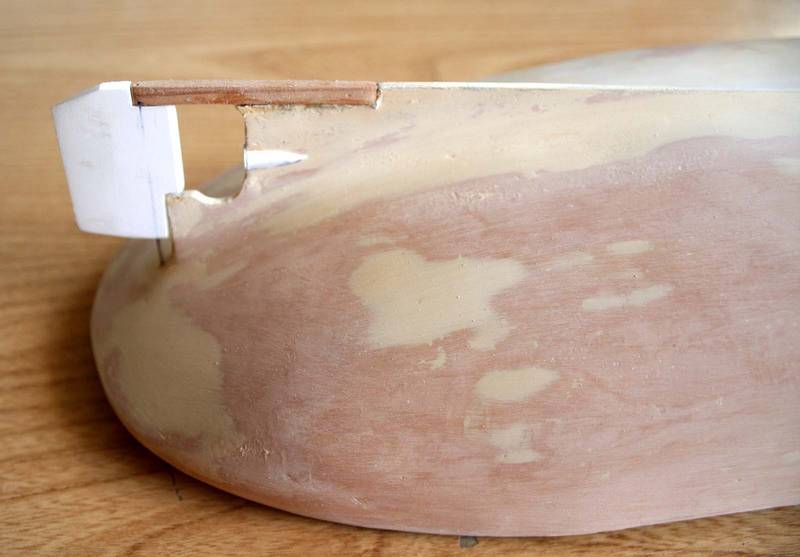

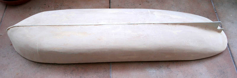

It was the time for the putty. I used acrylic type wood putty so it would not attack the Styrofoam. After every of the three coats I sanded the hull and sealed it with white glue thinned with water.
I also sealed the inside of the tub and the deck so it would not 'drink' too much paint. Then I made the imitation of the propeller shaft housing from styrene sheet: two shaped halves plus disc for the rear of the housing glued to the keel again with polymer glue.
The rudder was made of hard 3mm PVC cut and sanded to the right profile. Then the rudder was secured to the hull with a piece of 1 mm steel tube, placed in appropriate holes. I have replaced the aftermost part of the keel with a piece of wood as the card piece was too stressed from handling. This enclosed the rudder between the hull and another piece of tubing.
