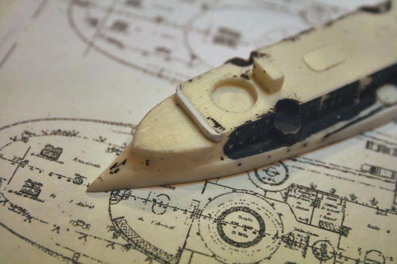

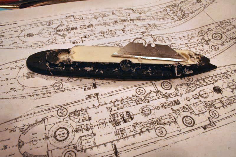

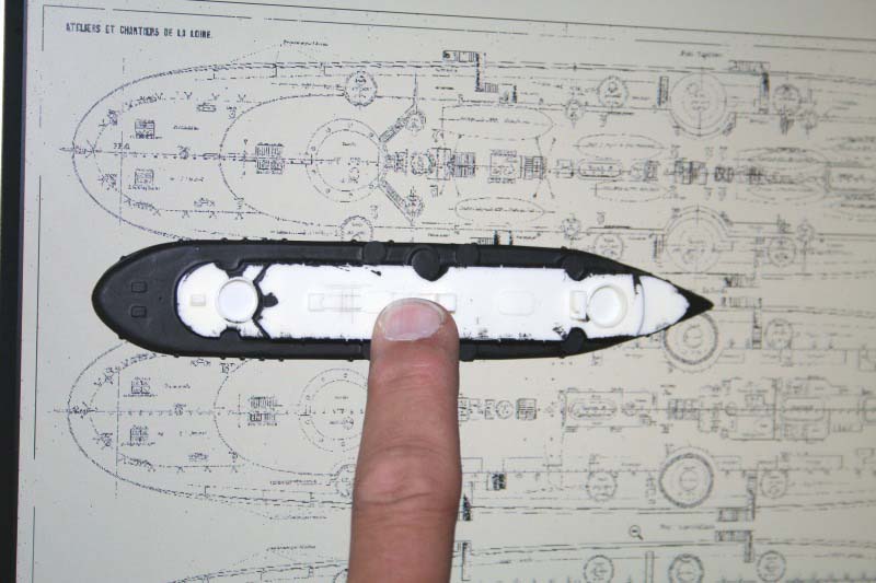

Upon checking the basic dimensions, the length overall was spot on, but the beam was to narrow, superimposing the hull casting onto plans showed the outline of the ship to be parallel when it should have been a gentle curve as well as a stern whose gentle curve was pointed.

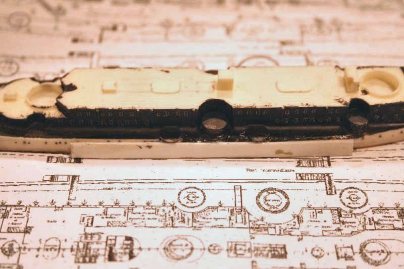

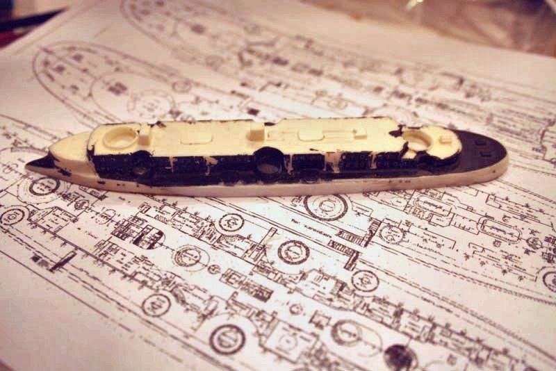

These flaws were rectified by adding styrene strips to the midships areas and fairing in carefully.
The stern and the shape of the stern superstructure was added to with styrene strip, re-profiled, and the deck/hull curve reshaped and sanded along the entire length of the hull.

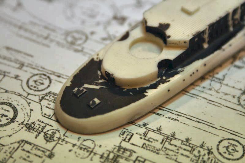

The foredeck was bit too long so the fwd bulkhead was extended and faired.
The intersection of the flat ship sides and the curved bow section was incorrectly shaped and was filled, re-cut and sanded. The snout-bow also had its top ridge sharpened, extended slightly and re-profiled...
