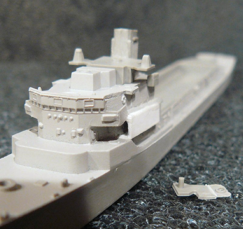

The kit was missing one piece. The sprue number was there, but the part hadn't been molded. It was the piece that attached to the aft end of the aft stack superstructure. Kind of important. After contacting DRAGON Care, they ordered this piece for me and it came from Hong Kong after about five weeks. Another modeler send a replacement piece, to me, in the mean time so that I could continue with my build. When the part arrived from Hong Kong, I sent it to the other modeler friend.

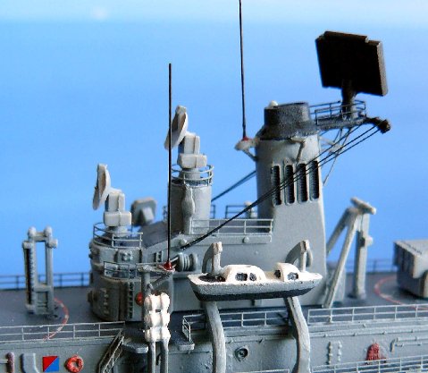

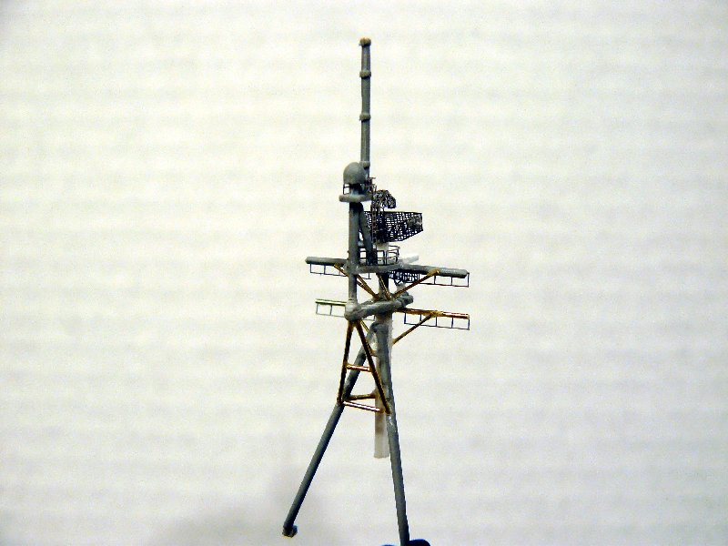

With the Sampson, I had to modify the foremast and detail the aft mast to depict her 1991 configuration.
I also had to add an enclosed companionway on the port side of the O2 level.
The Sampson had an additional antenna stanchion on the starboard side inboard of the whale boat station. I scratch built this, as well.

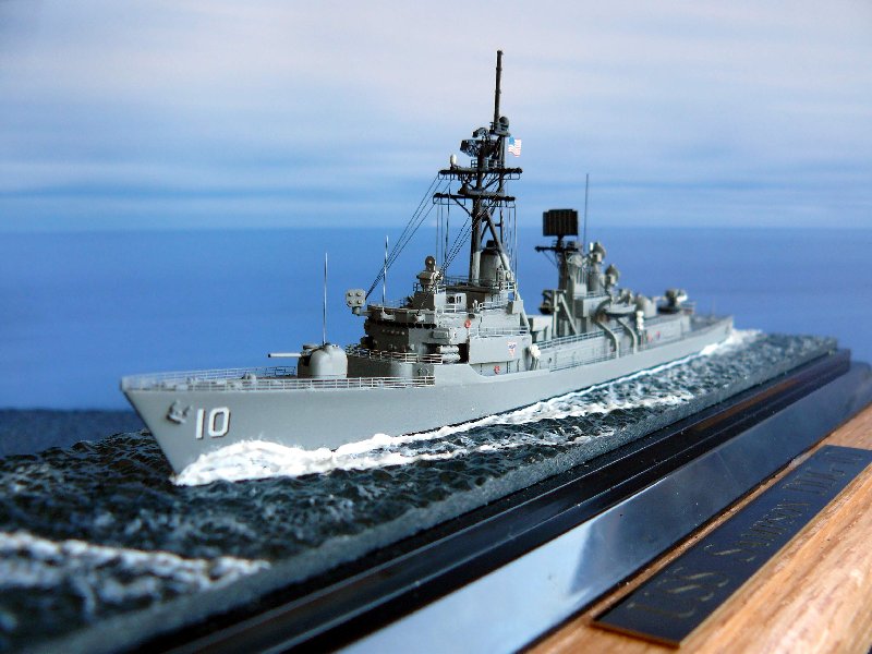

I mounted the ship on TAMIYA's "Ocean Effect Plate A" which is great for 1/700 scale water. I spray painted the under side an appropriate color, sometimes dark sea blue or a dark turquoise. I then applied "LIQUITEX" heavy acrylic gel with a syringe between the model and the waves, to fill in that gap.
I also used the acrylic gel to build up the bow wave and the stern wake and a few extra higher waves, here and there. I then brushed on acrylic flat white for the wake and waves. I followed this up with a brushed on acrylic clear gloss coat over the entire water base. The water effect plate was super glued to an IMEX acrylic display case base which was then epoxy glued to a prepared oak base.
Beautiful display and really great pix, very real effect. Rigging looks mighty sweet too!
