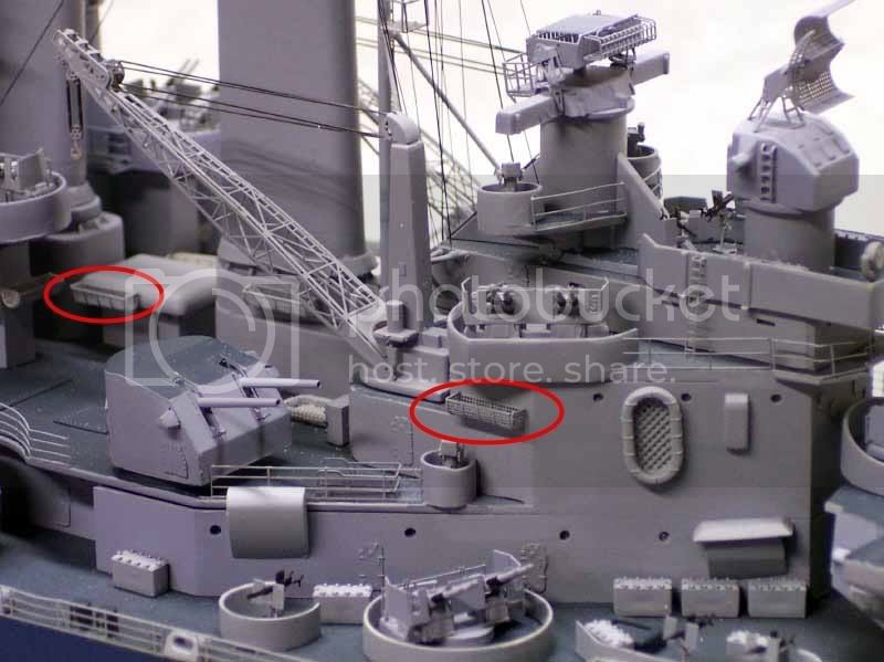

An excellent model indeed!  There appear to be curved basket looking things in a few places, what were these used for on the real ship?
SEP 30, 2008 - 01:08 AM
Anthony,
If you are talking about the things circled their called "Floaternet Baskets"...the baskets contained strings of cork floats used as life-saving equipment by the crew if the ship sank. I didn't add the floats because I could't come up with a way to make them.
