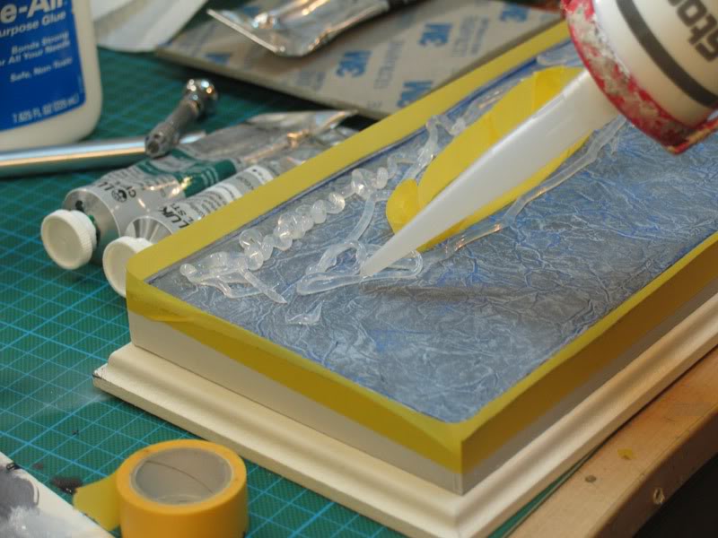

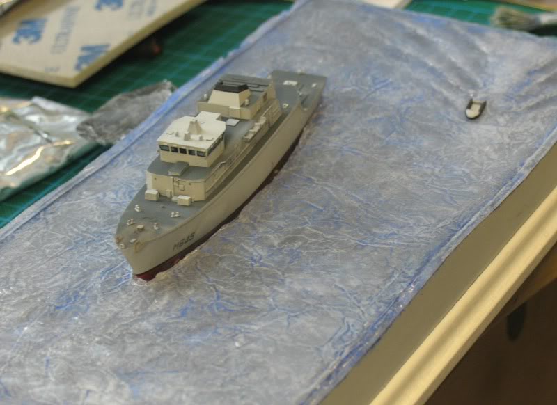

As you work the silicone, you will feel that it begins sticking to everything and being easily pulled up into long strands as you smooth it out... That certainly doesn’t do! To create an even surface, you will need to apply diluted acetic acid. (Wear eye protection and do not overly try to inhale it, it’s not really healthy!).
Where ever the acid touches the silicone it will not stick any longer....you can use your fingertips to smooth over the surface and remove the pulled up strands. Since this process has to be done quickly I didn’t have time to work and take photos simultaneously..30 minutes later you can remove the tapes and make a dry fit test.
