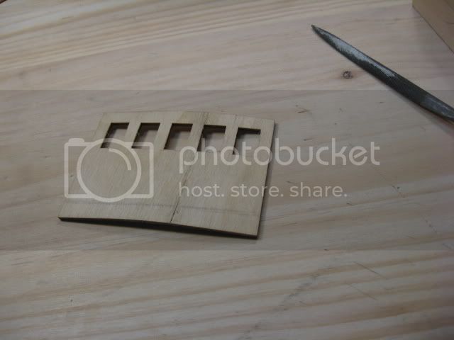

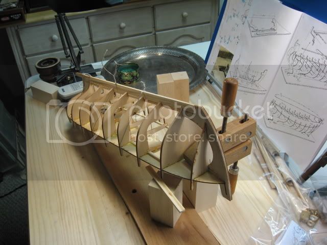

I've come up with some new and interesting ways to clamp and hold stuff along with the conventional ones.
In the last pic. [ yes I soaked the heck out of it ] I broke the front piece of the wheel house. I think that's because the wood is plywood like - many laminates. So I glued it, waited 24 hrs., soaked it again - and broke it again, l.o.l.
Scratch time.
Hull planking is next - which should be as much fun as throwing lawn darts with Stevie Wonder.
Anyway here's where I stand.

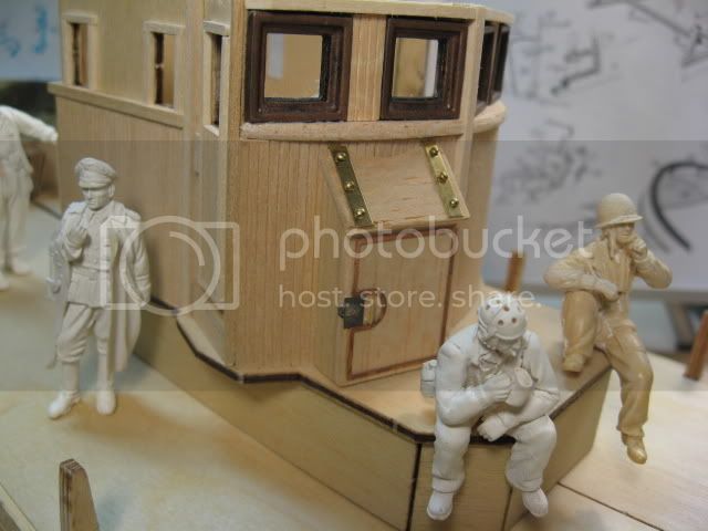

Posted: Friday, March 21, 2008 - 12:32 AM UTC

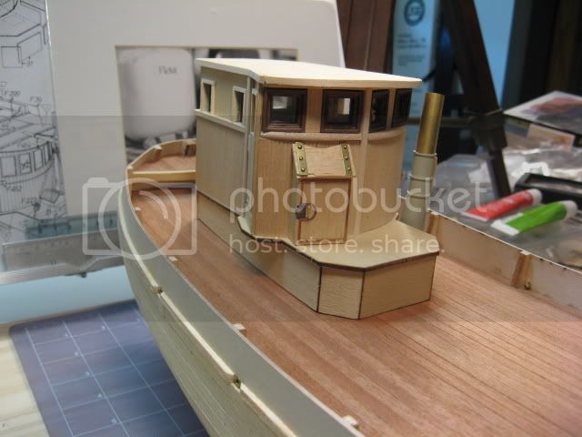

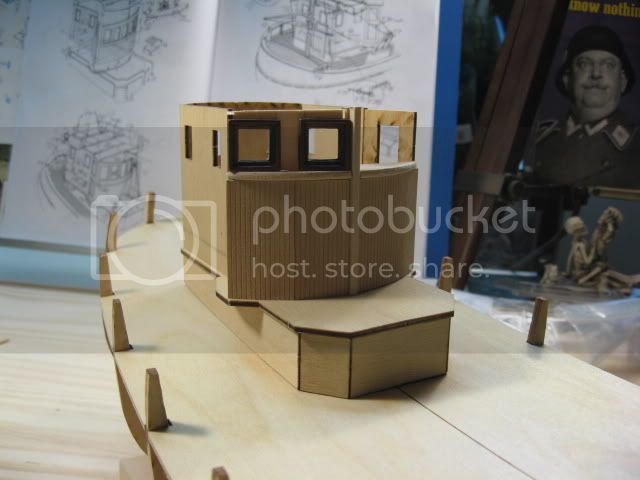

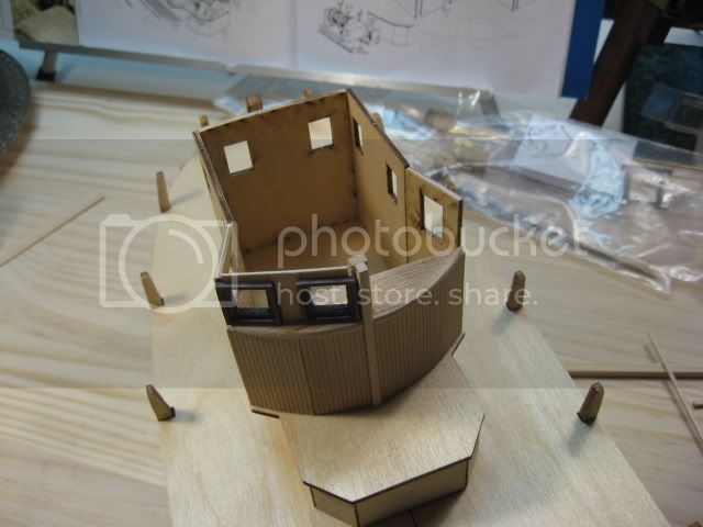

Thanks Gunny, scratched the wheel house front. The windows are actually metal hatches by Artesana Latina made for a smaller scale blow boat.
The wood under the windows split while being clamped and glued. The good part is that it's curved correctly and won't be seen after painting.

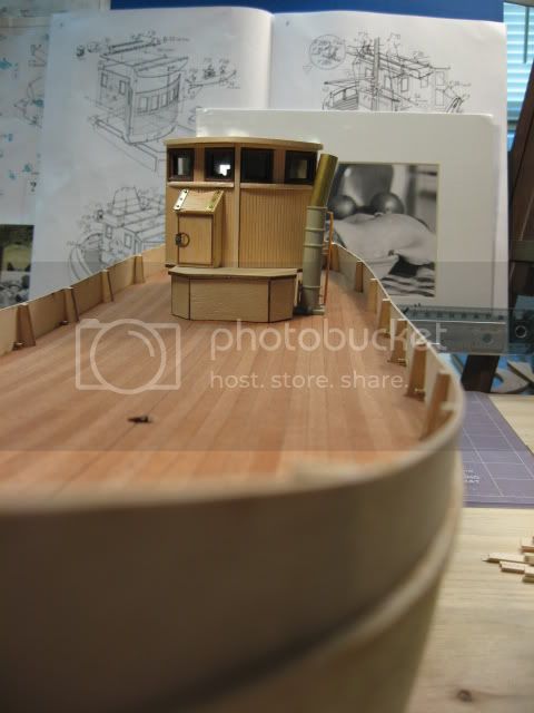

Posted: Friday, March 21, 2008 - 04:23 AM UTC
I've got a question for everyone.
Look at the pic. and tell me if you think the wheelhouse door opens correctly according to the directions for the build.
There is a brown step halfway from the deck to the door and a platform that that extends from under the door.
In this configuration you would be opening the door into yourself on the steps to get into the cabin.
I think the door should open to the left so you could enter the cabin via the stairs while opening the door ? Correct ?
Do you see what I mean ?
Why have the lip and the step if you have to climb around the door to get into the cabin ?
The door can ony open so far and to me it seems that the open door would be in the way of getting into the cabin in this configuration.
Advise would be appreciated.
Glenn
The more I look at it the more I think I'm going to reverse the opening .............. just dosen't look right.
Glenn
Posted: Friday, March 21, 2008 - 08:55 AM UTC
I agree, most definitely, mate...either the door is stated in the instructions as hinged on the wrong side, or the step is in the wrong location...either way, somethings wrong...can the step be moved to the opposite side, Glenn?

Posted: Friday, March 21, 2008 - 09:38 AM UTC
Well, I'm an 'old' Air Force guy, and I don't know much of anything about 'floaty thingies' which will probably be obvious...lol. But, what if the door opens 'in'? Course then the hinges are still wrong, but would work better for the steps. It's just that opening out would seem to have the person leaning back potentially almost over the railing to get around the door. Maybe you could ask "Sgt Schultz" there in the background? "I know nothing, NOTHING!" Anyway, as always Glenn, a masterful work in progress and anxious to see this project develop.

Posted: Friday, March 21, 2008 - 11:33 AM UTC
Gunny, thanks, I thought it was just me.
I switched the arrangement around, the other way just didn't make sense.
Hiya Mike how ya doing ?
The door can't open in because the sweep wouldn't clear the wheel and other controls. The " dashboard " , like them nautical terms ?, also meets the inside of the door by a scale 6 or so inches . That was the first thing I thought of when I checked out the configureation on the box art and promptly gave a Tim Taylor " huuuuh ? "
Thanks guys - Glenn
Thanks guys - Glenn

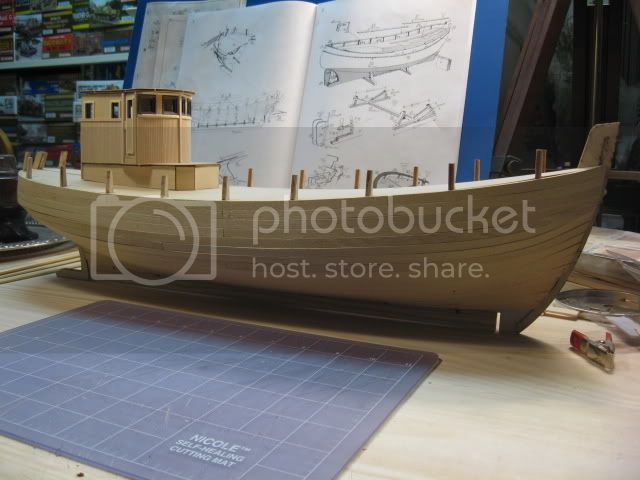

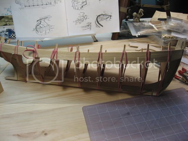

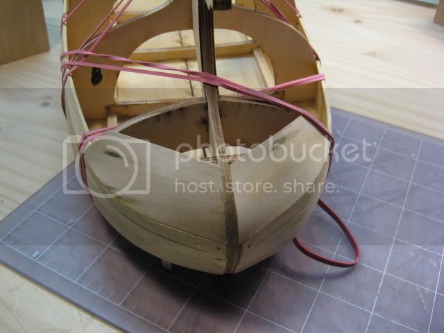

Posted: Sunday, March 30, 2008 - 12:18 AM UTC

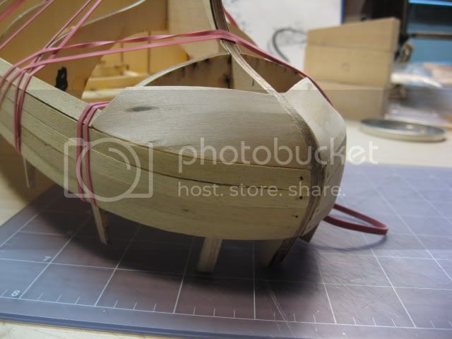

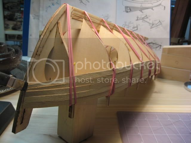

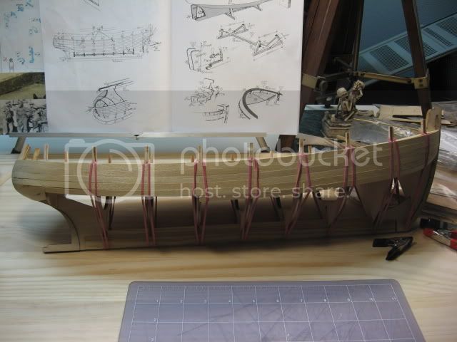

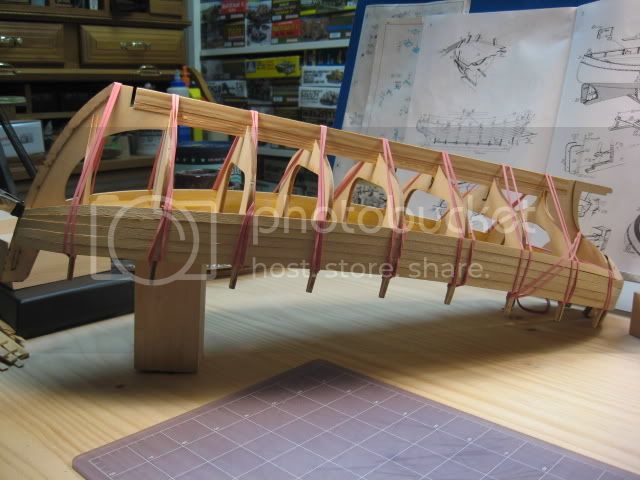

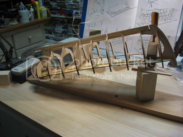

More progress - but slowwwlllyyyy.
No manner of soaking and prebending keeps the hull planks from breaking. The quality of the pine is very poor. I picked one piece up out of the box and it broke !!!!!
The hull under the stern [ rudder attachment ] will have to be done as plate, rivited metal. That's the smooth basswood pieces. Placement of the kit planks would have required a bend and a twist to lay them .................... never happen. I figured I'd better quit and use the metal plate and rivit solution before I ran out of planks.
So its soak, prebend, place on the hull, nail brads in the hull sections to bend the planks and glue .................... oh and then wait. The cat loves the rubber bands.
Here's how far I've come.
The hull sides will need some sanding to flush the planking. Iam going to try and keep the lapstrake effect in the bow area though. I actually can quit planking soon because I'm very near where I need to be for the waterline. Although I may want a semi beached look in the dio, still pondering.
Thanks for looking - Glenn

Posted: Thursday, April 03, 2008 - 12:47 AM UTC
I'm glad I found this one, sorry I missed it.
Glue.... Clamp... wait - don't forget to wait some more.......
These woodies are fun, but slooooow.
You're doing a great job on this one.
I like the rubber band method. I wish I had those built in spars at the top of each bulkhead on my kit. Makes for a great holder.

Posted: Thursday, April 03, 2008 - 11:15 PM UTC
Hi Jean, how are you ?
Wink, [ thanks Gunny ] she was built in 1957, or so the small write up in the directions say. I'll be showing her in Italy in 1944 so some artistic license - Hollywood FX are in play.
The cabin door problem has been solved, it'll be opening out towards the bow. Opening inward dosen't work. The bridge, controls and wheel are in the way of the arc of the sweep.

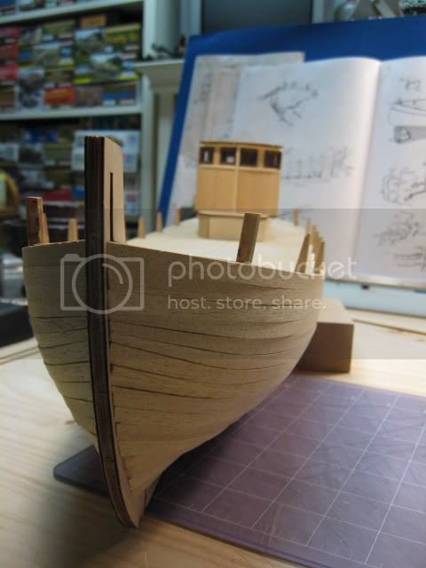

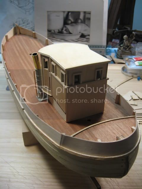

Well the hull is finished and thank god some better progress will be made on the upper works now............................ heh, heh.
Jean, remember these haunting images ? I'd like in incorporate this into the build also. I had to rethink the church/monastery thing and just have the monastery and a small church on a hill overlooking the harbor area.
Moving into the wee room and being in limbo on selling my house and getting larger digs has helped with this new arrangement. I have to live for today and plan a little for the future. Waiting on a larger house will just cramp my building and modeling.

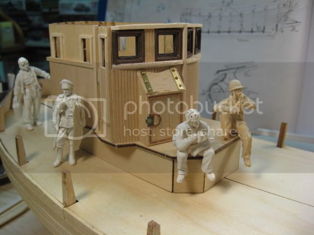

Progress so far .......................

Not much to report . Spent much of yesterday with a little spring cleaning around the Ponderossa.
I did manage to soak and place [ and clamp for 4 hrs. ] the curved stern deck rail. I also added an exterior locker in front of the bridge.
The entire front wall of the cabin is scratch, I broke the kit piece. The dark squares are Artesania Latina hatches with some clear plastic. The entire cabin was just four walls of kit plywood with window cutouts. Everything you see on the exterior was cobbled up from my lumber yard stash.
The brass bit on the exterior locker door is a Tiger screen with some other spare p.e. for the lock hasp. The handle is from an old Tamiya tank.
These are some pics taken last night while watching the news and goofing around with size ref. figs.
One question, I want to arm the ship with something other than the obligatory mgs. I do plan on several on the bow and stern. I was thinking, a shieldless flak 43 or small cal. deck gun, like the Verlinden 5cm kwk l/42 gun.
Any ideas ?
Pics. - thanks again - Glenn

A little more progress.
I decided I didn't like the kit stack, so I went into the parts scrapyard and came up with an old Airfix E Boat torpedo tube and a spare track rack from an old Tamiya PZ IV as a grab rail.
I also didn't like the configuration of the scuppers in the kit and used some eye gussets/rivits from Michaels as the scuppers.
The deck planking went smoothly and is I believe rosewood, [ paper thin ].
The deck siderails needed to be sanded alot to fit and contour to the deck posts.
Well here's where I am so far.
Still no thoughts on some kind of armament other than mgs ?
Thanks for lookin - Glenn
