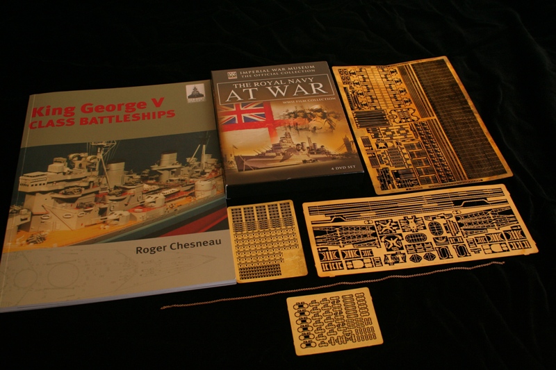

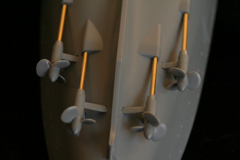

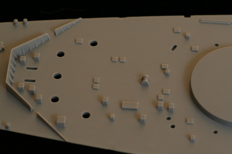

Hi everyone, I think I have the images figured out, so here are some pictures of progress so far.
Tamiya's 1:350 KGV Kit.
Don't ask!

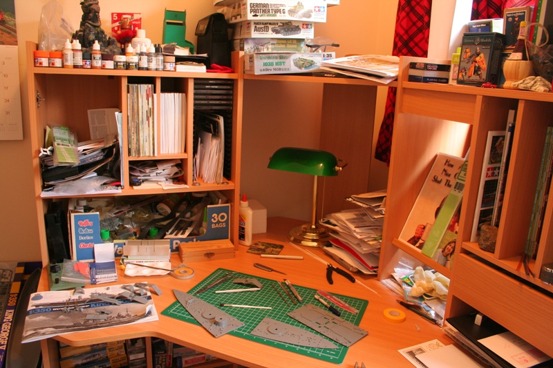

My work area.
White Ensign Model's "Ultimate King George V" photo-etched set, RN Cable Reels set, GMM's 20mm and 40mm gun detail set, anchor chain (which is too big!) that I'll need to replace. My main reference by Chesneau, and an interesting little DVD set that shows some detail of the ships guns, decks, railings and other details around British Navy ships.

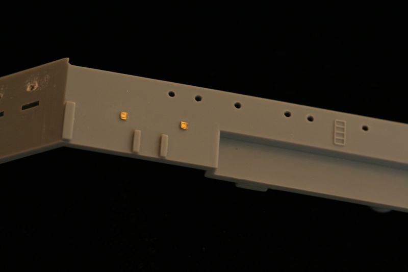

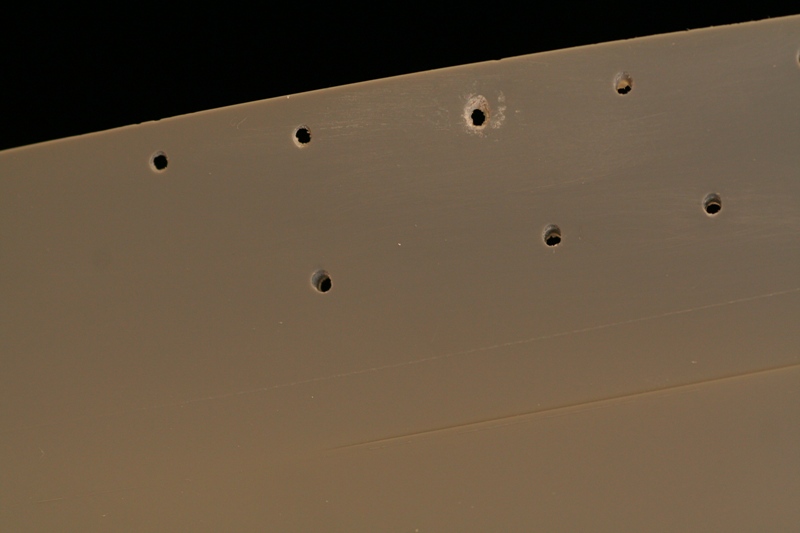

Showing the portholes drilled out (126 on the hull) and the propeller shaft supports.
I used 1/16" brass rod for the shafts.
I ran into some problems with drilling out some portholes. Some portholes were rather elliptical as opposed to circular, so when I drilled them out with the twist drill they appear too large and not circular. I tried to fill them with putty and re-drill them, but the putty I used was more a filler type so crumbled when I re-drilled. I'll try again with Tamiya's epoxy putty and try again. Same problem occurred on some superstructure parts. It seems if the portholes are on an angled part, the mold created an ellipitical shaped hole and not cirucular.

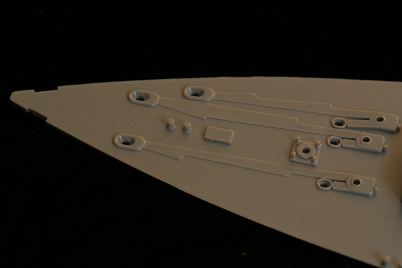

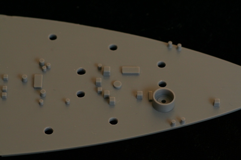

The bow minus molded on anchor chains, and holes drilled out for the insertion of real chain. As stated my chain is too large, it doesn't fit around the capstan well...so I'll look for a smaller size.

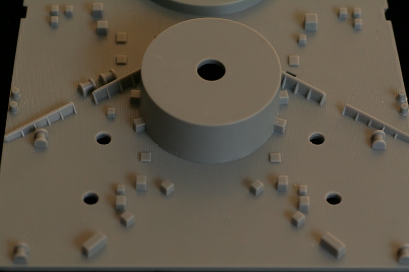

Holes drilled out for the placement of the 20mm Oerlikon gun positions. Also the molded on cable reels will be removed and replaced with photo-etched ones.

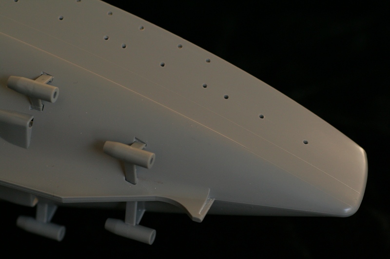

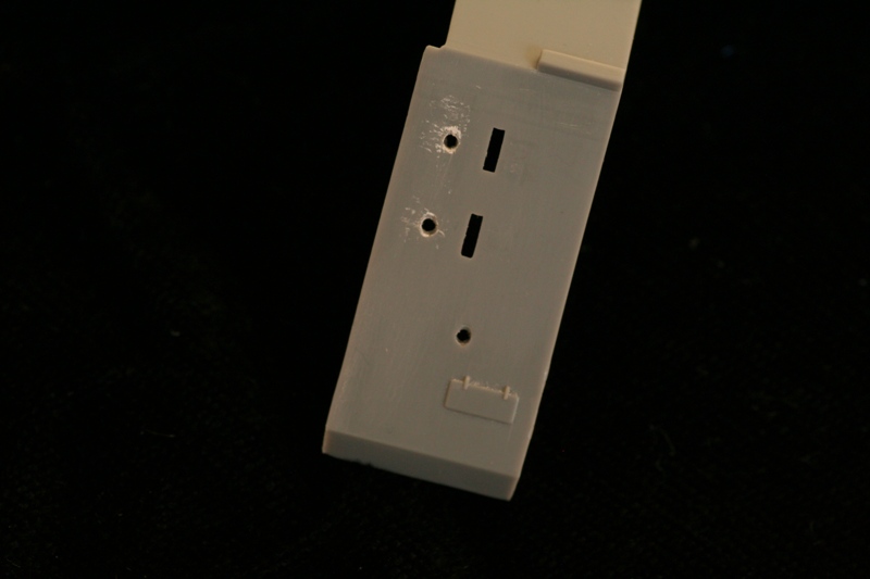

Showing the porthole problem on the superstructure.
Some photo-etched covers added, I have immense respect for the 1:700 PE users...tiny! I've decided to replace the doors & hatches as well, just ordered the set from GMM.

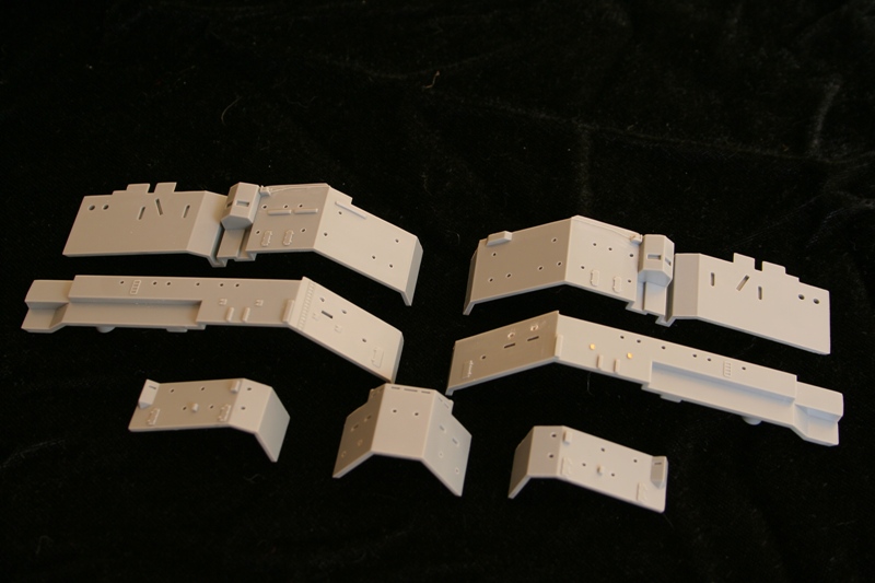

Showing all the superstructure side parts with portholes drill out (57 portholes) Total number of portholes drilled out was 183!
Once I get my porthole issues resolved, I hope to have more substantial progress on the deck taken care of for the next update, and more PE added to the superstructure pieces. Once again, any comments are welcome!

Good luck on the build Joseph, and wow that's a lot of models in that cupboard!
