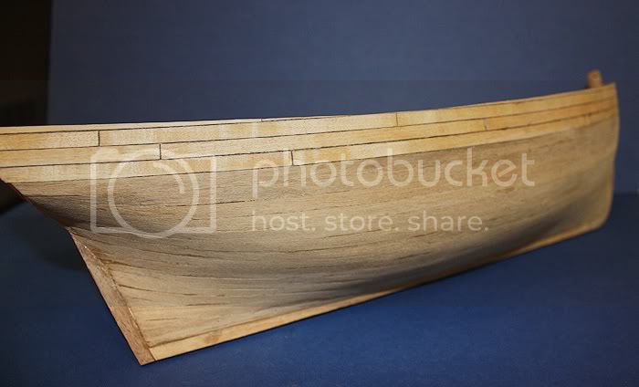

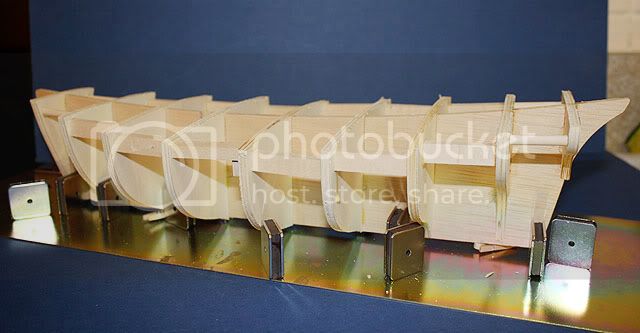

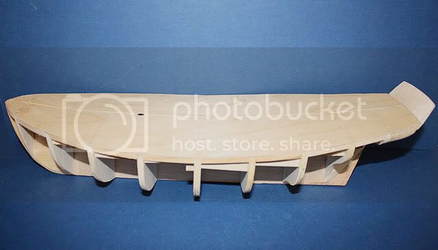

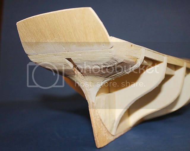

Very nice build so far Robert, When you get to the planking I'd like to see where you start your first run of planking. That bow has a pretty good bend. Keep us posted!!
Joined: December 07, 2004
KitMaker: 1,888 posts
Model Shipwrights: 213 posts
Posted: Friday, August 21, 2009 - 11:28 AM UTC
Thanks Jim, thanks Frank, I will first start with the bulwarks at the top covering that small strip in between the bulkheads and than my first plank will start at the bow under the bulwarks this will be clear once you see it in the pics, i don't for see any problems bending the planks as i will soak them in hot water first for at least one hour this will soften them up and make it easy to bend them with out breaking.

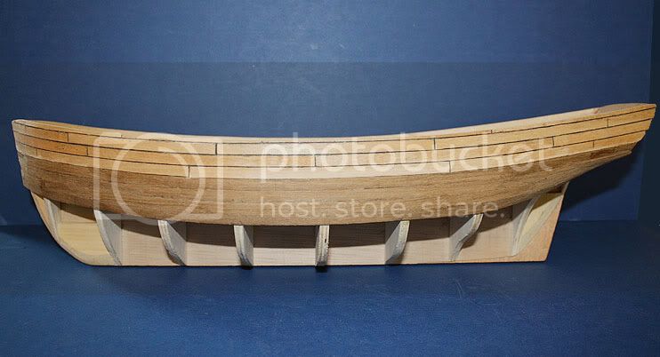

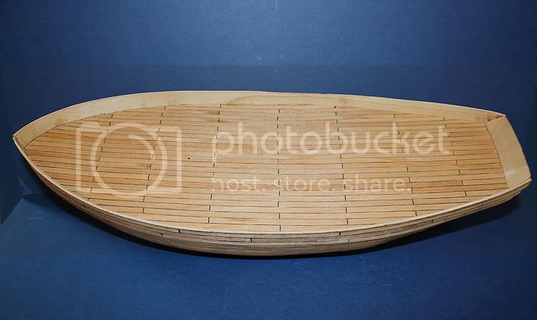

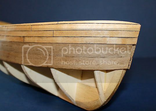

Lookin real good Robert, nice smooth run on the planking. Is there a reason why you ran the shorter planks on ythe bulwarks?(  Looks good!!! )
   Frank
Posted: Thursday, August 27, 2009 - 12:39 PM UTC
Thanks Frank, yes i ran the short upper planks for a little contrast the breaks in the boards give a little visual interest on the light colored planks, i did not do this on the lower planks because they are much darker and the breaks would be more difficult to see also much harder to install the thicker boards under the stress of the curve in the hull,to tell the truth the lower planks are incorrect and would most likely have been done the same way as the upper planks in real life, i don't think they had that many 60 foot boards laying around for such a small inexpensive ship.

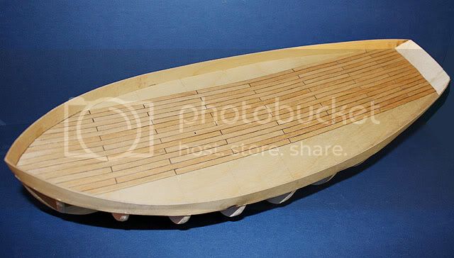

Posted: Wednesday, September 16, 2009 - 12:49 PM UTC

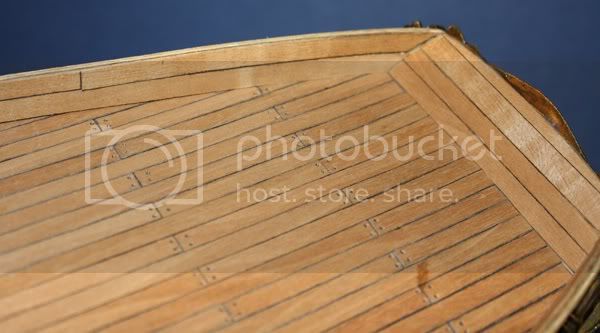

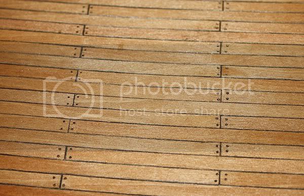

Time for another update, as you can see i finished the decking and i may still add some nail heads, i was trying for a nice cleen look. All comments welcome.

Posted: Thursday, September 17, 2009 - 05:25 AM UTC
Hi Robert,
    You decking is looking really nice. Unless you'er planning to countersink all of those nail heads( Whew!!!!!!) Its probably best leaving them off. I read some where,that instead of using nail heads, They used a pointed tool to make the impressions in the decking, then sanded them lightly. when varnished they look like dowelled decking. Might want to give that a try if you feel real ambitious. !!!!  lol  . Keep the posts comeing
      Frank
Posted: Friday, September 18, 2009 - 12:00 PM UTC
Thanks Frank, I really wasn't going to use real nails i am not that crazy yet but i may use a sharp pencil and press the point into the wood you may be surprised at how good this looks i have done it before.

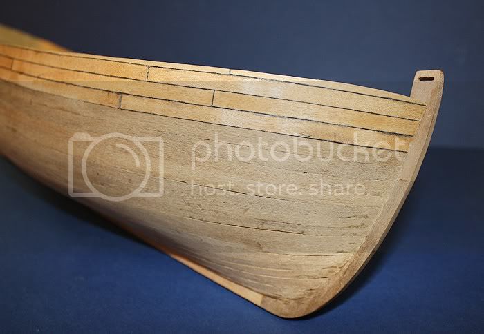

  As you can see from the pics i finished all the planking and installed the stem post, stern post and keel and did most of the heavy sanding still need to fill a few small gaps in the planking and do a final sanding, all comments welcome.

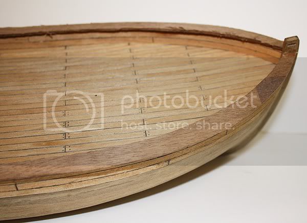

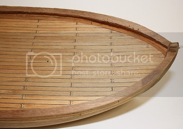

Hi guys i have a small update in the first pic you can see i installed both cap rails i made out of walnut sheet which i cut out with a small saw blade in my dremel in the second pic you can see the finished cap rail in thr forground and the unfinished rail in the backround in it's raw state, next i will finish off the other rail and add a cap to the transome and maybe add a few parts to the bulwarks.
