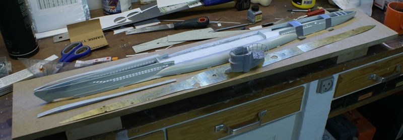

I have had this kit laying around the last 2 years, without really getting anything done. My prime concern was, how to display the boat - initially I planned on shoving it full hull, but making a scene with a full hull boat is somewhat static unless fitted into a dock - so I ended up cutting down the hull to waterline.
Aside from cutting the hull to pieces, I am going to use the modelbrass etch set that among other things, contains a beautiful brass deck. I allso have the CMK update set for the guns and turret and as can be seen the inner hull will be scratched in sheet styrene.
The U-201 returned from its 7th patrol on august the 8th “42 having sunk 6 ships - it was its last patrol with Adelbert Schnee as captain. It will allow me to do the boat as it looked returning to Brest with the double snowman emblem, victory pennants and a lined up crew on the deck - and a heavy weathering after a long patrol around Freetown and in the Atlantic.
Water will be a mix of methods inspired by Tailors builds - sea will be relatively clam with "lazy" waves build up with styropour and plaster - on top will be wrinkled alufoil to depict the smaller waves within the bigger waves, and to finish it off after painting it will get a layer of acrylic gel to ad some depth and seal the boat to the surrounding see.
Cheers/Jan

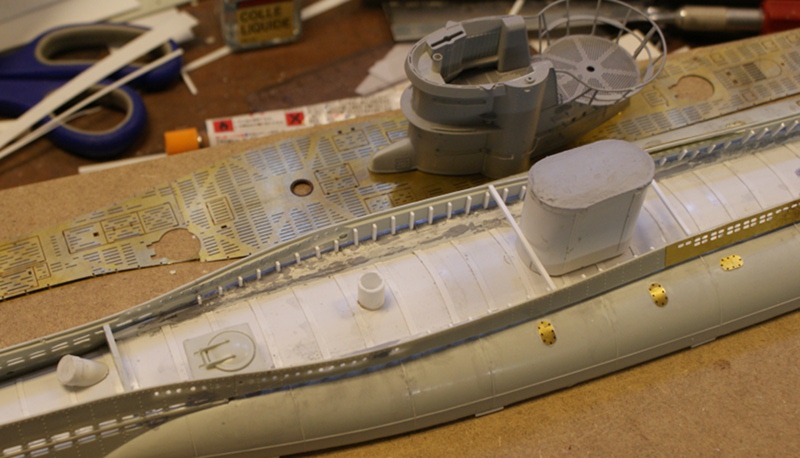

Posted: Saturday, April 17, 2010 - 07:22 AM UTC

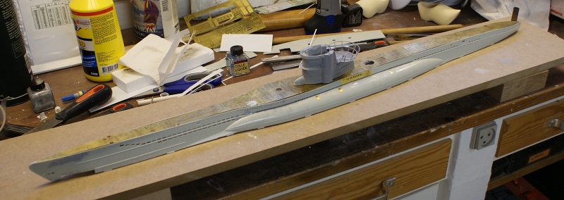

Thanks guys - the P-hull is needed when you build the boat with open floodholes, but only as a representation of the p-hull, as not much is visible trough the small and badly lit floodholes.
The trick is to stop before getting carried away in detailing something that never will be seen again.
As I have put in a new deck in the cunning tower, I will have to scratch the conning tower as it will be visible from above - sweet
Cheers/Jan

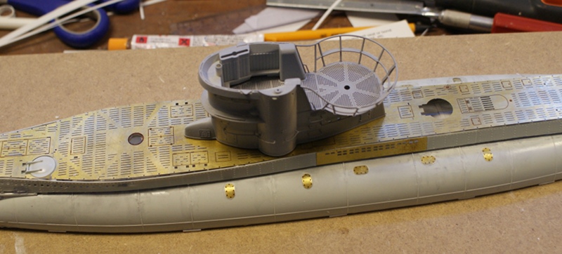

Posted: Wednesday, April 21, 2010 - 08:53 AM UTC

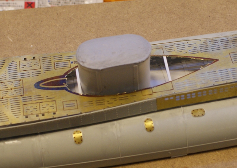

A bit of striptease - slowly building up the innerhull and the combatroom in the tower.
Cheers/Jan

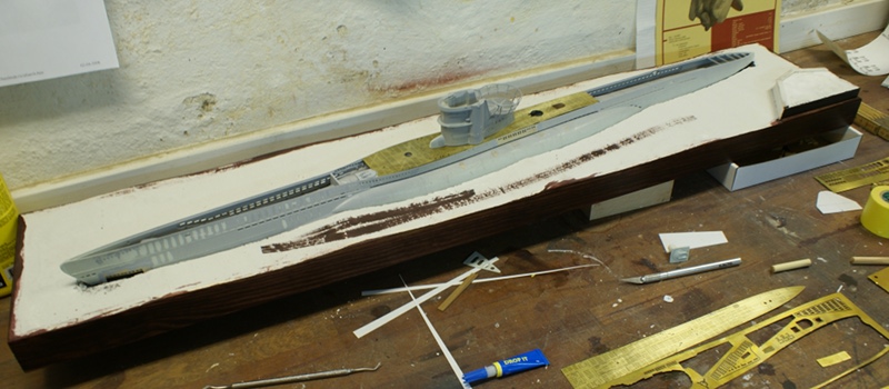

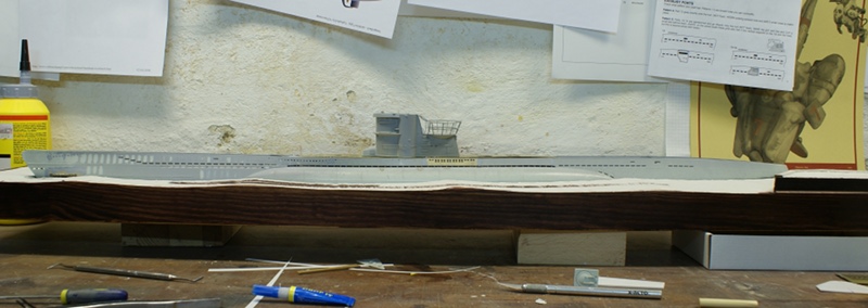

Posted: Monday, May 10, 2010 - 07:07 PM UTC
Been sidetracked by a WWI wingiethingie .... but after proper treatment I am now back on the right track
Been working on the frame on the base and the rough layout of the water. The base is now ready to accept the sub. But before joining the base and the boat, I will have to have the hull done and weathered - the deck will be added later and be painted separately as its will be easier to simulate the dark worn wooddeck when I can handel it without affecting other parts of the buildup.
Well - enough talking - pictures:

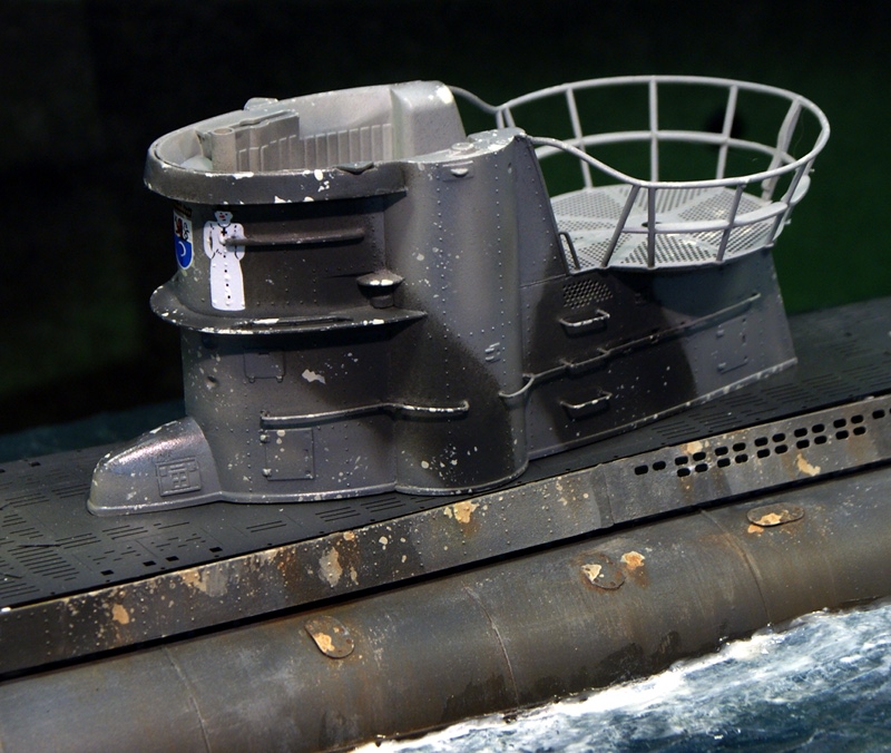

Posted: Thursday, May 13, 2010 - 06:07 AM UTC

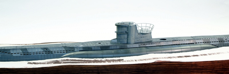

basic paint is on ... the deck is not glued on yet - so its a bit floppy ...

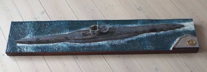

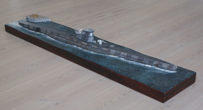

Posted: Tuesday, May 18, 2010 - 04:06 AM UTC

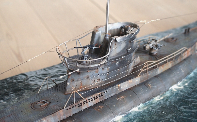

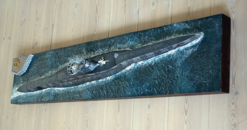

Been working on the hull and integrating it in the water - Alucraft heat barrier for housebuilding glued on, base paint in black, oil paint for the water, highlights in white, gel for transparency and cotton strings for foam.
Turret and deck is still missing weathering
Comments are wellcome
Cheers/Jan
Cheers/Jan

Posted: Saturday, May 22, 2010 - 08:15 PM UTC
Really nice build and display, love the pier/quay corner and emblem/badge.

Posted: Sunday, May 23, 2010 - 05:36 AM UTC
I have to say this one looks really good! Personally I like most of all the calmness of the water...

Posted: Sunday, May 23, 2010 - 10:35 PM UTC

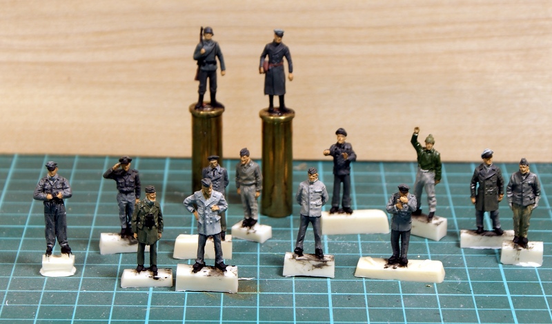

Thanks for the kind words - due to a lot of other activities things are a bit slow on the workbench - but i have been working on the tower, here it is without weathering and the difference to the hull is quite striking, and its clear to see how much oils alter the basic colors - which should be taken into account when laying down the basecolors.
Taking into consideration, that I don“t really fancy doing figures, Its not very smart doing a harbor diorama, where a good deal of the crew would be lined up on deck .... - they are still to get a coat of future and a wash before being finished of with a dullcoat.
Cheers/Jan
Cheers/Jan

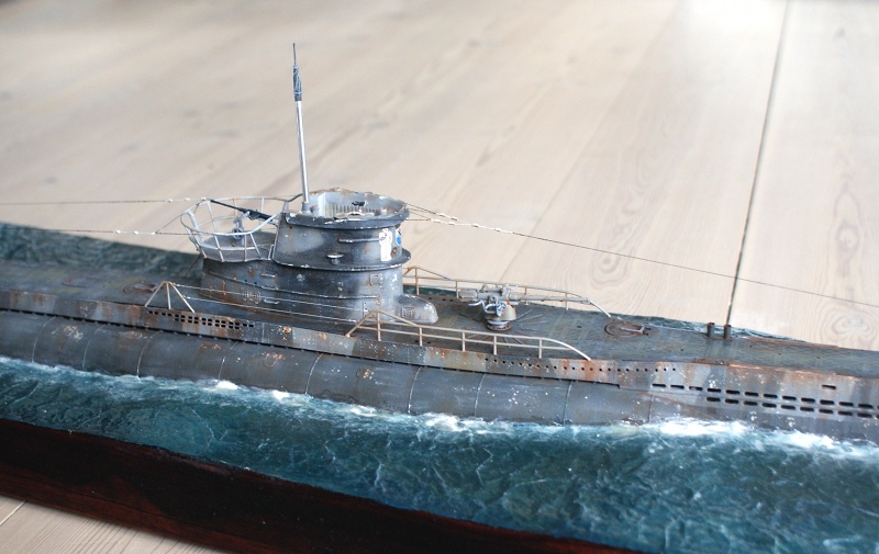

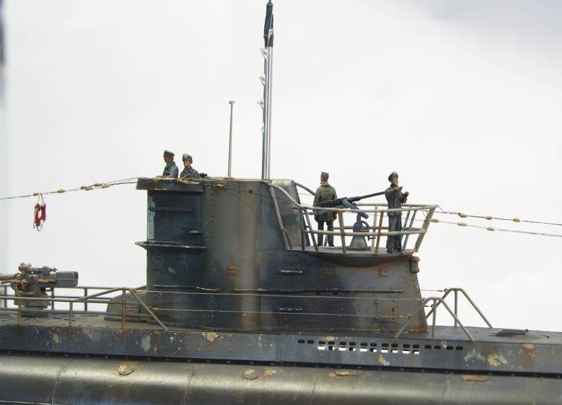

Slowly getting there - the wires still need a wash and the periscope - otherwise its about there....

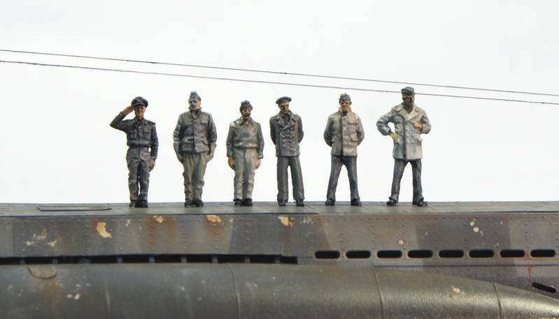

Posted: Sunday, May 30, 2010 - 08:59 AM UTC
Thanks Stephen.

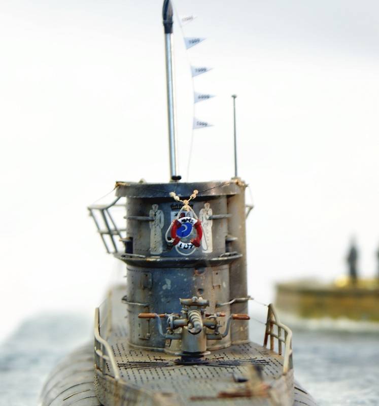

Getting closer
Getting closer
Posted: Sunday, May 30, 2010 - 11:04 AM UTC
Hi Jan
Very impressive work.
I like your figure work especially the painting they are muted and weathered just like the U-Boat.
Well done.
Well done.

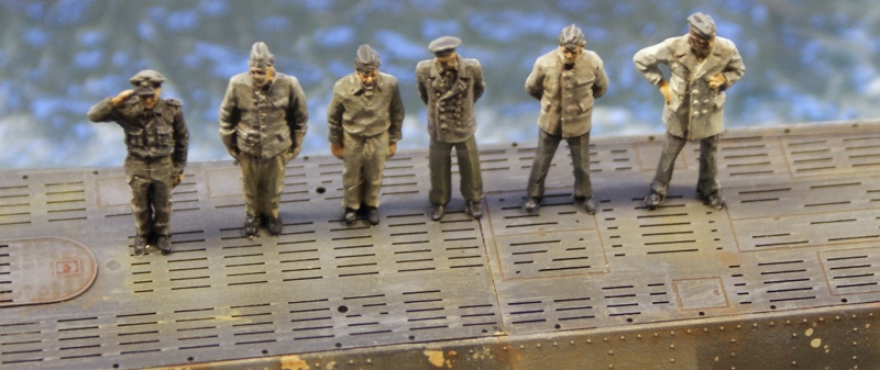

Thanks Sean,
I figured, that after 43 days at sea they would be just as gray as the boat itself
U-boat crews displayed a huge variaty in cloathing - a merry mix of civilian and military gear ranging from read sweathers to light gray leather - functionality seem to allow for a lot thats not in the uniform regulations
Cheers/Jan
Cheers/Jan
