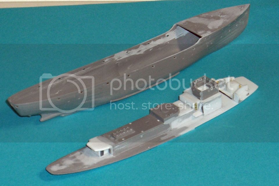

So, excited as I was, I glued together the hull, and
Sinkholes in the aft part (1) Seems to have had a grounding on the way, maybe in the South China Sea.
Resulting in (2): a nasty leak (shortshot)
Not nice but easy to be repaired. Hey, there is no other flower!

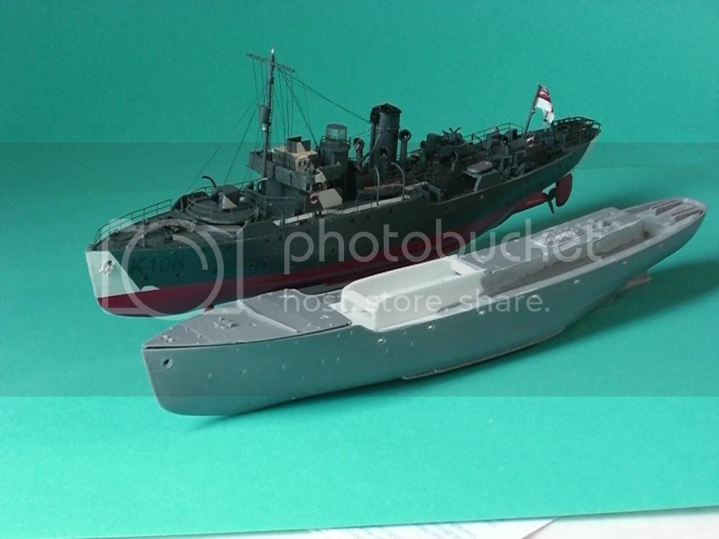

HMS Campion was not equipped as minesweeper, so I had to convert the stern. I made a cut in the stern, softened the corners of the square tuck with hot water and liquid glue, inserted a small wedge in the middle and glued it together again. Sounds more complicate than it is. You cannot just putty, because the deck is open and the bulwark should be kept thin.
The result:
 Note: the little uneven corners are actually lips, which protect the depth charge rails which stick out a bit.

So I mixed a very dark blue grey (AP507a?) for the hull and painted bow and stern off-white. Underwater seems to be red, Deck seems same color like the hull, and the wooden deck in front of the gun looks painted too.
 Decks and funnel are installed already, the fit of the deck on the engine room casing gave me a fit. Beautiful seam, difficult to remove without removing the details.
You can see, that i added the ASDIC transmitter on the keel a bit forward of the main gun position.
