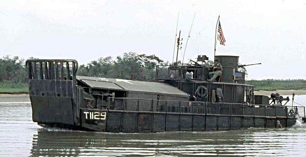

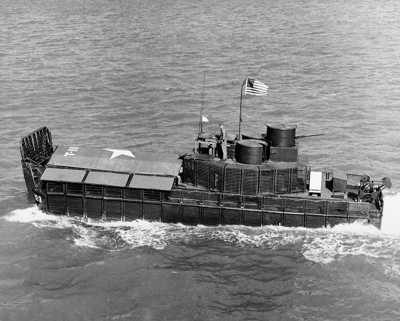

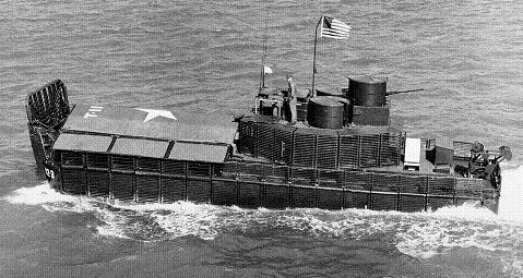

Howdy All,
I've decided, after much thought, to go ahead with my BWN 'Tango' Boat build. It was the very last thing I talked with my friend Garry Beebe about. And in his usual way, he told me not to delay the project, and to build it because it would make me happy.
And since these were the last words we shared together, I am taking his POSITIVE, and supportive suggestion and runnin' with it............
So, just to start things off and not get too long winded about it, I will start off by saying that what I am trying to do is take a recently released 1/35th scale Trumpeter WW II LCM (3) Landing Craft plastic kit and turing it into a Vietnam Era 'Tango' Boat. Also known as an ATC (H). The 'Nam era ATC's, or 'Tango' Boats were converted LCM (6) hulls, which were in turn converted (read, stretched) WW II LCM (3) hulls.
Here is a cross-section, and 'ghost' schematic to maybe give you a better idea of it's configuration........
I've already built my Tango up to the point of reconfiguring, or stretching, the main hull with a scale-accurate (and placement accurate) insert. This 'insert' has been glued to the front and rear hull halves, and putty and sanded down.
I have also built up the internal 'tub' and cut it down to fit in it's new 'deck-level' arrangement.
The front ramp is also built and mocked up, and I am now working on the port and starboard applique ballast additions that the later Tango boats had fitted.
Even though this build is a duplicity of eforts for me, meaning, not only am I building this for Garry, but it is also my lonely effort to generate some burgeoning interest in BWN subject matter, if there is anyone else out there who would like to join in on this wee Group Build.........I would be honoured to have you along
And I don't doubt our good friend Garry will enjoy it from his front row seat.............
Here's to you Garry
regards,
Tread.
More pics to follow..........

Here's a better shot of a Tango in colour. This one's a mine sweeper.

Here's a pic of a standard ATC .

EDIT: Hey Gino, could you rescale your Tango pic down a tad . That way we all don't have to keep scrolling to the right to read posts? Many thx pard.

Gordon,
No idea how to resize the pic. I coppied it off the net and that is how it came out.

No problem Gino, I never used to understand how to resize photos either, but now I've got at least an idea how to do it so I did it for you.
Here's your pic resized......

Gordon,
Thanks. What more can we ask for...A Master Modeller and computer genius too. Good job.
