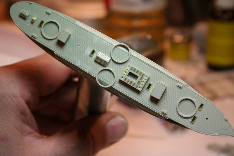

The difficulties of my build of this model, were compounded further by my wishing to build the ship as first commissioned with the full Brig sailing rig; but the kit represents the ship at a later stage of her career. To this end the first major modification was the removal of the cast block of resin which simulates the later fitted light gun platform and making good the deck there under ; builders of this kit who wish to represent the ship later in her career need to do this anyhow -this gun- platform was actually not solid based but supported on a number of columns.
Based on the plans I had, I cut the stairway apertures and lined them with brass, and applied skylight detail, and then carved away various cast stairs and parts that appeared to be incorrectly placed or sized. Then, I applied the funnel base vent cover plates, as well as clad the aft deckhouse in brass " wood" paneling; these were actually WEM PE Askold gun embrasure plates. I had blindly fitted these to the forward lump of resin. But, upon further examination of photos, soon showed me the error of my ways...
The second photo shows the now removed block with the decking re-scored with the tip of a sharp blade
