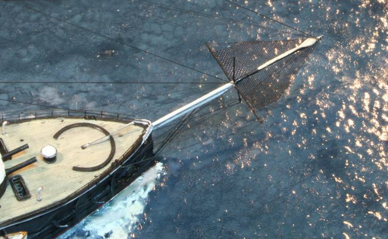

The bowsprit safety net was fashioned from a piece of fine mesh, edged with stretched sprue.
Where appropriate, the standing rigging was tightened by shrinking with my usual incense- smoke method...I spent over 40 hours rigging the model...!!
I was very tempted to rig some sails, however, the photos I have show the sails only deployed whilst at anchor...perhaps for drying or training..?
The Tsarist Naval ensign was made using a piece of light cartridge paper and a blue ball-point pen, crumpled to simulate the flag fluttering in the breeze.
The ship was mounted on a stainless steel plate covered in artist’s watercolor textured paper. I used Humbrol paints throughout, Black and White; except for the Funnel, Revell Matt 19. The deck was done in radome tan, covered with a light coat of Humbrol Oak satin, and dry brushed over with WEM Teak.
I mounted the model at a very early stage, so as to minimize handling, and thereby lessening consequent damage to rigging. All in all a tricky, but ultimately satisfactory, model to build. The Kombrig kit is an earlier effort from that firm, yet despite its vintage and simplifications, it is still a valid starting point, more so if one where to build a later version.
