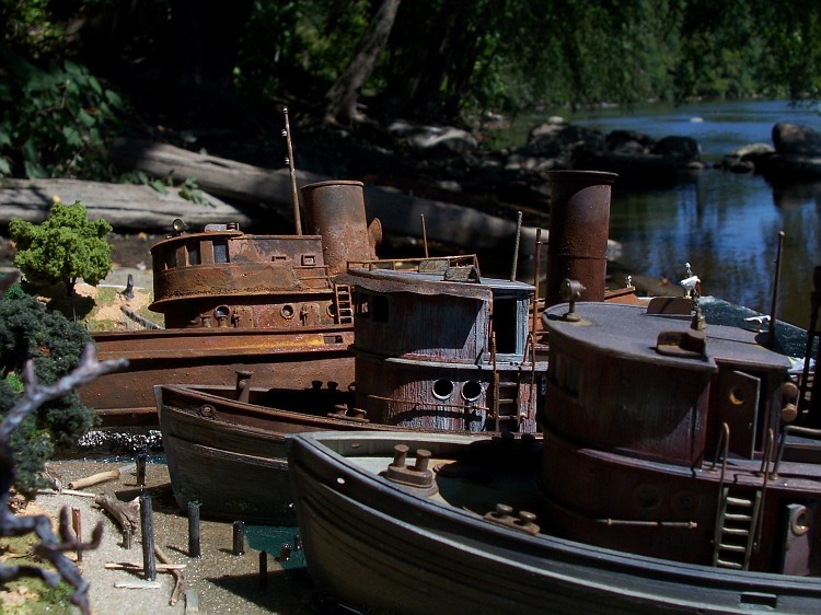

Dave Roehrle completes his "Tugboat Series" of SBS features with this final installment, putting the three previous tugboat builds together into one fantastic diorama!

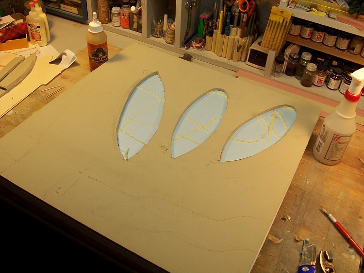

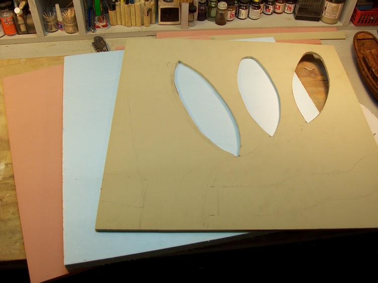

I started the new base by making patterns on paper for holes that the tugboats would fit into. For the base I used a 24-inch x 24-inch piece high-density polyurethane foam on the bottom and the top with a layer of blue insulating foam between them.
I positioned the patterns on the base and cut holes for the boats to fit through. The foam was then glued together with Gorilla Glue. I used wooden skewers to ‘nail’ the foam together before the glue dried.
Dave, an absolutly brilliant job. Love the way you quietly turn it into a horror scene in some of the last photos. Thanks for great build process, really enjoyed it.
