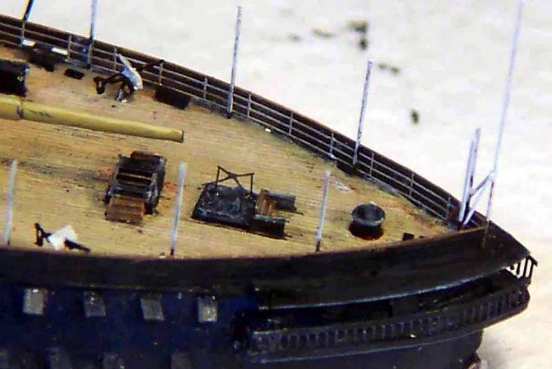

I  had realized that the profile drawing in the  Spanish  Pelayo monograph  was not entirely telling the truth,  and I   would need  far more information. I scoured the internet and ended with  placing help-needed  requests on the message boards; these quickly yielded an avalanche of  photos and even better still, scans of builders drawings!
I was able to contact the well known Pelayo authority Nick Mitiuckov who had just had published a new monograph of Pelayo; the book was rushed to me from Russia by Sergey. I was now better armed to be able make sense of the grey areas, as I now had cross-sections, as well as some deck photos which went some way to clearing up some of the queries that had surfaced through the build.

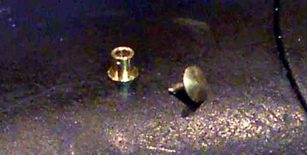

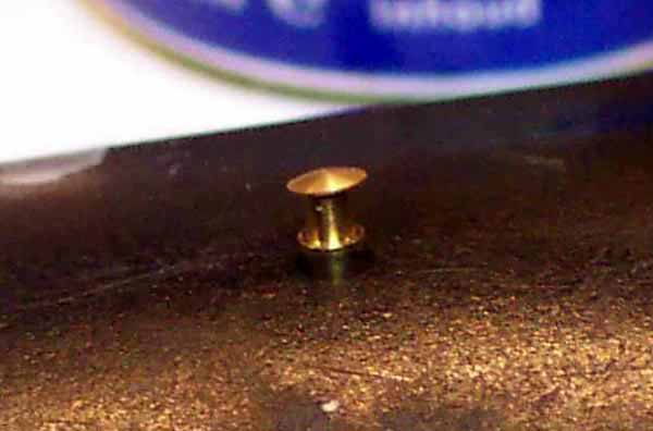

I made two capstans using small tube and N-scale railway buffers.

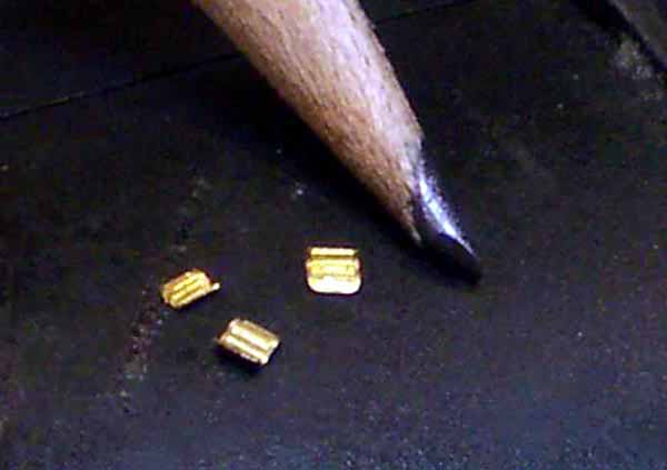

I was able now to see the exact positions of the deck hatches and companion-ways, as well as the positions of the ornate 'leisure' seat benches on the quarter deck.
These items I bent up from very small bits of corrugated PE;
I have never seen such items of civilized non-military equipment on any other capital ship!

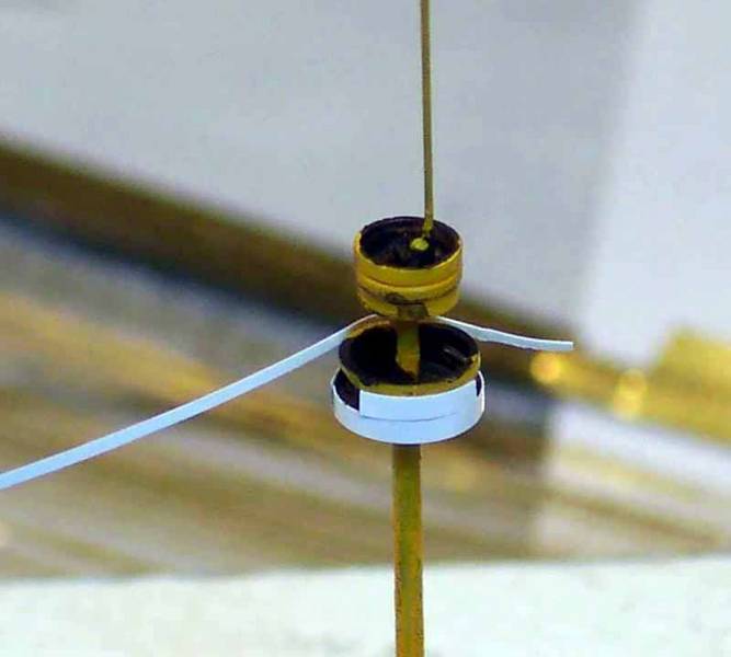

In the meantime I had masted the ship using stainless steel tubing to give rigidity.

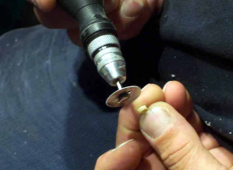

The fighting tops used were those supplied in the kit, they appeared to be about the right diameter, however I wanted to have the apertures open, this I achieved by cutting out a slice using a rotary saw blade. Thereafter the 'step' was given more definition again using the vinyl tape.

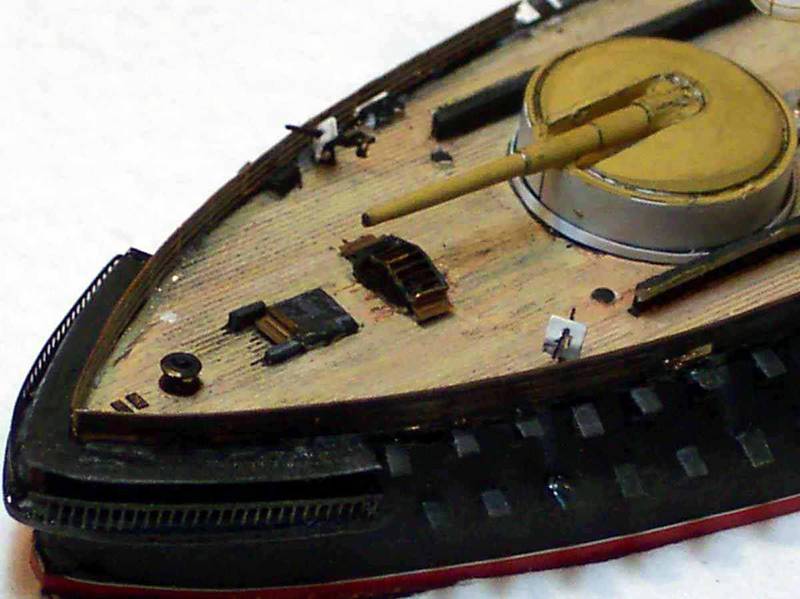

Beautiful build, Jim.  Great atmosphere.
A suggestion for the next time you have to plug a large section of hull (as you did with the sacrificial gun turret in this build): try some Aves Apoxie Sculpt.  It's an acrylic two-part sculpting clay.  It dries super hard, sands and feathers like a dream, and it will hold an edge.  You might have trouble making it out in  this picture  but I was able to get that end of the hull razor thin using Aves (I had to resculpt that edge after the hull took a nose-dive to the floor).  I was able sand it down so sharp it became a translucent knife-edge.
