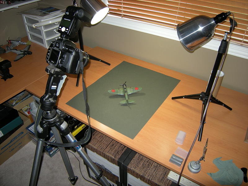

When shooting your model, use of fill in light will be critical in reducing shadows and contrast.
A portable studio can be purchased relatively inexpensive. My set up of two adjustable lights and tripods cost me just under $150.

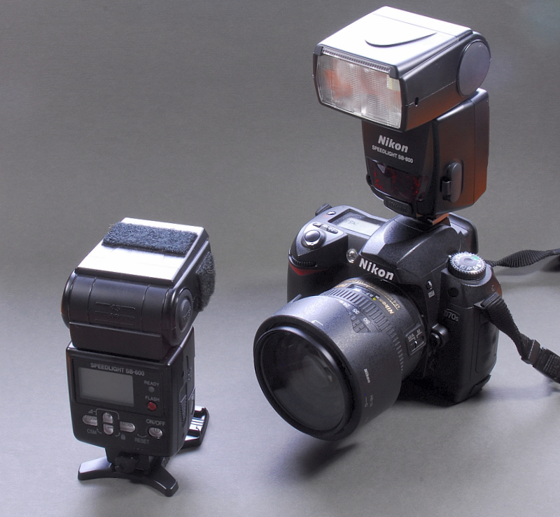

You can fashion a similar setup even cheaper if you buy the components individually. Another option for the DSLR users is the use of a master and slave flash setup, this allows the master flash to fire off a signal to the slave unit, firing both flashes simultaneously.
The slave unit can be positioned by hand to reduce the amount of shadow cast by the master flash.

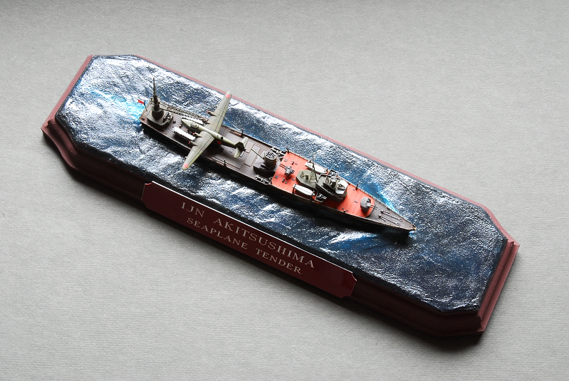

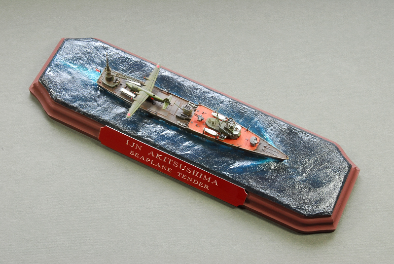

I was wondering about two things, mainly with regard to the photos: In your section about lighting, you have the 2 photos, but could you tell us with which kind of lighting each was taken with? In my past, I've taken slide pictures under fluorescent lighting, and they had a decidedly green tint to them!

I'm glad you found the article of use. Regarding the lighting used, I use my flash unit with two flourescent bulbs to either side to diminish the shadows. The flourescent bulbs are 5000K true daylight 26W/110-130V, Lumen:1600. As far as the Zero photos, the colours are the same, it's the background that gives the different colour perception.
