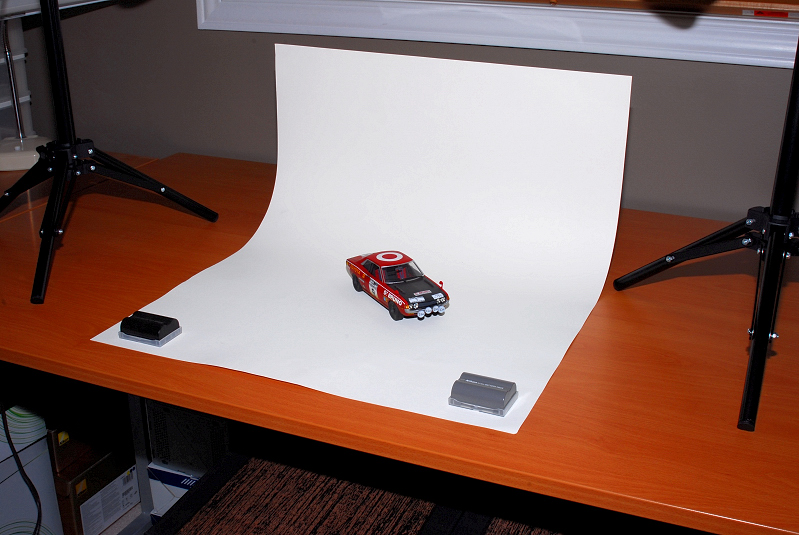

If you are shooting from above, lie it flat on a table, if you are shooting level with the model, set the cardboard curved under and behind to give you a seamless background.

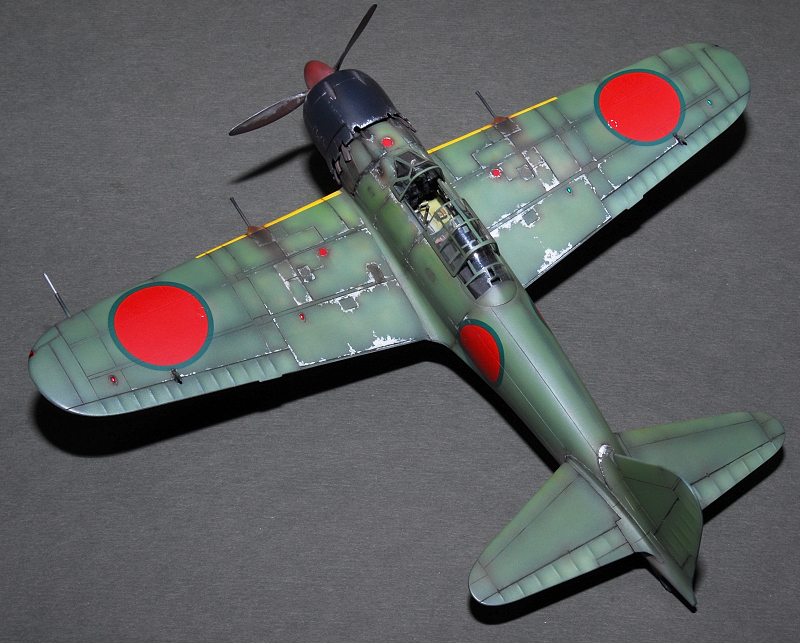

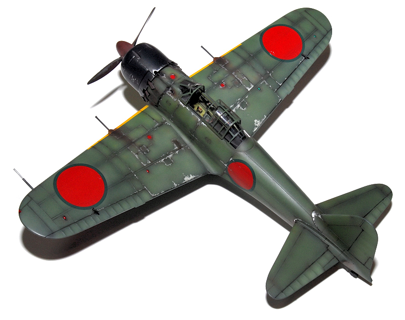

The other thing, with regard to the photos about using some colored sheeting for a background: the 2 photos of the Zero (it is a Zero, isn't it?) have such different colors with the use of different colored sheets - is that just my perception that the colors are that different, or were some different settings used on your camera to cause that?

I'm glad you found the article of use. Regarding the lighting used, I use my flash unit with two flourescent bulbs to either side to diminish the shadows. The flourescent bulbs are 5000K true daylight 26W/110-130V, Lumen:1600. As far as the Zero photos, the colours are the same, it's the background that gives the different colour perception.
