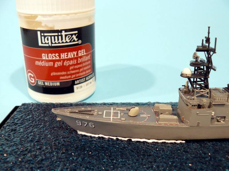

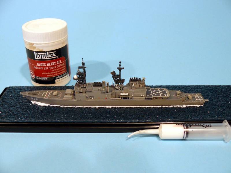

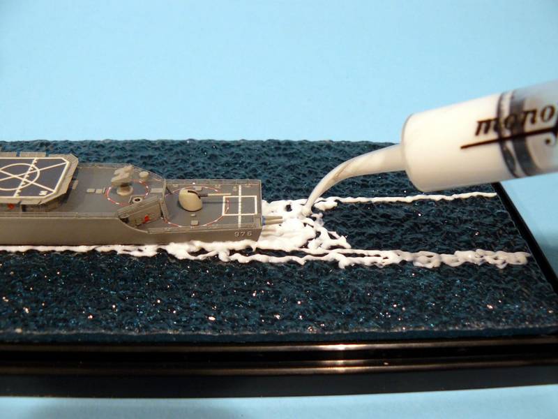

Step 4: Creating the Wake and Waves

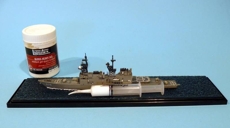

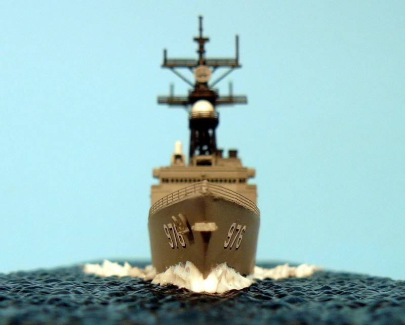

With a hobby syringe filled with LIQUITEX Gloss Heavy Gel (an artists’ canvas preparation acrylic gel), I fill the gap between the model and the OEP that occurs because of the irregular surface of the OEP and the straight edge of the model’s hull.During this same step, I apply the first layer of the bow wave. The bow wave needs a number of layers to build up its dimensions for a more realistic look.
After setting the bow wave’s layout, I apply the acrylic gel at the stern to build up the ship’s wake to add to the OEP’s texture in this area and outline the wake’s edges.

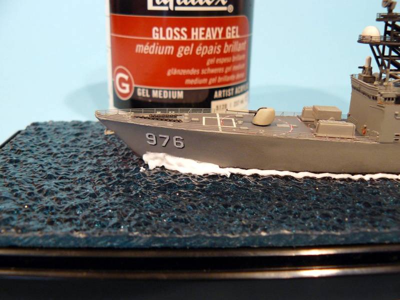

I also outline the ship’s side wake with the acrylic gel.
The LIQUITEX gel will dry clear. Once that the gel is dry you can begin painting the waves and wake.

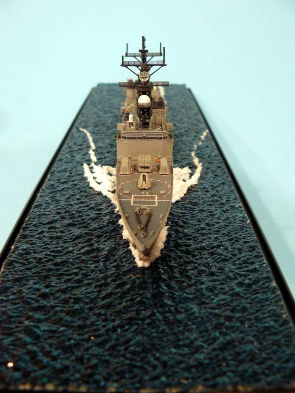

Here are the reqeusted overhead shots.  I hope that you can make out the black shadow of the under water hull.
OCT 23, 2008 - 02:21 AM
Hi Carl!
Thanks for posting the "Broach" dio!
It surely is convincing and a way of making a out of the ordinary dio, using just the sub tower and periscopes / antennas

Thanks for your comments, guys! This is my first attempt, so I haven't chosen my "standard method" yet (albeit that I'm rather pleased with this attempt)!
I've used "easy to work with" Acrylic paints and rather big, round brushes. This evening, I've cooled down the effects a little (it is easy to go overboard!) and added more white to the wake. Now it is time to wet the hole thing down with some glossy coats.
Cheers! // PolarBear!

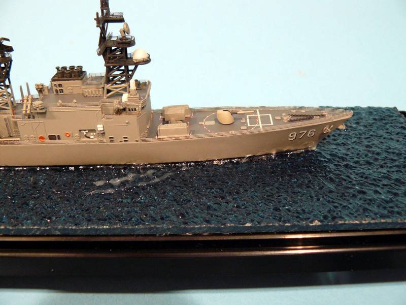

I've started adding some gloss to the surface. I couldn't help doing some basic "photoshopping", just to see how it would turn out..
Cheers! // PolarBear  OCT 23, 2008 - 12:07 PM
