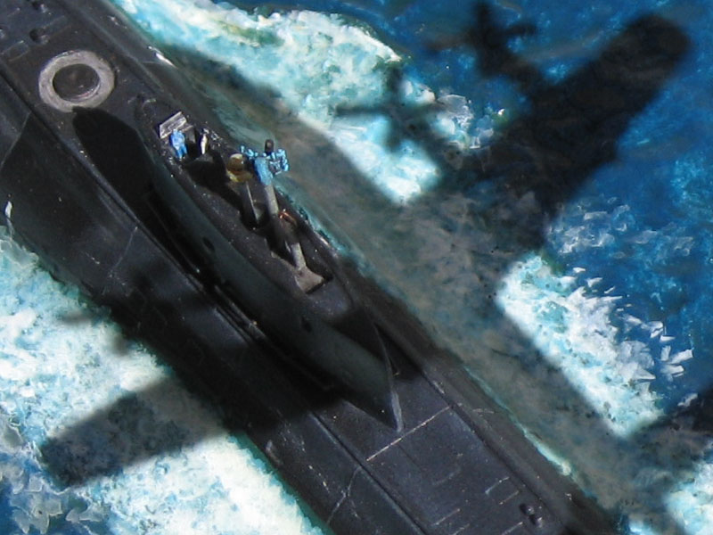

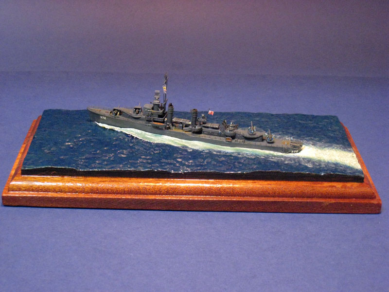

Several people have remarked about my water bases and have asked how I do it and I had the idea of making a "How to..." but Mark R. Smith (Gunny) suggested it as well, and that is what convinced me to go through with it.
It is a simple and easy method and not the most realistic water effect when compared to so, many others' masterpiece dioramas, but it is serving my purpose. It is a little flat and two dimensional, but It looks nice in 1/700 scale, to me, and seems to be convincing in the photos that I take of my models.
Hangchang Kuo has a similar method using just the Liquitex medium gel, instead of the heavy gel that I have been using, and he deletes the Tamiya OEP all together. I may experiment with that, too.
Rui,
Thanks for your question about ocean color. I served on five submarines in the USN. I didn't know the ocean had different colors other than "dark and cold".
I know some modelers have spoken of the look of the seas in different parts of the world as well as in different seasons and times of day. I tend to ignore these specifics. I find them "too, specific" for my intentions.
I am wondering if you mean that my seas are just one solid color or that each model appears to have the same color of ocean?
To try and answer both aspects...
I have found that some blues were too, blue and light and a little unrealistic. The darker blues turned out to be too, dark sometimes and almost black. Gray doesn't work at all. The "Teal" color that I have been using on my latest ones seems to have that "sea green" appearance to it , and is not "too, green", and most of the time, from the right angles, you can't tell that there is any green in it, at all.
I have one sheet of OEP that is painted a dark blue underneath which I use to photograph works in progress.
As far as different colors to the same sea base........I tried spraying lighter blues and grays in light scattered coats and then darker shades on top of those (from the bottom of the plastic, mind you) but the lighter colors still mostly disappeared into the dark shade, unless seen from exactly the right angle and really up close.
I haven't attempted to experiment with painting ocean colors on top of the plastic surface, yet, except for the white. I may try that, soon, with layers of paint colors and acrylic gel on scrap pieces of the OEP that I have. But if I'm going to try Hangchang Kuo's method, I'll have to paint ontop of the surface.

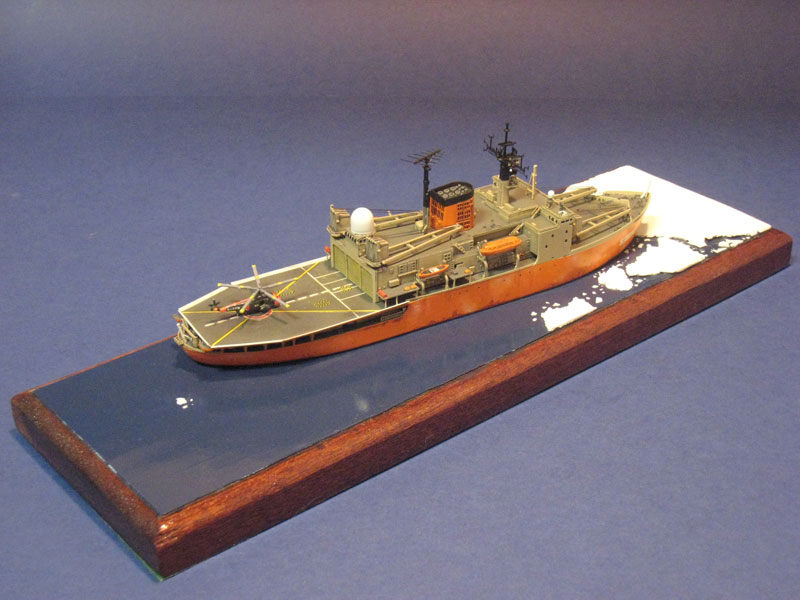

Let me explain with the help of finished projects images:
The Atlantic in all it's glory (on a Deep Blue color)
The River Tagus in Lisbon, Portugal (low tide)
A murky river in the China Coast (during the monsoon)
The Pacific (one)
The Pacific (two)
And to end the images... The Antarctic
I am finishing five projects and all have different sea colors, adapted to the place and in one case, time of day (I know I am being a pain in the ****).
Well, even if the subtitles, you can associate the image, and with a hint you can pinpoint the place where the model is portrayed/ described...
This is also a fun part of making the dio and I always put the same amount of effort in the sea base as with the model (I know that I can improve both, still...), and since you have a good way of representing the water, having it in different colors could even improve (more) your displays!
It's also fun to see all of them together and see all of those different sea colors....

Can you suggest any specific paint colors that you use for ocean effects? Or do you mix your own shades?
I thought that I'd take this photo to compare my various water base colors, but I find it on that helpful for this. I thought that I'd share it, anyway.

Its an honor to hear comments from you Peterf! I've studied your water effect lessons, as well.
My method is definately a good way for "The Beginner" as I still consider myself.
Another mindset that I have is that I'd like my growing collection of 1/700 postwar/modern USN surface ship models to match each other, as far as their bases go. So, I'll be trying to use this same method on those as long as I can still obtain the Tamiya OEP. Hangchang Kuo's method will be the closest thing to my method when the OEP runs out.
For any special projects outside the collection, I'll probably experiment with your method.
