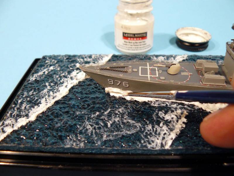

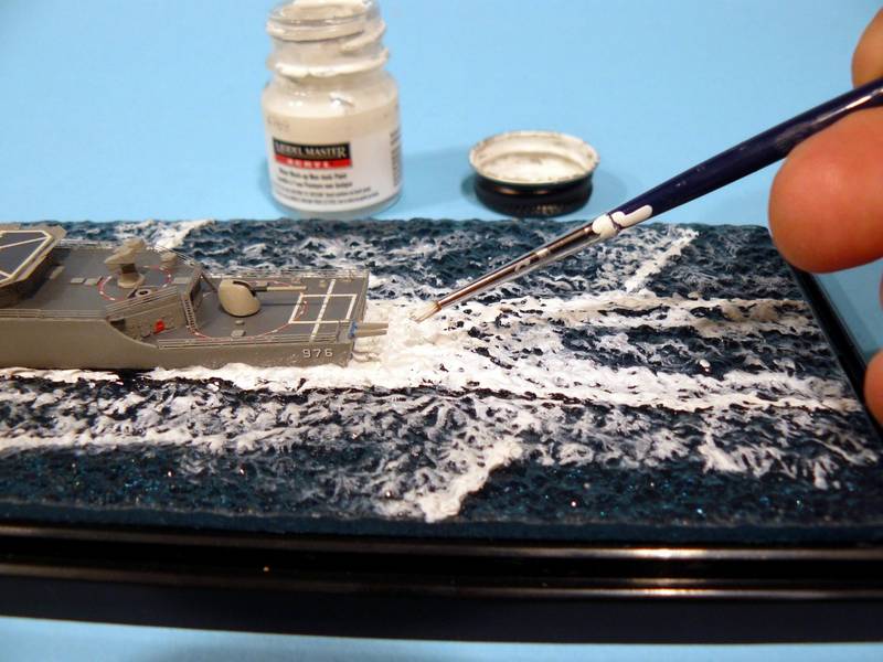

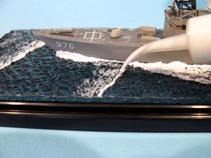

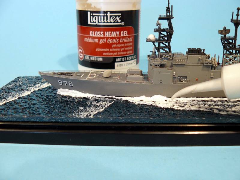

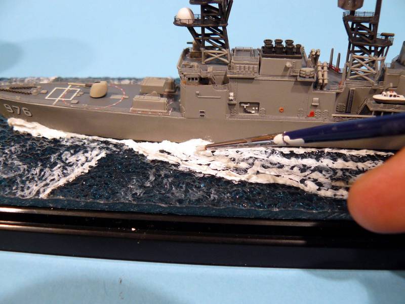

After applying the white paint to establish the look of the entire wake and waves, I again use the hobby syringe and the LIQUITEX gel to build up the bow wave, the stern wake, and some waves along the sides of the ships.  The leading edges of the wake, farther out from the ship, may be built up, as well.
After these second layers of acrylic gel have dried, I then paint over them with the white paint.

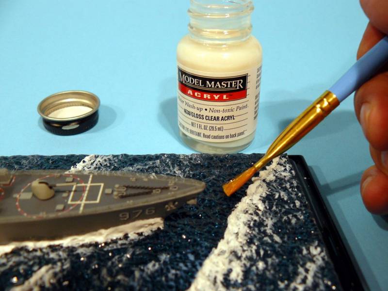

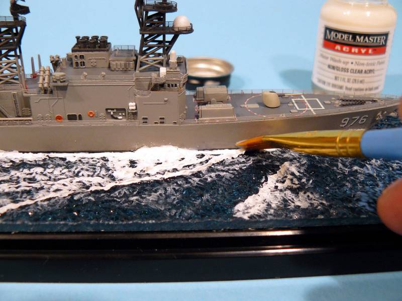

As I mentioned previously, when the white paint has dried I apply an acrylic gloss clear coat to the waves, wakes, and the entire OEP surface. I will also apply a little gloss coat to the lower areas of the hull and a little higher around the bow, to depict a wet surface in these areas.

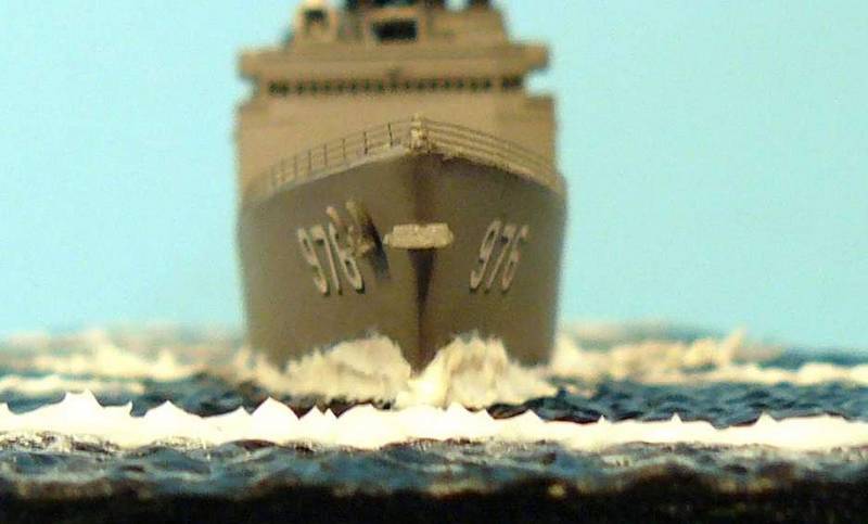

I've started adding some gloss to the surface. I couldn't help doing some basic "photoshopping", just to see how it would turn out..
 Cheers! // PolarBear
Cheers! // PolarBear  OCT 23, 2008 - 12:07 PM
