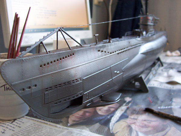

To make sure the decals would not get shiny, I first sprayed a gloss coat on the VIIC. I used Tamiya X-22 for this. After that, decals were applied with Micro Sol. I sprayed another gloss coat on the model and started weathering. The weathering I did was a number of washes on the whole u-boat. I used burnt sierra oil paint for this, mixed with white spirit. Also, while the wash was drying, I painted some rust marks with model masters rust on the u-boat (so before the wash had dried). I did this because the paint mixes with the not yet dried white spirit, with as result nice rust marks which are blended a bit with the u-boat colours. But I encountered some trouble with the washes: “circles”. Everyone who uses washes sure know what I’m talking about and on a large surface like the VIIC this problem comes very easily, so watch out if you’re going to “wash” you u-boat as well! You can remove “circles” by adding a bit of clean white spirit/turpentine on the “circle”. I finished the u-boat by spraying another gloss coat on the model. The model looked very “dead” after the washes were applied…..matt is not a good colour for an u-boat which is usually wet and glossy, so that’s why I decided to give my u-boat this gloss coat. I really like how it came out….but I think this last step is a real matter of taste!Part 10: finish / conclusion...
