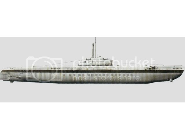

This project began to be in preparation it does mas of one year in a roast with friends in which I speak to him about the lack of a commercial kit of this type of submarine in scale 1/72. After an exhaustive search in Internet we come to the conclusion that had not realized any ¡!!! And the question was and for that not to try it ¿?? So I approach to trying to obtain the major quantity of information digital and written on them. With a few planes obtained of the book " Vom Original zum Modell and a few planes for models at carton I started being employed, correcting some little houses in this one I finalize and taking it to the claimed scale we begin this project that we will develop later
Good like presentation or to be entering the topic I they present a summary of excellent mas of these real submarines since for first you see had been achieved to construct a ship that was getting out of a jam itself better under the surface that above … ….. That to say or where to begin ¿? It would be necessary to move back in the history in the middle of 43 when the submarine war every day was untenable … .. the measures anti submarine and the air supremacy of the enemy on the Atlantic one they were almost absolute. The implementation of the Snorkel in the conventional units they were not stopping solving the topic and the encouraging projects of "Walter" and his system of turbines of Peroxide of Hydrogen (H2O2) could not have solved the problems of navigation and reliability as to help
A construction in series … … .asi that was a moment to construct some ship that was reverting this situation … .asi that based on the projects deduced of Walter or rather of the type the XVIII but with a hybrid system of Batteries / diesel engine … proves is a formidable submarinos the Type the XXIst that serious the second one in quantity of constructed " 119 units " finished behind the Type the VII. But of all of them only 2 had patrol of war without having victims in his short record ¡! If one of them pipe Or 2511 a meeting with an enemy convoy composed by the cruise Norfolk and the destroyers' escort … the curious of the meeting was that the U-2511 was on returning to Berguen to deliver his ship since Germany had come to terms … .but since of boys it wanted to simulate an assault to the powerful one Managing to unload fictitiously his 6 torpedoes against the English units and to move back from his minimal distance of 500m without being detected ¡!! Imagine the surprise of the allies to he reads the binnacle and the personal diary of the captain of corvette "Adalbert Schnee" ….. Returning to the principal thread … at this point Donitz's war there was drained constant of material and of sailors like that that obtained the approval of the immediate construction of the new submarines entrusted to revert the war in favor of Germany …. It was like that that I entrust him the construction of these new ships of a revolutionary way for the German shipyards … .basado in the construcciones of the American "Liverty", was decided to construct them for sections mas precisely in 8 sections and later one would add him Ninth that serious the candle this was reducing the times of construction and there were distributed those who haceres between the different executors minimizing the misadventures only man of work would take a time of aprox 330 000 hours when his predecessors class the IXth were going almost 500 000 hours.
This time serious reduced significantly Al-en enters construction in chain but equal it would not reach since the delays for the frequent mas bombardments one the shipyards and railroads every time were complicating mas his construction …..
It is like that that get up the construction of the Large chest " Valentin " gentle factory of assembled under the protection of several meters (7 meters) of I make concrete and steel which - daria the paragraph the whole article apart for the impressive of this Colossus of mas of 400 m of length!!! That day Al-de today continues being used for sports puerto of German war..
Las separa la o secciones irían Entering the lateral doors and they would follow his step along 13 stops in each of them arian the established works and it would follow the near one where it was waited by new operatives in charge of the near step until his end which already was put afloat where he would be finished by the works of adjustments and tests of watertightness to go out for the door that one sees in someone of the photos … … there was foreseen the construction of underground stores to have a stock permanent of sections protected from the bombardments to finish the war was almost finished in 95 % but being like that not salio not even the alone totally operative XXI.

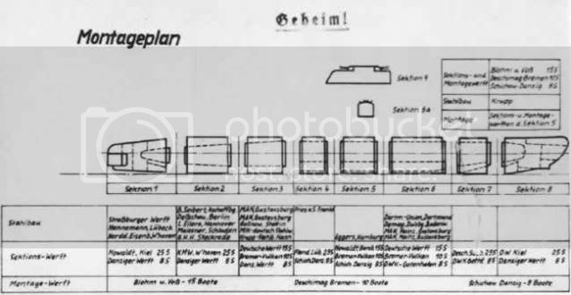

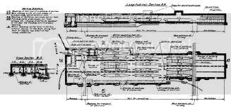

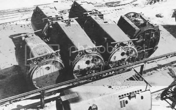

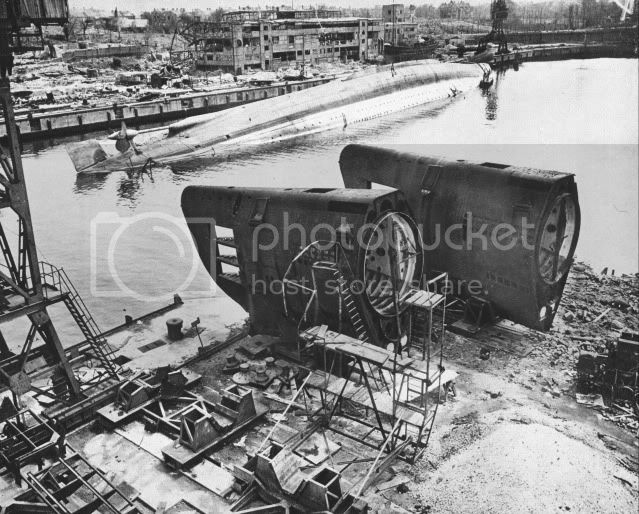

Here a plane of the sections previously mentioned this system also tape-worm the practice to the moment to repair ships damaged seriously changing only the section minimizing the tiempo in shipyard with the risks that this tape-worm
This of the sections is seen very often in the photos where they appear you depart from submarines dispersed as pieces in a chessboard … … … Also we can add that the system was mas that revolutionary but tape-worm his weak points since the delay was common of someone of these sections for the motives already Explained and in addition they were presenting minimal differences of a shipyard to other one so The photo had to be corrected to the moment to assemble
is very curious … .el in view of turned bell of the bottom is the Cruise Admiral Sheer Brother of "Graf Spee". Which was reached in an incursion of bombardment in the port of Kiel The previous day should land to a refugees' quota saved from the Russian invasion to Norway … … The Sheer permission of exhausting his grenades of artillery unloaded against the enemy to try to have time to the loading of the major quantity of possible refugees but the condition of his principal cannons was lamentable and they needed refill … .just Such operations were coordinated for these precise days …. Today in going he is in the same alone place that covered by tons of rubbles and with a beautiful beach of parking!!!!! .bueno I went away different you see … ajajajajjajajaja
Transport of different sections by means of the use of pontoons, above is seen since they are being raised the section of This prow it corresponds to a long shot of a type the XXI

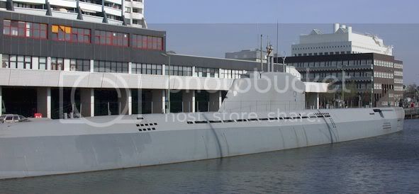

One of the mas known and being the only one of the Tipo the XXI that nowadays is kept after being refloated re conditioned and turned by the "Bundesmarine" in oceanographic submarine of studies and you try torpedoes for many years being acquired later before being dressed, there surrendered to a restructuring similar possible mas to his conception of war and today it is the ship museum. " Wilhelm Bauer " .que shows himself in Bremerhaven, Germany. And that in this forum is a representation of this copy ex-U-2540
http://www.ipmsuruguay.com/foro/viewtopic.php?f=34&t=3349&sid=968fb33aeda93239597be4fe3aa8a009

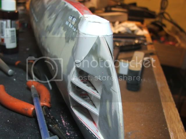

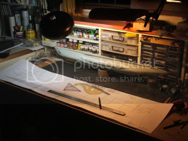

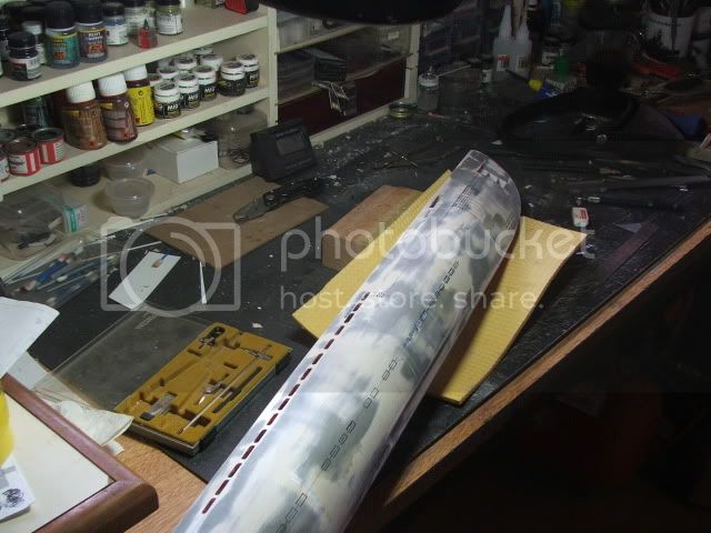

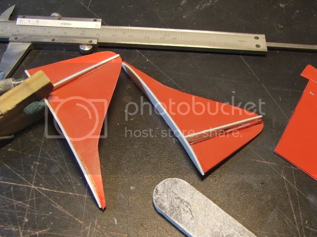

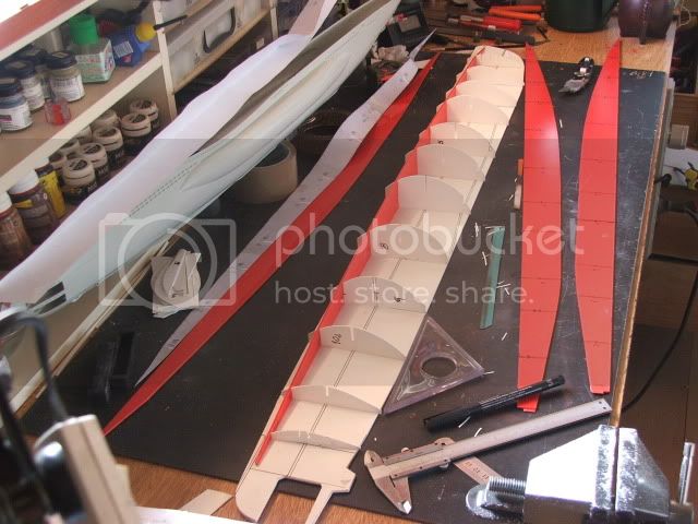

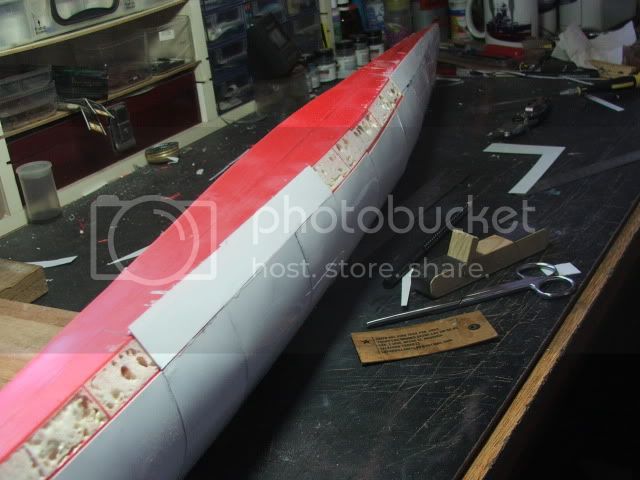

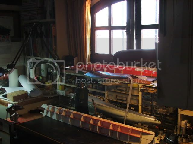

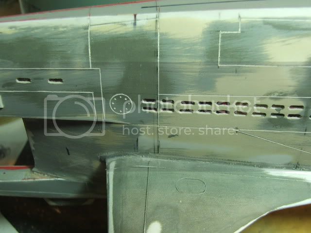

Stage of planned, corrections, extended etc etc … ….. The Type the VII of behind is for inspiration and in addition to compare sizes and differences of one with regard to other one … .. but already they will see it also … …..
Later us one came the moment of plantillar.marcar, to draw, to cut, to sand to compare, to present … … .aaaahhhhhhhhhhhhhhhhhhhhhhhhh!!!!!!!!!!!!!!!!!!!!!!!!!!!!!!!!!!
But the work has his rewards … …
And this way form is taking … … that beautiful lines!!
And in this one already we have an idea mas concrete of his lines and of size on having compared with his companion of hunt ¡! Jajaja
continua...

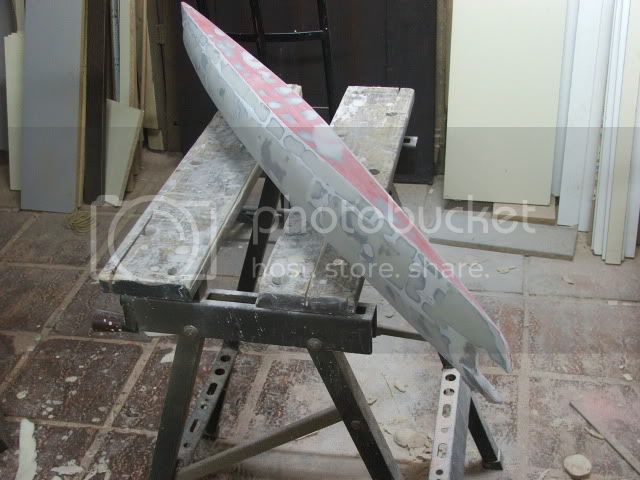

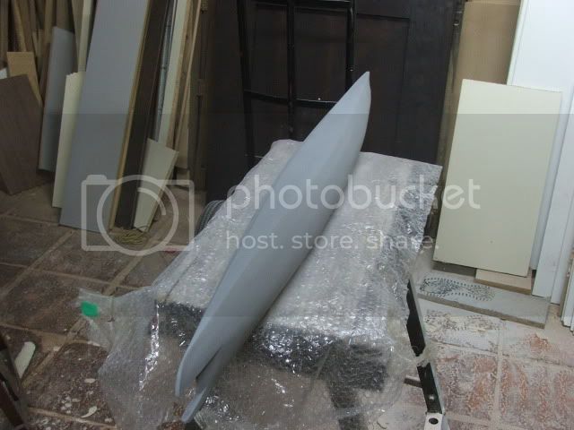

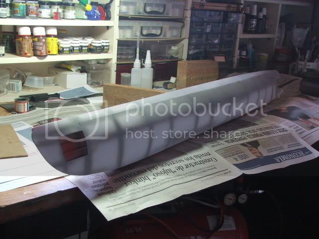

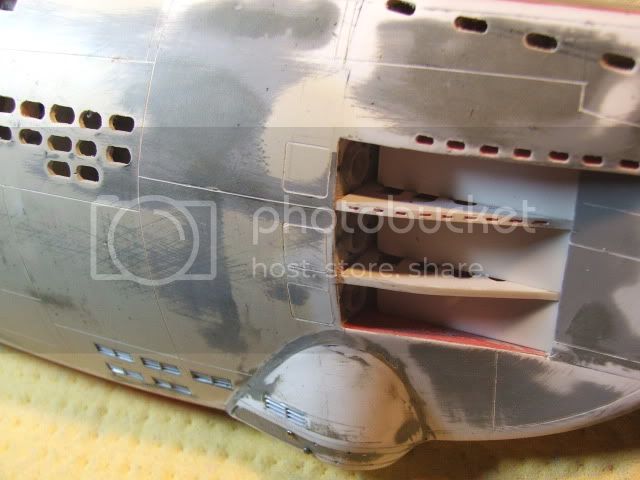

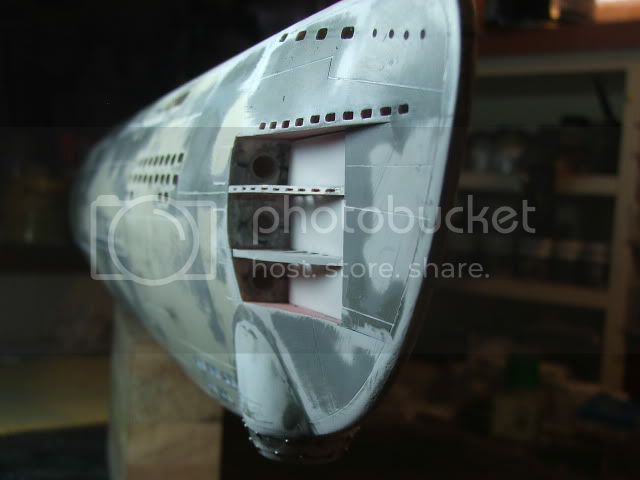

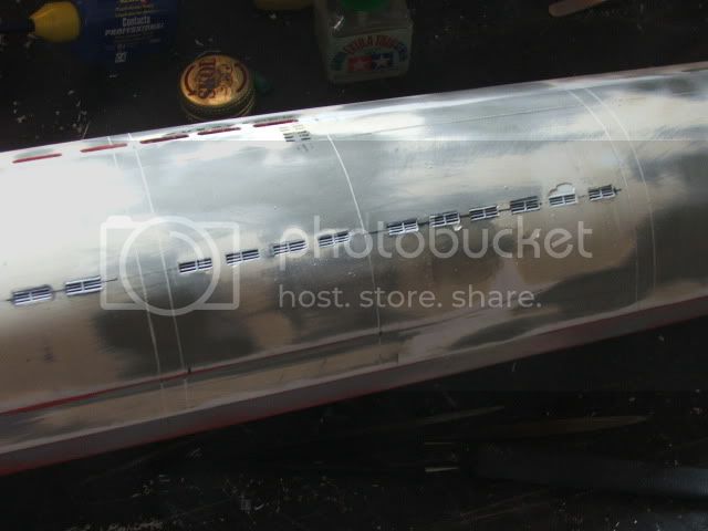

Posted: Friday, May 18, 2012 - 03:22 AM UTC

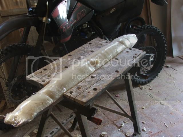

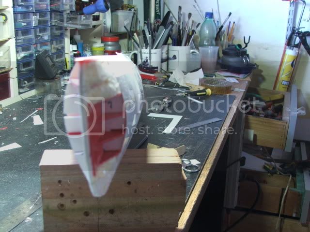

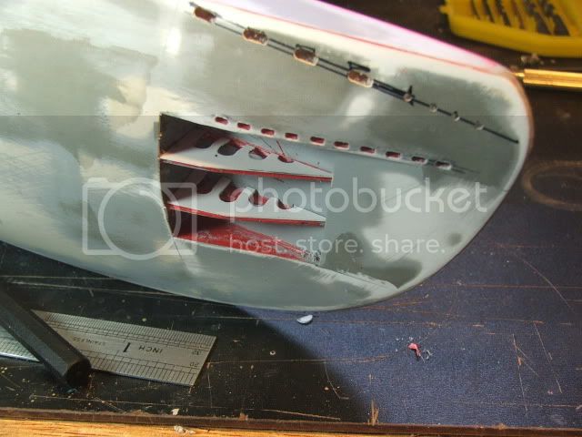

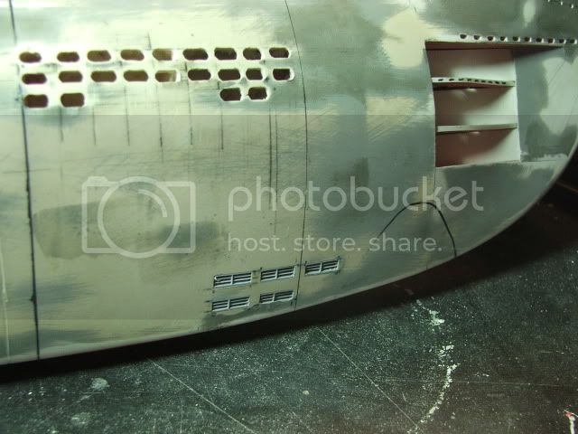

We beat well the polyurethane and it began the amusement ¡!!!
For reasons of plaster there are no photos of the disaster ¡!! Jajaj here already this controlled ¡!
Later work of laminated of the hull … …..
And later a base to detect mistakes … … before continuing forward …
Good as the thing complicated permission I decided and buy me the Kit !!!!!! 1/72 “ …….jajajjaajajjaaj
But after sanding………..
And this way we might hang approximately 200 photos mas … be equal ¡!….jajaa
Continuara …….

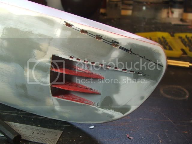

Posted: Monday, May 28, 2012 - 10:21 AM UTC
Thank you friend!! Here I leave some advances
Continuara .......

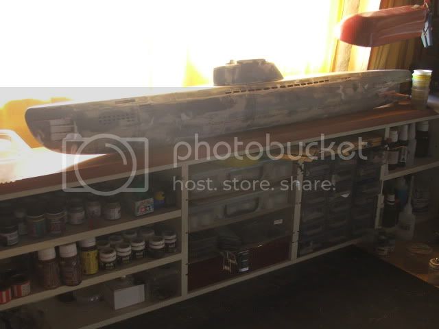

Posted: Tuesday, May 29, 2012 - 12:27 PM UTC
New update

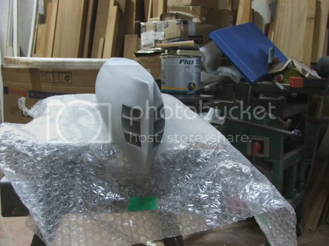

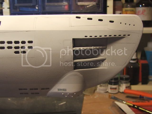

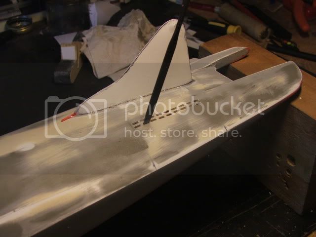

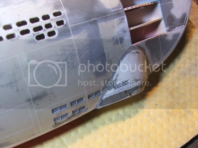

Posted: Thursday, May 31, 2012 - 03:06 AM UTC

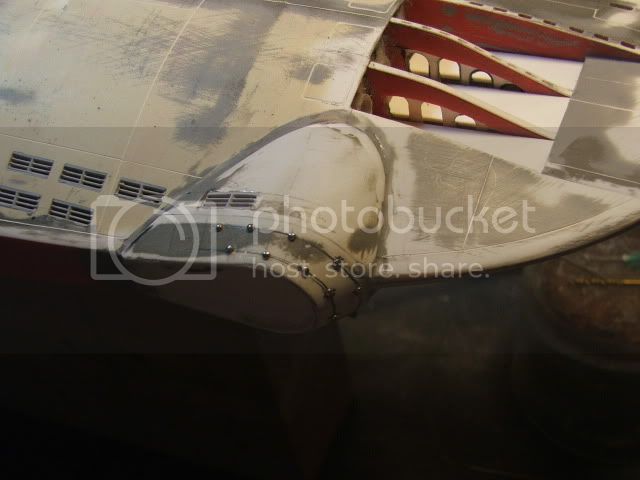

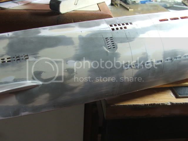

The " Balcon Gerat " ufff this piece I take a lot of work of adjustment!! But I stay believe that well.
,Good, now is a time to follow with the back planes, helms propellers .......... hheeeellllppppppp.p.

Some pictures ...., Drawing and marking panels with the "scriber" very danger
And we apply a new lick of imprimate

Posted: Friday, June 01, 2012 - 07:58 AM UTC
I am green with envy
Posted: Friday, June 01, 2012 - 06:07 PM UTC
Hi Daniel, looks beautiful with the grey ground coat on. This is an amazing build and the result is fantastic.The sonar dome looks just like the real deal.
