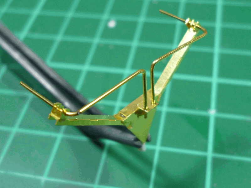

First up was building a much more detailed IFF antenna for the bow deck.. First up you chopped the plastic antenna off and added a new piece of styrene..
Then you bent some brass pieces and glued them together like so..
Then you bent some antennas up out of brass wire and bent some more PE..
Then you glued the PE parts to the plastic mast bits..
 Then after all that you put it aside to dry only to have a CF-100 drop on it and break the plastic mast. Then you drill the plastic rod out and insert a spare piece of wire and hope it all holds together.

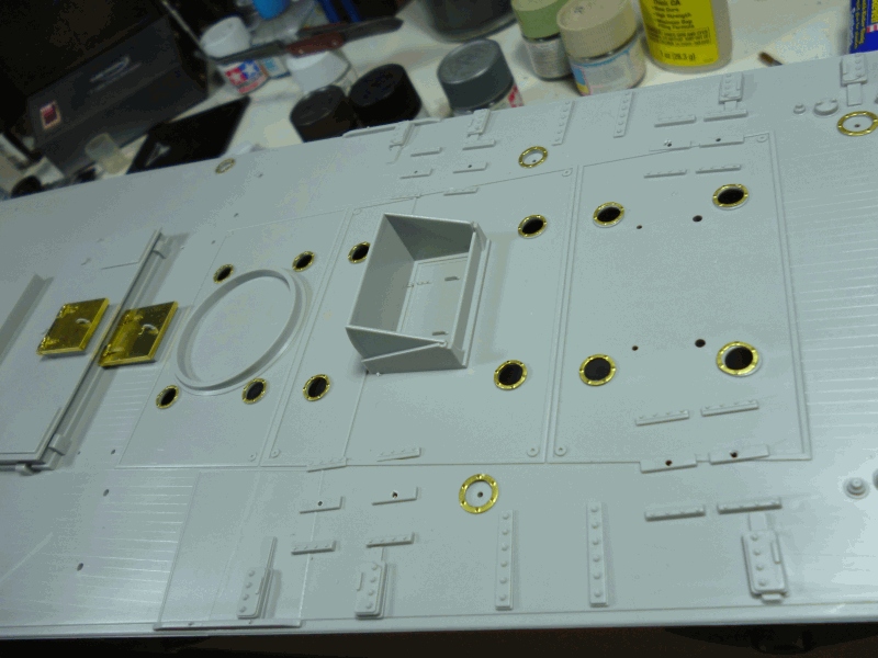

I also got some paint applied to the hull and deck..
And an overall view of the stern deck with all its jewellery attached before it gets painted boring old grey..
After that I made a start on the helm// More tomorrow..
