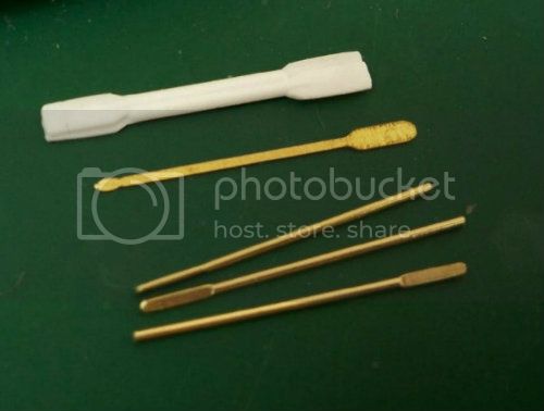

... One difficulty I'm facing is one of the kits I hope to build has oars that are grossly out of scale. The boat is about 1/250 scale. I'm thinking of trying to create oars from piano wire but not sure how to form the blades yet. I'm open to any ideas.
Thanks.
John, here's a repeat of a post I did on my USS Olympia build (1/230 scale) that might help:
https://modelshipwrights.kitmaker.net/forums/183169&page=7#1676770
The kit-provided stacked boat oars weren’t bad, but since I had improved the boats I decided to upgrade these as well. One option could have been to use the photoetch parts from the Gold Medal Models Olympia upgrade set, but these looked too flat to me in this relatively large scale, and the exaggerated blades seemed more like paddles than oars anyway. I finally opted to make new ones from wire.
Making these new parts was pretty simple. Using Detail Associates.022 inch brass wire (#2507), I trimmed each piece to length, making blades by crimping the ends with pliers. After sanding the blade tips to make rounded edges… instant oars!
I’ve used this method before; here’s how similar oars look once painted and in place on my Revell 1/303 scale USCGC Taney model:
Test fitted in the completed Olympia boats, the new oars definitely look more in-scale than the kit parts.
Good luck with your oars John!

Still having difficultly in scratching the oars in getting any two to look alike. I hit upon the idea of using sewing needles for the oars. I'll dip the eyes into white glues to fill the hole and then cut/file to length. I'll post photos when I make some more progress.
